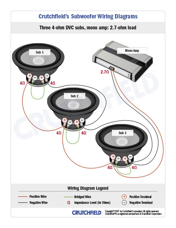

agree. The 2.67 ohm load will be fine and wire up like so.
