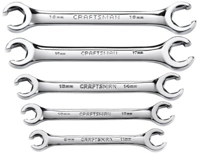

I've had the best luck on all of my cars bleeders using line wrenches, they wrap around the bleeder a little better. I discovered that after breaking 2 off of my wifes jetta right after we first go married. (Her first introduction to hearing profanities being yelled in the garage while she was inside the house...) I won't touch a bleeder now without a line wrench

This. Flare wrench fo sho. Like @Galante said too. If they're that tight, put kroil on there and give it a bit. Just worry about getting them out without breaking them and plan on replacing them.

Yes but if they are that rusty that wrench is just gonna spin...more than likely he will break one but ive gotten lucky on a few occasions...vise grips since they are toast anyway.... you know how it is since you experienced it first hand..;)

Are these metric or standard sizes? Trying to figure out which flare wrenches to get.
52,949
Use an 8 point deep socket and if that fails vise grips. And yes have replacements ready. Then use a line wrench because you can't use a socket when doing the actual bleeding. The Motiv bleeder will amaze you that it's so easy. BTW I just installed a pair of reman ACDelco calipers and one had a 10 mm and one an 11 mm. bleeder.
I have a set of SAE and they do not appear to fit correctly. I'm going to get a set of metrics just to add to the toolbox, and hopefully those will work. If not, the vise grips are oiled up and ready. . .
