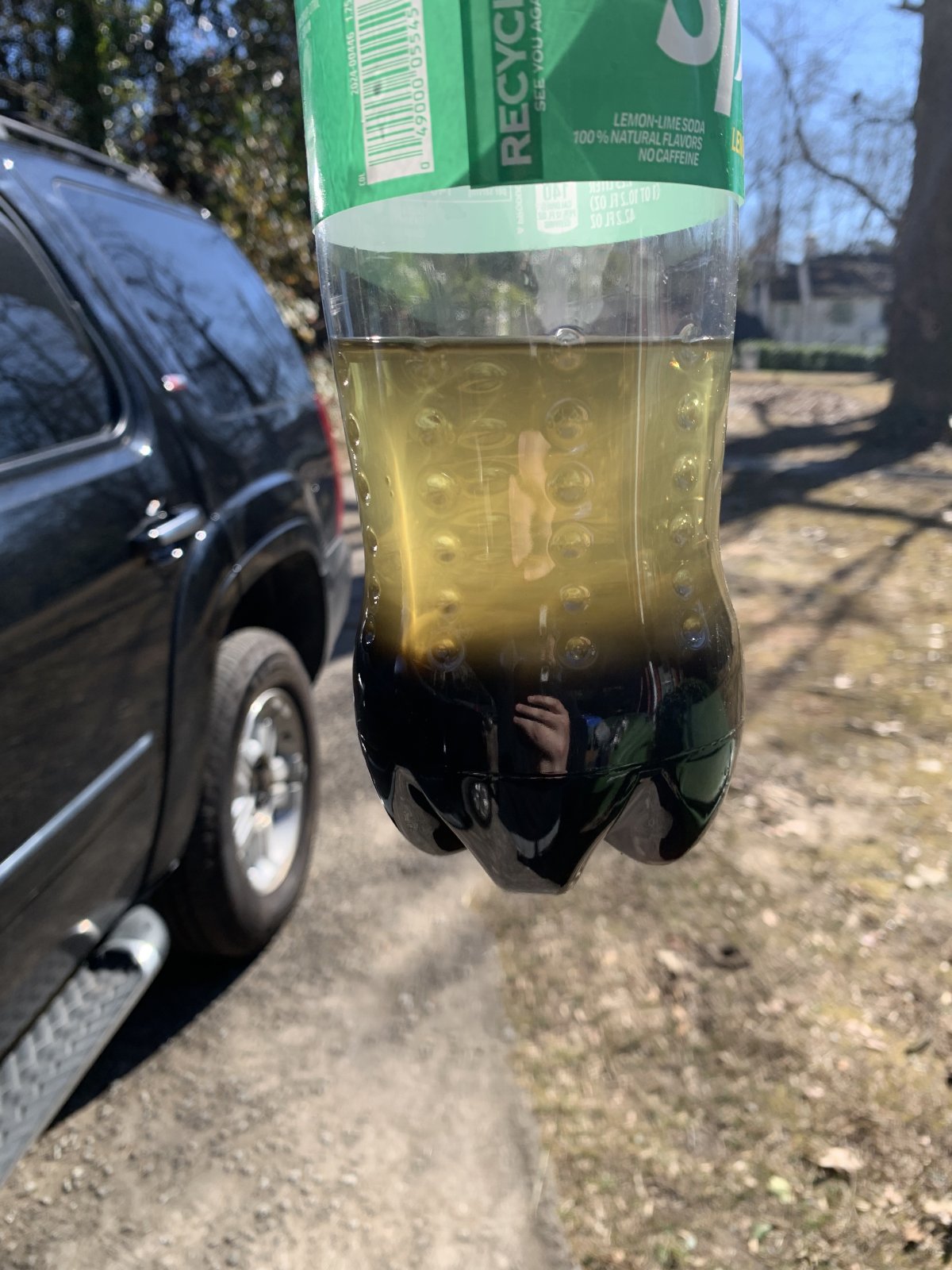

Discovered rear brake pads were low and recently replaced them in the driveway. After replacement, rear driver side caliper is sticking and won't release (rotor gets very hot and burning smell). I cracked the bleeder screw to attempt to release pressure and see if caliper would release. Didn't release without c-clamp and fluid was very dirty that came out. I decided to do a "flush" and see if I could push the dirty fluid out. What came out is the dark stuff pictured (clear fluid is what I put in the bottle before bleeding).
How concerned should I be with fluid like this in the brake lines? Could this cause random ABS/Brake lights on the dash? Should I do brake system overhaul?

Well, clean fluid is better than dirty fluid. However, your truck is at least 12 years old and by about 150K or so the calipers are due for replacement or overhaul. Some get to 200K or more. I made it to the 150s myself on one and 160s on another before replacing the front calipers and rebuilding the rears.

Besides not knowing if the caliper slides are also sticking, you did not talk about cleaning and lubing them, That dirty fluid causes problems internally. The dark means water in the fluid, right along with dirt. That will effect the caliper piston seals and not allow smooth piston movement.
Mine is an 07 with 134k, I've only owned it since Nov. Previous owner had some brake work done, but nothing with the rear calipers so I'm going to replace those. Thanks for the rec.

Unless you know the fluid has been replaced within the service life, probably a good idea to flush the entire old fluid and purge each wheel.

Lots of good advice already offered. One thing you mentioned was you opened the bleed screw on the stuck caliper and it did not release?
That eliminates some possibilities.
If no fluid came out is it possible the bleed screw is plugged? Remove it totally and see if fluid releases.
If fluid is not causing your stuck brake a new caliper is in order or a rebuild to free your stuck piston.
Probably when you compressed the caliper piston to install new brakes you pushed it back into all the dirt in the system and the piston got sticky. When you apply the brakes and release the piston goes out applying pressure but it no longer retracts.
Common issue. They used to sell rebuild kits for calipers but due to liabilty and the time it takes to rebuild one every shop now does a replacement with a new or professionally rebuilt caliper.
Flush the system completely before installing your new caliper or you will pump old dirt into the new caliper and shorten their life.
