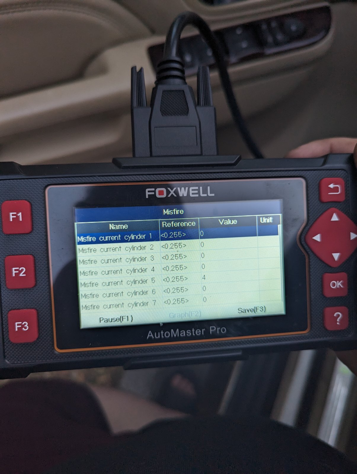

I did a bit of a test today. I opened my scan tool, Opened misfire menu, Rev up engine to 3700 rpm, and let go gas. It showed just once misfire on 7, 5,8,1. I bought just 2 coils blue streak, installed on 5,7 I had new delfy , so I used it on 1. The real pain is to get to #8. I definitely know that nobody changed coils on 8 and 6. Last time 8 spark replaced it was broken on a side or burned. And mechanic was cursing that engine and that engineer who made it. And he said that he did all his best, but could not guarantee that while he was pulling out socket, he might broke that spark again.

from my experience when it's missing to the point of feeling it and setting codes the misfire numbers on the scanner will be steady counting up, not just a few here and there. but a almost constant counting. if you can get it to miss while driving with the scanner activatly on it. say with a passenger watching. don't run into someone trying to drive and watch lol. I do like the blue tooth phone apps ones for things like that. Just put the phone in the holder and go for a drive till it starts. then pull over and watch what's going on.
an intake leak will make the long term and short term o2 sensor trim crazy. good is around 5% plus or minus. if you're in the maxed out 15-20% you could definitely have some leak. if it's bad enough leak, it can definitely cause a lean missfire.

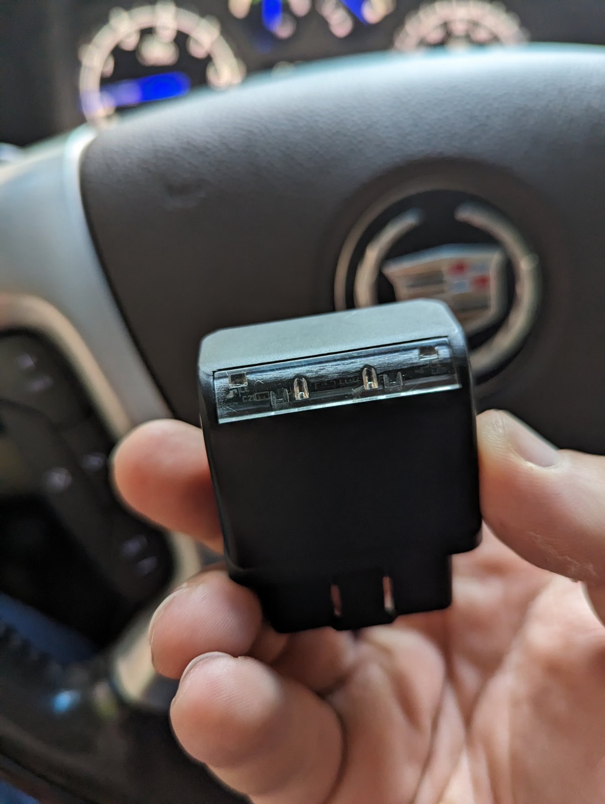

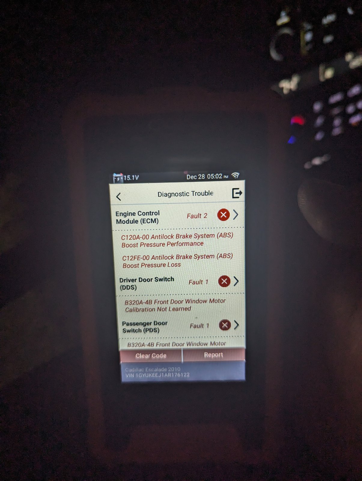

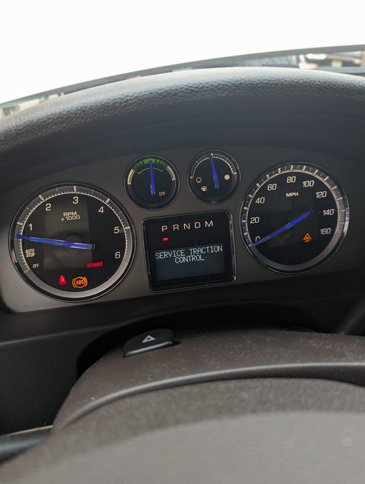

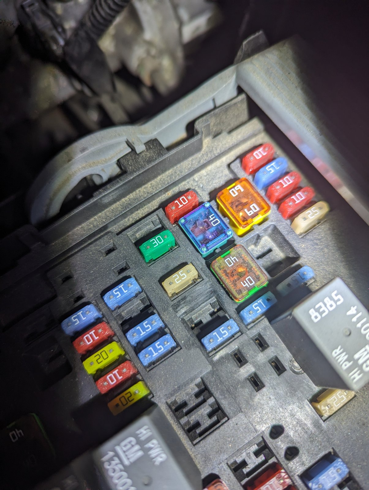

That's for a tip. I don't know what is going on with this truck but I gives me Stabilitrack again. I tried disconnecting battery wires for some period of time. But no avail. Can't wait to trade it in, before it would kill me. Once I had Stabilitrack service on 65mph. With all my family inside. I barely managed to avoid collision. I got no idea what is wrong now. I drove it yesterday it was fine, parked. And I got this thing now.

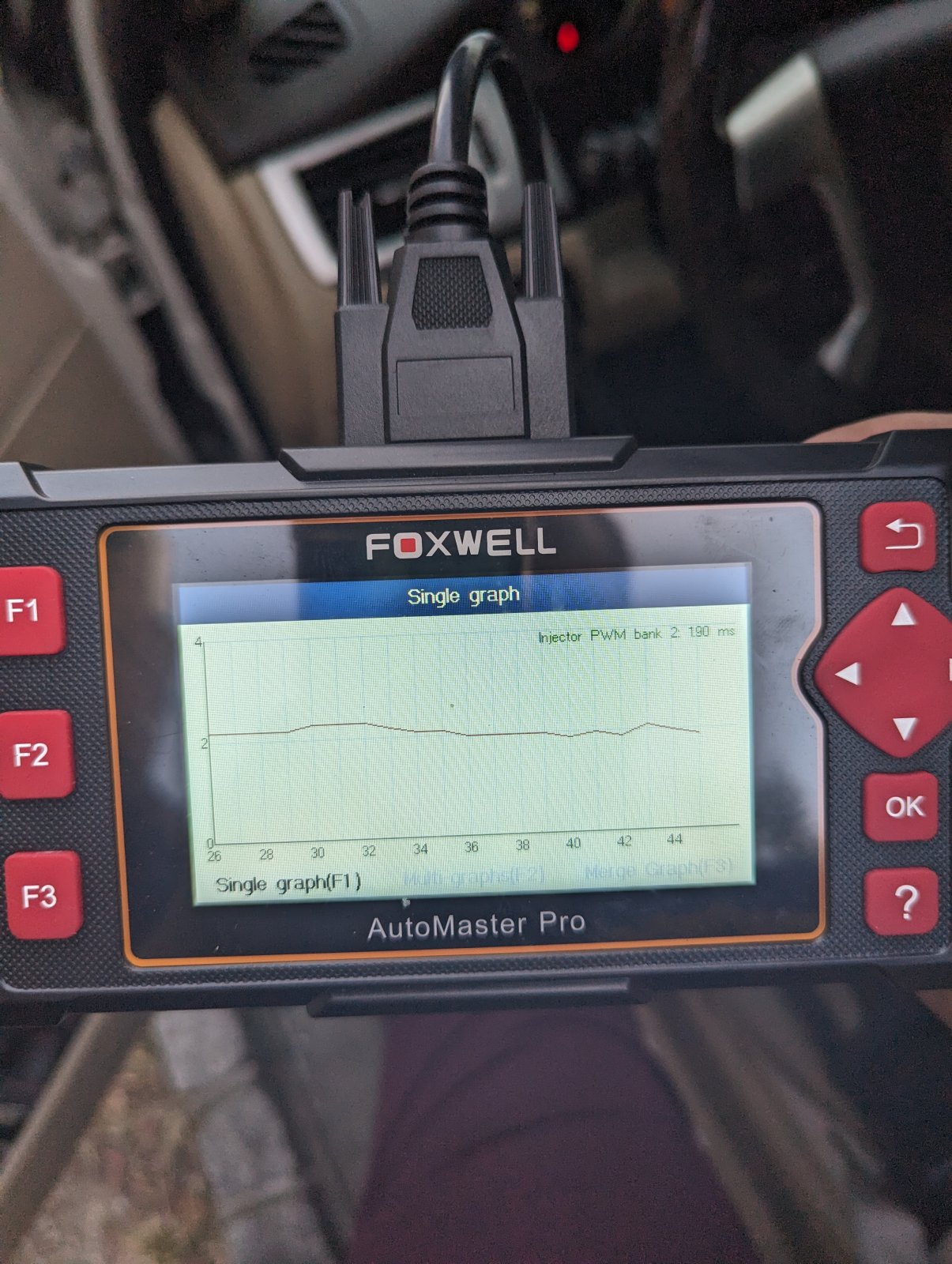

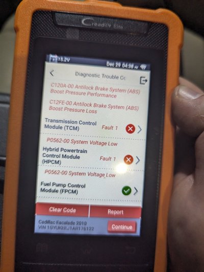

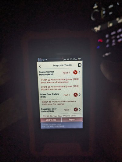

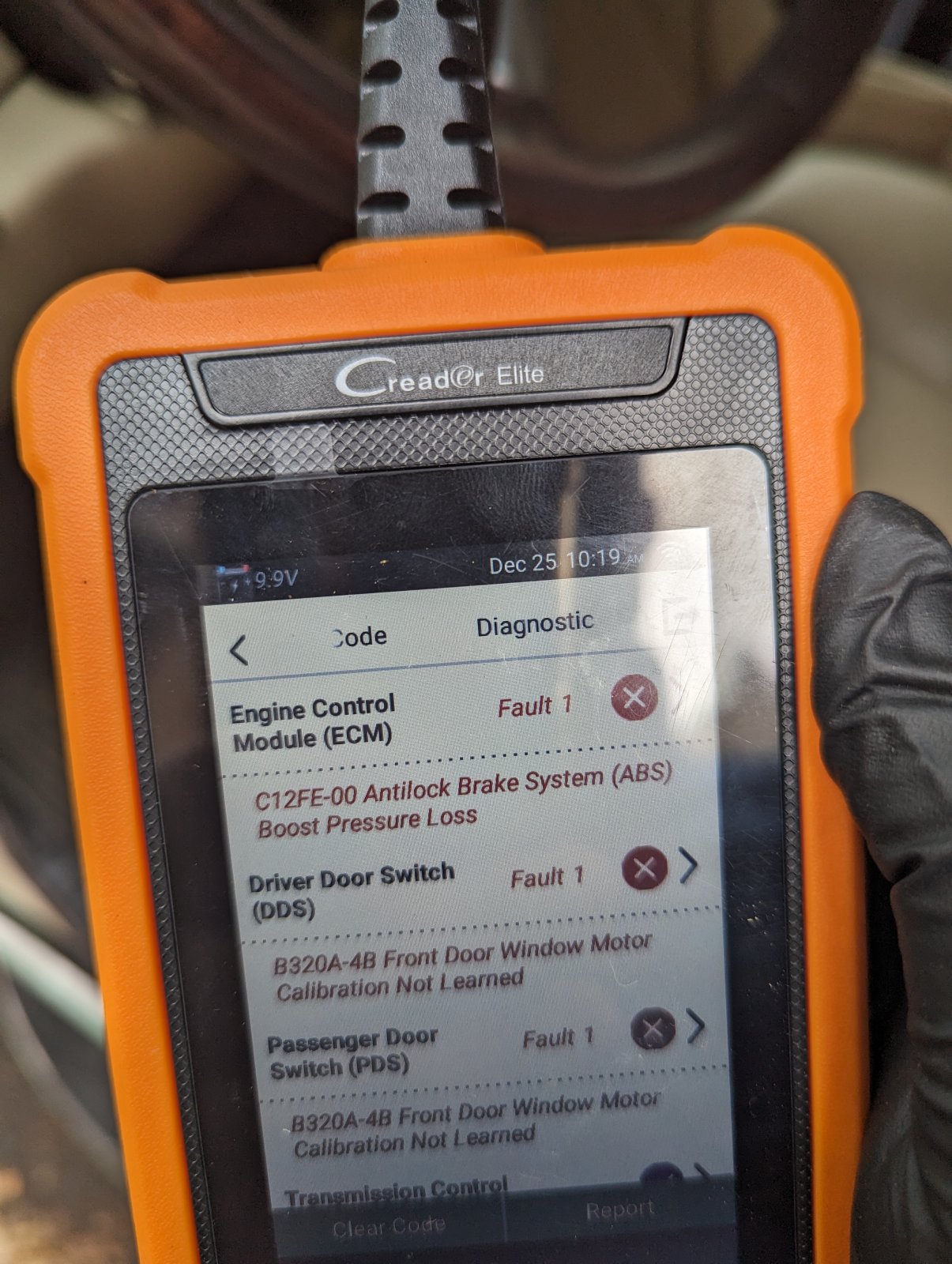

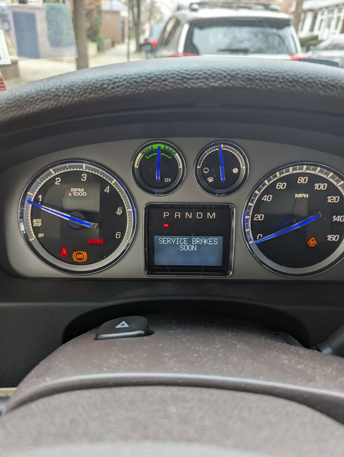

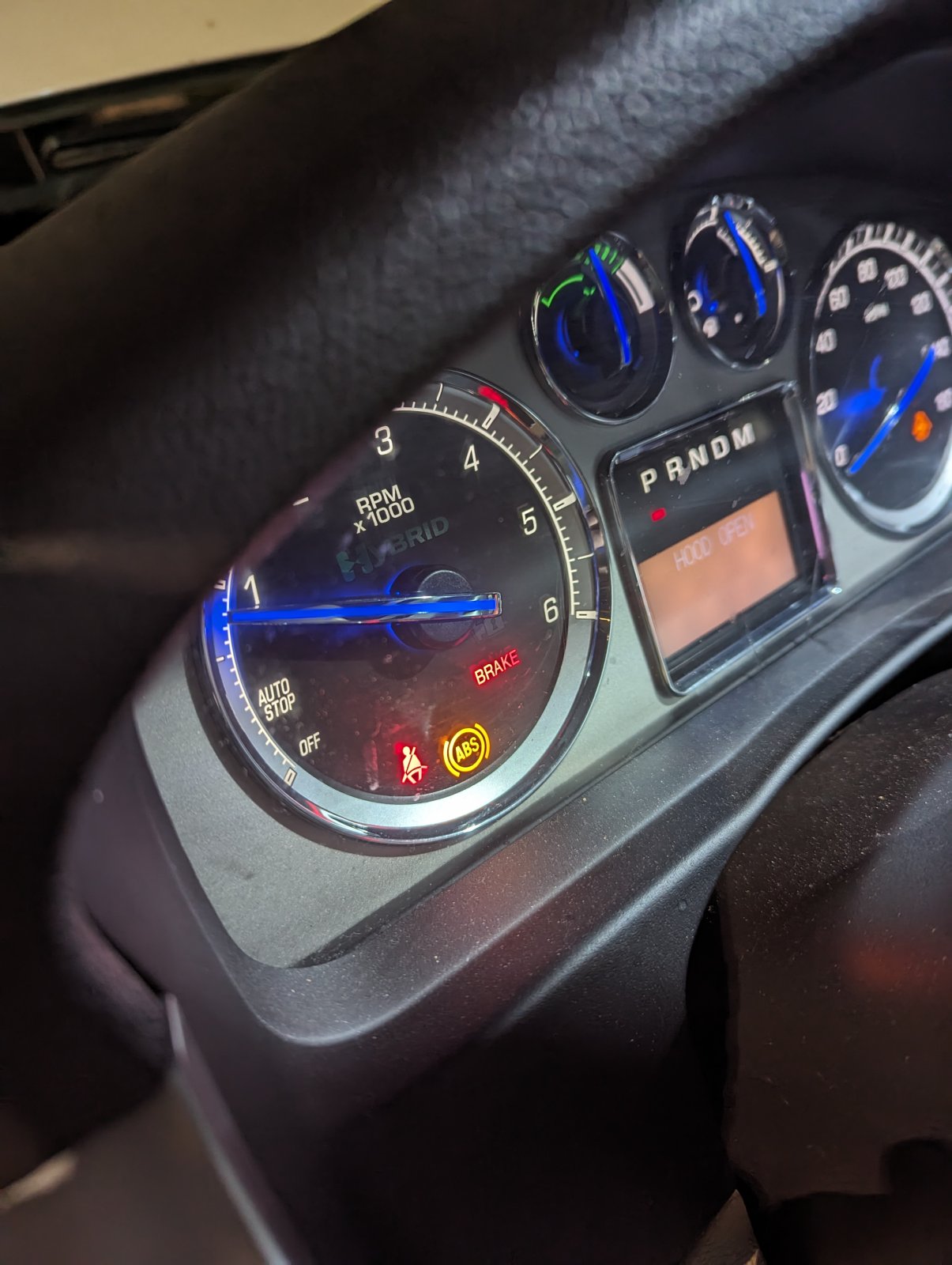

By some kind of reason I can't get 14 v. 9.9 through obd reader . System has not enough of boost. There's big energy drain in the system.

how old is the 12v battery? are the terminals clean and super tight? I've seen posts about these quick connect style battery cables not making good connection for people. you shouldn't be able to move them by hand at all when you try to twist them.
these things use the 12v battery in a weird way, since they don't crank the engine over, they can be what a normal truck would consider bad and wouldn't crank, but good enough to allow these to turn on. but cause other weird issues.
lotta times it will thru off the stability control when the miss fires happen. the computer figures it can't control the torque output of the engine correctly to manage it. so it turns it off so not to make it worse. I'm sure they didn't expect it to make you crash. that seems scary.
you definitely have a ghost in the machine at this point.

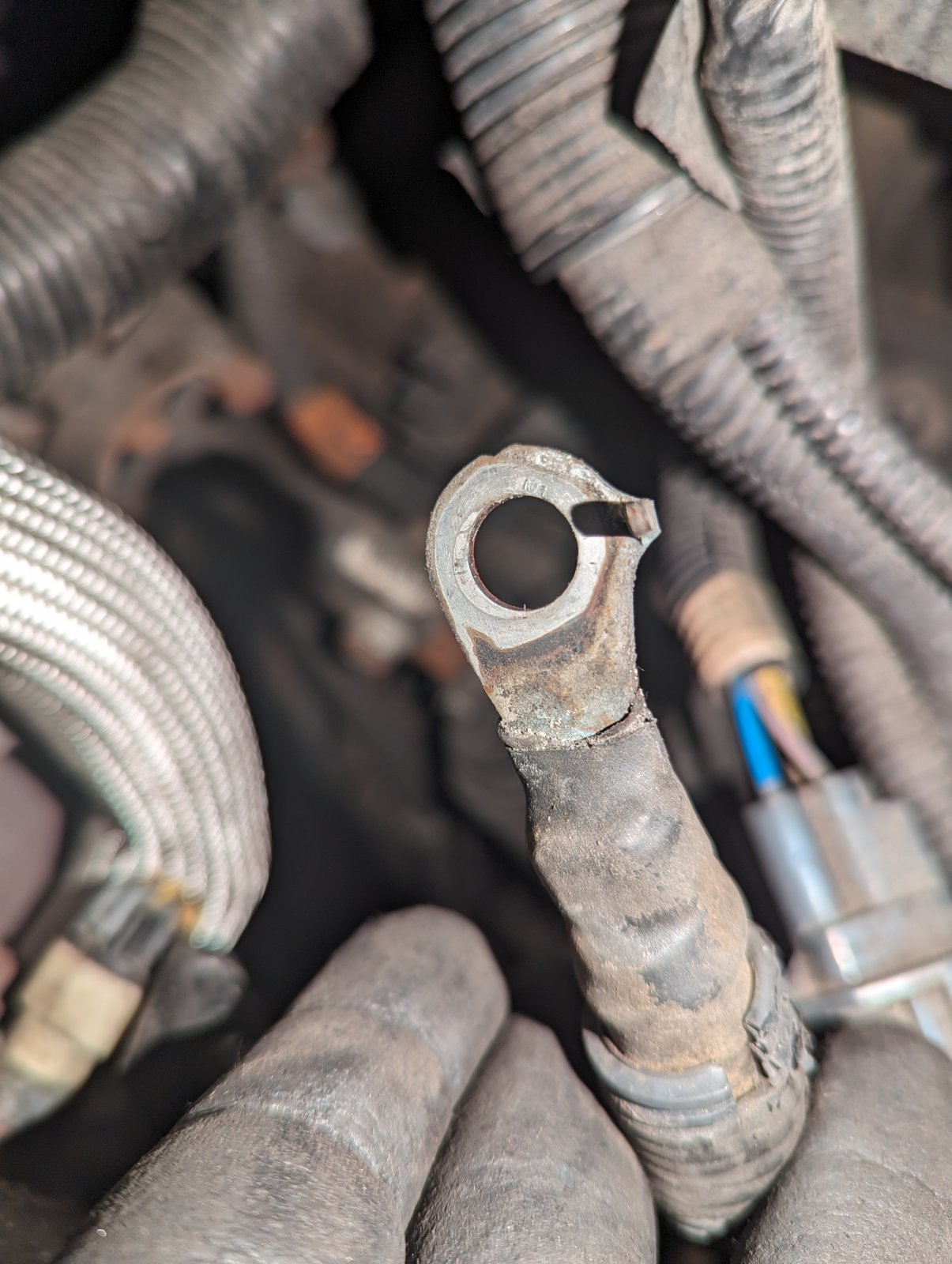

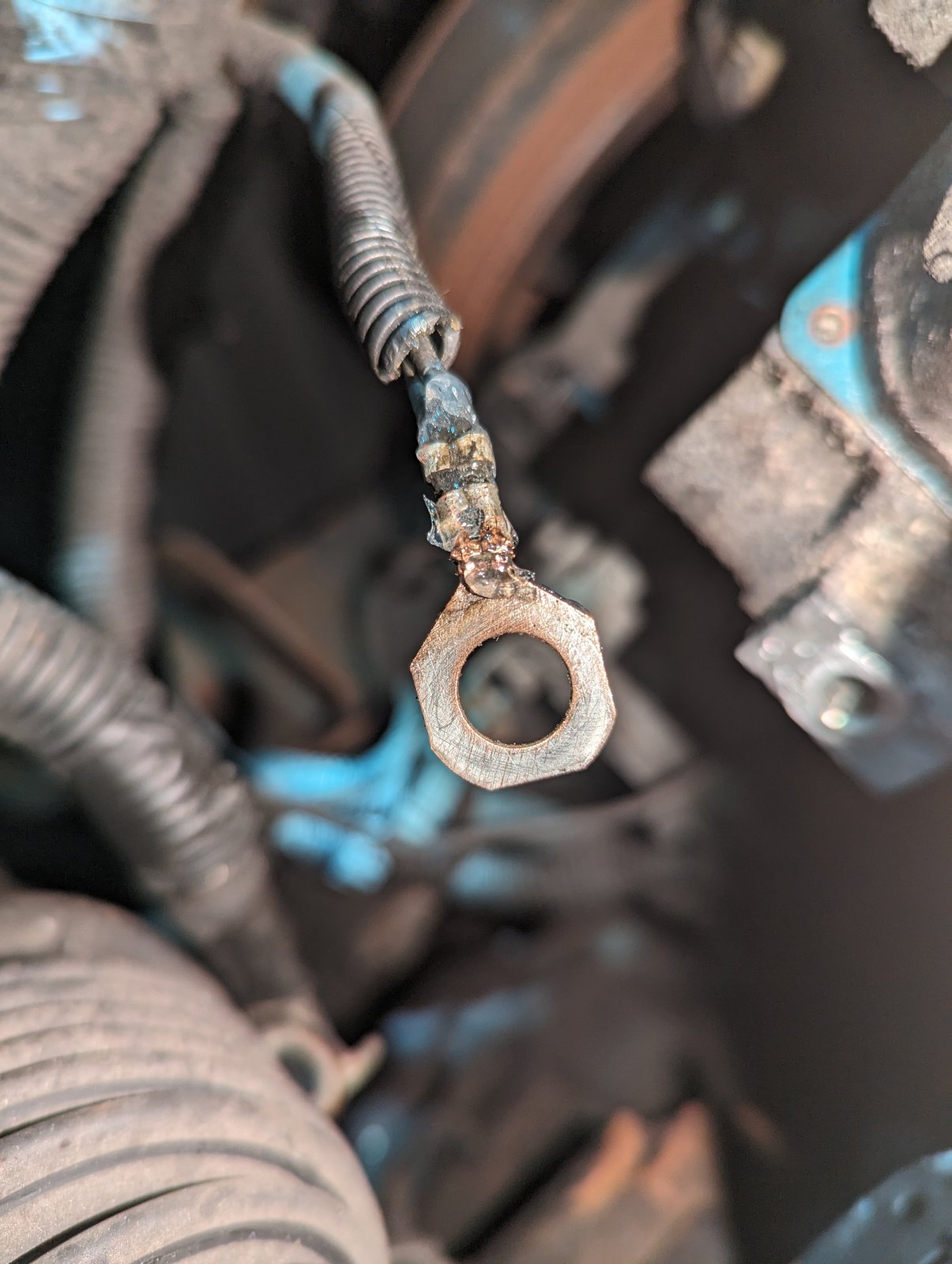

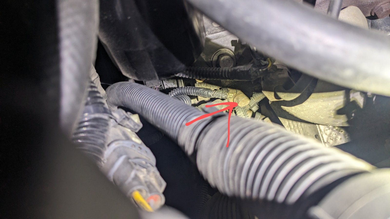

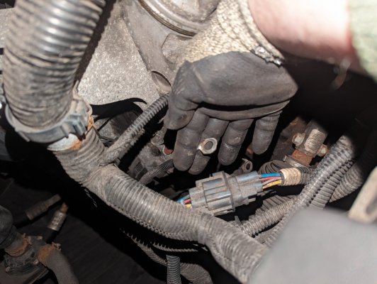

i did finally get a chance to get a pic of the ground cable block attachment point that seems to be a pretty common problem with all these year trucks, not just the hybrid ones and especially up north. it's a pretty big deal as it's the block and driver side coil pack ground point, this pic is looking straight down from the #1 plug front drivers side. it's worth taking off and cleaning if you haven't even thou I know you've made one. I keep coming back to grounds cause I've seen them do so many random things.
Ok, I will give a shot tomorrow. I ordered some sockets and torque ratchet. I will let you know how it went. By the way what about the opposite side of this cable where does it go??? Maybe I should clean it too.
you know, I'm not sure. I always figured it ran to the neg battery terminal. but I'll have to take a look.

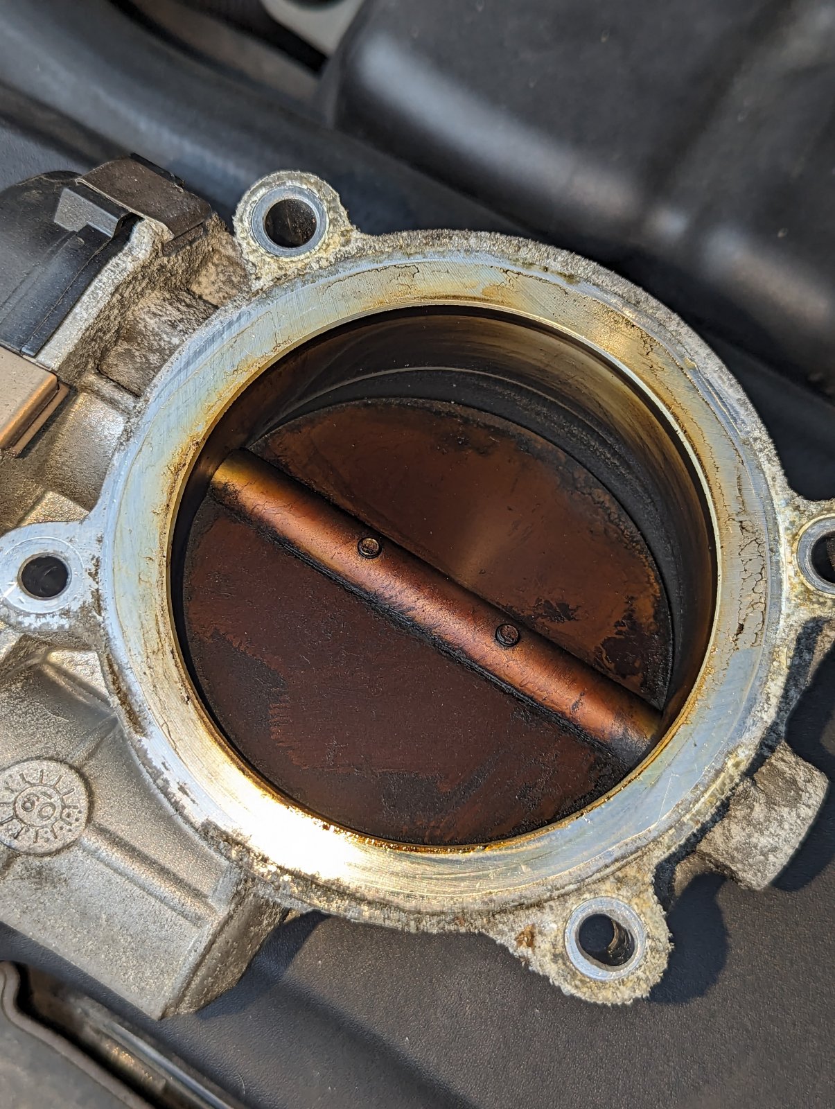

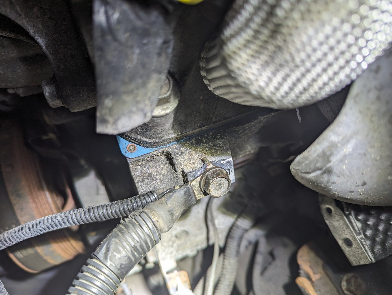

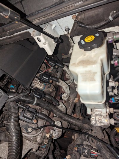

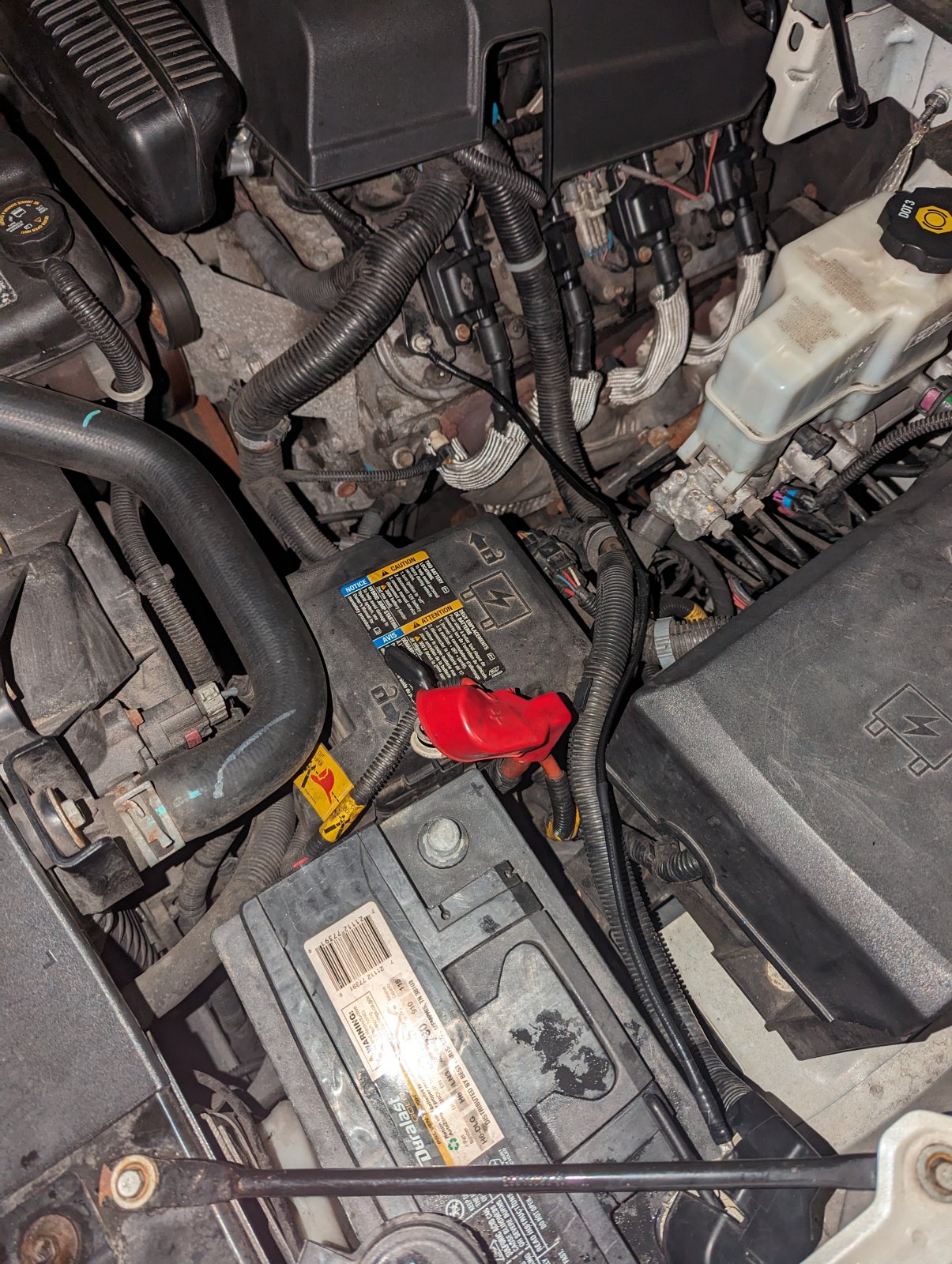

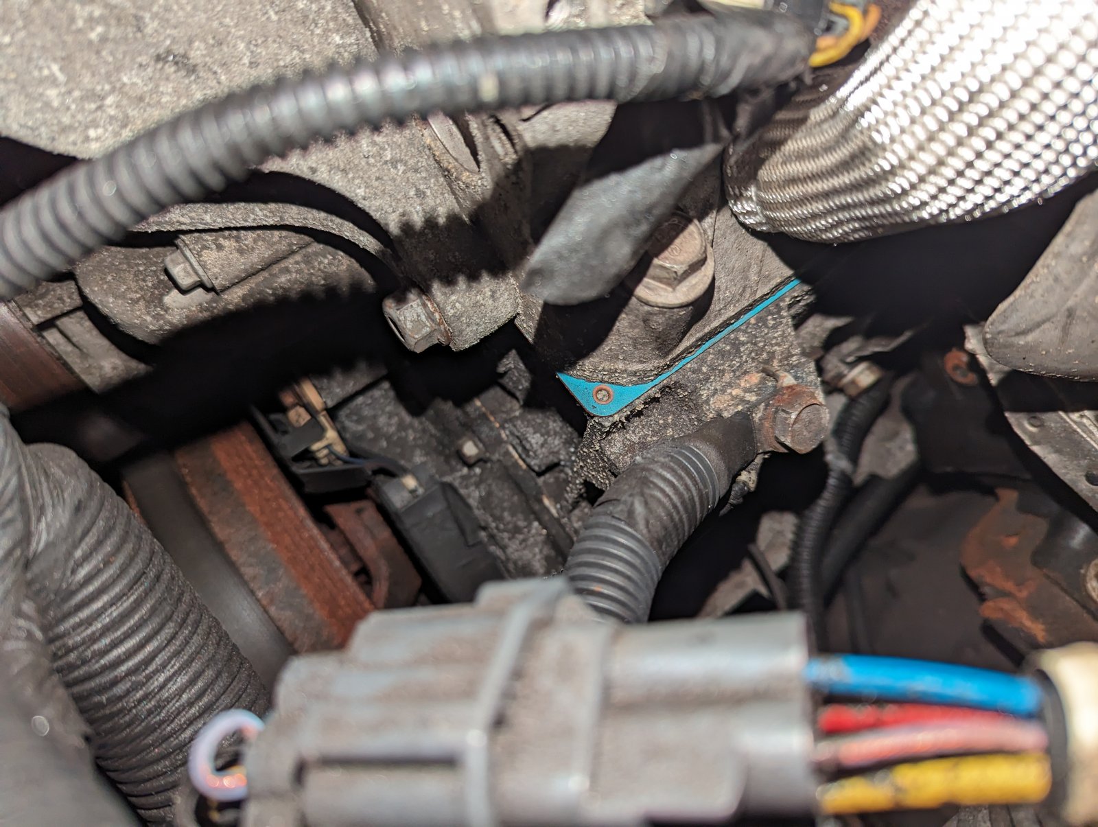

Ok, what is done today: removed block to firewall my auxiliary cable, wiggled mash ground cable, resecured it's grounding positioning on firewall, had loose bolt. Managed to achieve 10v on the system. Still had issues with Stabilitrack. I run cable from block to the negative terminal of the battery, checked brake fluid tank, maked sure it's tight, checked it's sensor and connector. Disconnected and reconnected 4 coils on driver side. Drove it with Stabilitrack around the block, I had to move vehicle anyway, tomorrow is street cleaning. After I parked, upon checking obd, I had 14.2 volts in th system. Got check engine light, that is something new. Stabilitrack still not functioning. I disconnected battery negative terminal and left it till tomorrow. I will order new brake pedal sensor and try it again.
P.S. I couldn't even move that ground bolt , it's so frozen I would need a impact gun. Brake pedal sensor was replaced like 8 months ago.

man that bolt shouldn't be that tight. mine wasn't when I cleaned mine. but I was under the truck doing a water pump replacement. so I could reach up for good access.
does leave me wondering if it's tight because of corrosion and rusted up making a bad electric connection. if you look close there's a smaller wire behind the big wire on that bolt, that's the ground wire for the coil packs on that side. you probably don't have the tools and terminals handy to just cut the wires and crimp on new terminals and move them to a fresh near by bolt. my worry is if you could get an impact on that bolt that it would snap before coming loose.

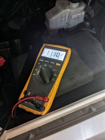

Ok hopefully I won't get sick after this. It's been hard. But I did it. I heated bolt with torch lighter and managed to undo it. I cleaned terminals also I slightly sended them for better contact, also I sended the bolt head and it's washer. I added some extra ground cables. And relocated that mesh cable on firewall. Also I changed some coils. Still misfire. I added some dialectical grease on those grounding wires and I also sended down it's mounting place on a block.

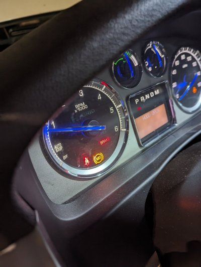

After that I got new stuff. Usually Stabilitrack appeared only when I pressed brake pedal. Now even how long would I keep battery disconnected it would come up right there as soon as I start vehicle. Also I checked some fuses for abs, they seemed to be fine. I checked level of DOT3 it fine, checked and cleaned sensor connector, that not an issue. I tried disconnecting those hoses first one on a top, which clicked back with no issues and than the bottom one. My battery is 10v I managed to boost it to 11.65, but when I removed jumper cable it started to stop 20 mamo per second. That's a lot. I need a mechanic shop ASAP. SOMETHING IS WRONG. How come I parked and this thing just happened next morning. WTF. I HAD A CHANCE TO DROP THIS VEHICLE LAST WEEK ON FRIDAY, BUT MY WIFE HAD DIFFERENT PLANS , SHE CALLED ME ABOUT ASAP HELP WHEN I WAS AT THE DOOR OF DEALERSHIP. Now I'm stuck with this Cadillac. I cannot go anywhere. All shops closed, NEW YEAR EVE. Nobody would take it till next middle of the week.
