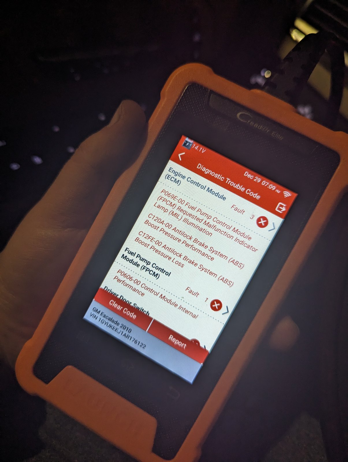

Interesting. Now I have fuel pump ⛽

and it's still missing? ugh.
it looks like you got it nice and clean.
does it still sound the same as in that video?
Truck running with 14.2 volts. That's still missing I will do that 7 cylinder tomorrow. It's really dark and cold+ rain

has the miss code for a individual cylinder shown up yet since the new wires, or just the p0300 one that isn't specific.
all those other codes not really related to the miss are a mystery to me. wish I knew if it was really all related or just coincidence

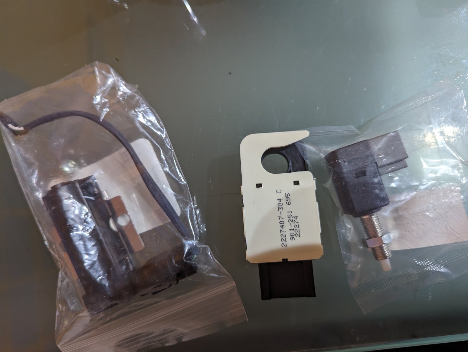

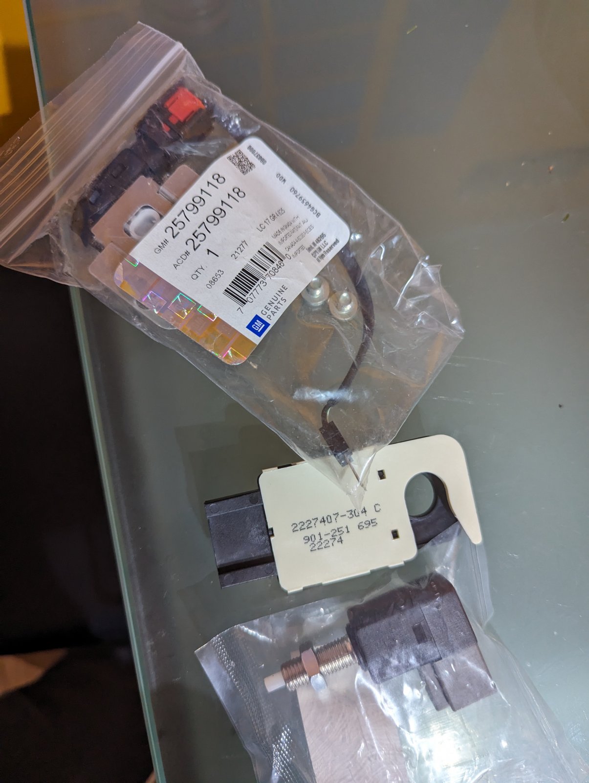

I mean I can't drive faster, just because it is not safe. I bought some parts. Let's see what I can do. Maybe some switches are bad.

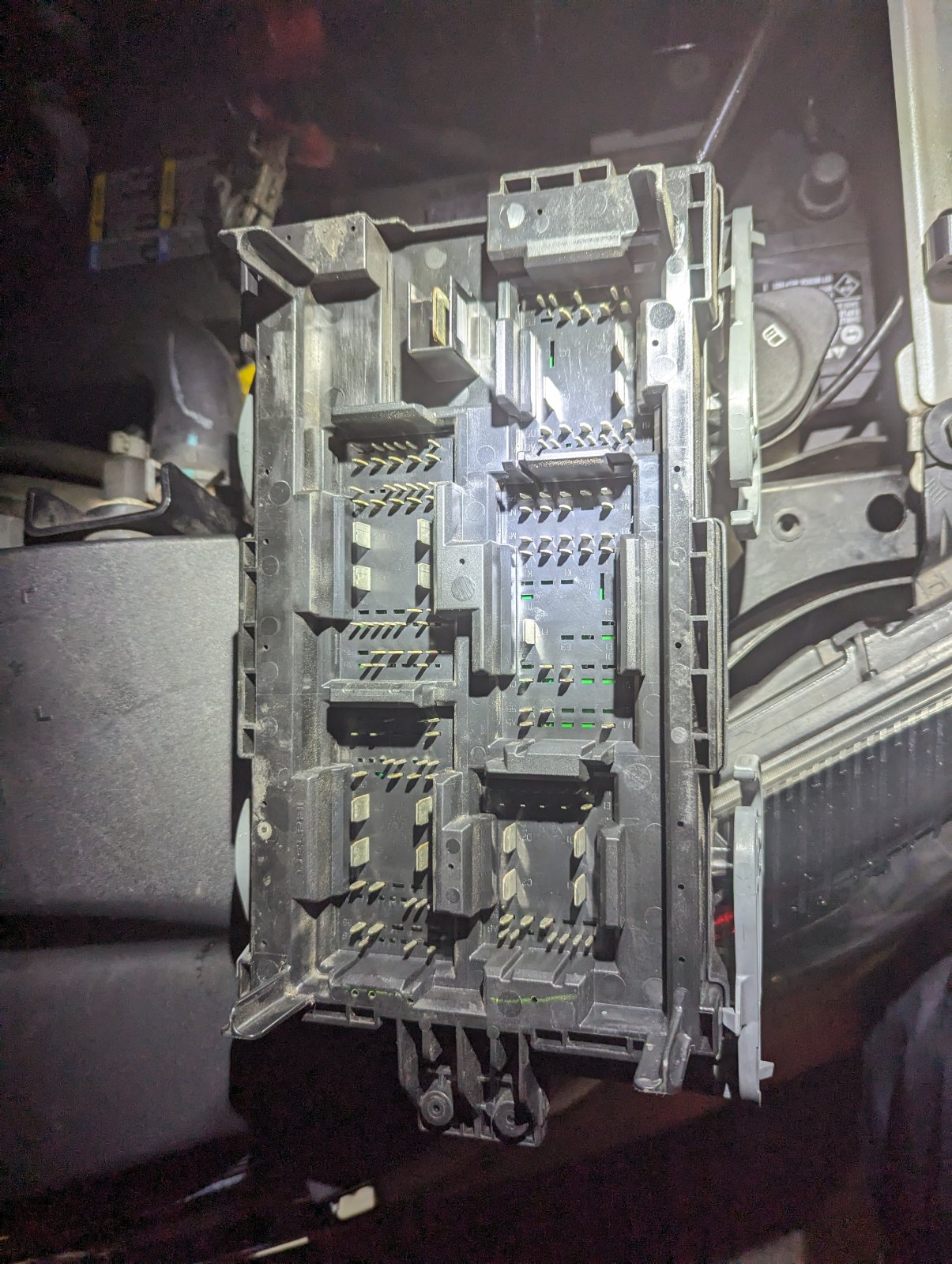

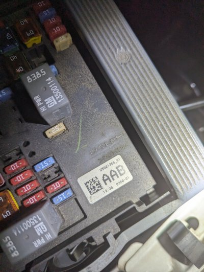

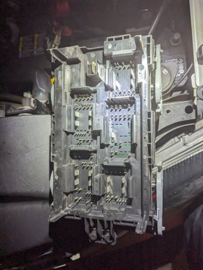

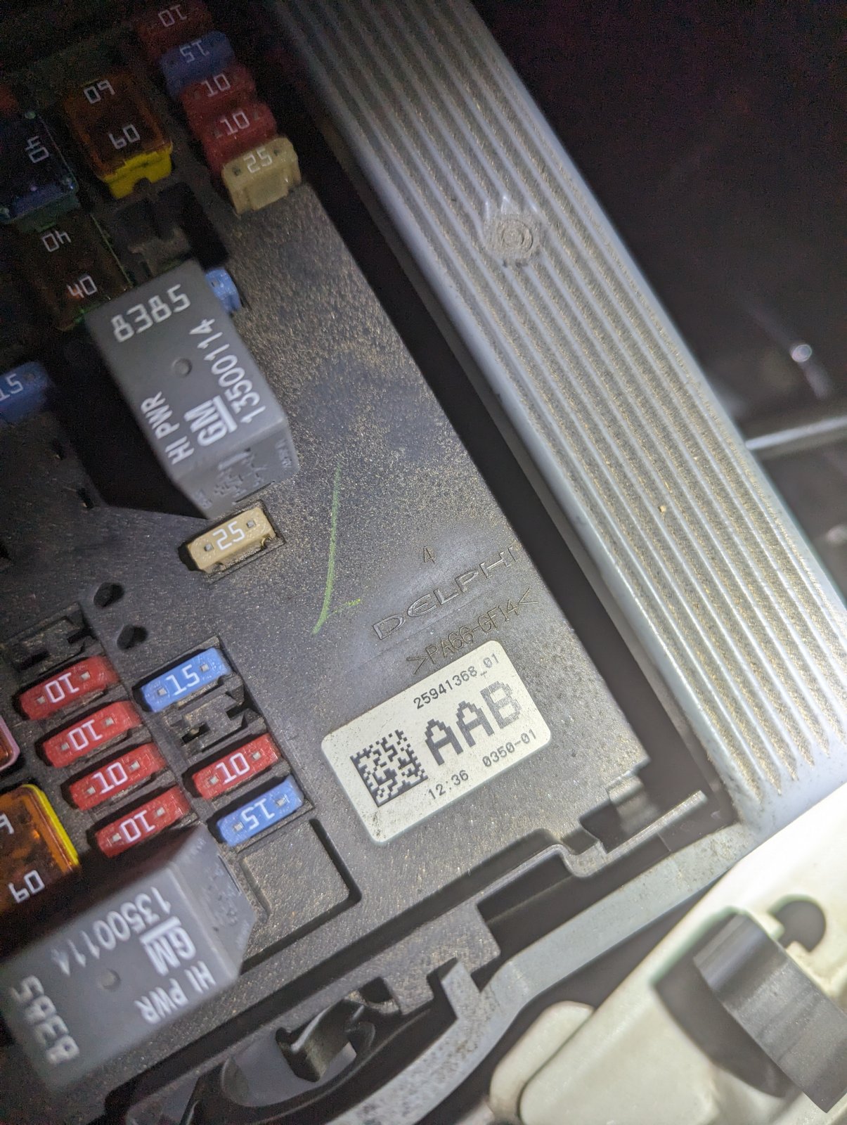

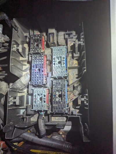

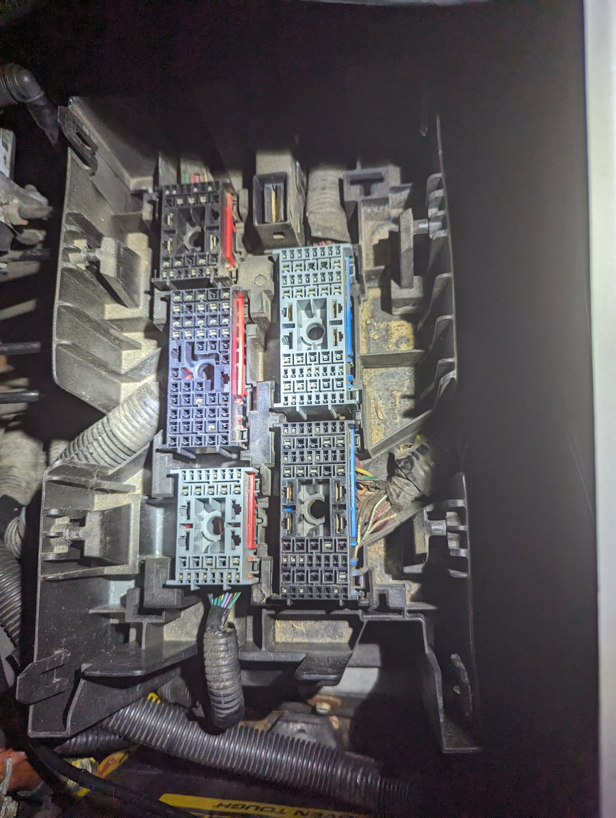

Okay so what I've done. I removed the fuse panel top of it. Put it back together again .Connected the battery terminals and just started right away. I got 15.6 volts in the system. After a minute or two it dropped two 14.2 volts, engine is idling like new. Literally like new. Nothing really wrong with it. This truck is a mystery for me. I still having that stability track day. I cannot program the ABS unit. I cannot do anything. I need tech to win I think. I bought one long time ago but it was a Chinese knockoff and it was not working at all. So far I don't have a boost. My brake pedal is really soft. I don't want to mess with it. I noticed that board itself. It's not original. It's a delphi. Some blocks are Delphi as well. Also, I noticed a lot of corrosion on the ABS control unit work at the picture.

looks like you've definitely found something worth cleaning in that fuse box. I've never had mine apart, did you just flip the 2 levers and pull? I should probably check mine too even thou I don't get the corrosion you get.
yeah, I'm not good on the programming modules, I believe that sounds right thou. there's a 100 page thread around here somewhere. it sounds hard to get the China one to work. I believe it only works with a old windows xp laptop. but the non China is very expensive. might be better to just pay a dealer to flash it. I wouldn't expect them to charge more than an hour labor?
there's some kinda brake pressure calibration these trucks need, I messed around with a scanner once when I first got mine and dumped all the pressure out of the booster and it felt like crap, long peddle and no stopping power, I belt it was throwing a code of some sort too, but I don't remember exactly. it might be what yours feels like? like old manual brakes in a 50s farm truck lol. I used the scanner to run the automatic brake bleeder function, but I didn't actually open the bleeders and make a mess, just did what it said on the screen. it runs thru a bunch of tests and makes you pump the brake pedal a few times, and when it was done, it worked again. since you need power assist even when the engine isn't running these have an accumulator and pumps up to like 2500psi or something like that.. so when you hit the peddle, that's your assist. it also needs to know the peddle travel amount for the regen battery charging and all that stuff too.
the braking system on these trucks is way over my head. I read about it and just hope it doesn't fail haha
glad you're making progress thou

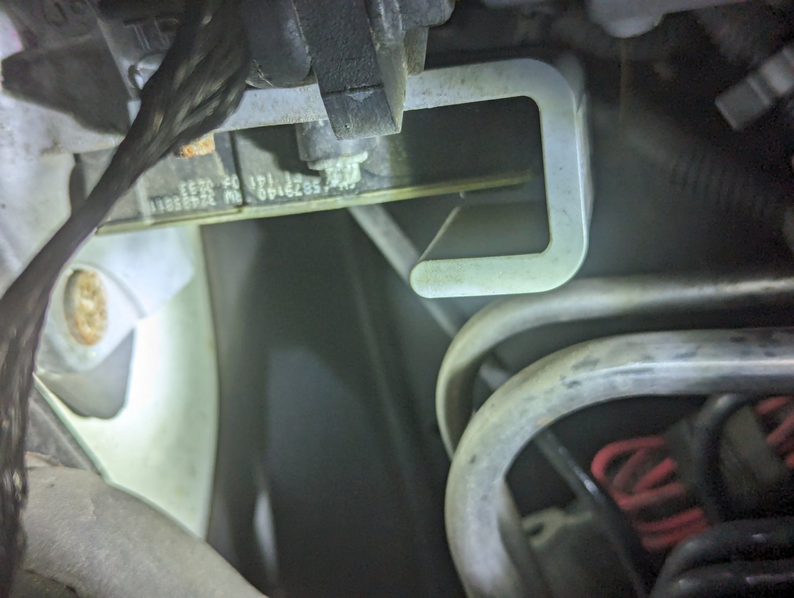

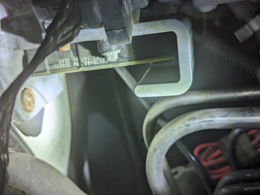

Well I would not call it a progress. More and more I lean to only one thing defective ABS module. I really have a big trouble replacing that brake light switch on brake pedal. It's not looking like regular GM trucks. Mine is so stiff that I can't do a thing.also I would replace brake pedal position sensor. If that is not going to help I would take that fuse box apart. And if that not going to work well 2 ways either look for used ABS module or junk the truck.

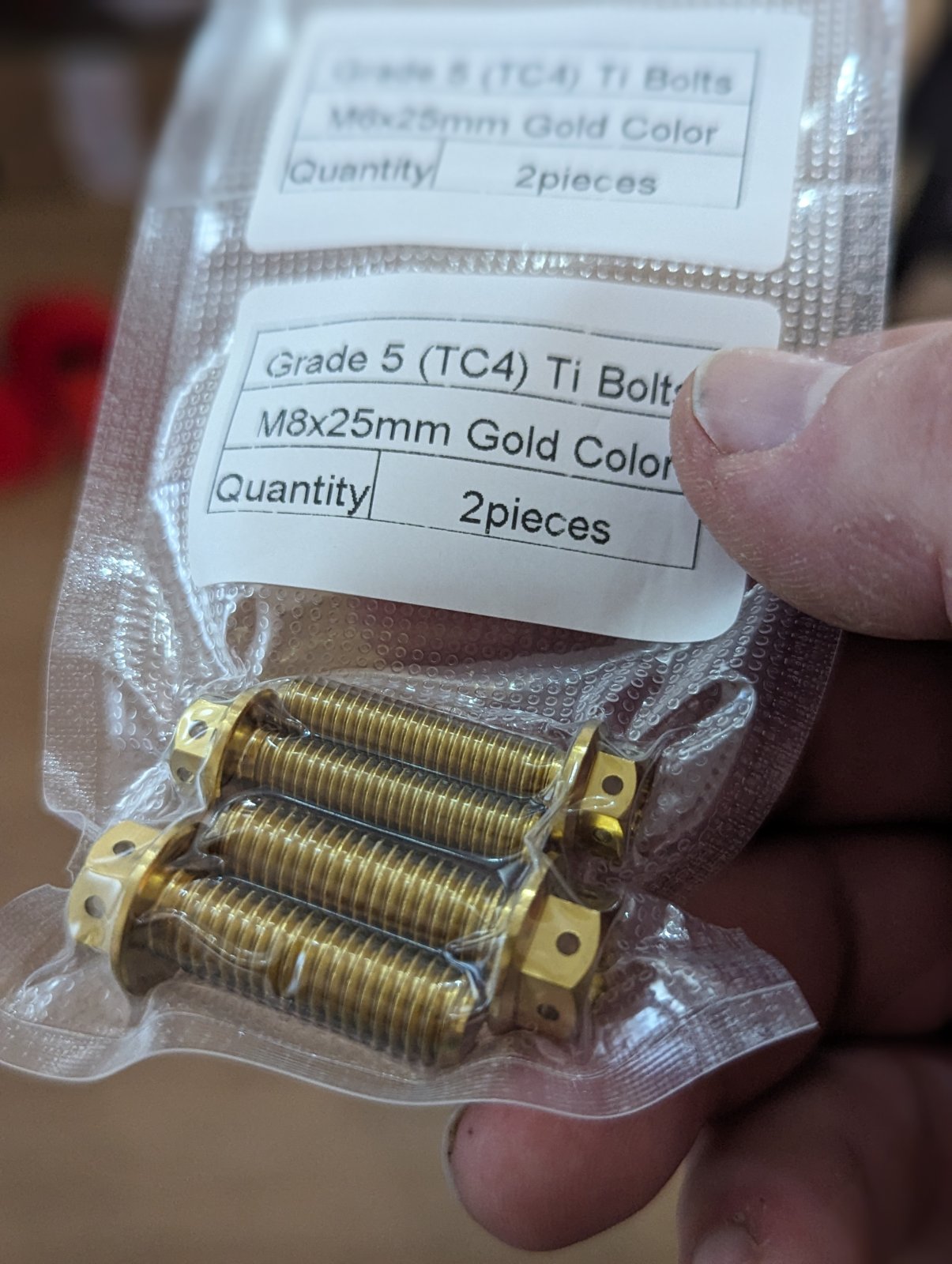

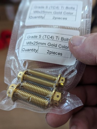

That's m8x25, coil bolt holder. Now I need to get 16 of them. Truck is at the shop, no news for now
