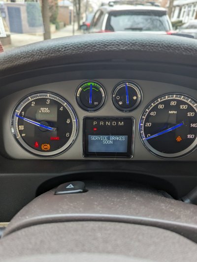

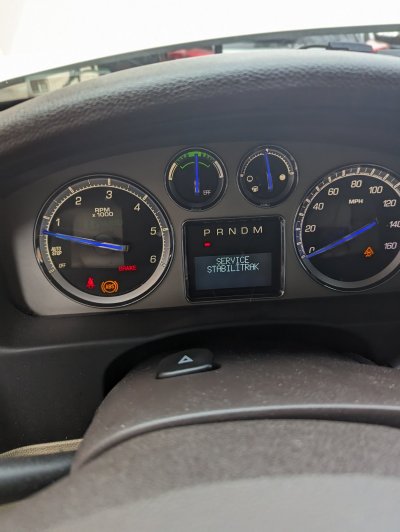

I asked my mechanic to fix brakes issues. Also he managed to get to the 6 and 8 and replaced coils. Unfortunately brakes still not good. I drove to his shop, I would say it is not the best experience. Tomorrow I am picking it up, and would unload from my junk, take off car seats, and prepair it for sale. But before I want AAMCO to check it. I want estimate of parts and labor. Unfortunately they don't use used parts, only new. Considering aftermarket value of ABS booster it's ranging from 1200$ up to 1500$ + labor. I could assume it would be around 2-3k. If that is true I would dump it for as much as I can. Also I called that dealership that sold me this junk, they say that I have extended warranty. That lasted only from November 2022 till August 2023. Not even a year, and which costed me 2500$. I will try to work with them. Maybe they would take this truck away. I'm ready to pay for towing anywhere, just I don't want to deal with it anymore. I'm so tired you can't even imagine. For that time I owned I made barely 9k miles and dumped around 8 k $ in it. That's financial mistake.
sorry it's given you so much of a run around. that's a lot of money to put into a used truck.
I've only read one other tread in my searching about the electronic brake module going out. I don't remember the deatils. but I think it was a high mileage truck, like 300k.
I don't blame you for wanting to ditch it and get something else.

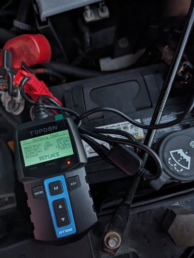

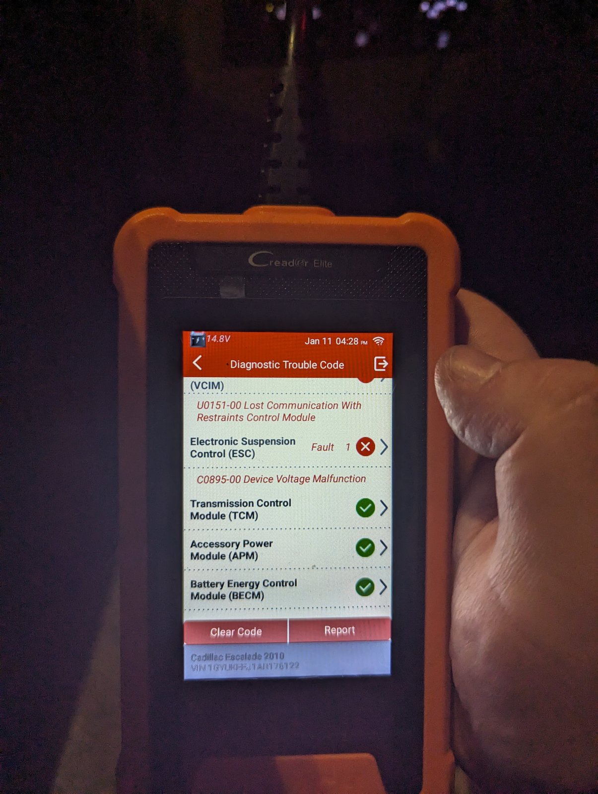

I got new H6 battery just now. From AutoZone, under warranty. I bought some tester and it was pretty bad . Right after I installed it and pressed brake pedal I got same code for no boost. Plus I got a tons of new stuff . I dropped code but I still have issues. Same light is on. So far I lean to replacement of booster. Only thing is to find right part.

what is the charging voltage 14.3-14.9v is where you want it at when it's running.. it should be at that all the time...
the new battery was faulty?

That duralast gold that I purchased a year ago was faulty. I replaced it under warranty for new one. It's holding charge steady. No self discharge. 12.6 on new battery. I tested cranking, and charging so far 14.6 and steady. So I doubt that is the bad battery. My module is faulty. I had a big hope for battery but unfortunately that is not it. I will try to obtain negative terminal from Rock Auto and try to replace it. So far I get too deep in this truck so probably I would be able to remove bumper and unbolt that connector. Only thing I haven't tried, is to simulate frame to body connection. If negative terminal is bad so I have 2 bad connections on engine block and frame. I will try to thow a wire to a frame and directly to negative terminal. We'll see.

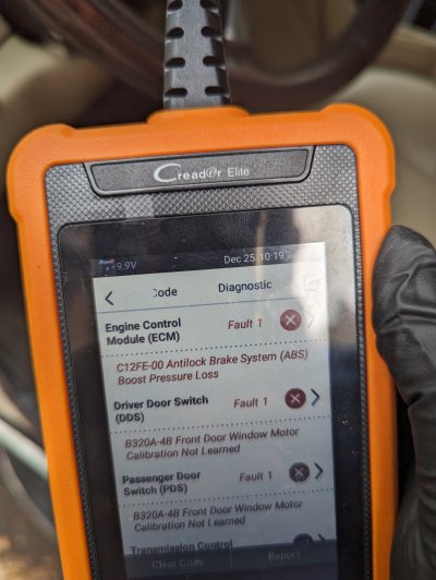

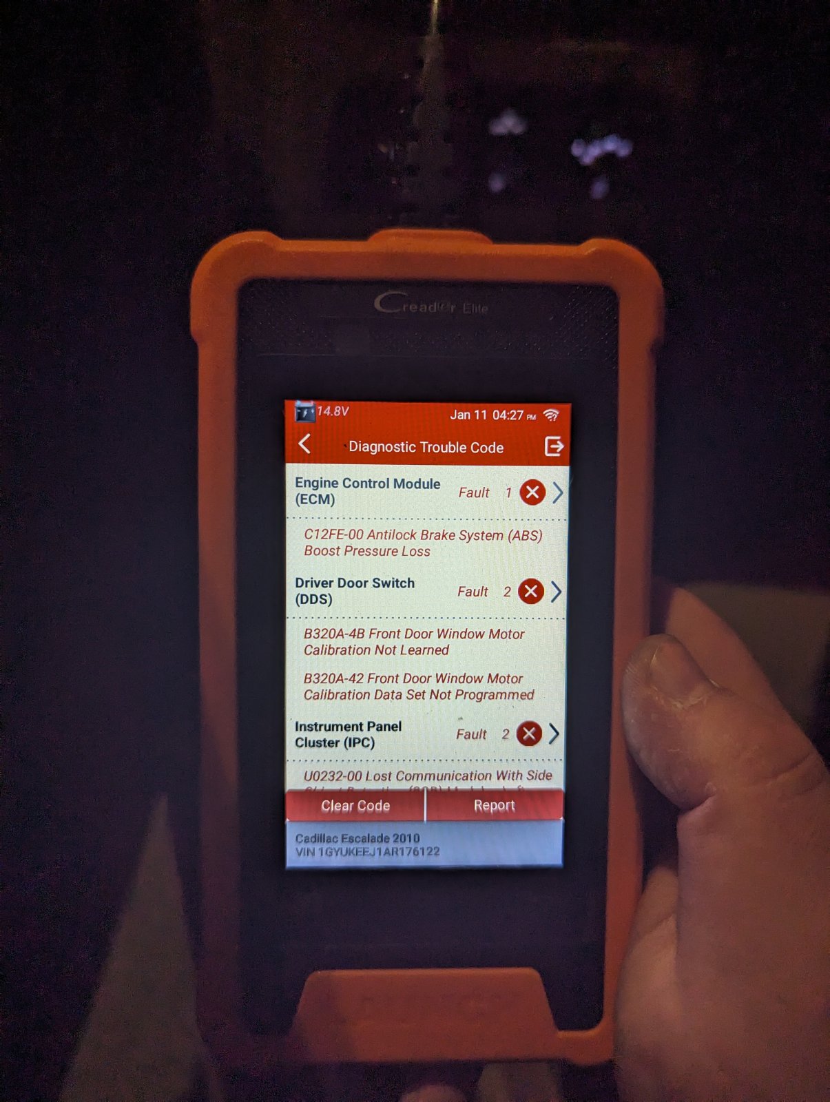

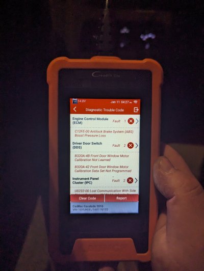

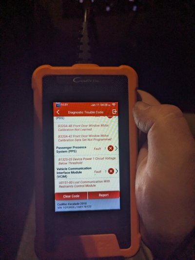

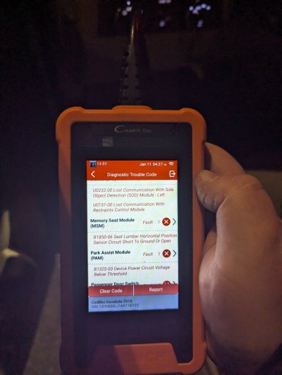

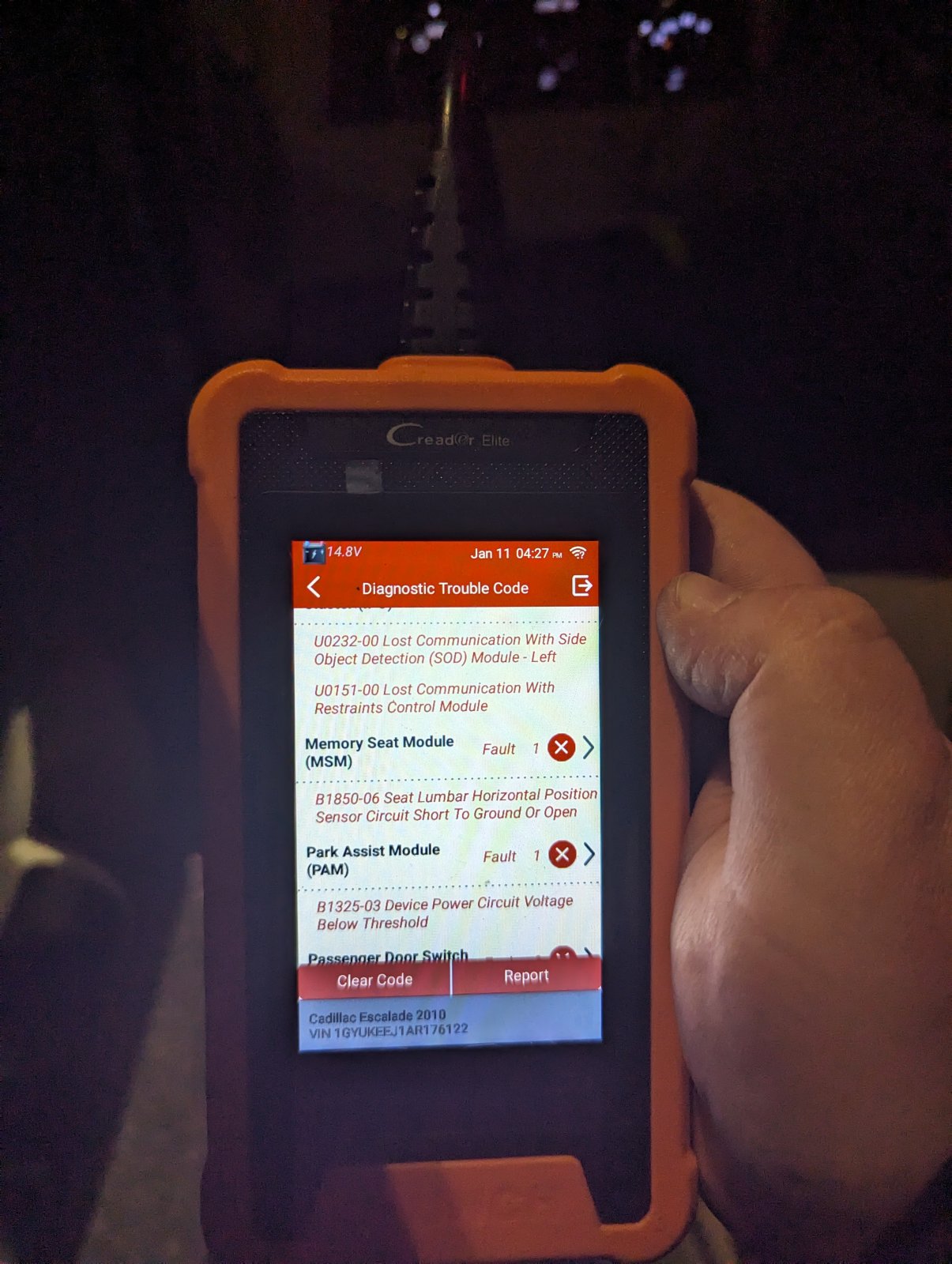

the common thing on all these codes seem to be voltage below threshold and calibration lost, most likely they lost cal from lost voltage?
seems like a voltage issue to me. have you been able to check the volt at the abs pump motor? the one that builds the boost that's missing?

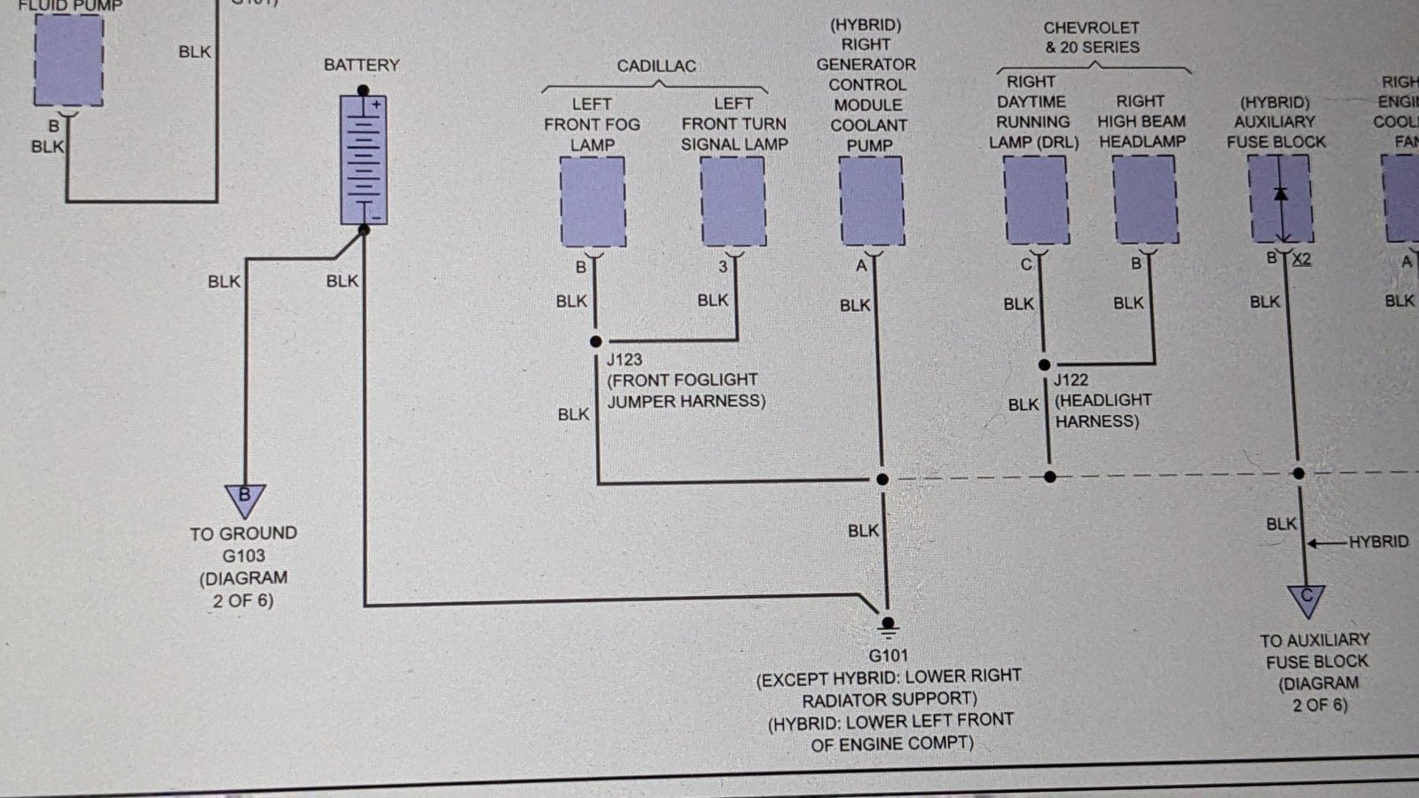

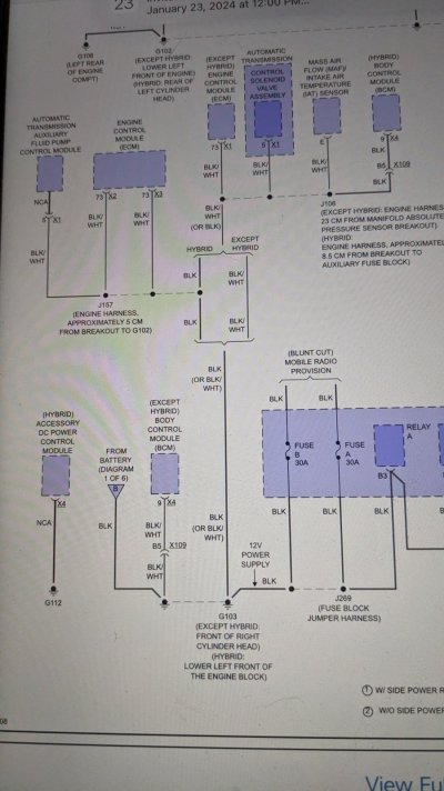

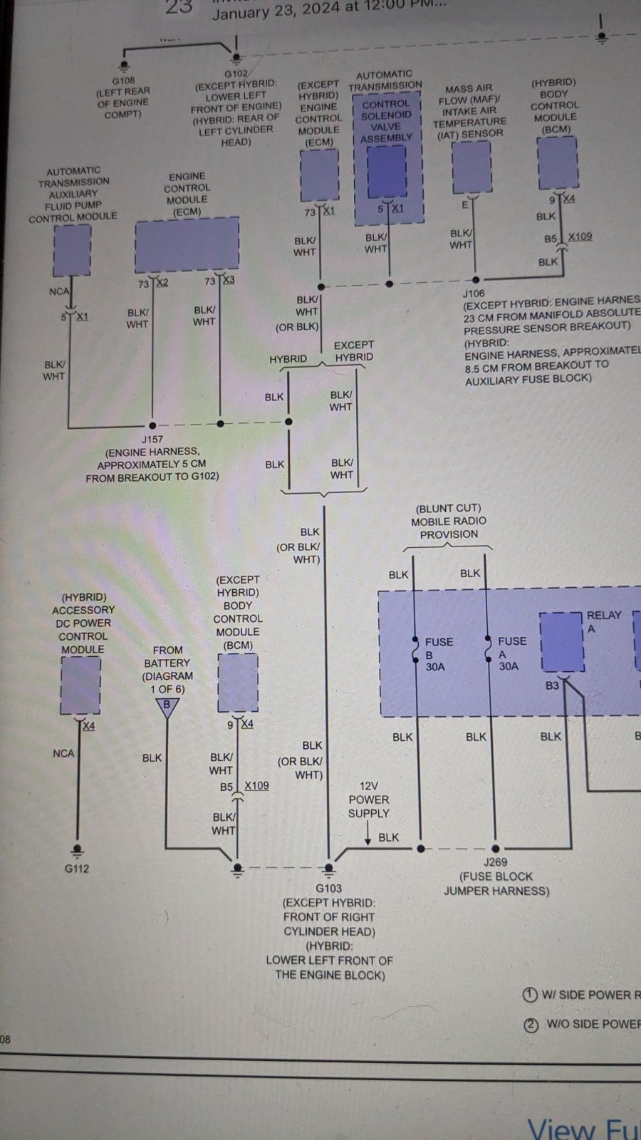

not the clearest Pic, but I'm like. 90% sure this is the hybrid ebcm wiring. it's all I can find on it.
you could check for voltage at fuse 61 ABS1 40A and fuse 59 ABS2 60A and see if the voltage crashes when you step on the brake to load the circuit there. much harder to check at the plug on the ebcm, I know it's a nightmare to get to. but it's pin 1 and 25 of it. looks like ground is pin 13 and 38 they tie together and then run to ground point g300. that might be worth cleaning too. it's #3 in the location pic.

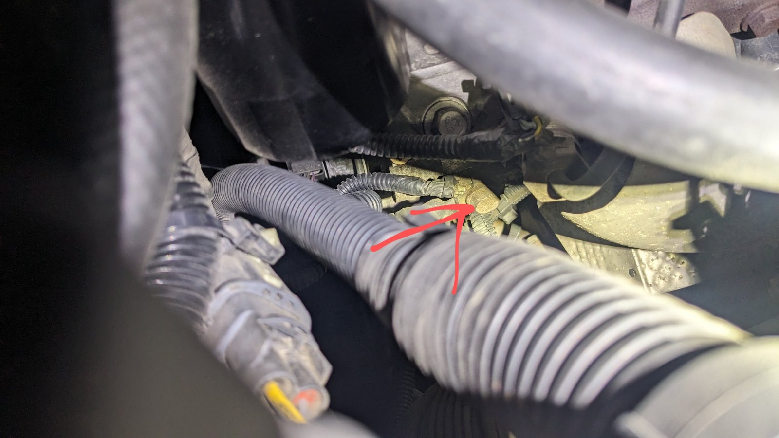

take some photos of you replacing it I need to do mine my self but i'm clueless as to where the tiny wire goes.. i know it goes under radiator somewhere
j91z28d1
Feb 28, 2022
4,603
5,863

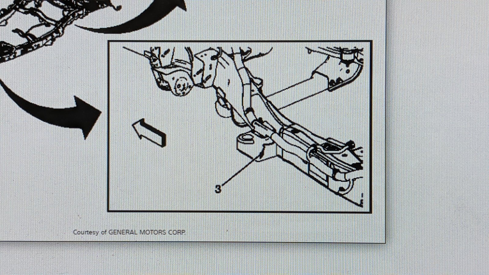

I think you're looking for g103 on this?

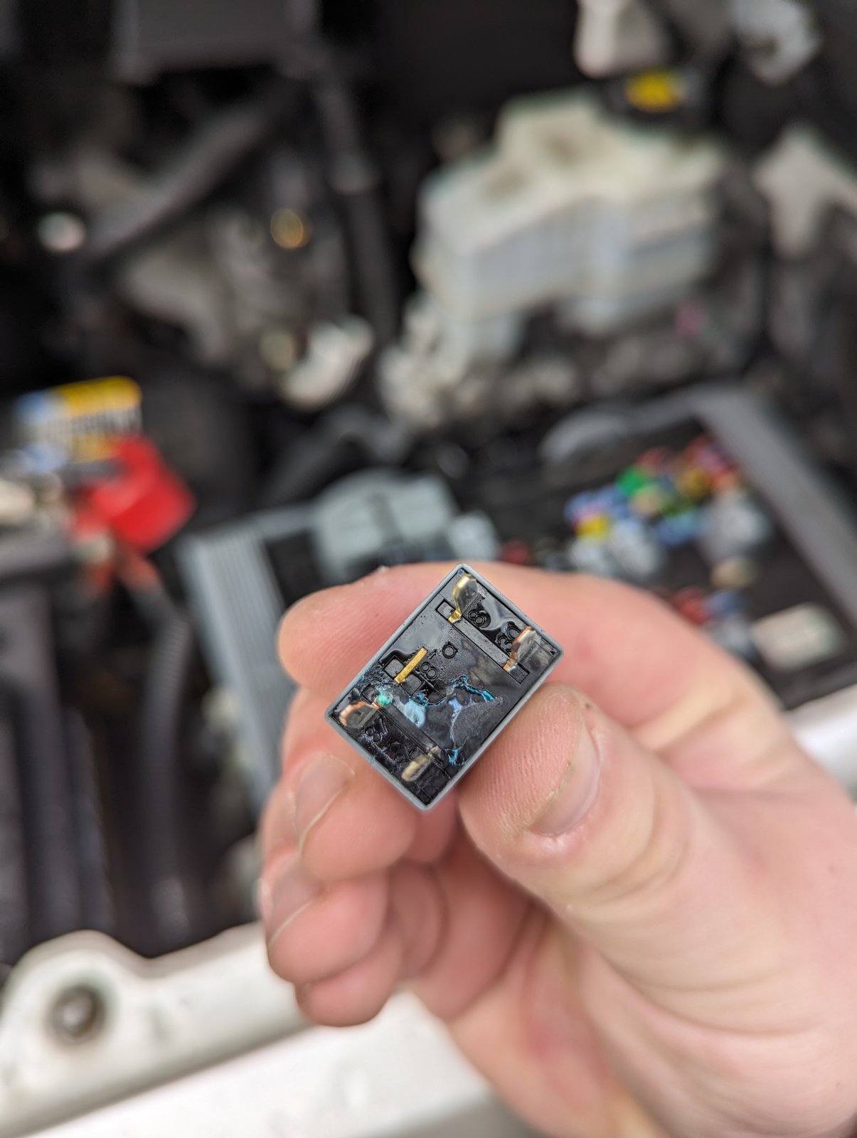

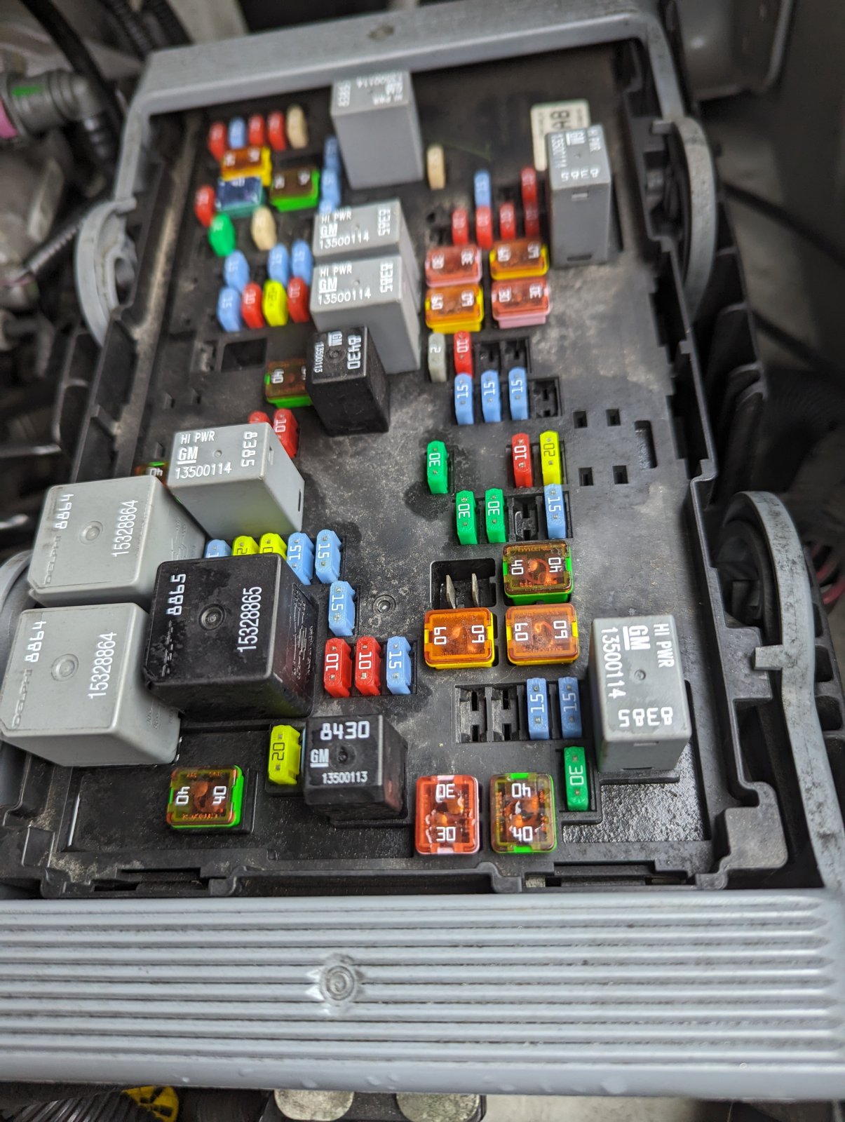

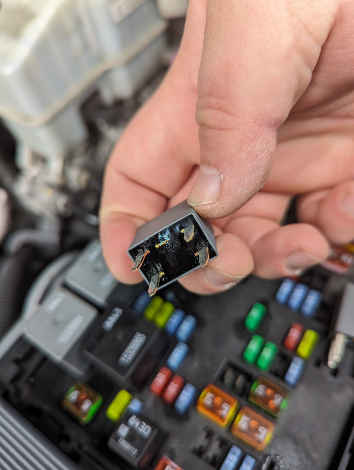

Ok. Ok. Houston, we have a problem. Yesterday was pretty rainy and heavy winds. I have a huge gap in hood. So wind blew under one direction. Got flooded fuse box. Upon inspection I found some bad relays . Pretty corroded. I doubt that it happened only for one night. I already ordered 5 of them from Rock Auto. Unfortunately I can't find where to get that negative battery cable. I don't have part number for it. I know it it mounts somewhere under front left or right tow hook. I assume that is for frame connection. As far as I get it. One line goes to engine, which goes to cabin by connecting block to firewall through that mash cable, that negative thin cable goes to a frame and should mount at tow hook . I can simulate frame to block connection simply by taping into a frame, I got some terminals and will try to do something. But that is going to be next week. I been into few dealerships, well prices and rates are bad, pretty bad . New Toyota crown which I like is 40k and it's rated is 5%, used Highlander 2018 with 65k miles 27k and rates at 10%.that nuts. I need to fix this Cadillac ASAP, and try to make it on budget.

feels like you're on to something.
I believe if you lift the 2 gray levers on the fuse box, the top will come off, and you can clean everything with some contact cleaner and a soft wire brush. might even unbolt the whole thing and look at the under side too.
for the ground cable, probably have to take the battery out and maybe some plastic panels, to find that G101 ground. like maybe the inner fender liner? I had to do that to get to my fog lights. my software just says lower left front of engine compartment. looks like on the diagram that it's also a ground point for a few other things too, so it's probably worth cleaning, even thou it feels like your fuse box getting wet might be the main issue.
on a side note, I was looking around the other night in my scanner options and saw a window calibration option. I had always wondered why your scanner was showing a window lost cal fault. I didn't even know that was possible ha. but I guess it's a thing.

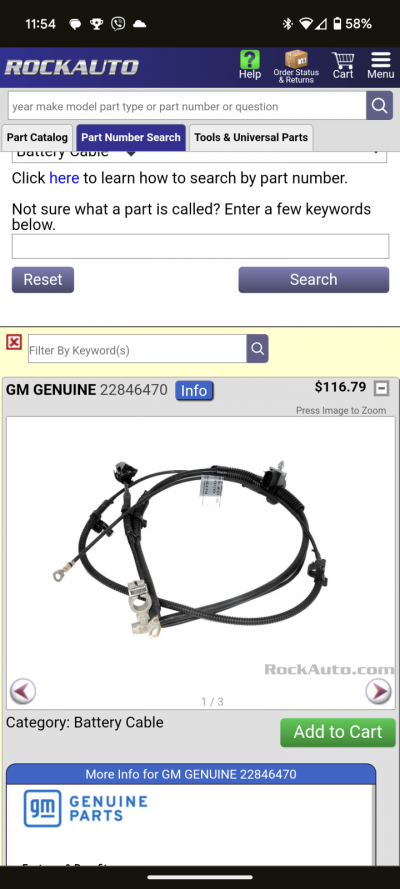

the ac Delco web site lists this for your Cady. I'm not sure it looks right and man it's expensive. you might have to stop by a dealership parts department to look it up forsure.

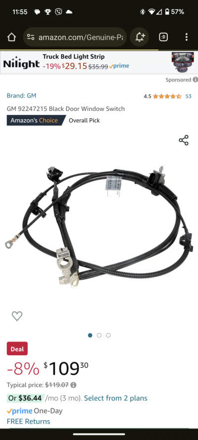

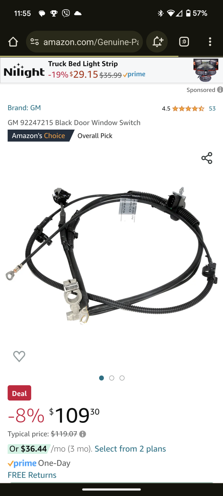

I don't think that thing is right part. Doesn't look like mine .
But good tips and few minutes on Googling gave me this.
Limited-time deal: GM 92247215 Black Door Window Switch https://a.co/d/0qWGkEn
100$ that's 3 times cheaper than on official site
Also found on Rock Auto same item.
I can make a bet if I go to eBay I would get it even cheaper. For me the really cheapest way is to make my own. I have some C terminals and also I have 6 AWG wire, I can get 2 and 4 at work. Battery terminals I can scrap from existing. Probably make my own would be better option because I would be able to tap in directly into metal, I can apply some Zink from Zink batteries so place would not be corroded anymore.
I could find that calibration thing. Probably I need another scanner.

i'll get you the part number from my cable
2008-2013 Chevy GMC caddlic hybrid negative battery cable with sensor
https://www.ebay.com/itm/115865012306?chn=ps&mkevt=1&mkcid=28 ask them for an actual photo first
