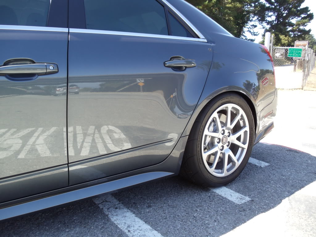

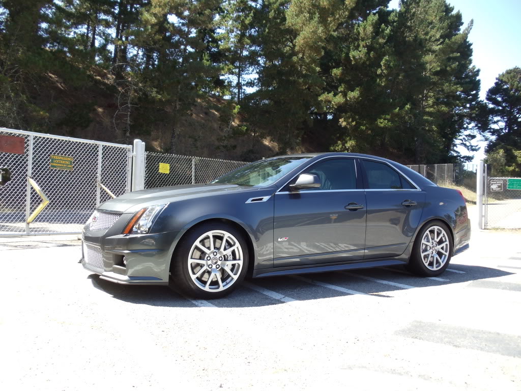

I put the coupe springs on it and sits at 27.25 from ground to fenderlip in front and on 305 35 19 drag radials in rear 27.5 inches.
Ride Im very happy with

Did you initially lower it with the coupe springs or was there another set installed first? It looks great!

eibach has sedan springs not even out yet and only lowers .6/1.0 which would make the front higher than rear. I used the coupe .9/1.1 and came out perfect.
and ride is great still.

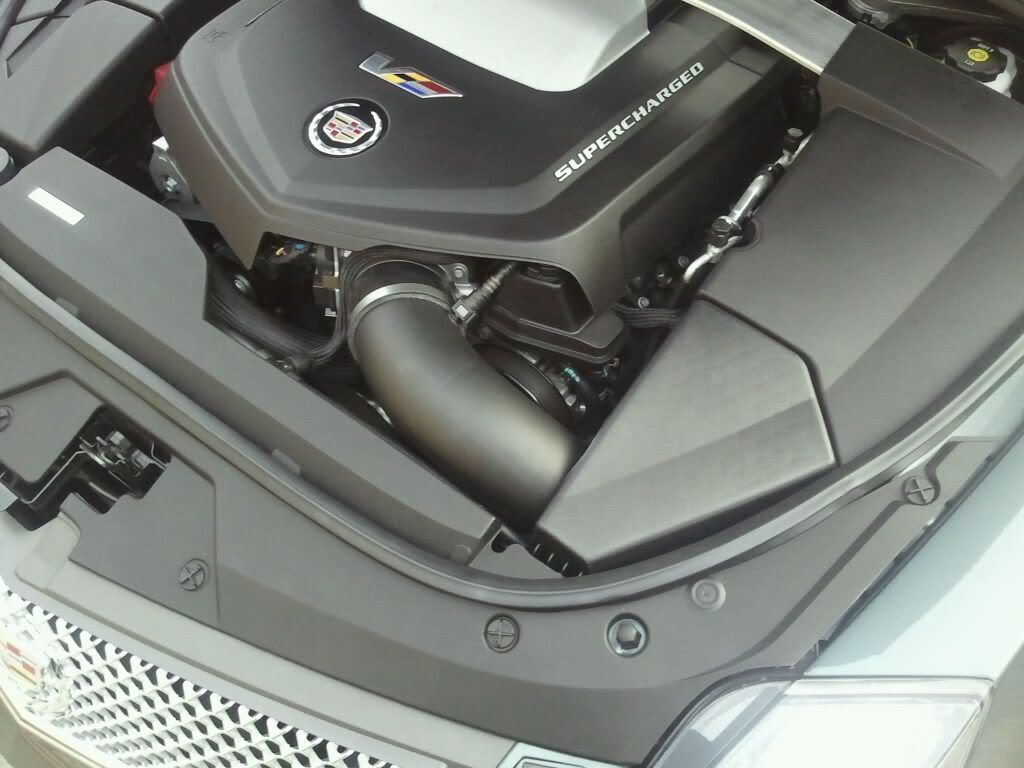

intake powdercoated to match engine/side covers

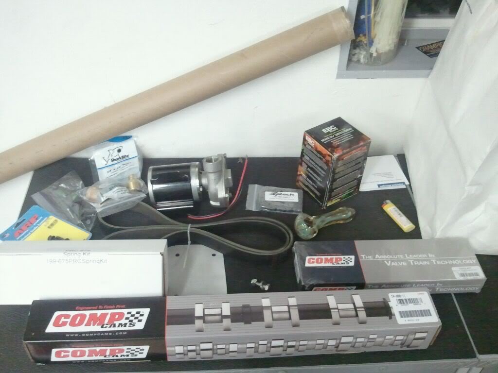

so you guys know car ran a 11.3@94 on the brakes just added a few more things
changing to a custom
LT1Z CAM
675 valve springs
Hi flow pump for hx
ebc rear pads
few other things
CIRCLE D 2800-3k triple disk stall
