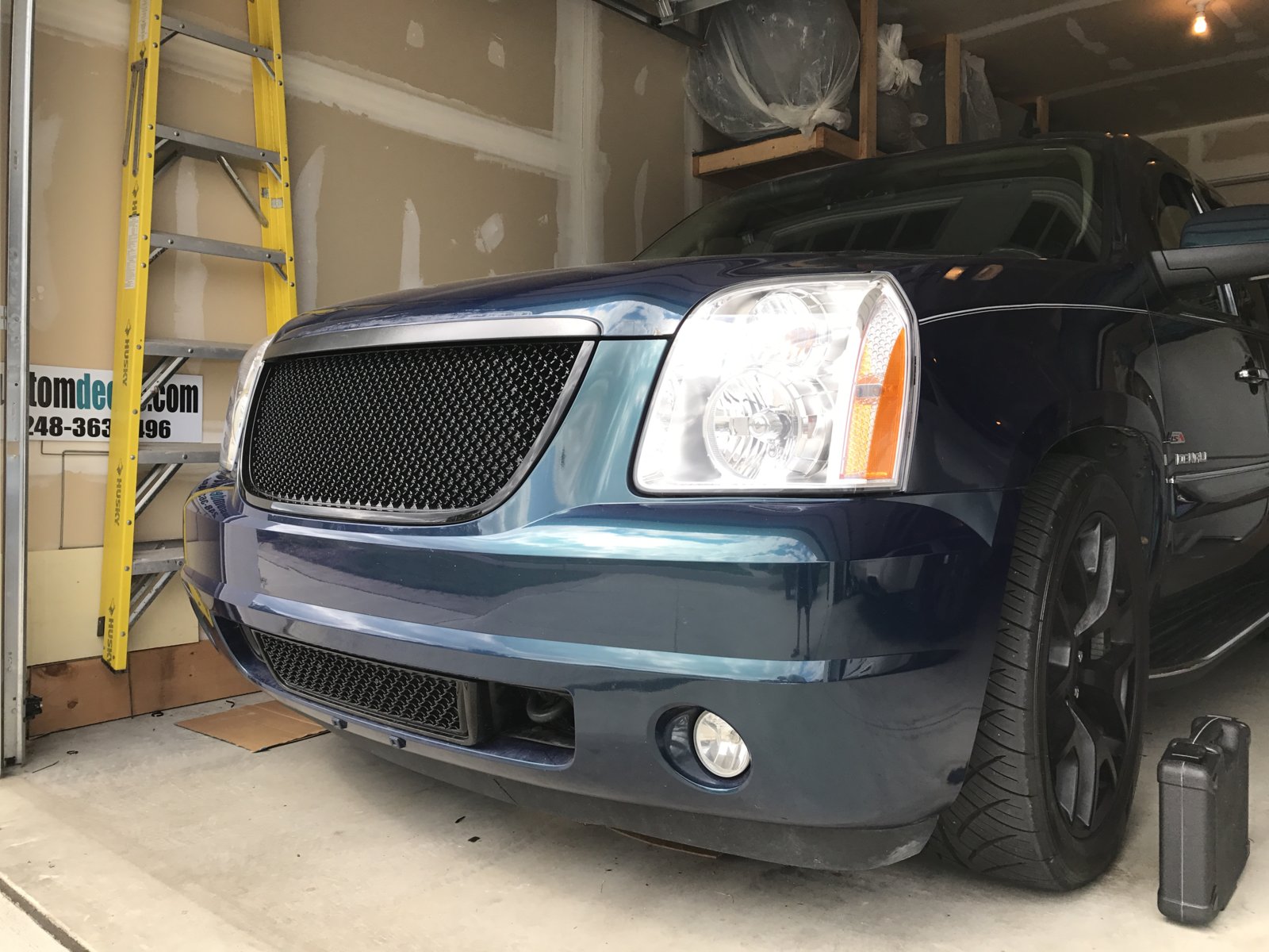

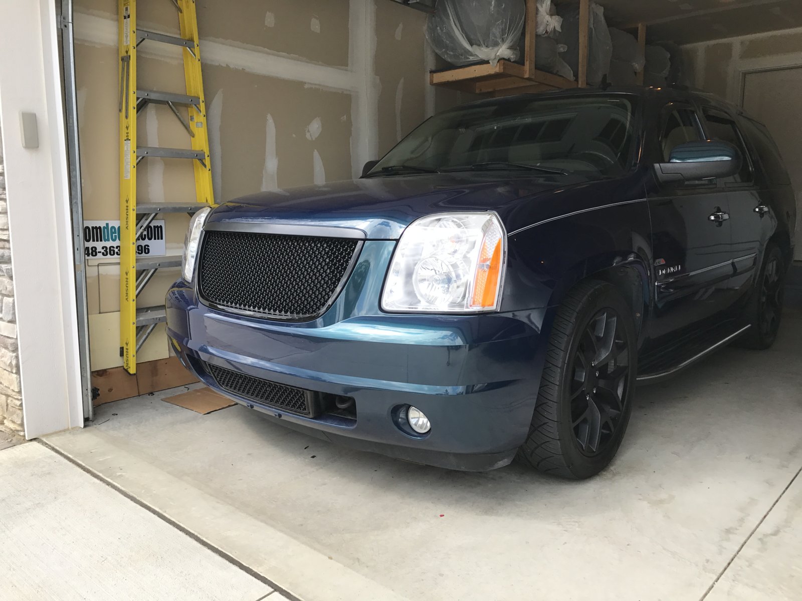

What grill combo is this?
Not 100% sure honestly... I bought it on eBay and my purchase history doesn't go back that far. There are only a few that look like that so you should be able to find it or one similar.
