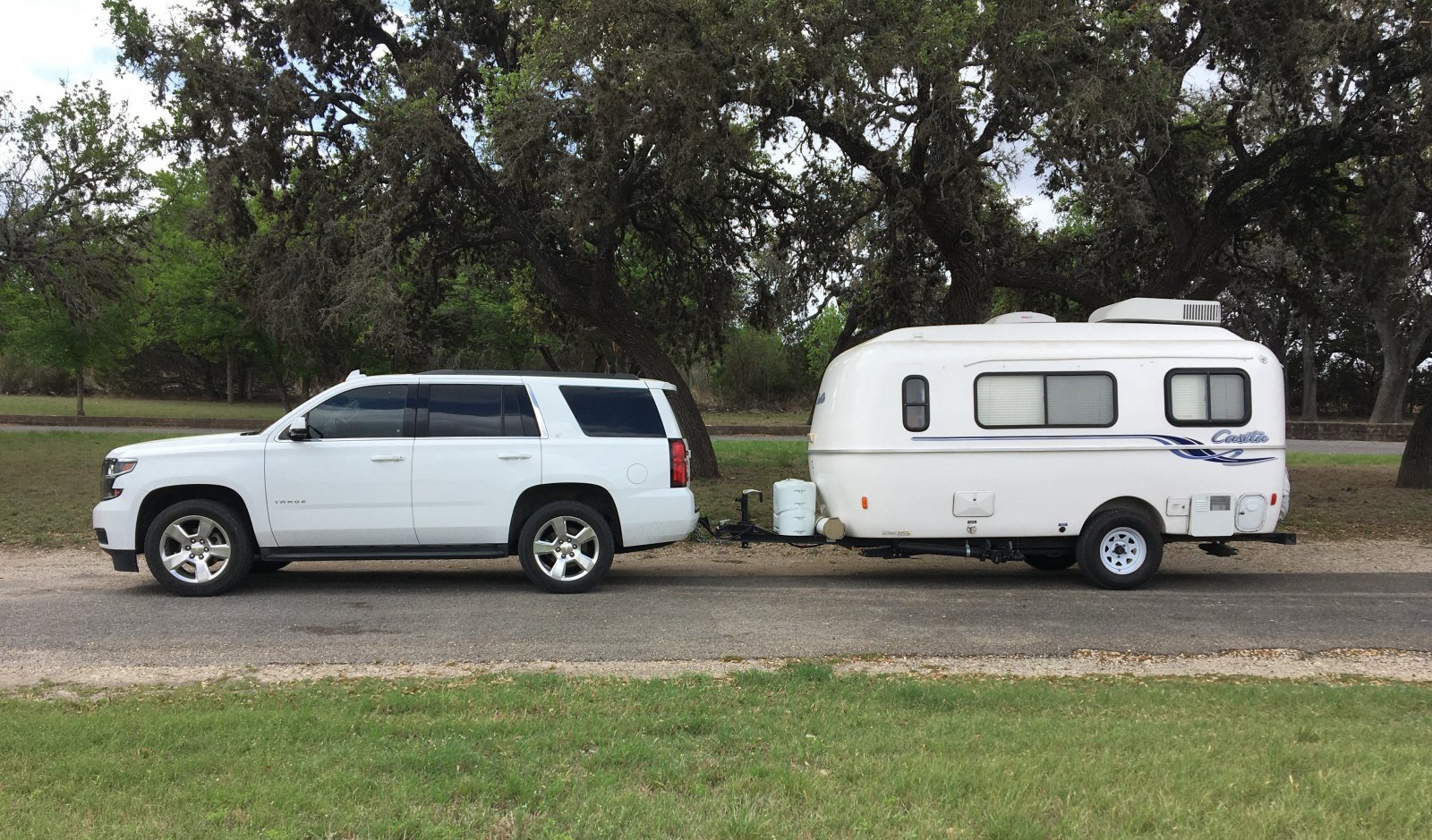

My Tahoe's axles are spaced so that I can put the forward axle on the forward weighing plate, the rear axle on the second weighing plate, and my travel trailer axle on the third weighing plate.
Here is a typical weight ticket for me.
Steer Axle -- 2520
Drive Axle -- 3477
Trailer -- 2820
As you can see, the total weight on the Tahoe's axles and tires is 5,997 pounds.
To get my trailer tongue weight,
1) I get a ticket with the three axles listed and compute the Tahoe weight with the trailer attached.
2) I pull off the scale and unhitch the trailer.
3) I get a second weighing of the Tahoe without the trailer.
4) The difference between the Tahoe weight with and without the trailer is the trailer tongue weight.
