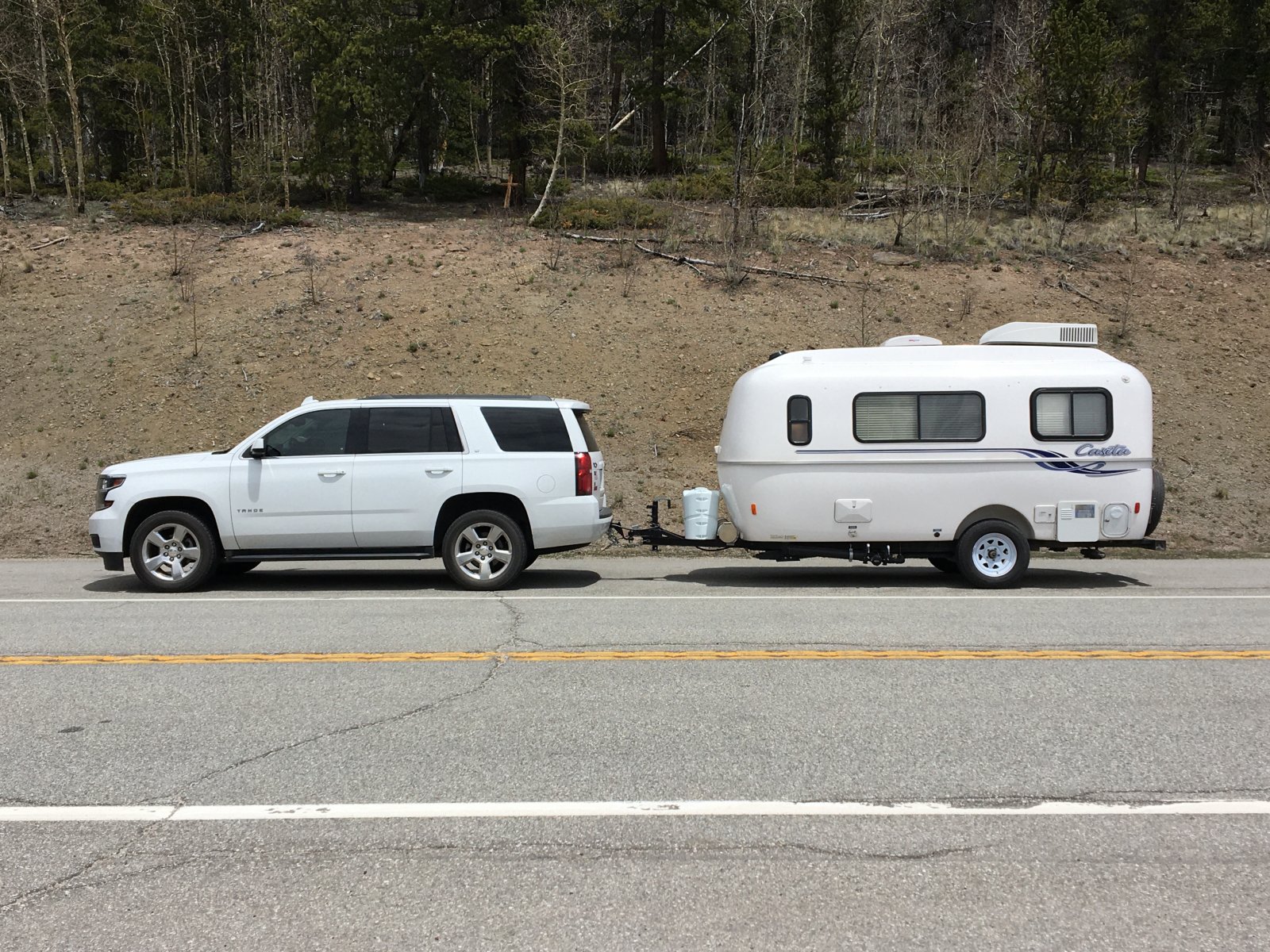

Actually, I would prefer to have my SUV towmobile look like a Chevy instead of a Cadillac. I don't like attracting more attention than necessary.
10,130 foot Cochetopa Pass in Colorado.
in Idaho
I've decided to stay with my 2016 Tahoe with the reman 6L80 and new brake rotors and pads. When I did my pro/con analysis, below, the Tahoe received more green checks than the Escalade. If the Escalade were optioned like the Tahoe, it might have gone the other way.
