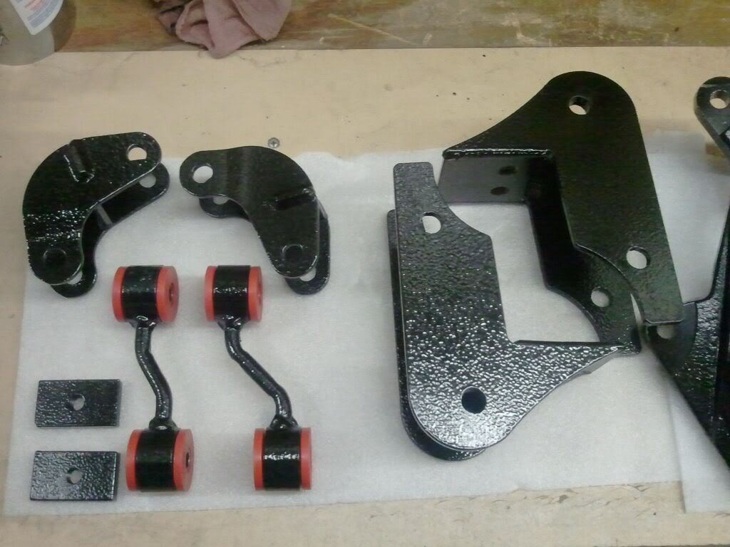

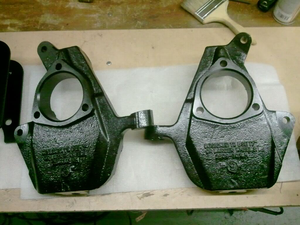

Scuffed and cleaned djm rear hardware kit along with the front belltech spindles and painted semi gloss black. The hammertone finish on the rear djm kit I didnt like and the front spindles if not painted will get a rusted look which will look horrible behind the wilwood brake kit. Its drying in the paint booth right now ill take pics when done.

Rear djm kit and belltech spindles painted :)

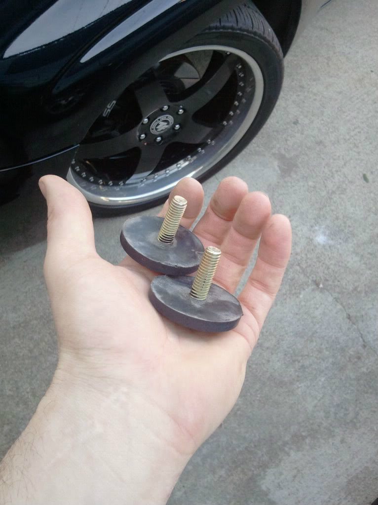

just wanted to put this up. Here are the short bumpstops I include in my rear 5 plus kits. Pretty much drill and tap for a 3/8x14 bolt and then i put red locktite on the threds and screw it into the frame. prevents the big metal sound when you cut the rear bumpstop brackets off and its really short so you get the most travel you can
