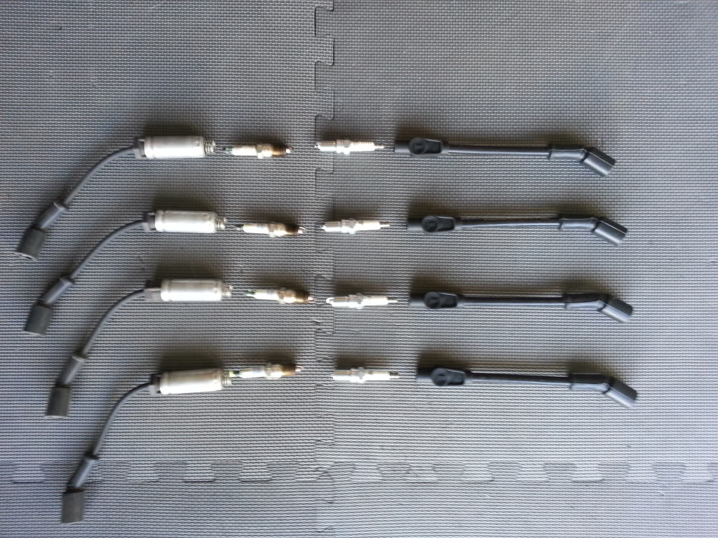

changed the plugs to ngk tr6 gapped at 40 and taylor wires. I have a ported tb from my ctsv I will put on the escalde after our first base run to see if it helps.

Excuse my novicness but what exactly do the plugs and wires do and how much did it run you?
And the ported throttle body what does it do?

As long as you are using the proper octane, there is no problem running the stock plugs and wires on L9x engines.

on my ctsv tr6 plugs got me more timing then stock same thing on our tbss. the tr6 plugs are great and with the whipple and 3.325 pulley stock plugs wont cut it lol

weird even on stock trucks we saw less kr on the tr6 out our 91 messed up gas. oh well im trying to do all this in stages. most people here have higher mileage and the tr6 plugs are only like 18 bucks so great plug to go with.

They are good plugs, but most folks won't see a difference. I ran he TR55s on my Tahoe but only once I went FI. Plugs and wires for NA are a nice to have but not a necessity, especially if you are running good quality/octane fuel.
Keep in mind, more timing does not necessarily mean more power (which is against popular belief).
