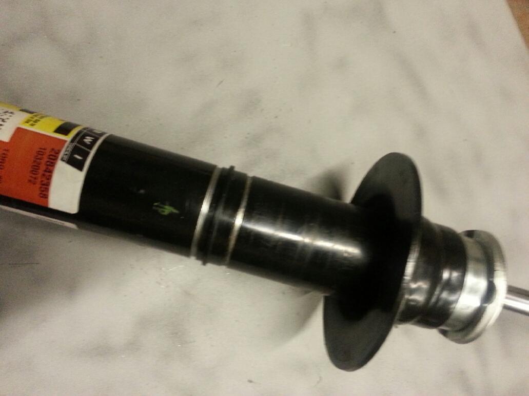

Been doing this for over 6 years now on the 07 up trucks (aug 2006 did the first one and customer still has the truck with no issues)
I have a machine shop I do stuff out of so you will need a machine shop to do this. You remove the spring assembly and you pull up the lower spring perch and you will actaully do 2 grooves. The top groove is the factory one. The middle one is put at .40 under the oem ring. Then the 3rd one is .620 from original snap ring groove.
I was at 34 3/4 from ground to fenderlip on 305 30 24s and belltech spindles on my 2011 escalade. Going .40 under the original groove I am now at 34 1/8 which was 5/8 of a inch drop. THe .62 should give you about 1 inch drop.
Now you guys can go lower than 1 inch but just a heads up after 1 inch ride suffers and will kill the stock shocks a lot faster. Also remember to cut the front bumpstops down when you do this mod.

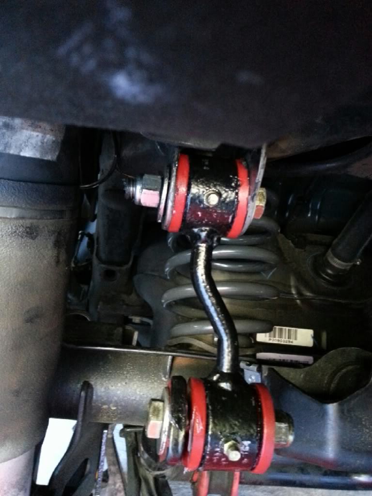

well tomorrow going to take the djm hardware kit off and put zerk fittings into the endlinks in rear. Then just go over the spohn bar kit and grease them up. Oh yah going to install the belltech tb coils. The front of my truck came down perfect pretty much where I wanted it if i can get the rear down another 3/4 of a inch ill be set

zerks installed on the djm rear hardware kit. find more info here on that http://www.tahoeyukonforum.com/forum/showthread.php?t=44731

Some pics from today
