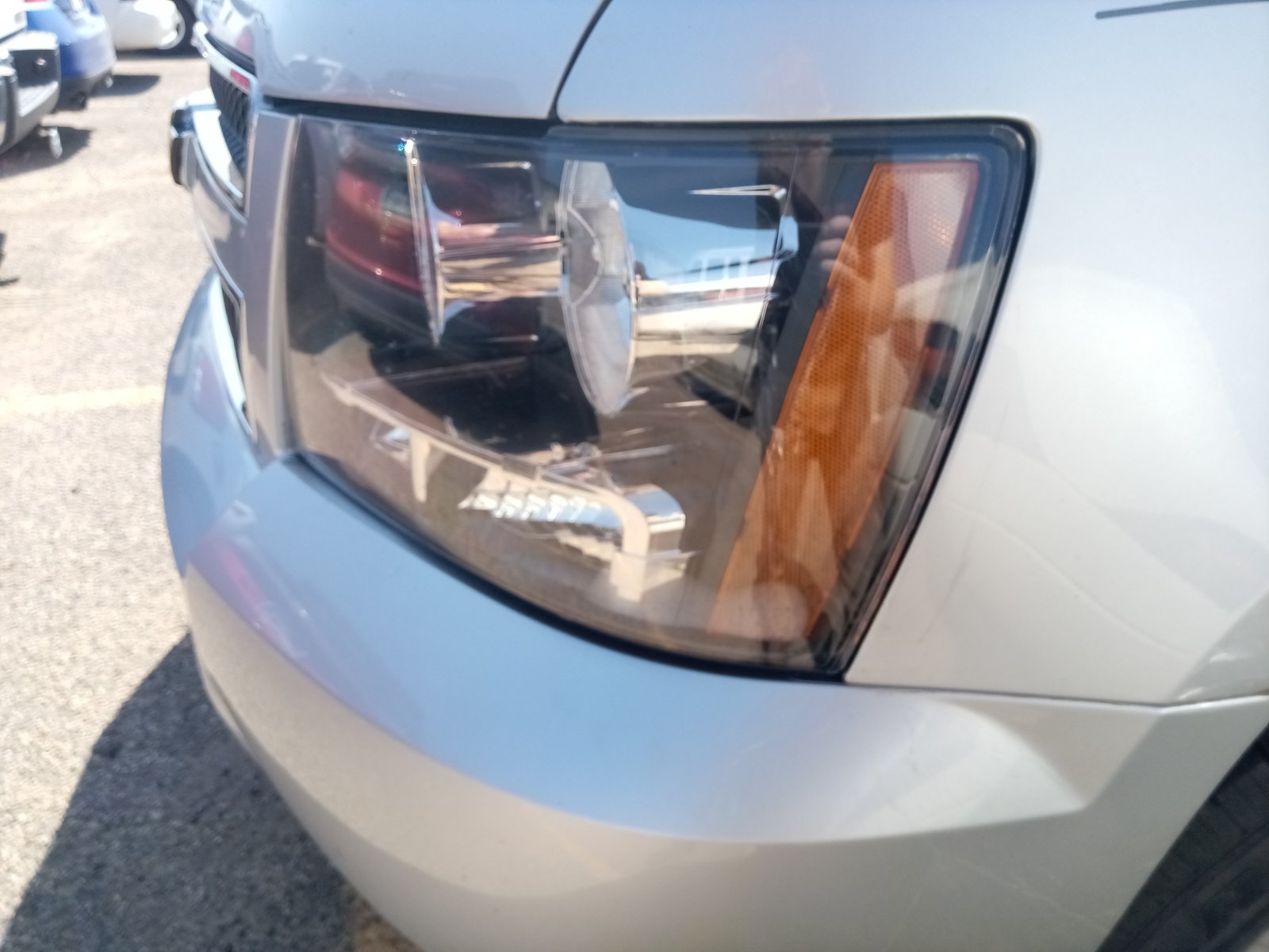

When changing bulbs, was there anything I could have missed up? Like I didn't clip the bulb in right? Maybe there was an o ring of some sort that fell off? It rained pretty good yesterday and my drivers side housing fogged up. It was hot out to though, mustve been humid to bc my inside of my windshield fogged up good too. have never taken it apart. Just had taken it off the vehicle and changed the bulbs. I did break the bottom clip on accident. But it didn't compromise the the housing or break any seal. Used epoxy to put it back on the housing. What y'all think?
The fog did go away pretty quick so whatever it is leaking must be a decent size leak. It is a OEM housing

There's still some moisture in there as of now.

I took the bulbs out to see if it will dry the spots of condensation. It all went away and came back next day.

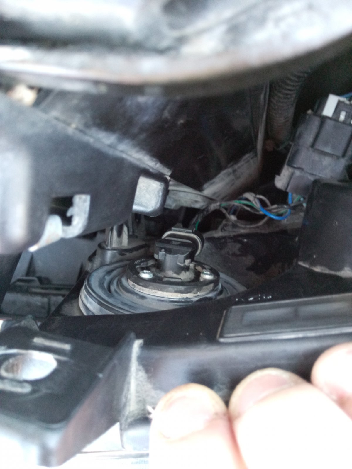

I actually have a backup housing. I tried the high beam from that one and it still fits loose in the high beam socket. Maybe even looser than the old one. So like the o-ring on the bulb isn't sealing all the way or something

I actually have a backup housing. I tried the high beam from that one and it still fits loose in the high beam socket. Maybe even looser than the old one. So like the o-ring on the bulb isn't sealing all the way or somethingView attachment 434209
Hmm. Maybe something gone wacko with the housing. If the bulb has the oring, you may be tasked with swapping housings.
