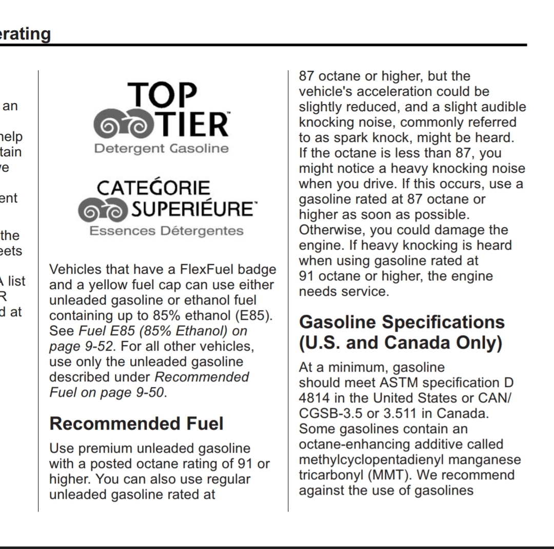

I've seen/read/watched many forum posts and videos online of damaged 6.2l engines caused by spark knock. They have a higher compression ratio than the 4.8/5.3.
GM does say in the owner's manual to use at least 91 octane, but in a pinch 87 can be used, but engine knock may be heard and you should use higher octane or severe engine damage will occur. So if you drive it like granny, 87 would probably be OK

Right. GM recommends 91+ and says 87 "is acceptable", but follows that up with something to the effect of "If knocking occurs, use a gasoline rated at 91 octane or higher as soon as possible, otherwise, the engine could be damaged."
I interpret this as "the engine is designed to work in X way, but has safety nets in place should X occur". I'd rather not consistently rely on safety nets.
Maybe I'm overly cautious. But, I don't want ANY knock. The PCM doesn't sample the fuel and proactively adjust. It sees knock, responds and repeats until it has determined that it should stay on the low octane table. The process repeats when it sees a refueling event. I perform best when keeping my bones, blood and dermis covered, as designed. I can TOLERATE getting scrapes and cuts. But, that doesn't mean I was designed to constantly take on such damage, regardless of how small each incident may be.
There are a ton of other factors that affect how "safe" one is running lower octane grades in the 6.2- quality of fuel, driving environment, driving style, etc. Bone stock, my 5.3 would knock on 87 in summertime weather and under moderate acceleration. It was noticeably reduced on 89 and non-existent, even at WOT, on 93. I could run 89 or 87 and drive like I'm 90 years old. But, I prefer the freedom of flooring it whenever I please. In my parts, there are always times where maximum throttle is needed to pass someone or to avoid a potentially dangerous situation. Which, they're often one and the same, as when merging onto the highway.
We were looking at different manuals. But, same story.
