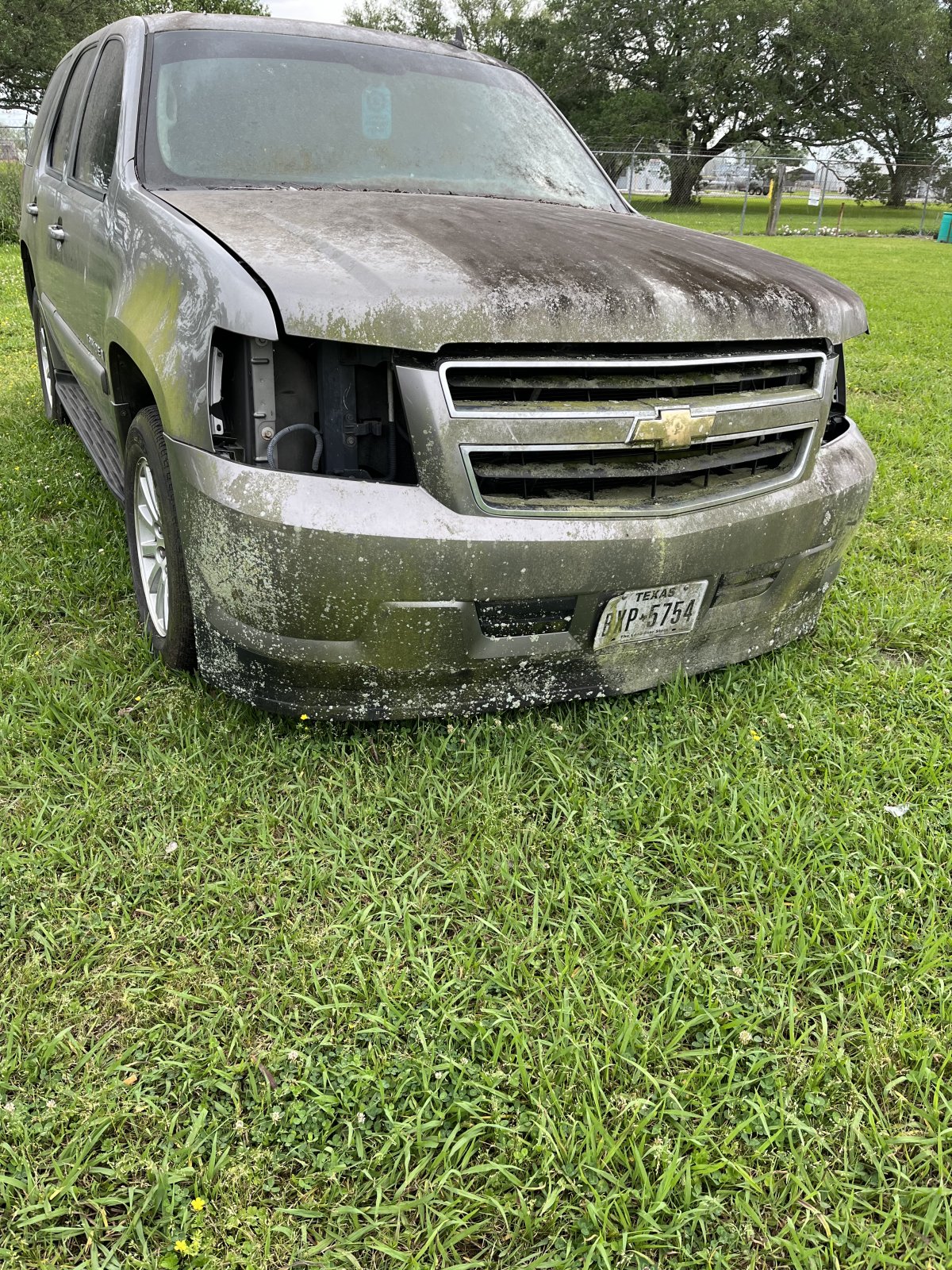

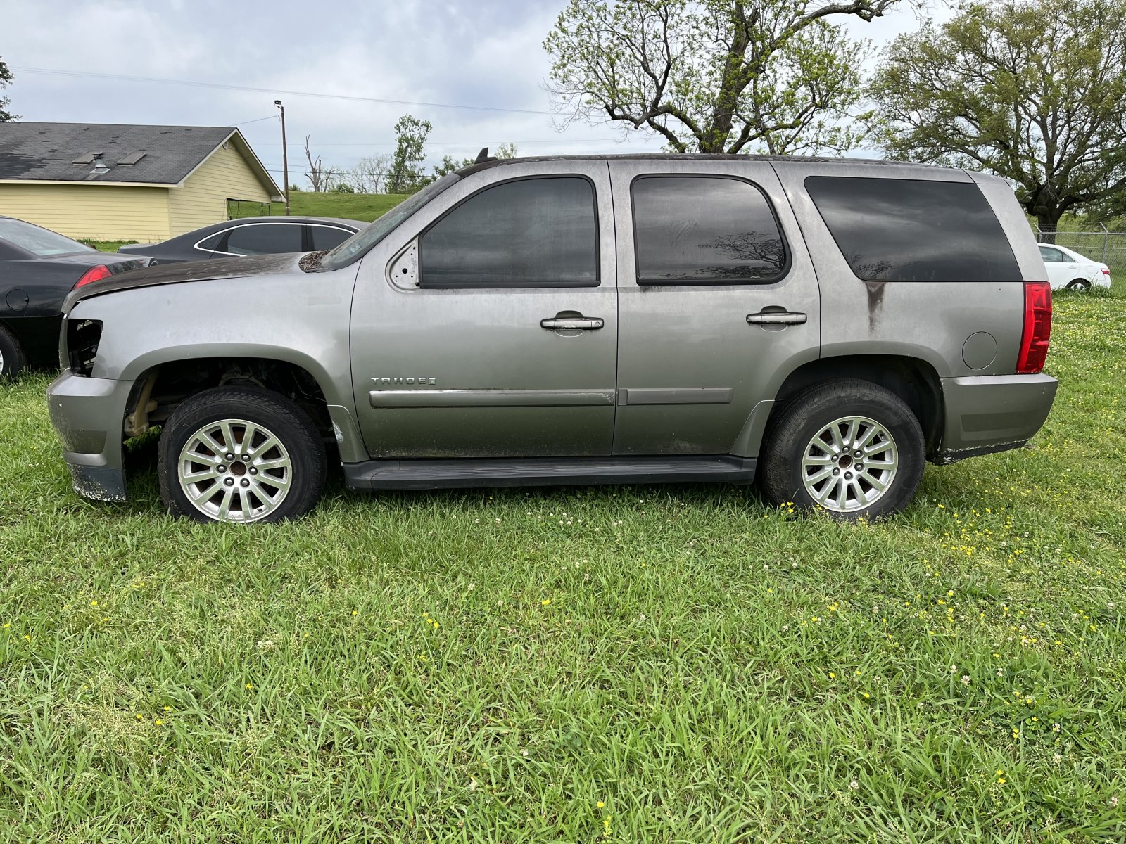

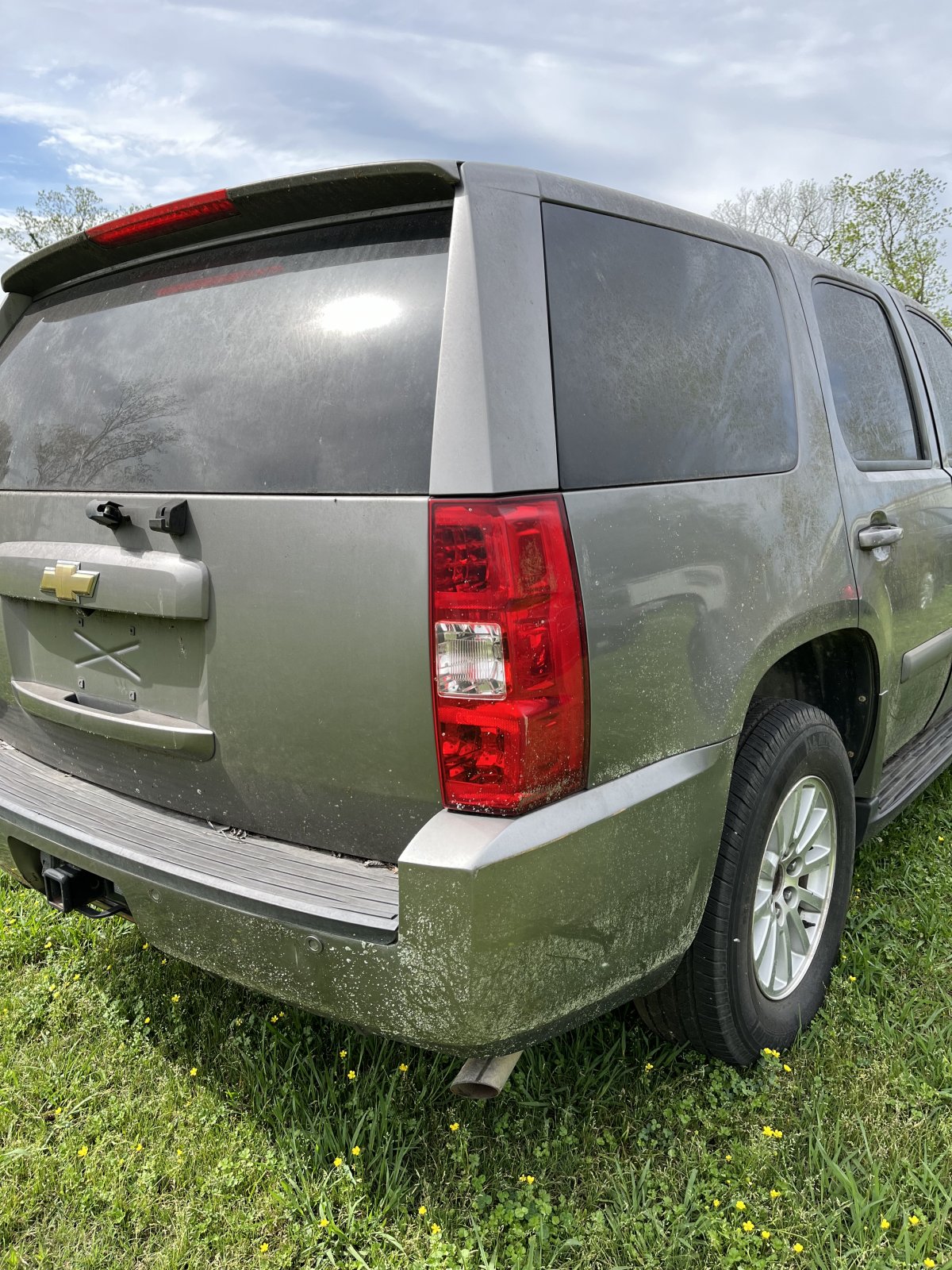

My left fender has some wrinkles. I bought a good fender of the same color, but it needs paint work so I haven't bothered to swap it on yet. I've been keeping an eye out for another fender with "perfect" paint just in case. The other day, I stumbled upon this:

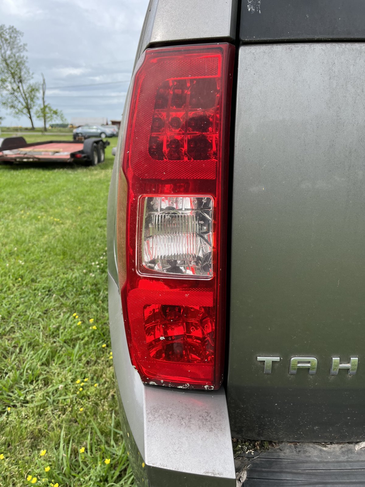

It's all there. I'd either swap on my current lower lip/air dam or trim that one way down. The rear bumper cover needs work. I'm sure I could make the LED tails work. It's more of an all-or-nothing thing cuz the hood (aluminum) goes with the front bumper/grille. As much as I'd like the aluminum rear liftgate, the fixed glass is a deal-breaker. I'm more into removing or relocating frontal weight, anyway.
The rear bumper has a cut in it like they backed into a receiver hitch as well as some other scrapes. I'm really considering wrapping mine so the paint stuff and the damage really isn't a factor. I can easily fix the rear bumper cover and have it wrap-ready.
The seller said a guy wants it for the engine. I told him I'd write up a parts list and get prices. If the other guy buys it, he might make me a better deal on the body pieces. Or not. lol
I'm not head over heels in love with the front, but I like it just the same and sometimes maybe a little more than my stock one. I would do it more for the rarity and because I like the more pronounced edges. It's like it's halfway between a GMT900 and K2. The aero would just be a cool factor since it'll never improve MPG enough to be a return on investment. Are the battery packs in these things worth anything? I don't know if it's still there. The cats are gone, of course.

you will need the hood as well the hood is different then the normal tahoe... the tail gate is aluminium as well the D plies and steps and flaps the...... the brake lights are LED you may need to do some modding or adding resistors for it to work correctly (or commercial mode) it's not connected to the lower lamp like the normal, the turn Signal is separate circuit for the lower light only from the brake light and running lights

You going to make a run on the Bonneville Salt Flats?
Salt Flats, Hwy 190 in West Baton Rouge... Tomato tomahto.
If the hybrid battery was good there will be buyers for it but a dead pack or transmission probably led to this ones demise. The aero features are cool, they cut the C/D down into the .34s if memory serves.
@BG1988
I didn't bother to ask but I will ask about the whole thing. Yeah, I read that the C/D is brought from .37 to .34. Like I said, it'd be more for the novelty of having the rare stuff. I guess my thread title is misleading. I'll edit it. Due to the drop, I'd have to chop that front chin spoiler a lot or swap my stock one on if it'll fit.

Yeah, that's everything on my list. It's probably gonna be an all-or-nothing thing.

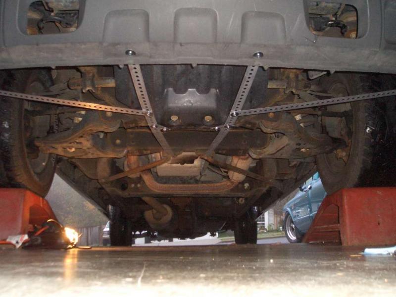

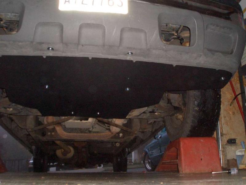

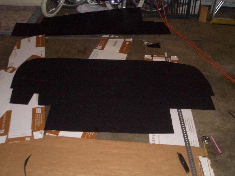

I only wish GMT800s had aluminum hoods and low-drag front fascias.
Looks only get you so far, though. For more drag reduction, smooth out the belly:
Can't see a downside to smoothing out the underbody airflow.
Cool! I've considered belly pans! I'll never do it cuz I do more local drives than highway cruising/top speed jaunts. And I plan on going a little lower. What is that made of and did you notice any improvements?
Corrugated plastic aka coroplast.
I myself did not notice any improvements ... yet ...
The major appeal is that only my mech will know that I'm an aero-focused EcoModder.
