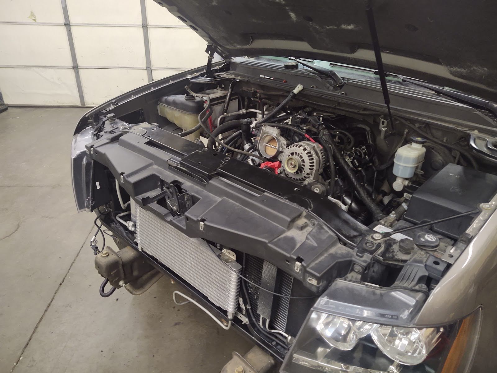

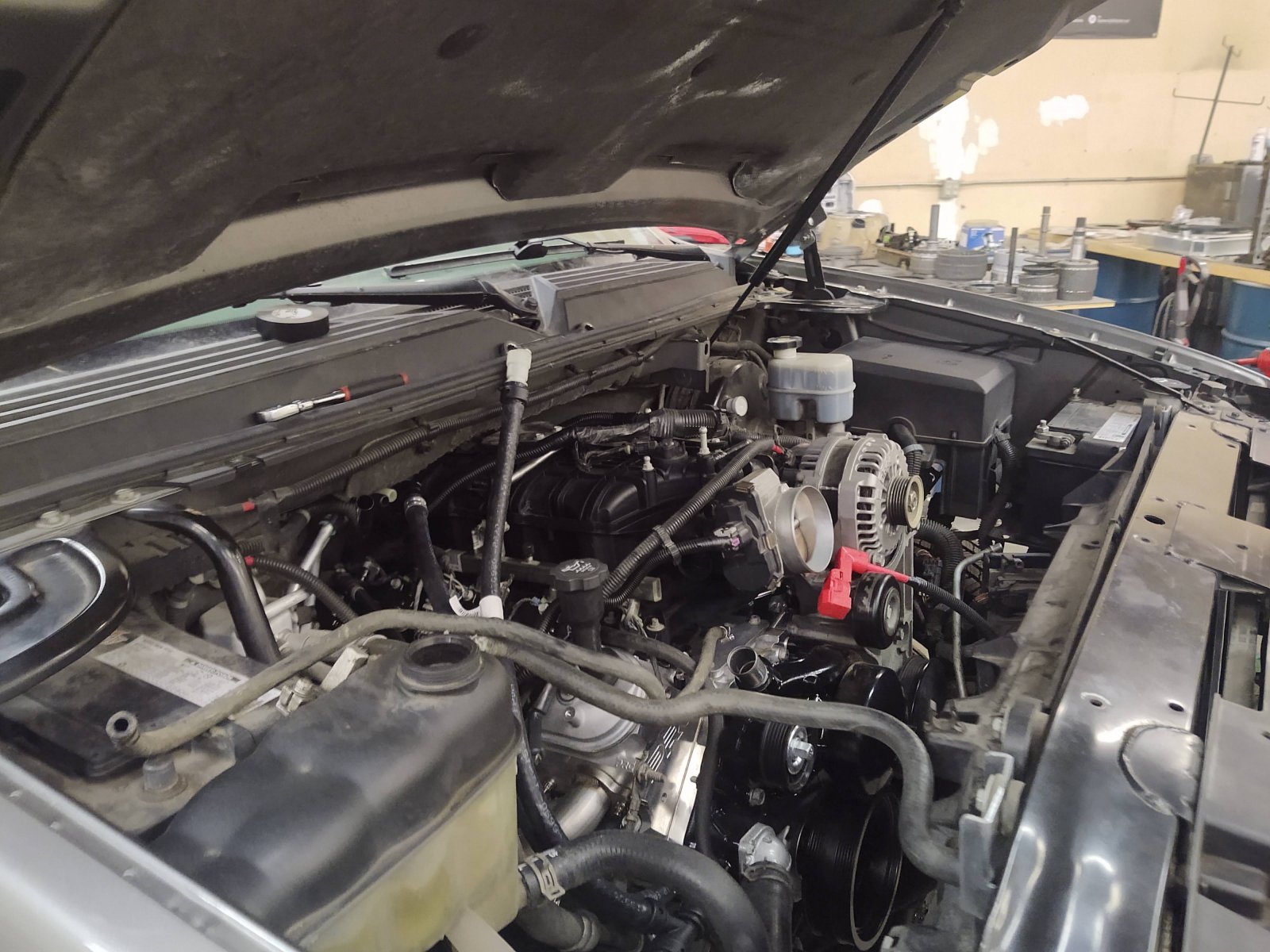

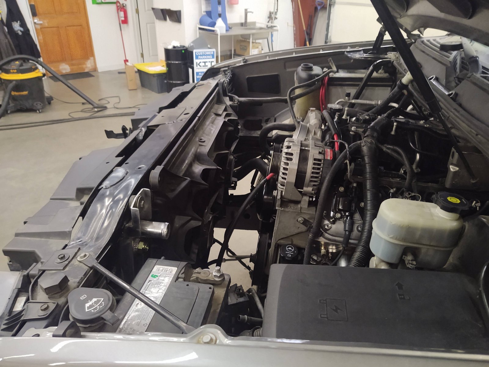

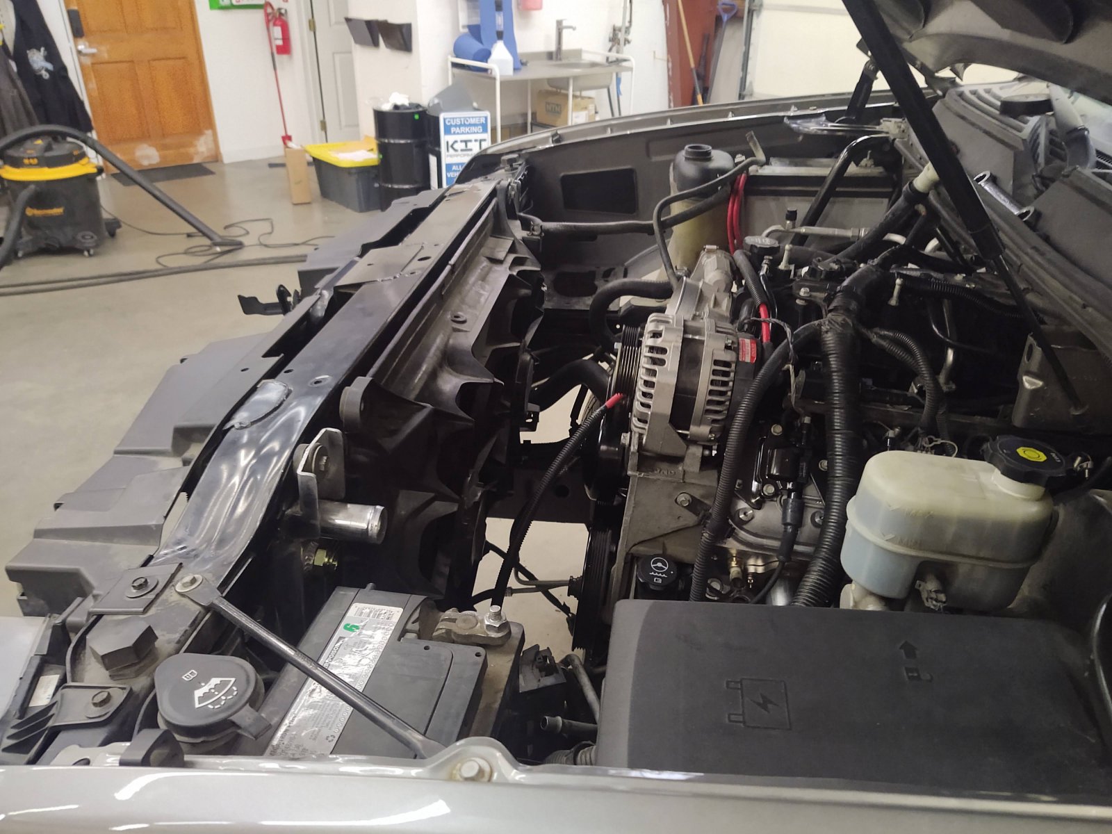

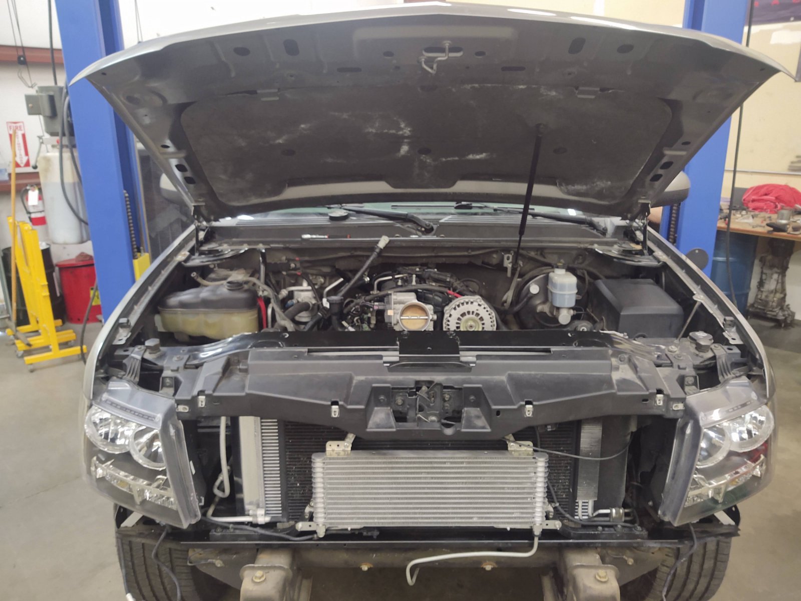

Oh, I forgot my hubby got a few pics today.
