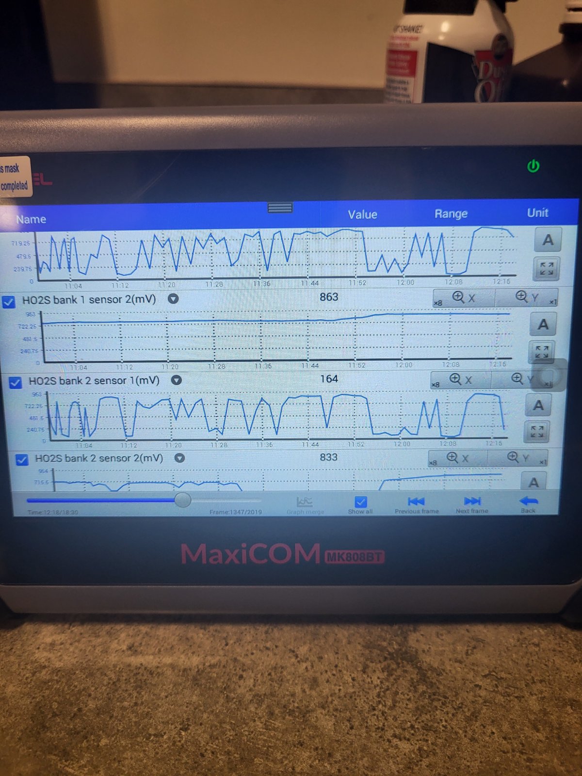

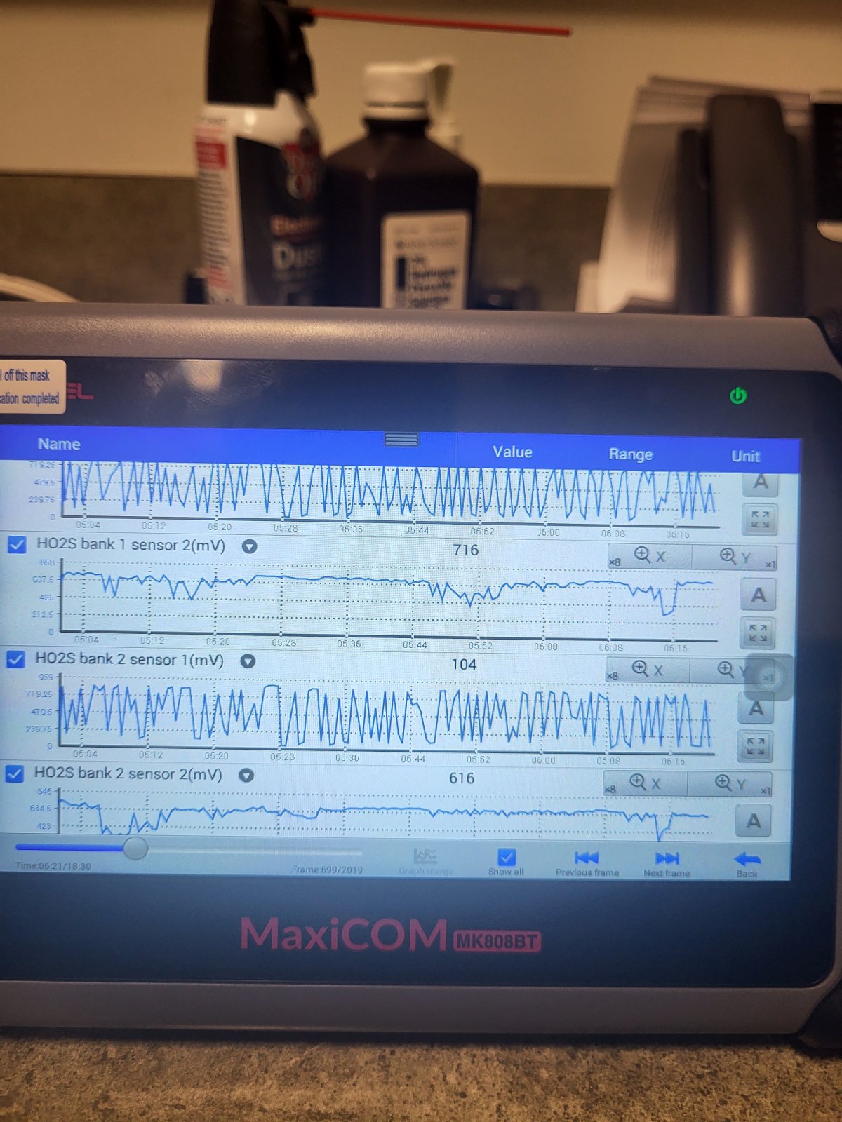

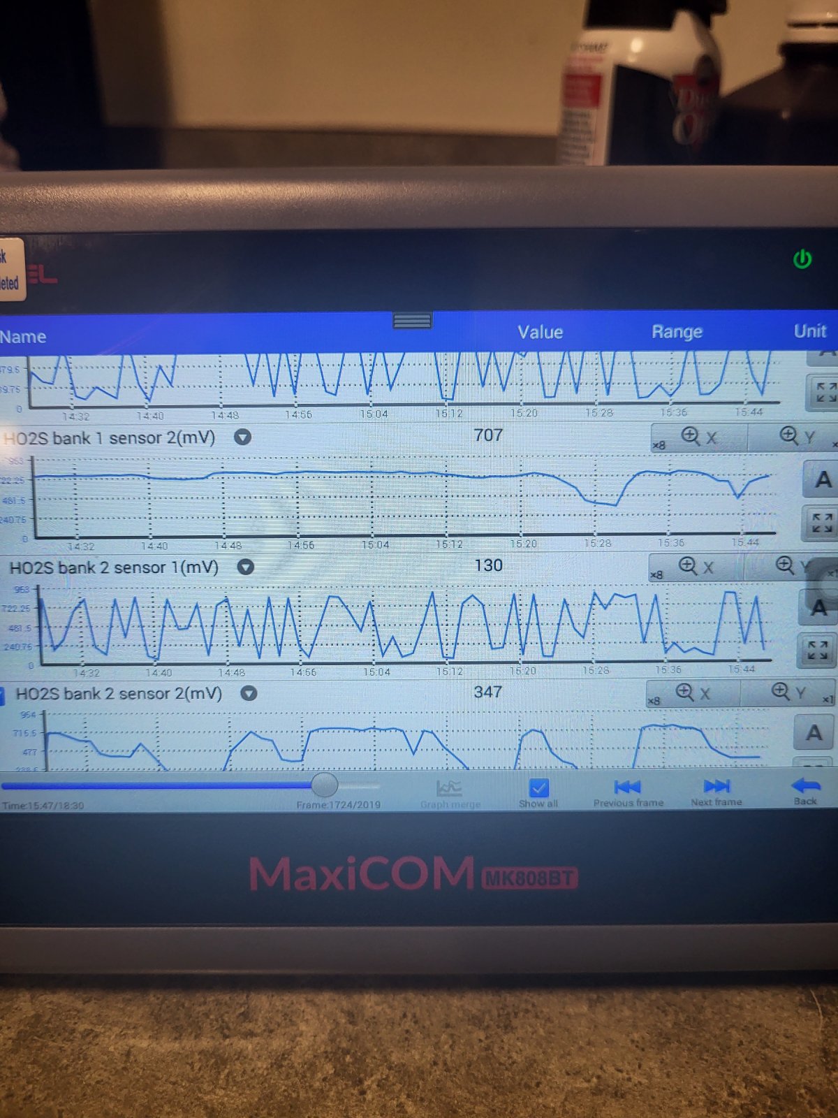

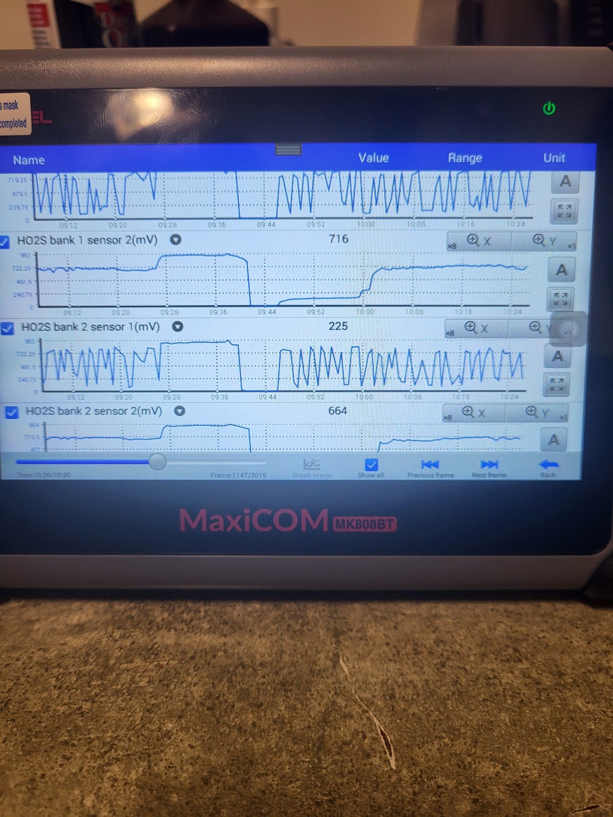

Picked up some data this morning on my way to work. Here are a few shots of my 4 o2 sensors doing there thing. This is at several high way speeds and stops and go.

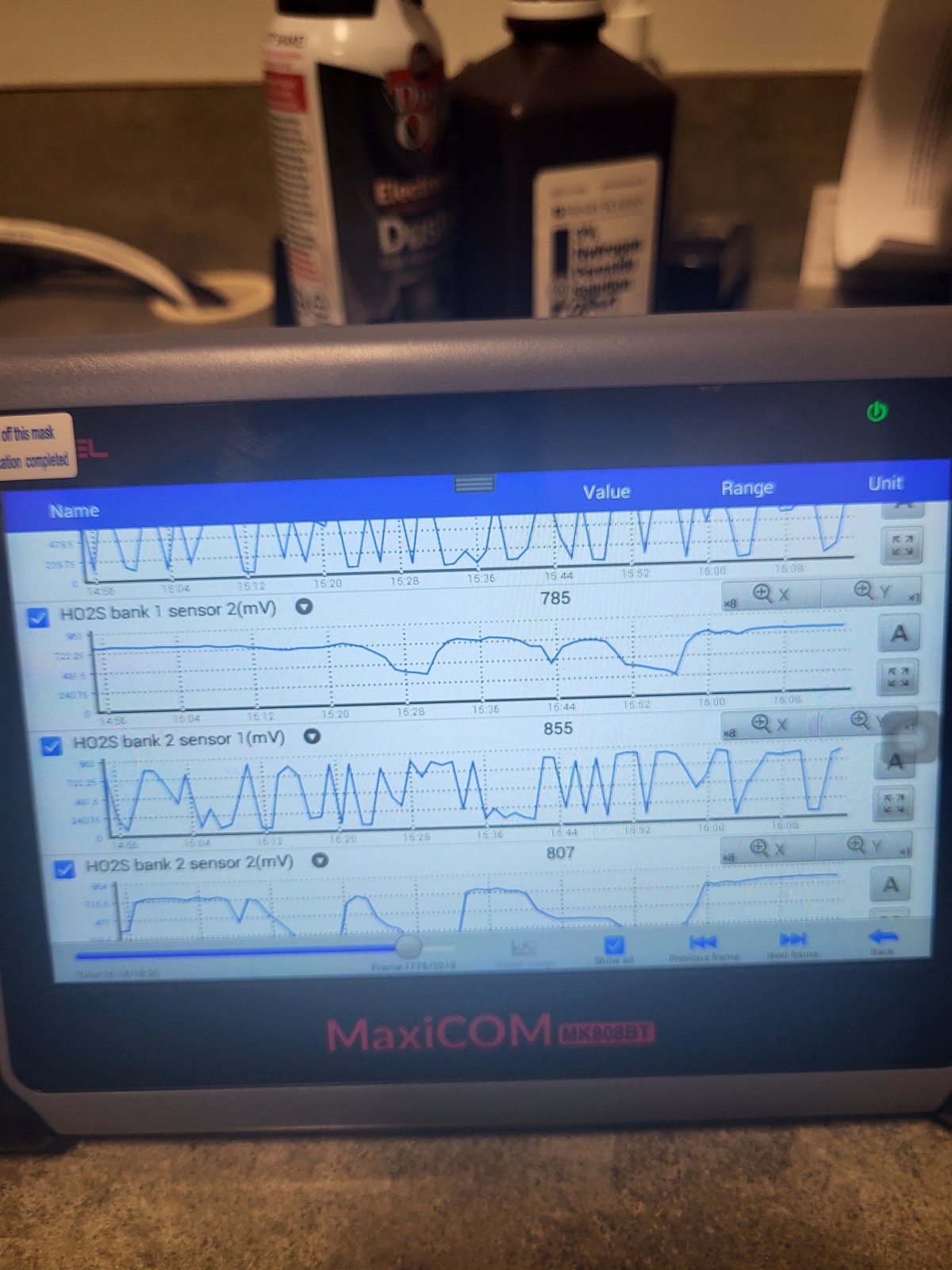

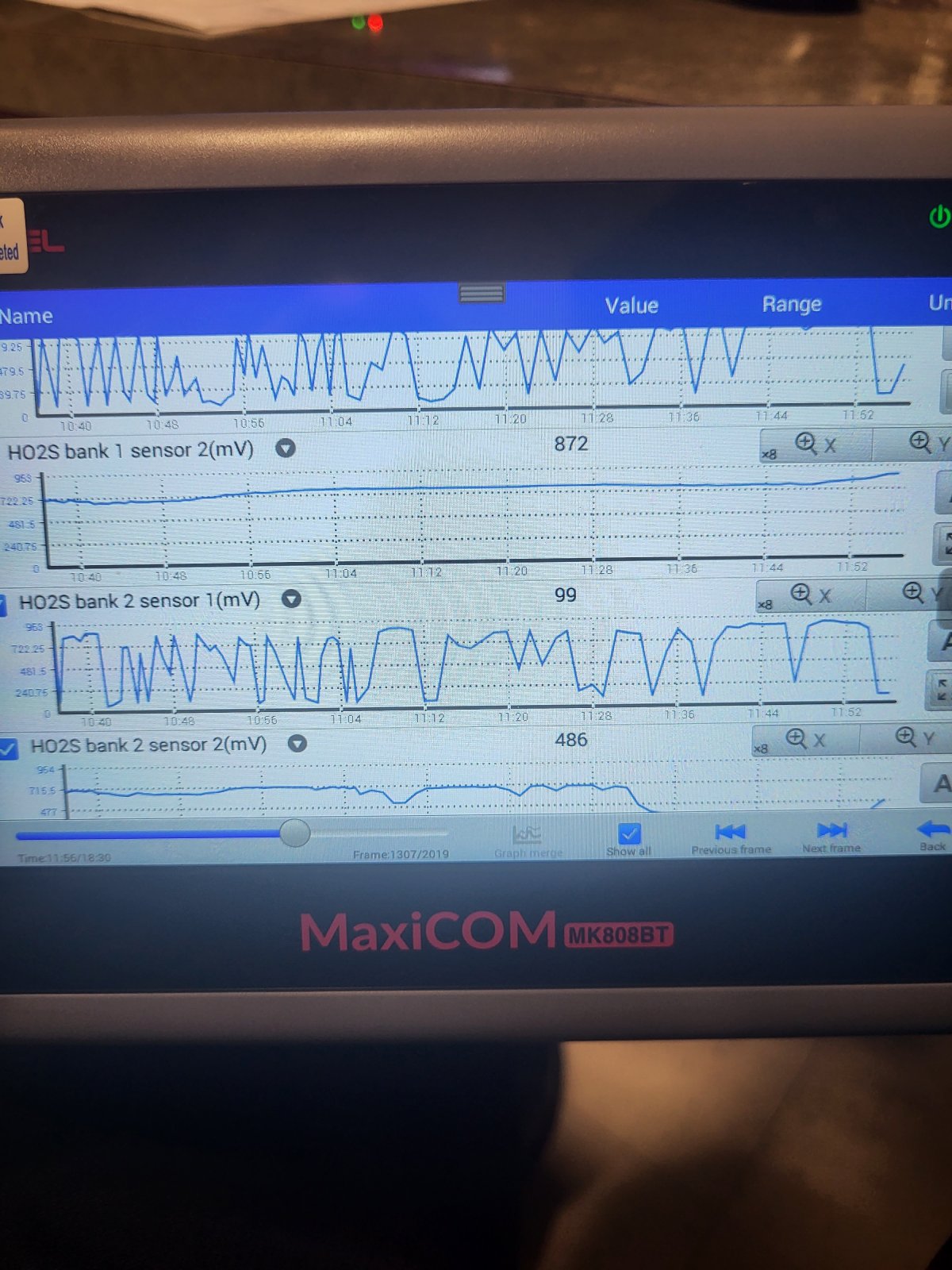

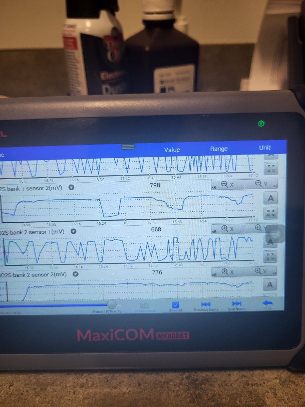

Few more

Thought The LTFT are not suppose to bounce around so much and both LTFT bank 1 and 2 be equivalent to one another?

Opps im sorry. Im all confused with this. I am learning as i go with this scanner and trying to do my own diagnostics. So both sensor 2 on bank 1 and 2 are reading good?
Moderator
16,284
33,667
People's Republic of Colorado
Sensor 1 (upstream of the cats) readings on each bank are the important ones, since they control the fuel trims. They should switch from about 100mV to 900mV all the time as the fuel is managed, and all that is normal.
The Sensor 2 readings are downstream of the catalytic converters and really only tell how the cats are doing.

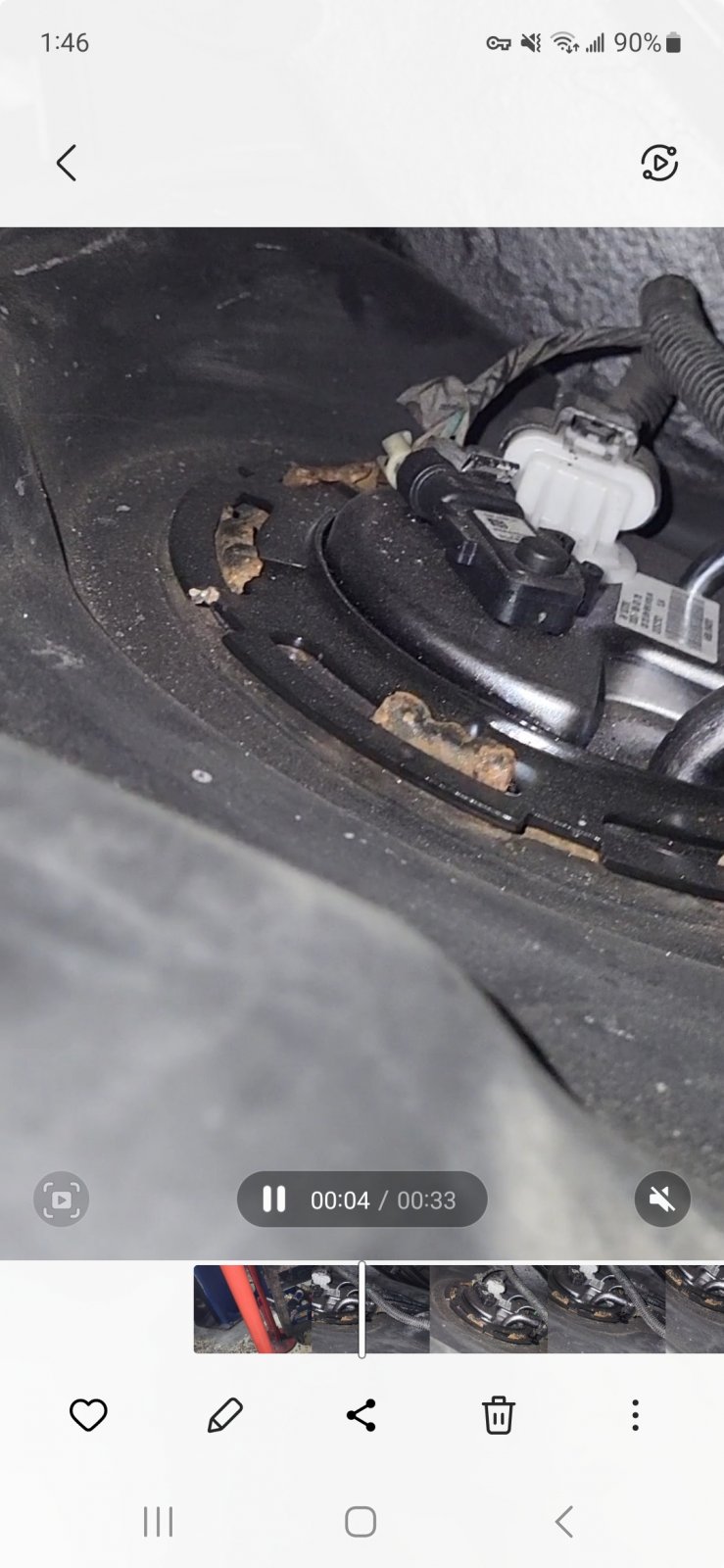

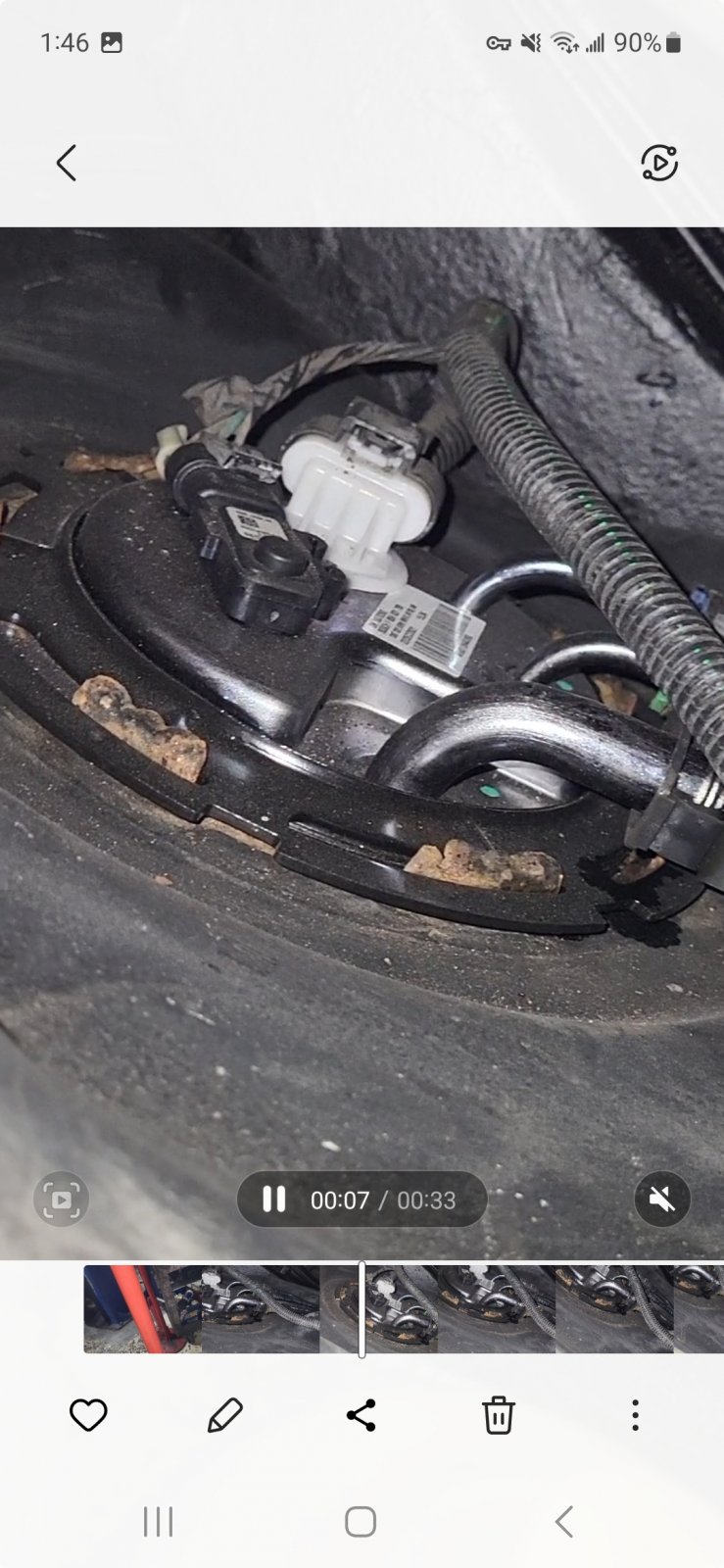

As per the hissing sound coming from the top of the tank. I had replaced the fuel pump about a month ago. Seems like the o-ring from the evap hose that connects to the pump was bad. See in the pic attached the oil from the smoke machine right under the connector.
Replaced the vent solenoid and replaced the o-ring. Ran the smoke test and all is good leak wise. Will run the truck tomorrow and see how it runs.
Moderator
16,284
33,667

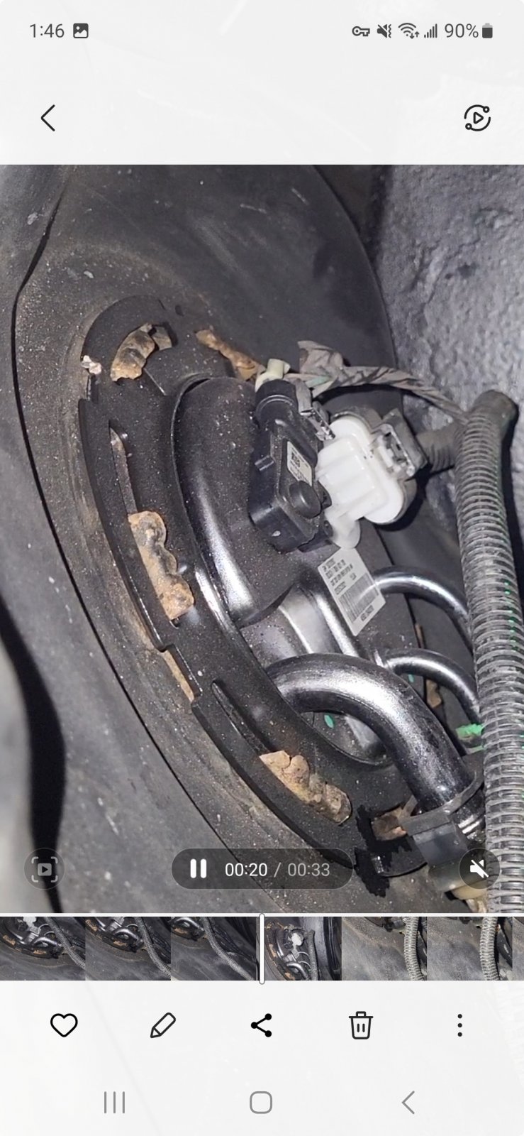

Maybe it's just the way I'm seeing it, but to me it looks like the ring isn't fully seated. The tank "hooks" don't look like they go past the slots in the ring.

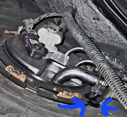

Few more pics
What you think?
