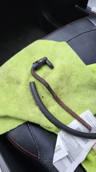

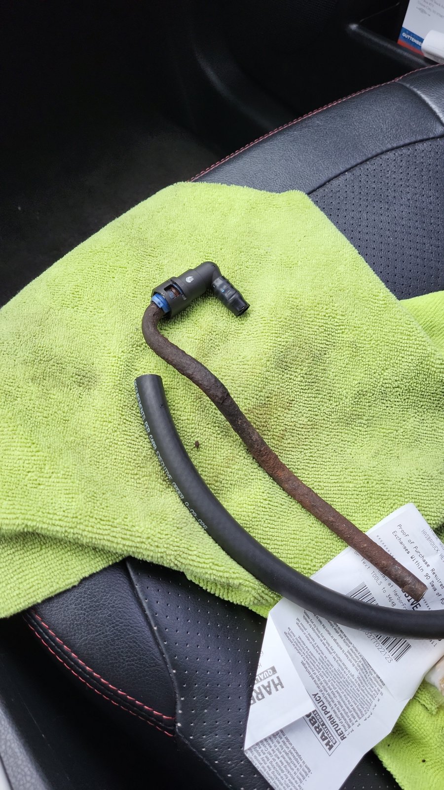

After inspecting the truck, came to notice that the fuel line coming from fuel rails and the evap line coming from the front are both heavily rusted and most likely when trying to fix my 1st issue i must have demaged it some what. It is now leaking fuel.
I have checked several websites and no one seems to have these available. Any one have an idea as to what replace these with?

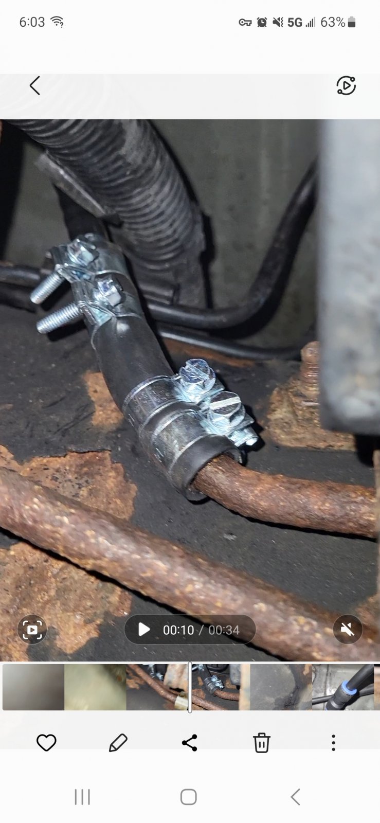

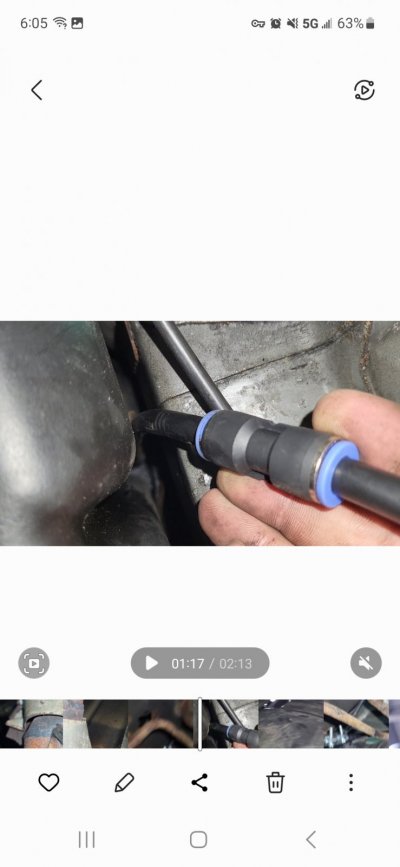

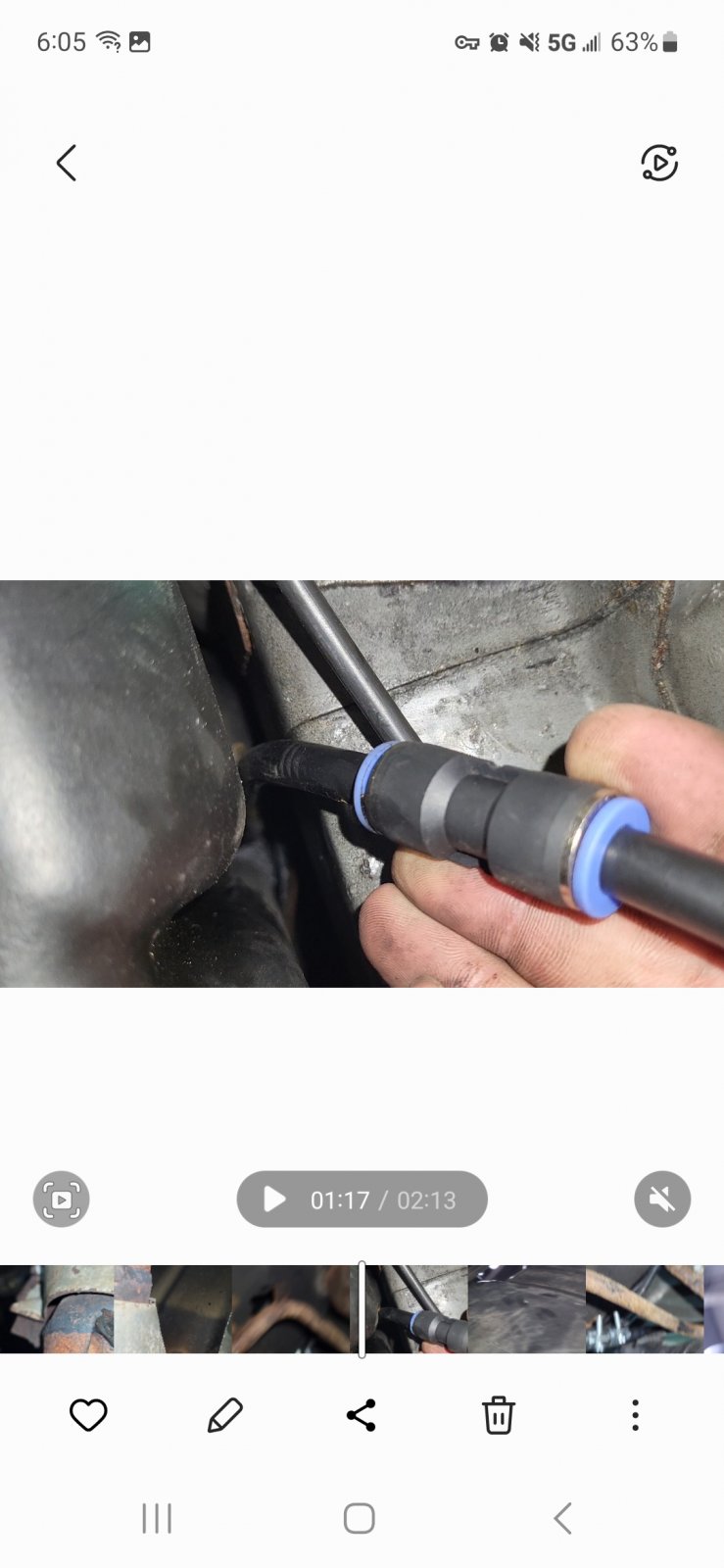

Ordered the fuel lines. In mean time, i had to get the truck running. So i cut the piece where it was leaking and did alittle something.
