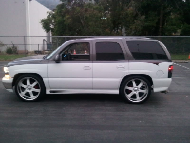

no it will pretty much be even with the lip. Here is a 305 35 24 (almost the same as a 305 45 22) and the drop i listed you can see sits pretty flush
