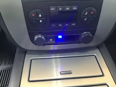

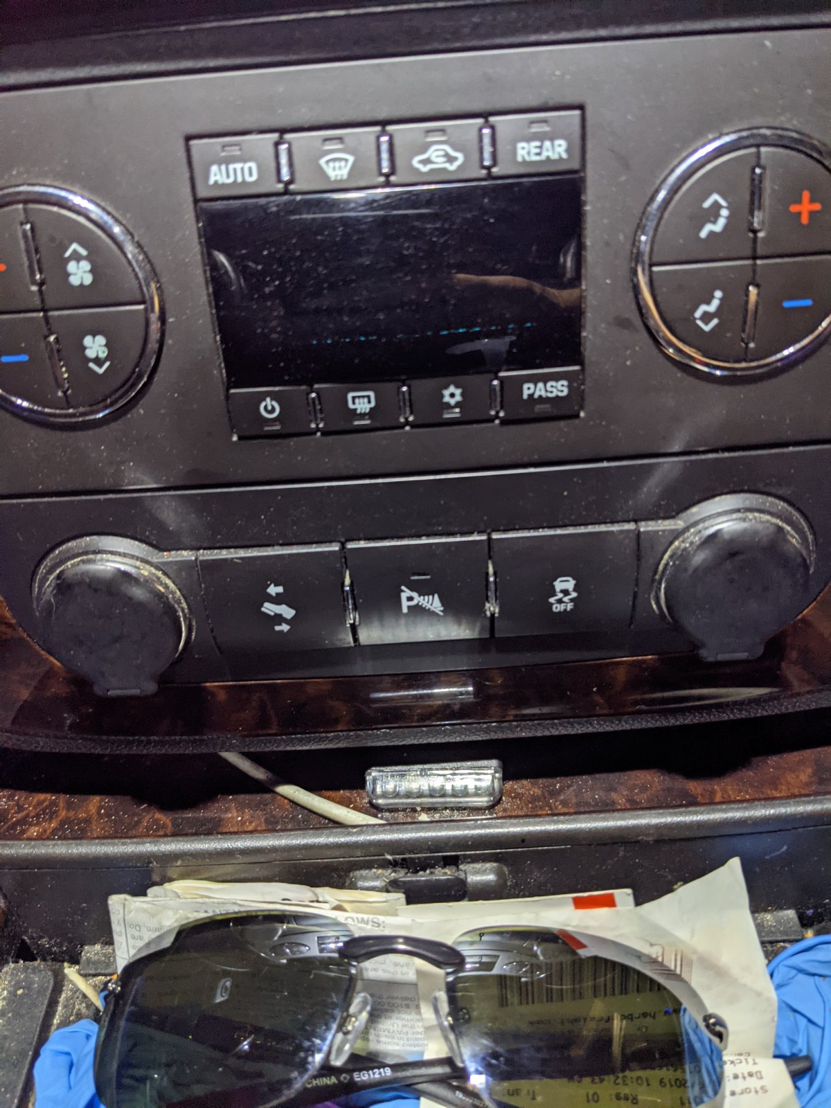

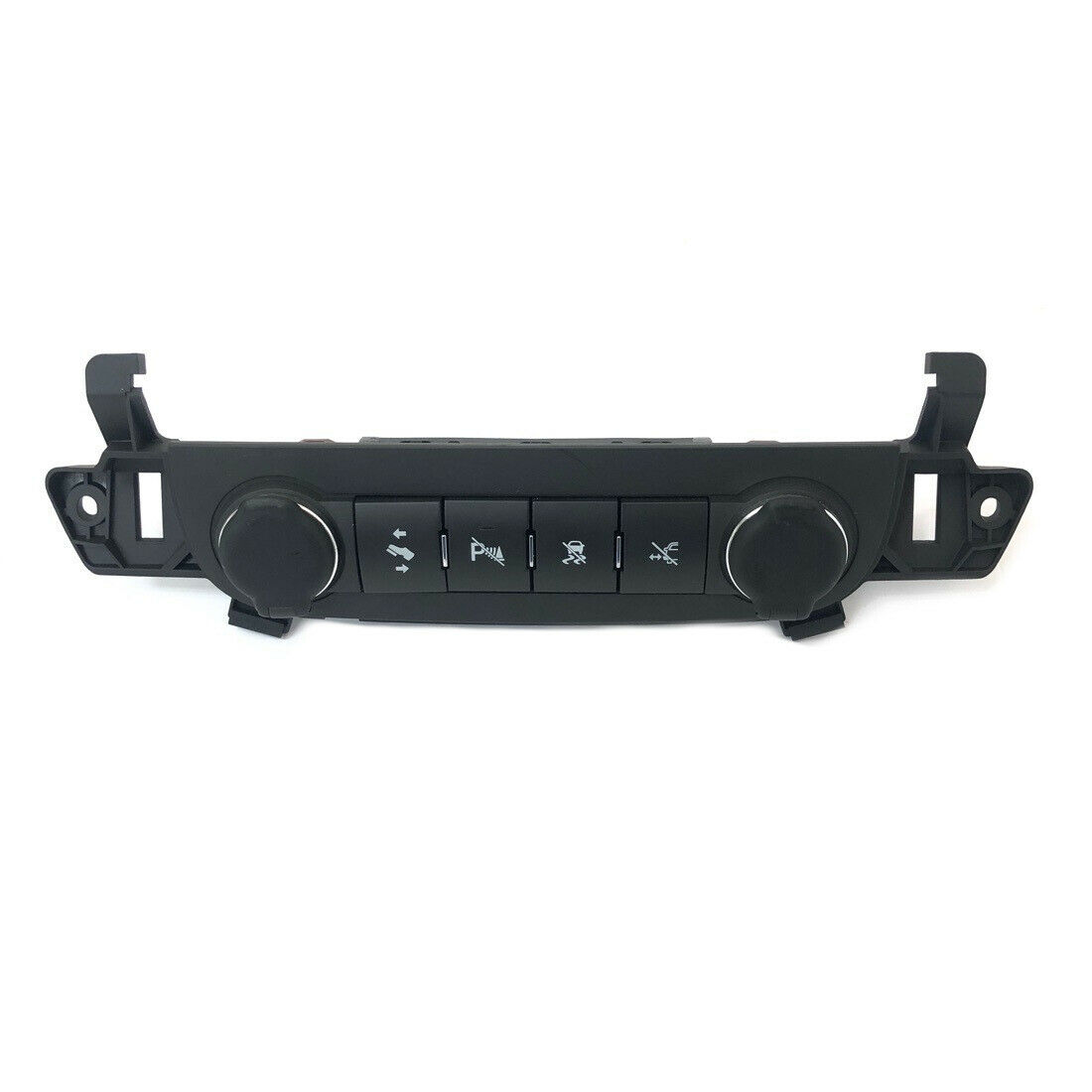

I’m curious what the combinations of available switches were in our trucks. Both of my PPVs have the single traction control switch and a useless cubby. See first pic. I’ve seen a version that has 4 switches. Second pic. The exploded view shows 4 modules as options for the location. I’m curious about the others. Are they just versions with fewer of the same switches, or something else?
I’m curious because I want to see what I might suddenly gain with just a switch addition. Alternately, I might reuse one or more of those for something else.

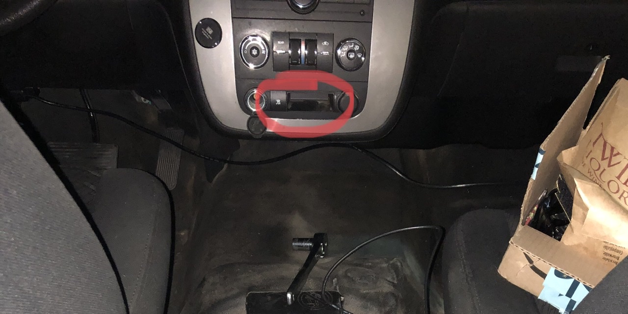

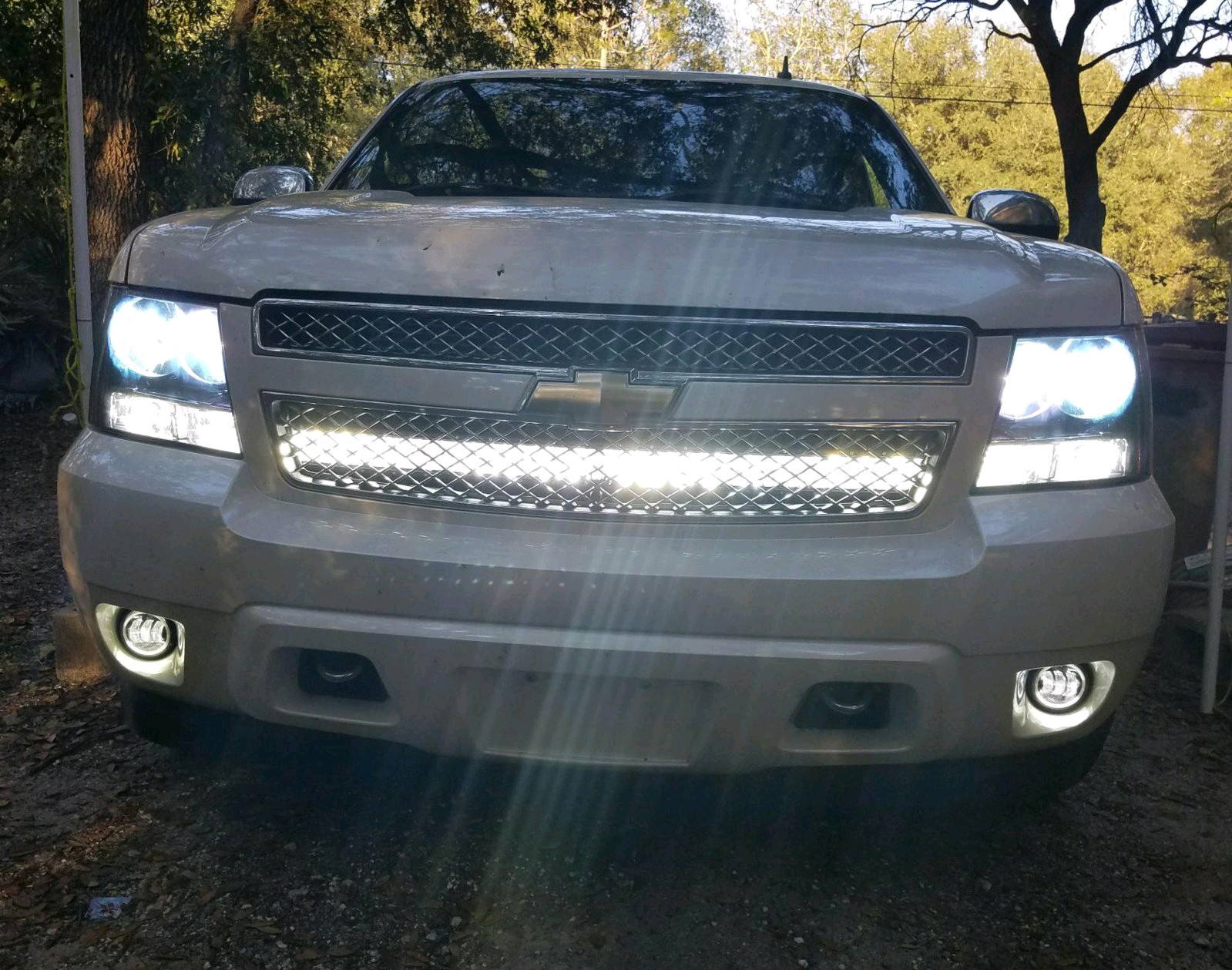

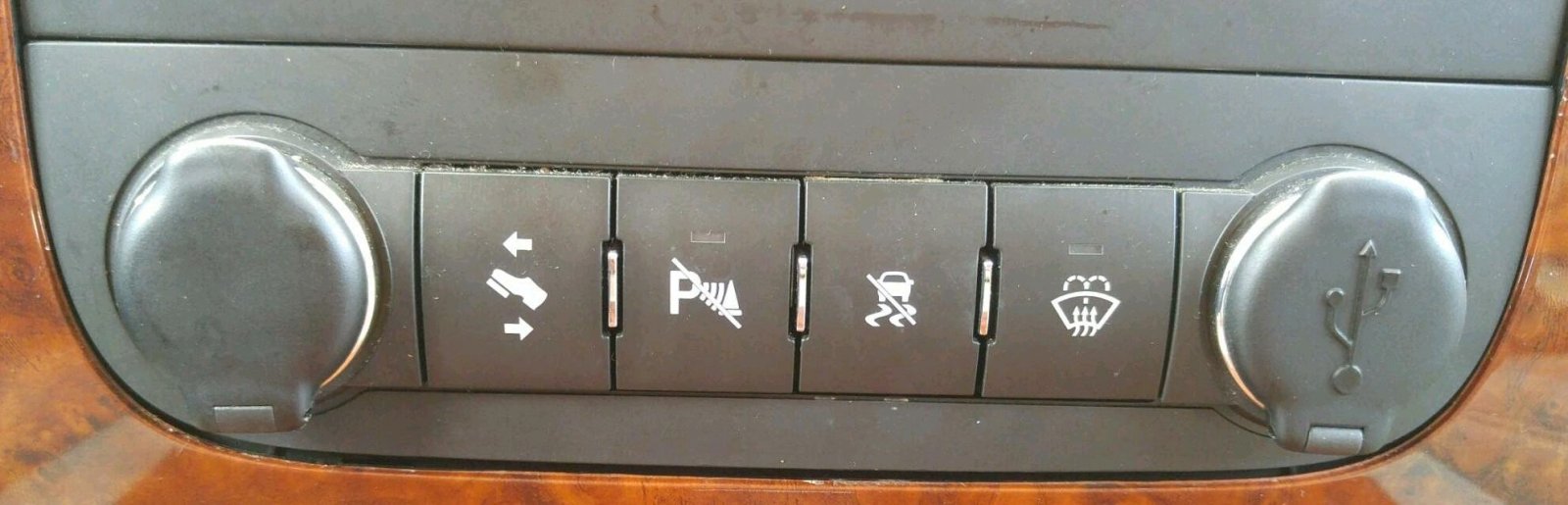

Here is mine...
It originally had the heated washer bottle which was deleted during the recall by the previous owner.
I repurposed it to operate my 42" light bar behind the grille...
Just FYI, the heated washer button is a momentary switch that works off the ground side so it requires a latching relay to turn something on and keep it on.
If you just wanted to use it for something like a train horn it would work without a latching relay.

Here is mine...
That’s the kind of idea I have.
how well does your light bar work behind the grill?

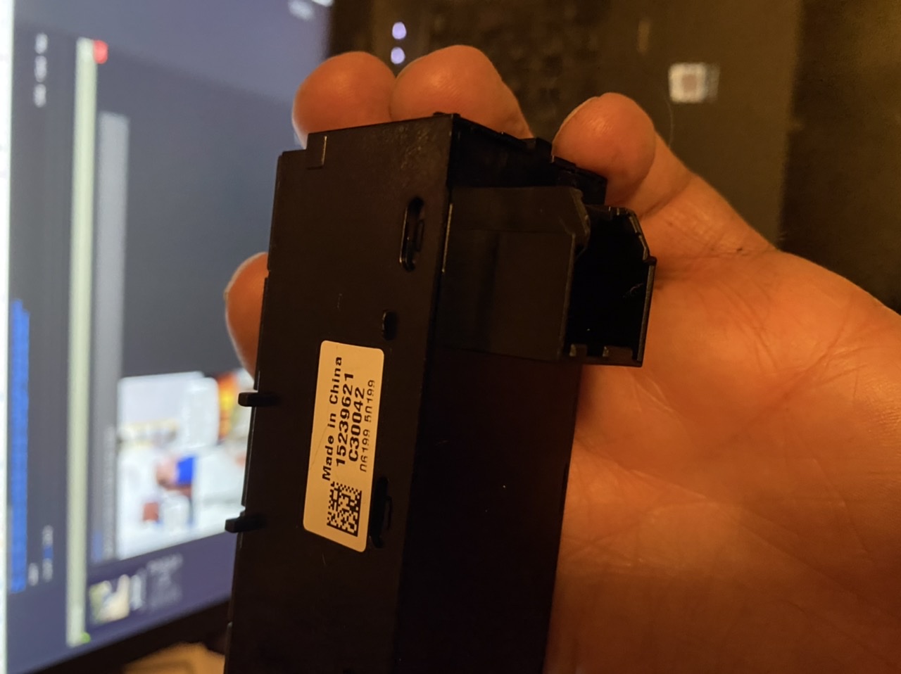

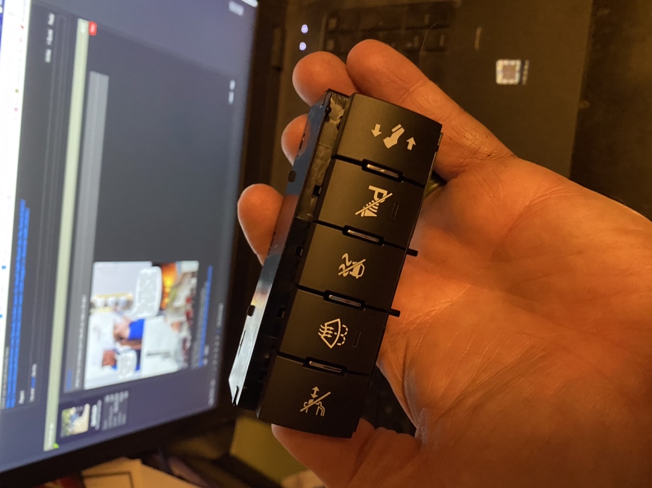

Ooo what's the pn for that?
I had to check mine to see how many buttons i have.
Just Fishing
Can't fix stupid
Aug 30, 2020
4,542
10,219
Utah
about 18 shipped, what the heck. :)
I compared the pin out between the 3 button i have and this one.
Seems to be the same plug, just this one has more pins.
Should be easy enough to add pins should they be missing...
also makes it easier to figure out what pins are for the extra buttons. :beer:

I saw someone on youtube that had the light bar behind the grill as well but didn't really get into how they did it. Is there a post I can look at that shows steps for this because I would like to do this on my 2010 Suburban
