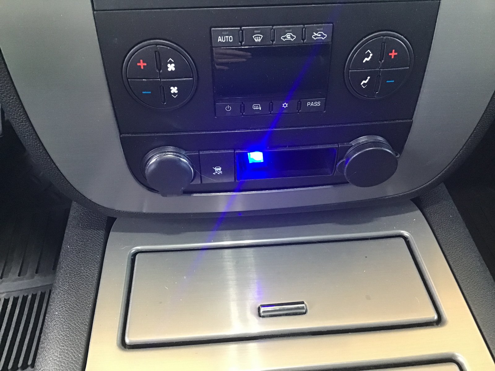

Anybody know of stickers for the buttons that are custom instead of the stock symbols? I was thinking of the ones you can buy for the hvac control head where I scraped off the background faded colors and then applied the stickers and they look like new. I’d like to use one of these buttons for my demon eyes so if one button had a symbol for lights or said AUX on it that would be cool but I don’t want buttons that say one thing but do another. I bought the one that has a pocket and mounted a lighted rocker switch in it but it could be better.

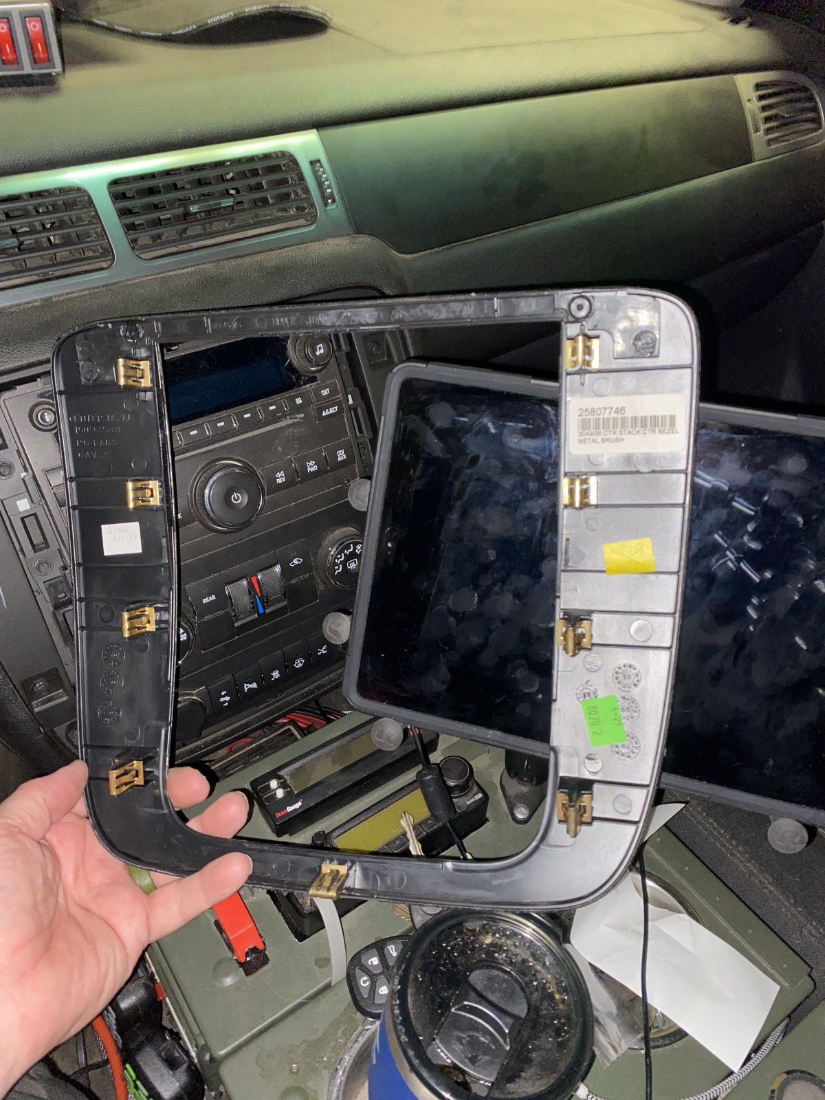

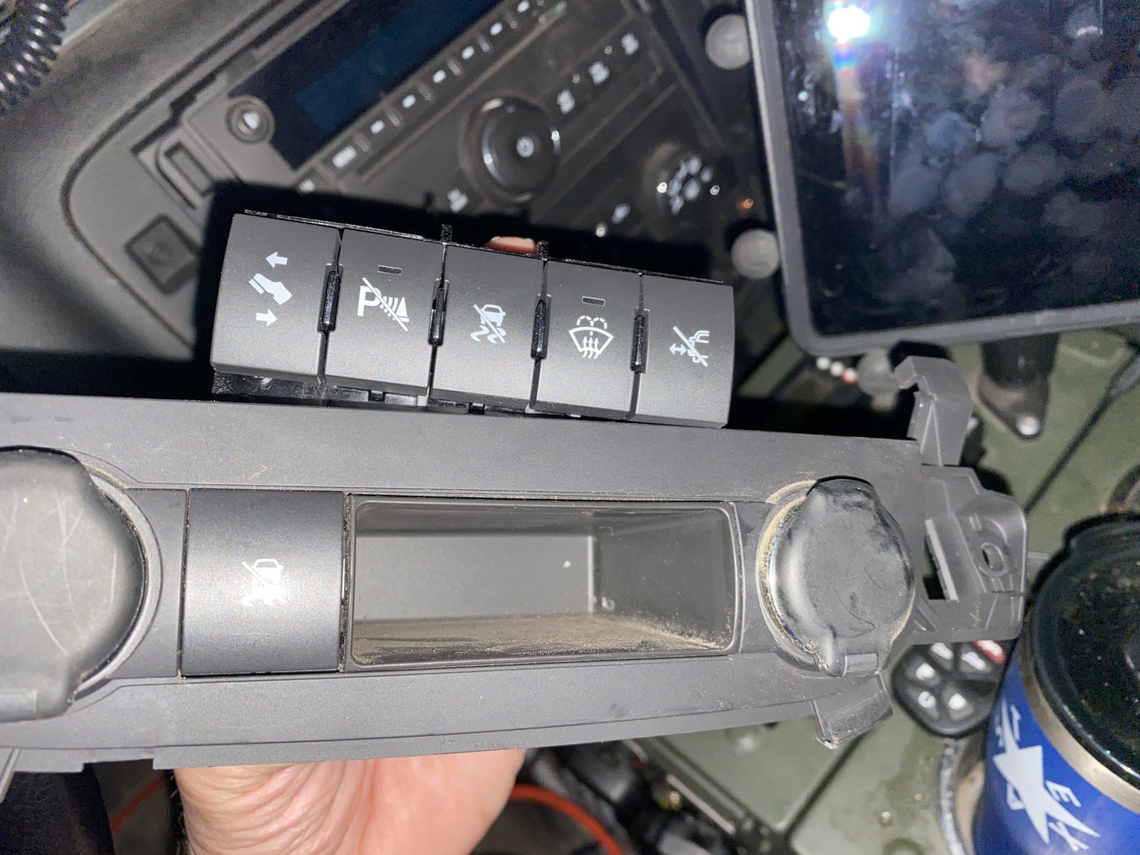

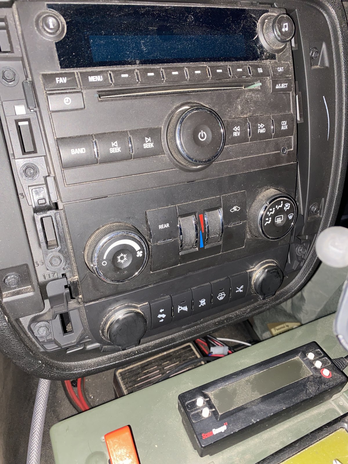

Swapped the switches. BTW, that bezel is a pain. Only 9 clips to not break. Start at a corner, and a thin piece if spring steel would be helpful to be able to get the trim tool in.

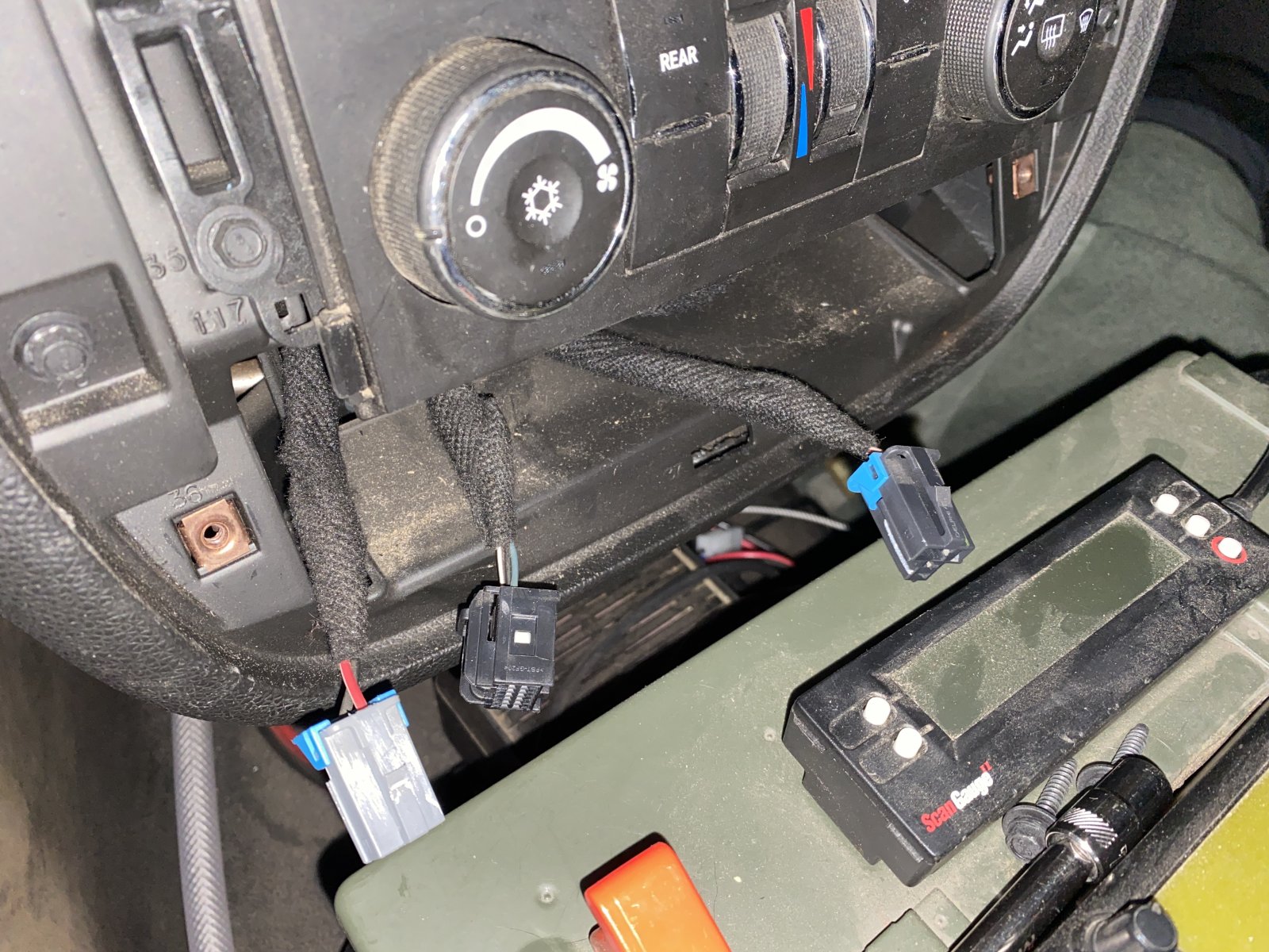

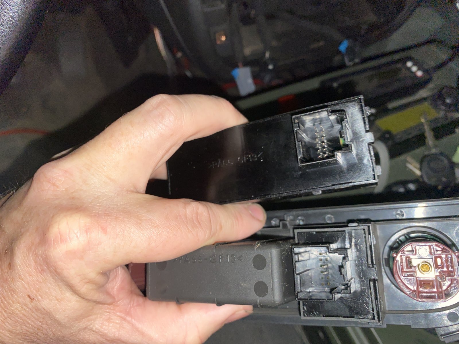

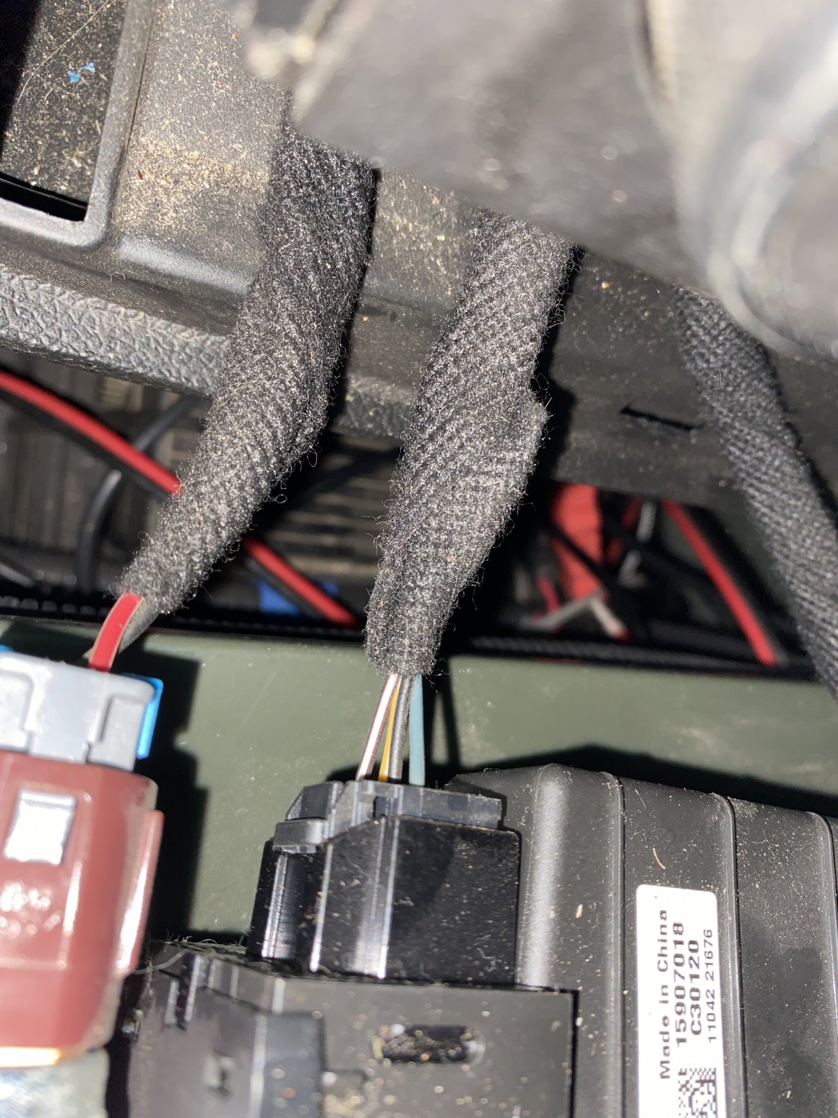

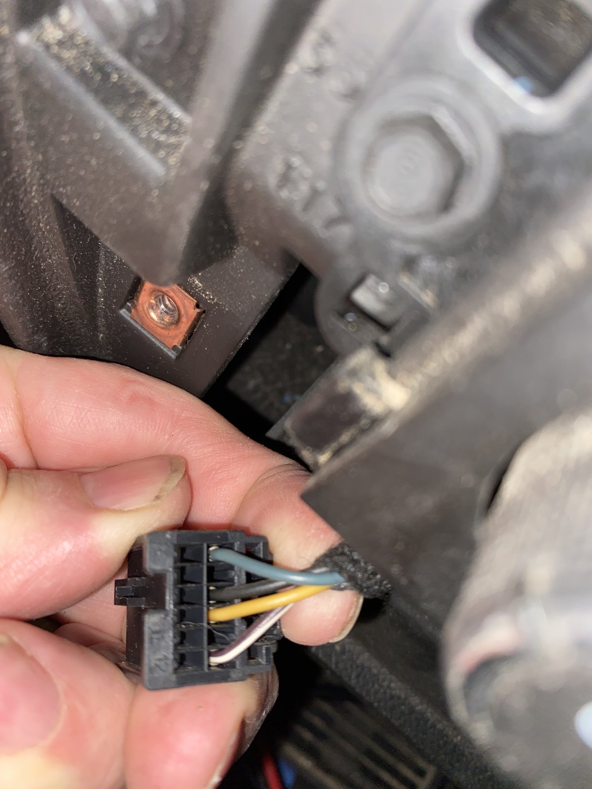

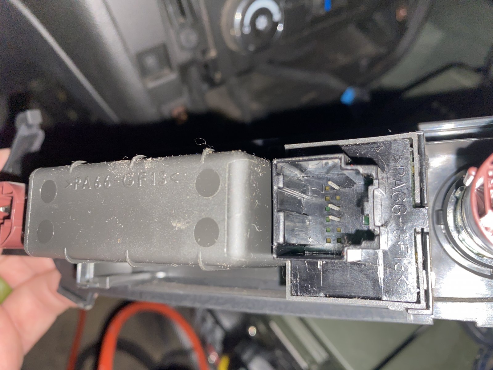

Well, pins 3&4 are for the traction control. I wonder if I get get a fully populated pigtail, or even individual pins with tail.
