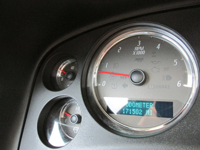

Goimg to pick my 07 denali up Thursday anything I should look for? The oil pressure Guage seems a little low I have to drive it 1400 miles home what should I look for?

Gas, gas is low as well. Sorry, but I just had to!!
As far as your question, is it cold in that picture and if so, did you just crank it up? I have seen oil that low on my 6.0 Silvrado at cold temps until about 15 min after warm up.

There is an issue with higher mileage 6.0 and 6.2 oil pump pick up o rings. Seems that as they age the o ring that seals the pick up tube at the pump hardens and an air leak develops....sort of like a pin hole in a straw. It's worse when cold but gets better as the engine warms up and the seal swells a bit.
The cure is to drop the oil pan and replace the pick up tube o ring seal. I decided to do mine on my 2005 Escalade LQ-9 6.0 at 185K miles. Once I got it dis-assembled I replaced the pump with a new GM OEM replacement that has the new and improved seal.
I would recommend this to anyone with a high mileage LS GM engine.
As far as driving 1400 miles make sure your oil is current and take it easy until the engine warms up. If there is any way to get the pump replaced before the trip do it. The GN pump is around $125.00...expect labor A-Z to be $300.00....much cheaper than a $6K engine swap.
Good Luck.
