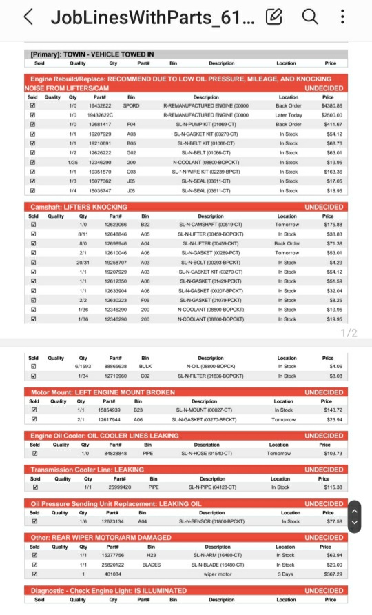

This is the gm dealers initial write up of what is wrong an recommended fix . And yes it is making some noise.

This is the gm dealers initial write up of what is wrong an recommended fix . And yes it is making some noise. View attachment 367847
If you post a video of what it sounds like, we can advise you better. Record on your phone, upload to Youtube as public, and link it here. In my opinion, it's very unlikely that you actually have oil pressure low enough to cause an engine mechanical problem. 90% of the time it's the sensor screen. The rest of the time it's the oil pickup tube o-ring as has already been mentioned. How many miles on the truck?
