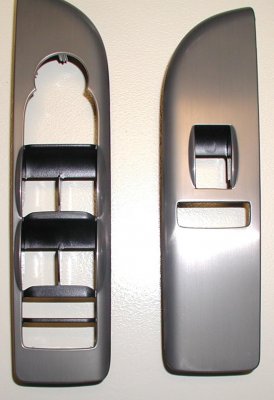

  • Z71 front doors switch bezel replacements -- 1 of 2 -- received more parts than GM schematic sho.jpg

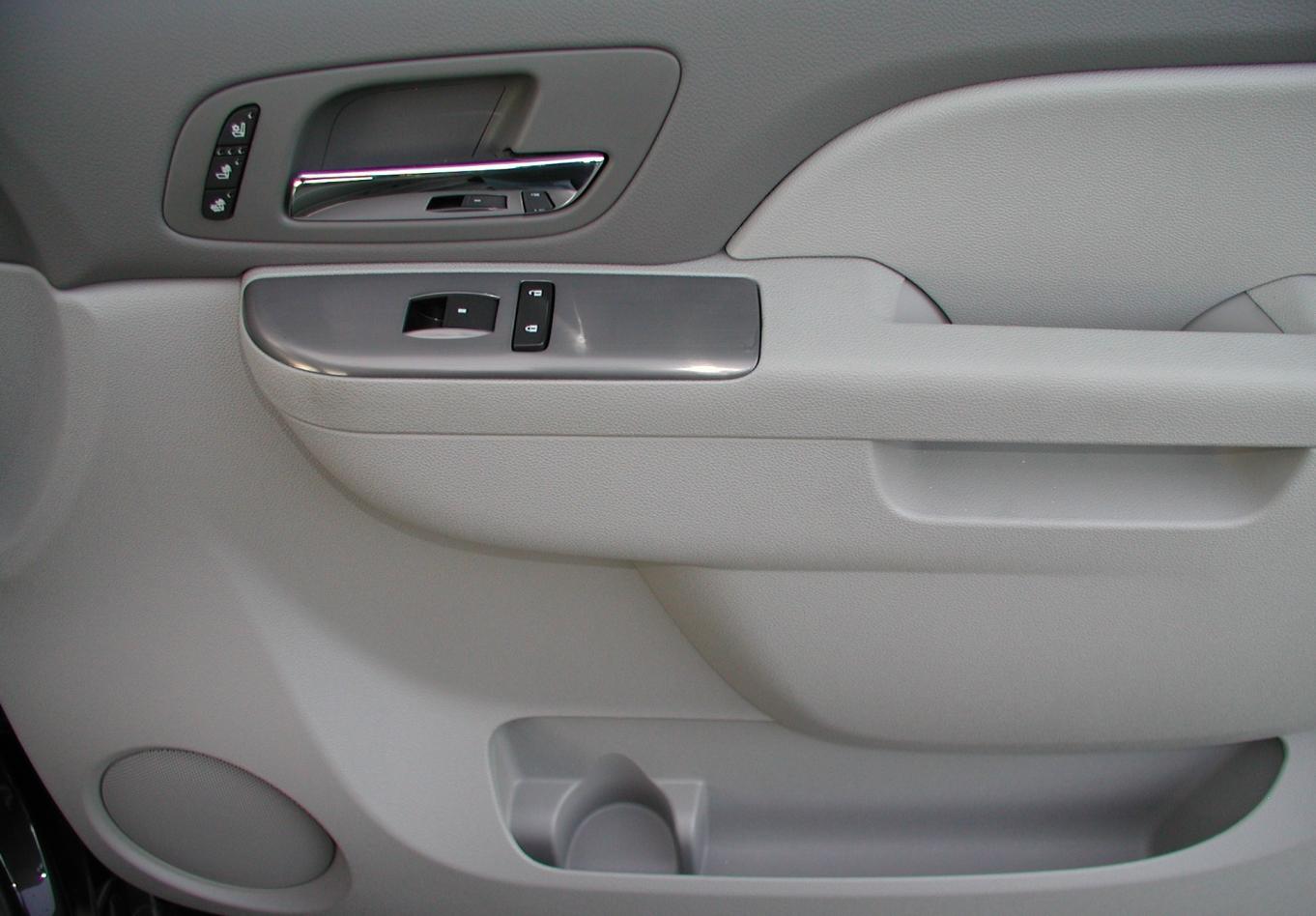

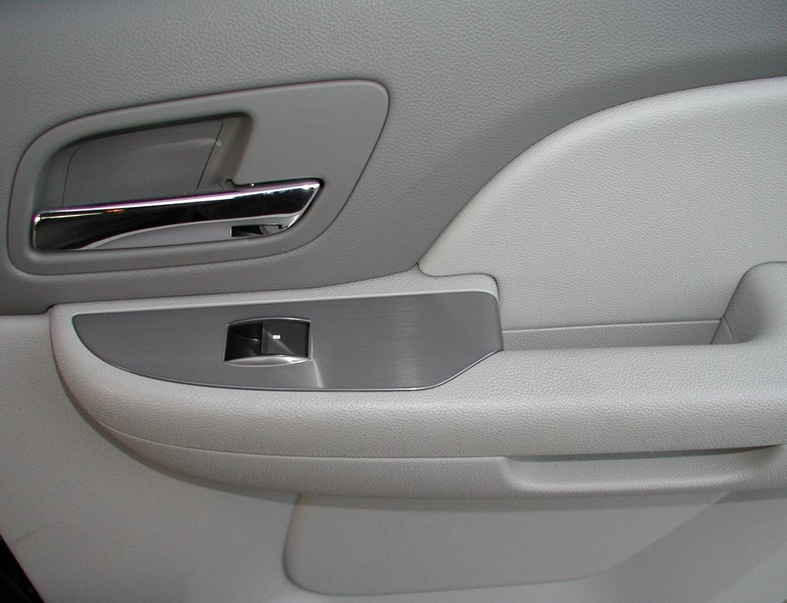

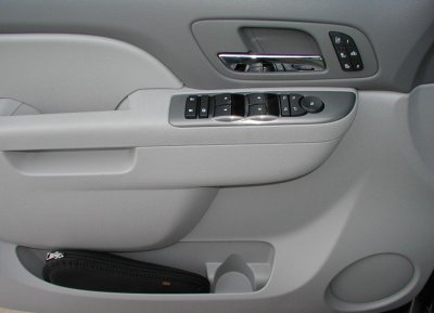

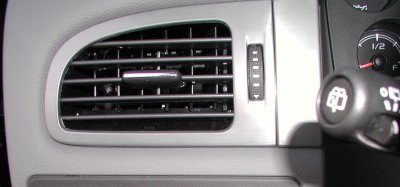

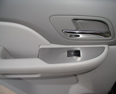

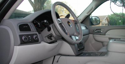

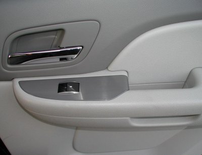

Here are the first five of eight pictures of the finished Z71 trim project.
The fifth picture show a good place to carry a weapon.

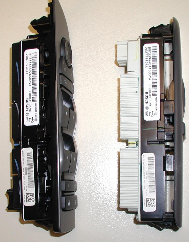

Here are the pictures six, seven, and eight of the finished Z71 trim project.

What's funny is when I started the project, the first piece I replaced turned out to be -- hands down and by far -- the hardest piece to remove, and yes, three or four of the fastener clips got pulled loose from the plastic trim piece as I removed it, but the plastic trim piece wasn't damaged during removal. But it could be if you're not very patient and don't take your time when removing it. It then took a little while to get those fastener clips removed from the vehicle, and those fastener clips could be reused in your case. That problem trim piece was the center instrument panel accessory trim plate (plate that goes around the Radio/AC/Navigation spot on the front center console). If I were to do the eight-piece project all over again, that would be the last piece I would remove!!!!!!!!! You want to build up your confidence as you go along, and I wasn't too confident at all after I removed that piece first.
Yes, the four door switch bezels are so simple to remove that they could be done blindfolded with one hand tied behind your back. I'd start with those four items. One pop with a screwdriver or removal tool and they are out.
Then I'd remove the center console cupholders/storage compartment (only need to use your hands with that item if you put them in the right spot to begin with and lift straight up) and driver side instrument panel trim plate (dash area), which is another one pop with a screwdriver or removal tool and its out.
The only other item that takes a little time is the center instrument panel trim plate, but it comes out very easily if you get the screwdriver or trim removal tool in the right spots as you pry it loose. It helped that I had the replacement pieces to look out when I positioned my screwdriver to do the popping of the fastener clips.
The pieces pop in quite easily. Just put your thumb over the fastener clips so when you apply slight pressure to the trim pieces, the pressure is directly over those fastener clips rather than to the sides of the fastener clips.
While I didn't take any pictures of the undersides of the removed trim pieces (either threw them away or in the case of one item, gave it away), here are two links that helped me greatly when I was changing out the eight pieces:
