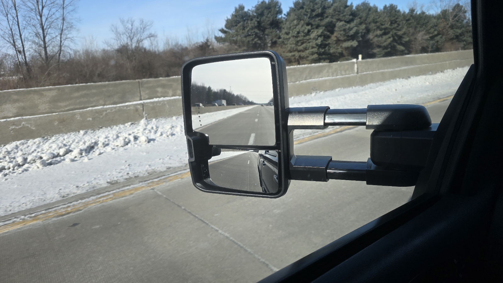

Some finished installation pics:

I'll start with the bad - nothing major, or even minor - I'd call them nits to pick
1) I wish the convex mirror had more travel. I see too much of the truck, and that's as far as they go.
2) The red signal LEDs in the upper glass are BRIGHT. They're also omnidirectional, so the brightness is a little annoying at night. The Trail Ridge signal mirrors were more unidirectional, so you could they were on, but they didn't shine in your face.
3) There's a little vibration of the upper glass at highway speed. Nothing that makes images hard to see, just an annoyance. They're not rock-steady, but I'm also pretty sure I've never seen ANY rock-steady towing mirrors.

Yes, unfortunately. The convex/lower mirror doesn't have enough travel to pivot more towards the outboard. I dunno - maybe it's "more convex" so it's just giving me a wider field of view. You can see in my two pics on the highway, that the body of the truck is prominent in both convex mirrors - I'd rather have more outward visibility, but they're at max travel. And there is no blind spot - no way a car can be next to me on either side without being seen.
I'm learning to live with it, because I can see my rear tires, so I do have that pinpoint accuracy when backing up.
