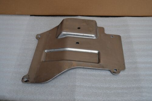

here is one
oil pan/front diff skid plate
another
transfer case skid plate
here is the front one by rodlouvers

here is one
another

I have these on my 2012
The transfer case one is black painted or powder coated steel
The oil pan/front differential one is aluminum
