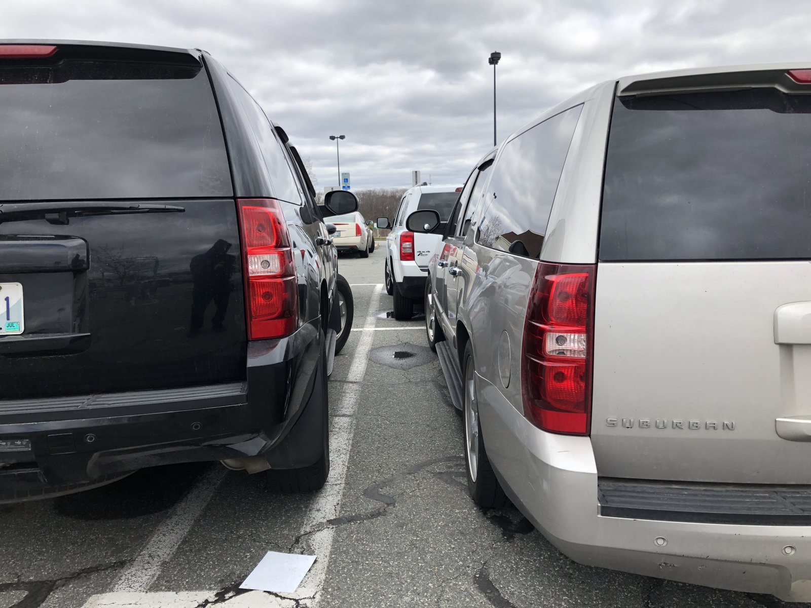

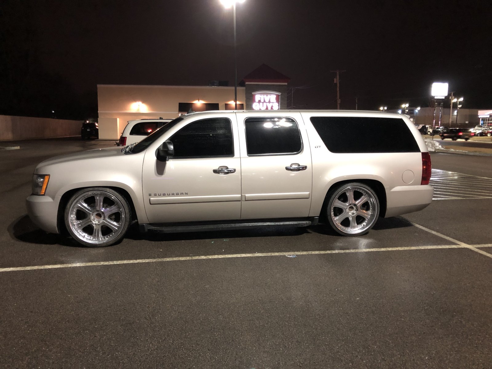

Funny picture I took yesterday at Lowe’s parked next to my dad’s van

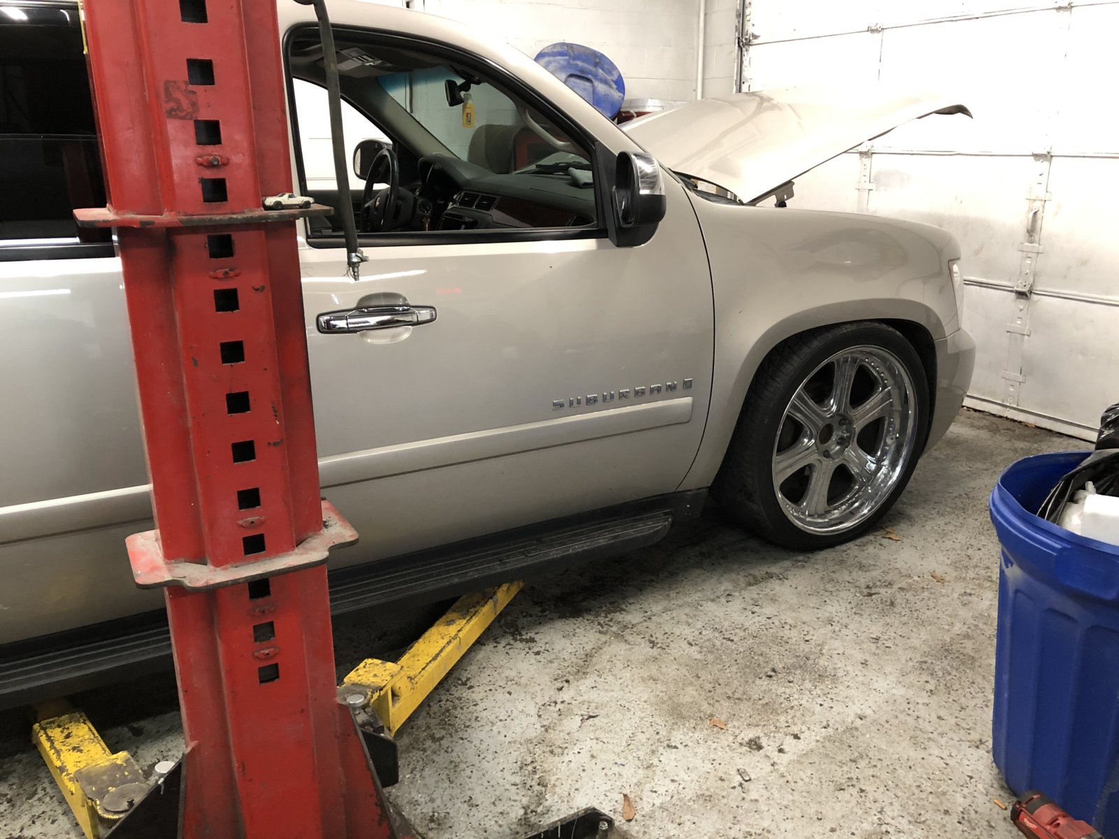

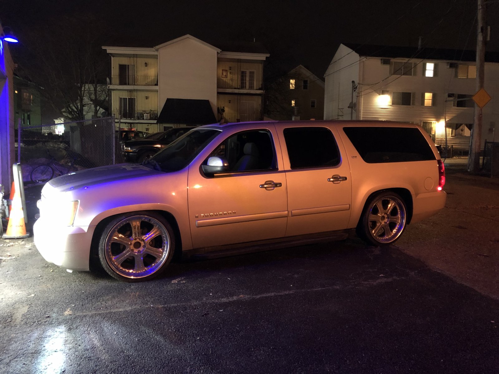

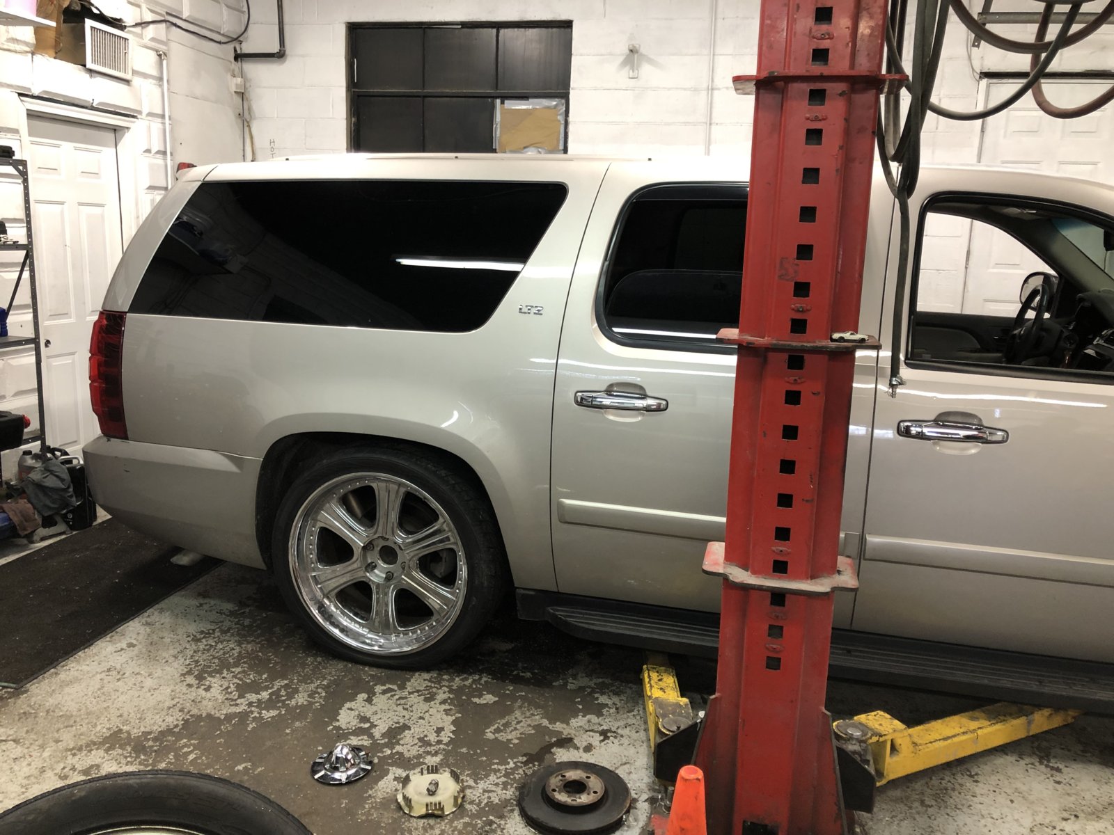

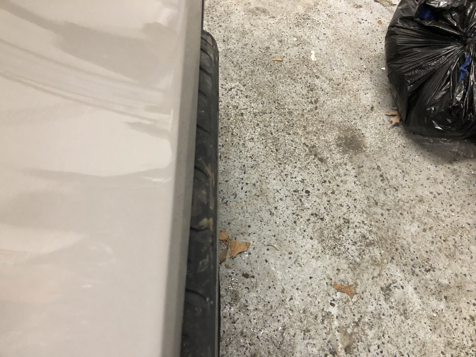

Grabbed some 24’s today for $150. They need 4 tires but that’s fine because these are WAY too big with this drop. They’re 305/35/24. I’m going to run a 275/30 in the rear and 255/30 in the front. The truck in the pictures is sitting on the front tire and has over an inch to go down all around

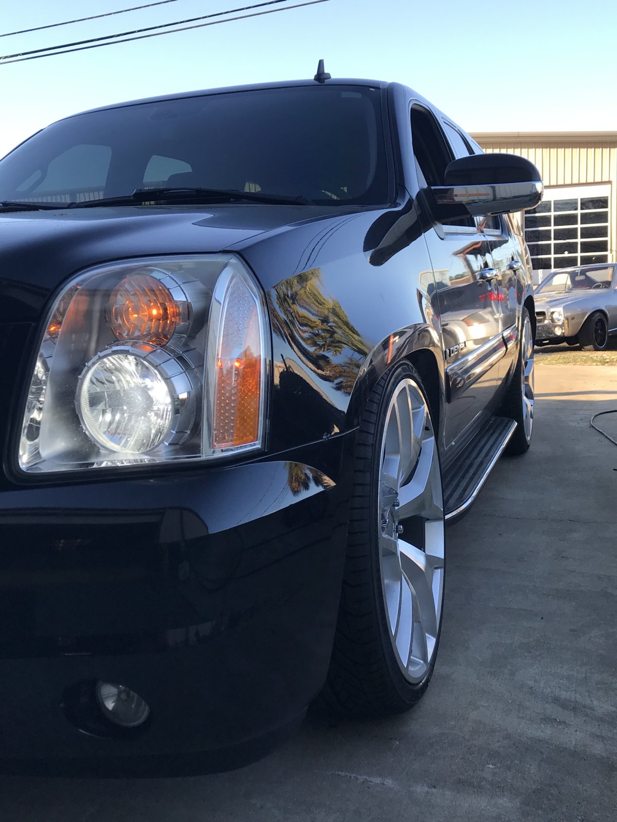

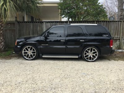

My 2005 2wd Escalade 4/5 DJM Lowering kit and 24” Snowflakes (Sold)
Current ride, 07 Yukon Denali Street Edge 3/4 Lowering Kit w/26” Snowflakes and 295’s

The Yukon looks really good. 295/30/26? I know I’m going to have to add some camber to the front to get the tires to clear

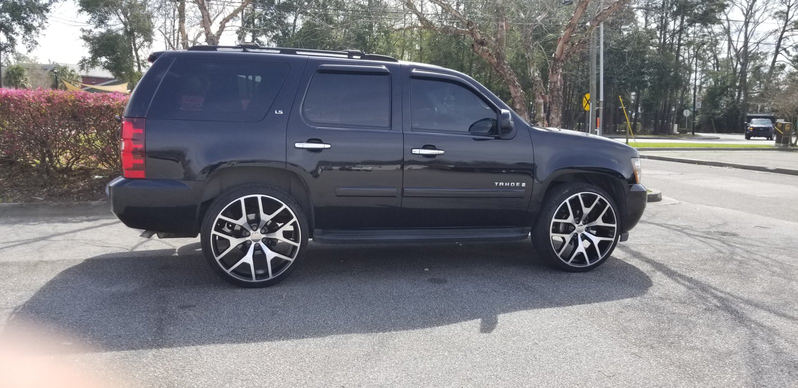

Doug, the pic of the Yukon was taken right off the rack..... pre alignment. Im going to align it today however I fear that adding too much camber won't allow the travel it needs to clear the fender. I used a +30 offset to push the wheel as far to the outside of the inner fender and 1/4 panel as possible... Im also going to have to play with the caster, off the rack the front wheels sit about 1.5" too far back in the wheel well which off the rack caused some minor turning issues. Before l left my shop last night I cut a pair of 1/2", 3/4" and I should arrive to 1" strut spacers on the cnc machine just in case I need to lift it to correct anything I can't correct in the alignment. The wheel wells eat up the 26's and a static drop that tucks a 26, just looks bad ass to me... I hope I can keep it the way it is without having to add any spacers.
Yes they are 295/30R26's and I wish I would have done an Yukon XL or Suburban like you did.
on a side note, my wife said "great now you look like a drug dealer" hahahahah
