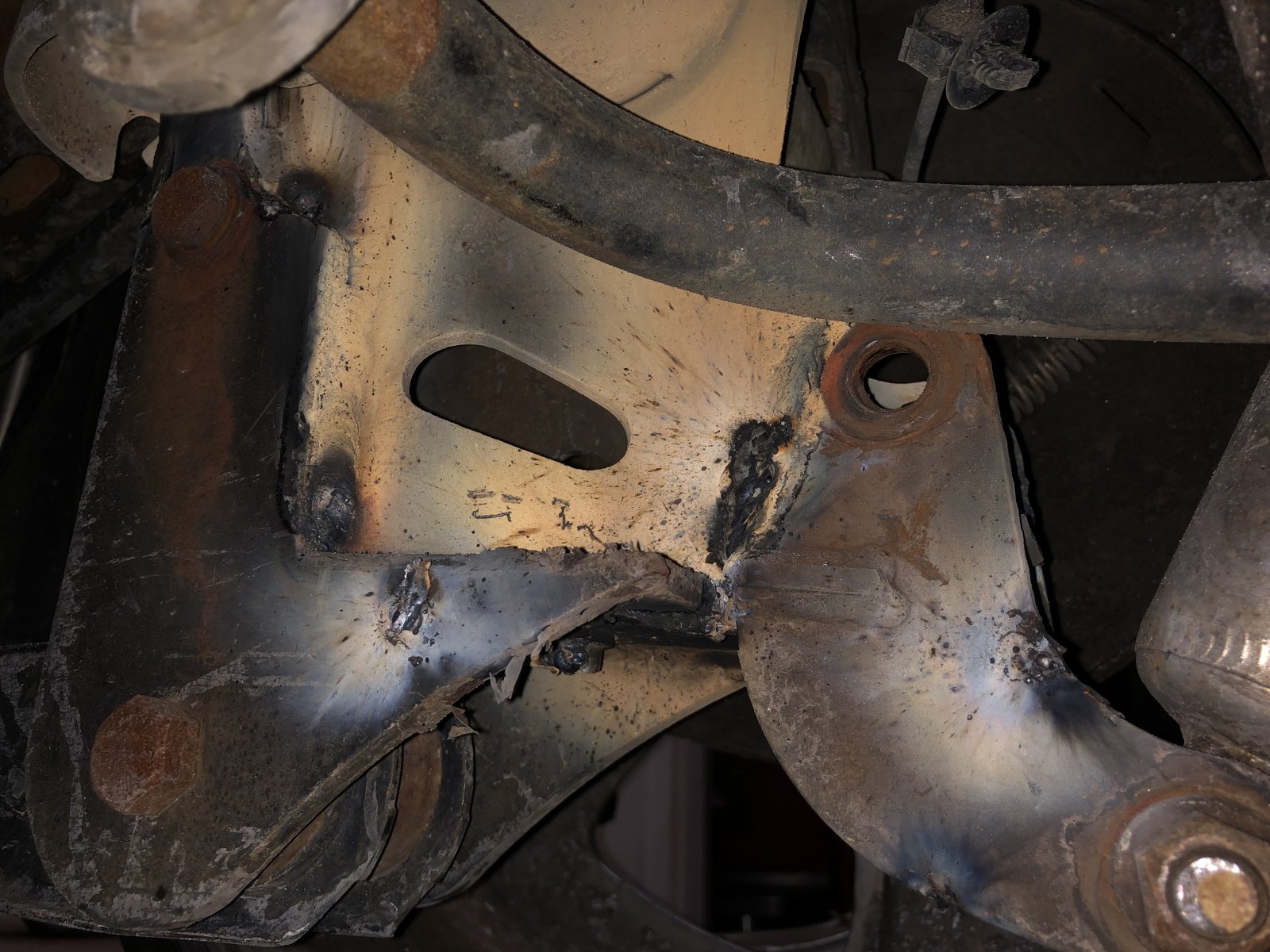

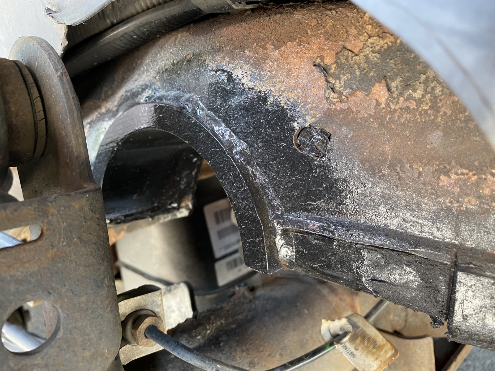

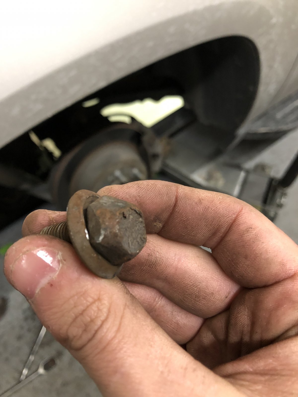

I figured out why the back of my truck was riding like dog shit. The trailing arm bracket bolt pulled through the washer so the whole bracket was just loose. I welded the trailing arm bracket and shock extension brackets right to the rear end and now the truck rides like a dream
Hmm, interested in seeing this. Could you snap a couple of pictures of where you welded them?
Had to take the opportunity View attachment 220729

The truck never goes up in a lift and I’m definitely not fitting underneath lol. I just welded the brackets anywhere they came in contact with the rear end

Forgot I sent @Leo1103 a picture when I did it. Yeah it’s the DJM stuff. After speaking to a bunch of people, I regret doing drop shocks and shock extensions. You’re supposed to do one or the other, not both
And the drop shocks that go with the kit are a horrible combo with the 6” drop spring.

Cool, Thanks.
One or the other, not both? Huh, that's a first.
I thought without the extender the angle of the shock would be almost 45 degrees (that's and exaggeration) but it would be at an angle where the shock would not perform as it should being more upright.
I need to get under mine, its about that time to re-tighten everything, again.
I may end up pulling my welder out and just zap everything.

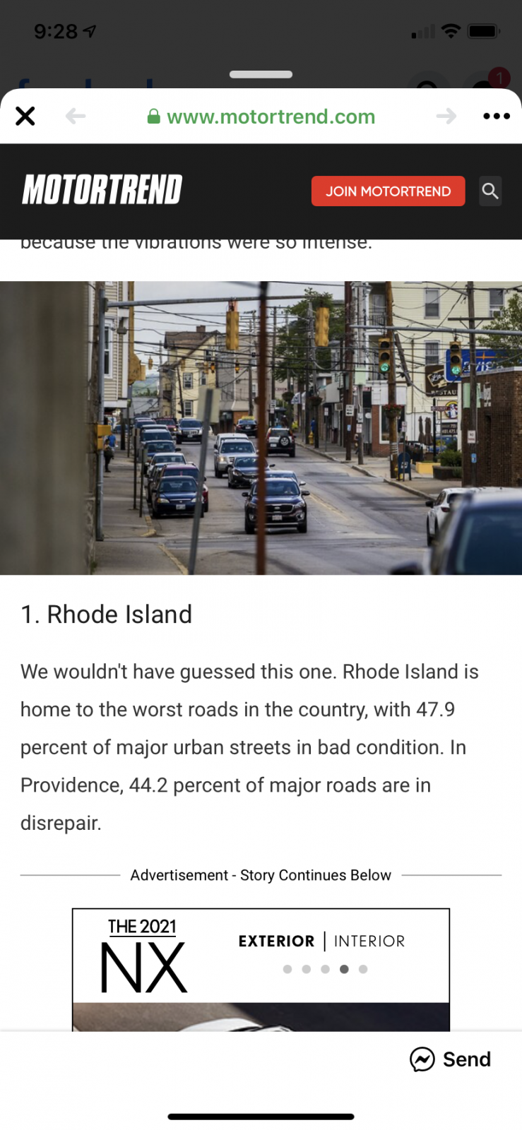

Thanks guys. And we were just listed as having the worst roads in the country and I get around no problem ‍♂️

Thanks guys. And we were just listed as having the worst roads in the country and I get around no problem ‍♂️View attachment 258970
Hahaha how do they take those poles anyway?

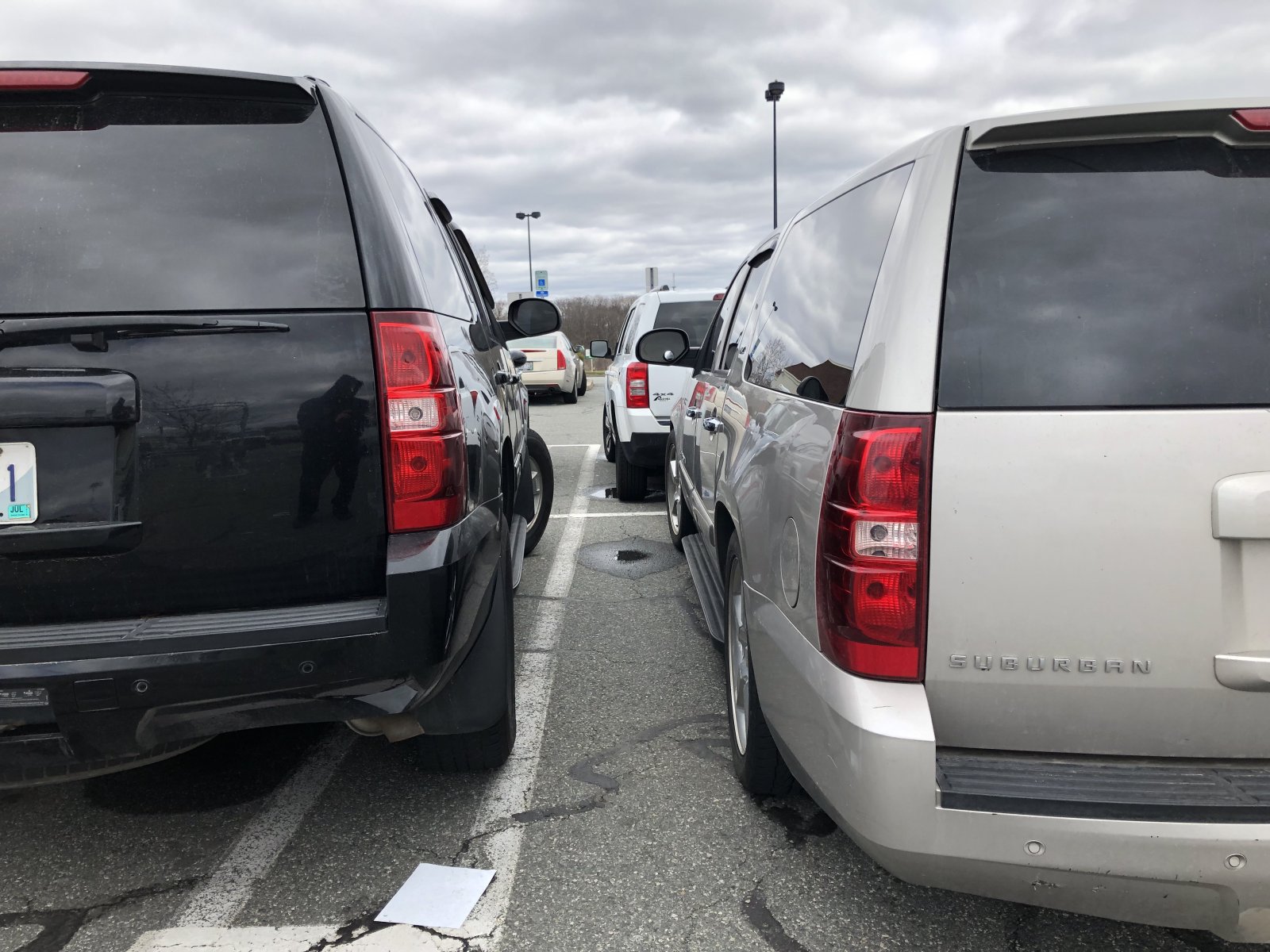

This is when it was like 4” higher in the rear and 2-3” higher in the front
Looks good. I like it better lower :)
