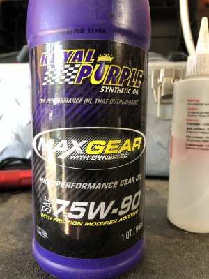

Ok I am now officially irritated. I have always used AC Delco 12378261 which now comes up as 88900401. Last time I decide I wanted to use Royal Purple because it’s the best, right? So I used their 75-90 synthetic gear oil. I have read it’s good for the G80. I didn’t look at the label obviously. Their website stated it’s GL-5 and GL-4 spec’d. The damn bottles state at the bottom that it has you know what. Grrr. It’s about $100 between the 3 quarts of oil and the gasket. I have not noticed any issues with the diff. I’m now going into the rabbit hole to see if the Royal Purple is ok. If I’m not back in 3 days send help. Probably should be a shrink and an anger management specialist.

I’m leaving the RP in mine. I have read enough. There’s plenty of guys that run it with no issues as well as Amsoil or Mobil 1 which all have FM. Seems the worst that can happen is chatter, at which point I would change the fluid to something else. I think GM just wants to sell their product for twice the price as anyone else. I read you just need the GL5 spec and just don’t add ADDITIONAL FM. Here’s what an Eaton expert has to say:
