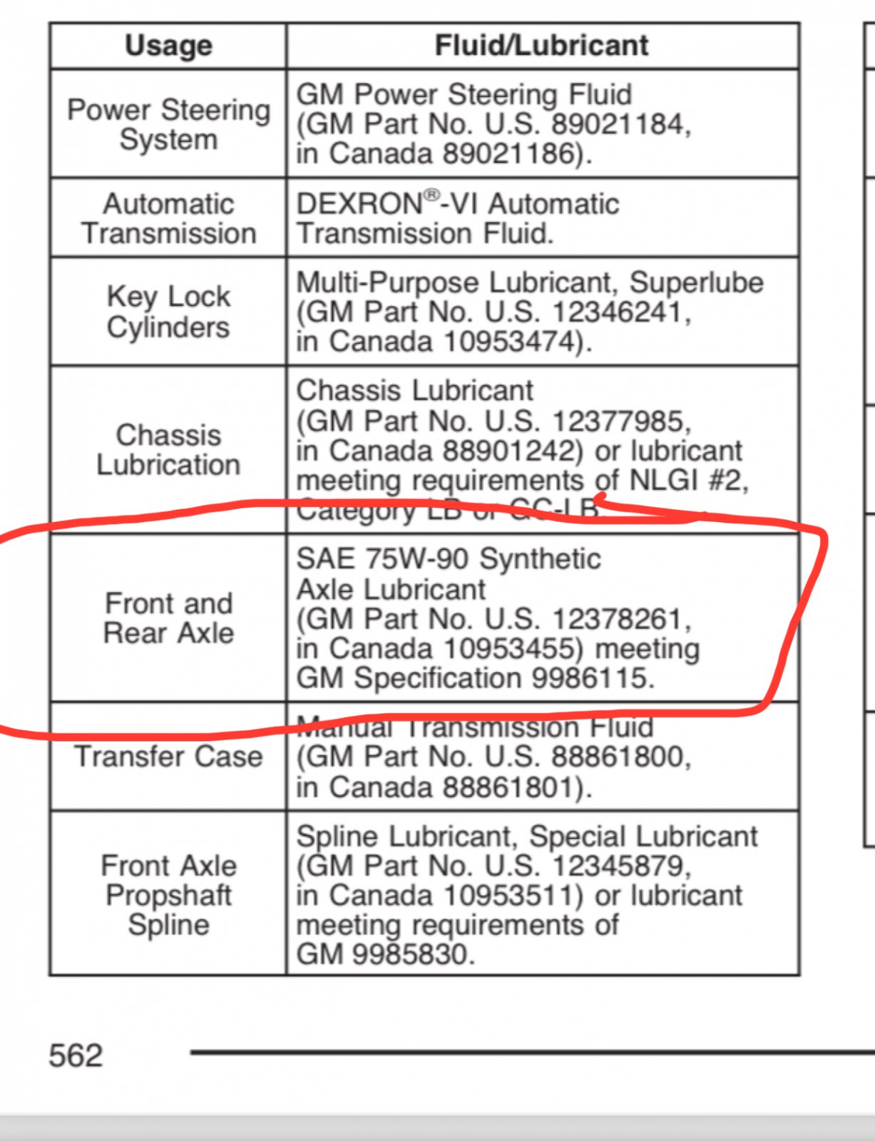

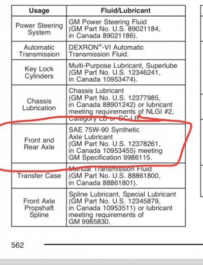

My manual doesn’t say anything about additives. It just says use 75-90. How can you tell what type of diff you have?

If your RPO code sticker says G80, you have the LSD. If the manual says nothing about additives, then use no additives.

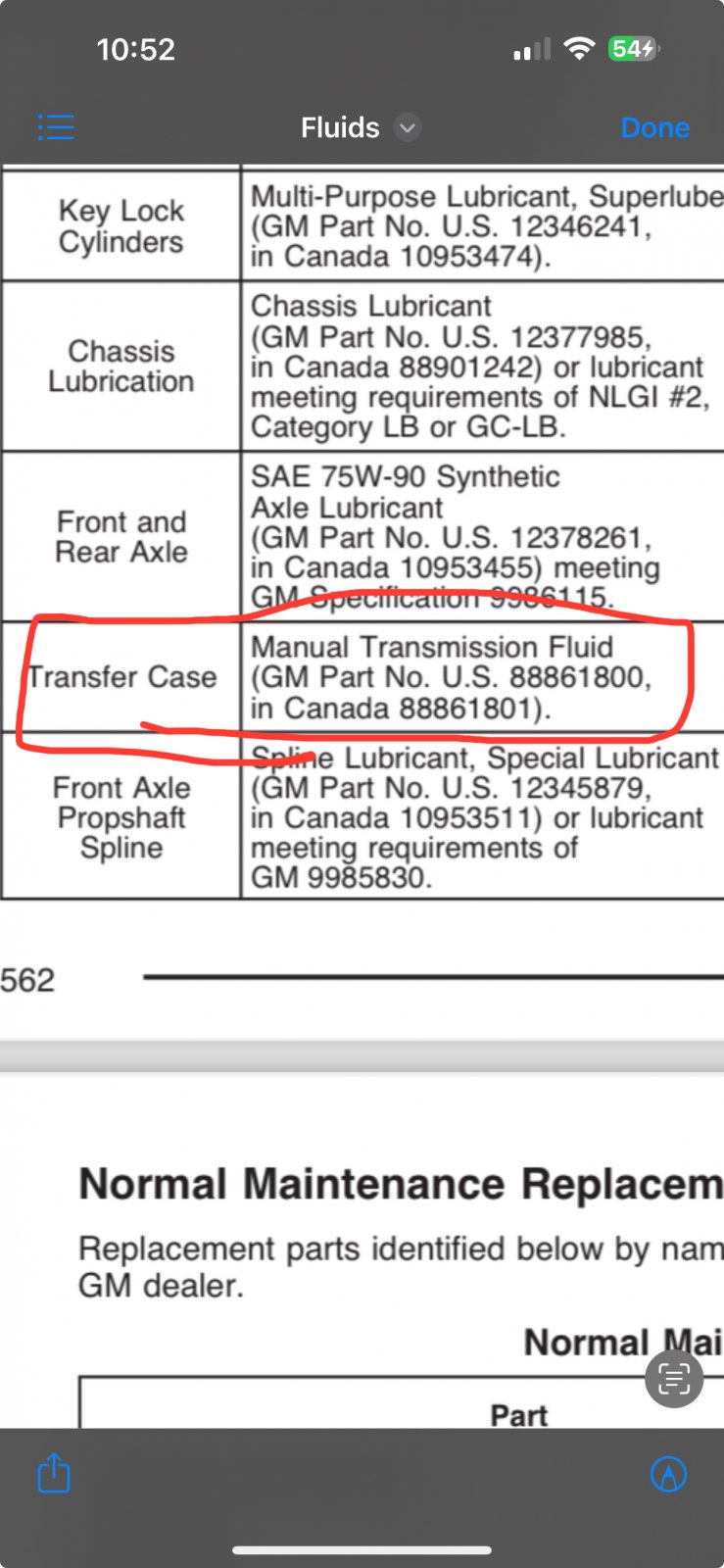

One more question guys. Transfer case question. I’m also going to change that fluid but I’m a bit confused. My OM says to use manual transmission fluid but I’ve read that people are using Dexron 6.
Depends on the TC. Many of them do call for ATF in the OM. Use whatever the manual calls for.
