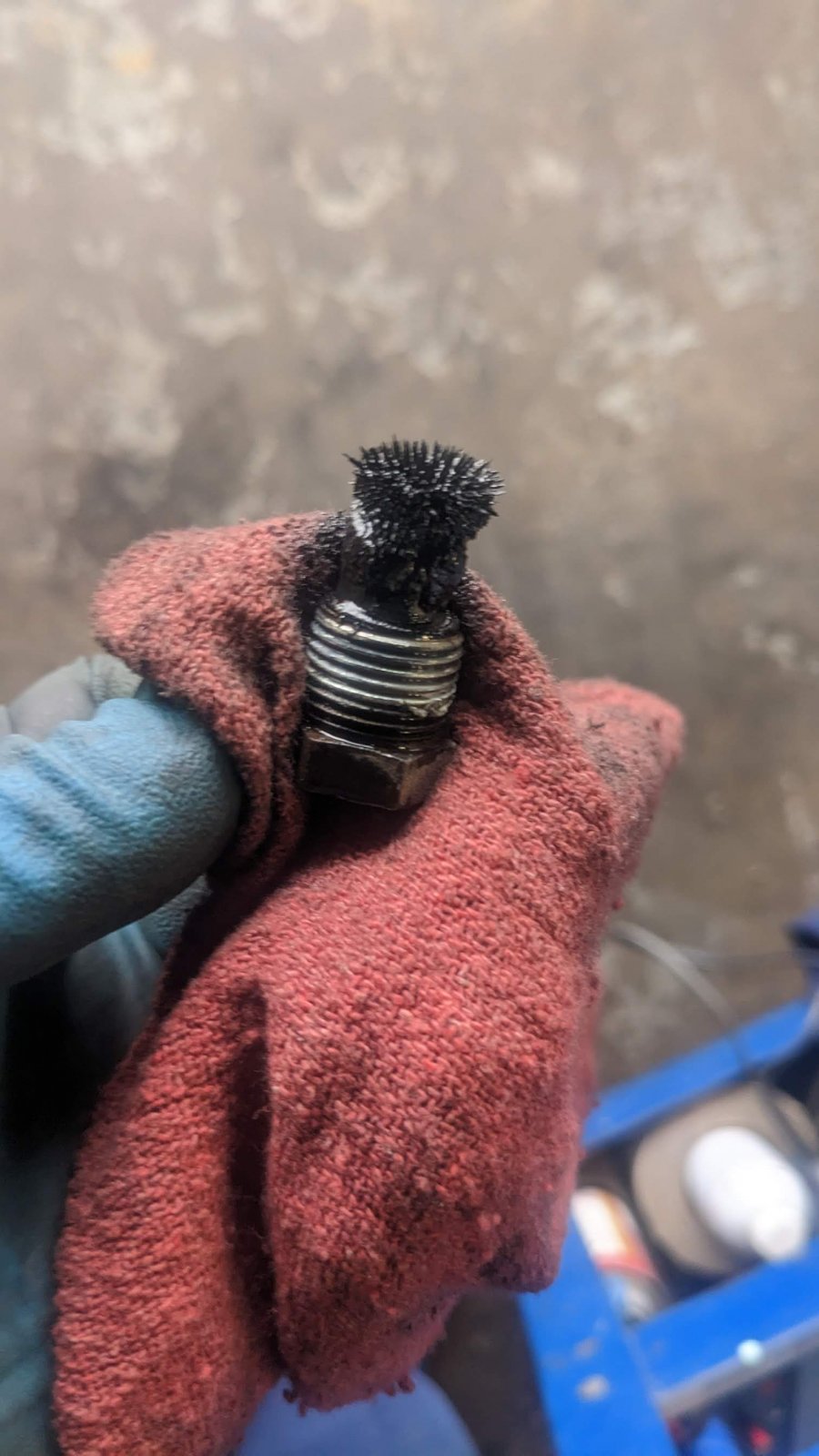

I had one 135k on mine when I got it. no clue how it was used but I doubt every hard life being a hybrid. but it could have been in auto a lot. the t case fluid was black and the magnetic drain plug had a scary amount of fluffy on it. I changed the fluid and then again 500 miles later and just hope. but so far it seems to be OK? not that I ever use it besides just testing to see if it still works.
