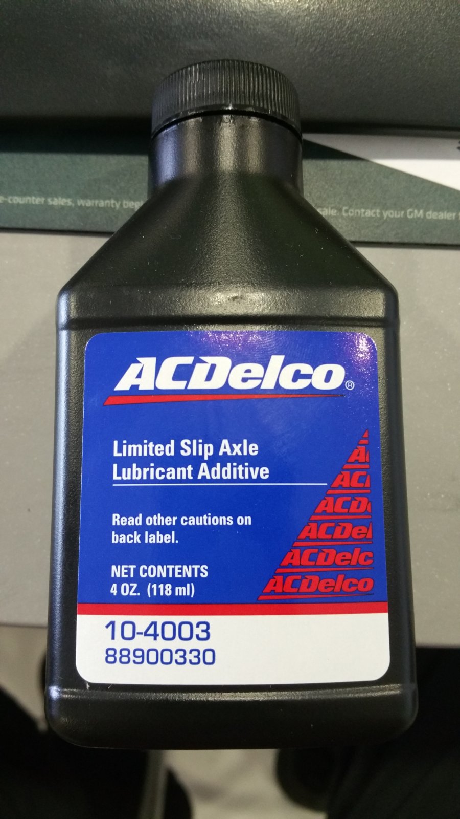

GM# 88900330
ACDELCO# 10-4003
THIS MUST BE ADDED WHEN SERVICING YOUR REAR DIFF, IF YOU HAVE LIMITED SLIP.

Soooo much contradictory information being thrown around in this thread.
Once again, for full size SUV & pickup trucks, no modifiers should be used or added.
STRICTLY gear oil, nothing more & nothing less

I apologize for all of the confusing info being posted here. Our more active members that have posted here on this subject are far off the mark this time.
@915_Tahoe
That lube has no business being associated with a Tahoe in any way. These trucks do not have a limited slip type diff.

Don't even mention limited slip, doesn't apply except towards creating more confusion, which is why the OP started the thread in the 1st place.
GM# 88900330
ACDELCO# 10-4003
This post should be removed from the thread, entirely

Yessir. The G80 in my old 1980s Buick was a limited slip. I can see literature where the locking feature was added to trucks in the 1980s but have not looked into the history of that. So even the GMT400s could have it but I do not know as I have not looked.
Anyhow, here's a quick explanation on what it look likes and how it works:
Yes. The GMT400 had it.

Watched the video and looked like just a regular locking rear carrier, nothing limited slip about it.
Either locked or open.......
