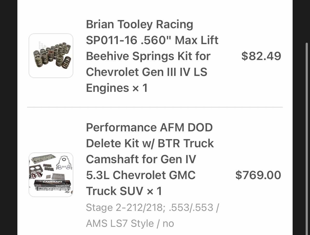

Bought Black Bear Performance Tune for the computer side of the delete. Grabbed an AMS Racing AFM/DOD delete kit with a stage 2 cam and new beehive valve springs. (Hopefully pictures I added show up).

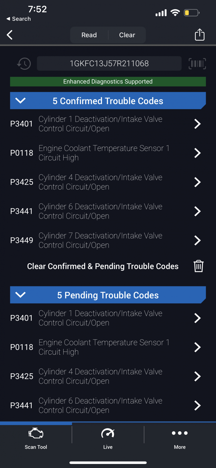

I solved the sputtering out issue however I am waiting on the BlackBear tune files to get in to turn off the AFM/DOD in the computer.
Currently, these are the codes it’s throwing (I fixed the temp issue)

oh yeah, I forgot you deleted afm. it will run like crap till it's turned off in the tune now. at least from what I read.
until then. I wouldn't worry to much. maybe do a compression check just to double check none of the valves bent a bit and aren't sealing. since you bent the push rods, they did hit the piston pretty hard and it's possible they are leaking a bit.

I did. They looked the same as when I pulled them. Not great but nothing that indicated they immediately needed to be replaced.
Yup, those are vlom codes. That tune will fix you up. Good job finding your root cause.
