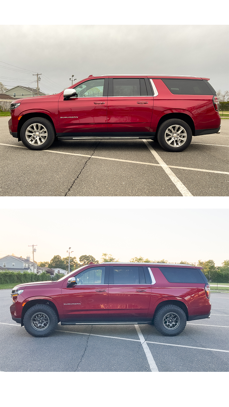

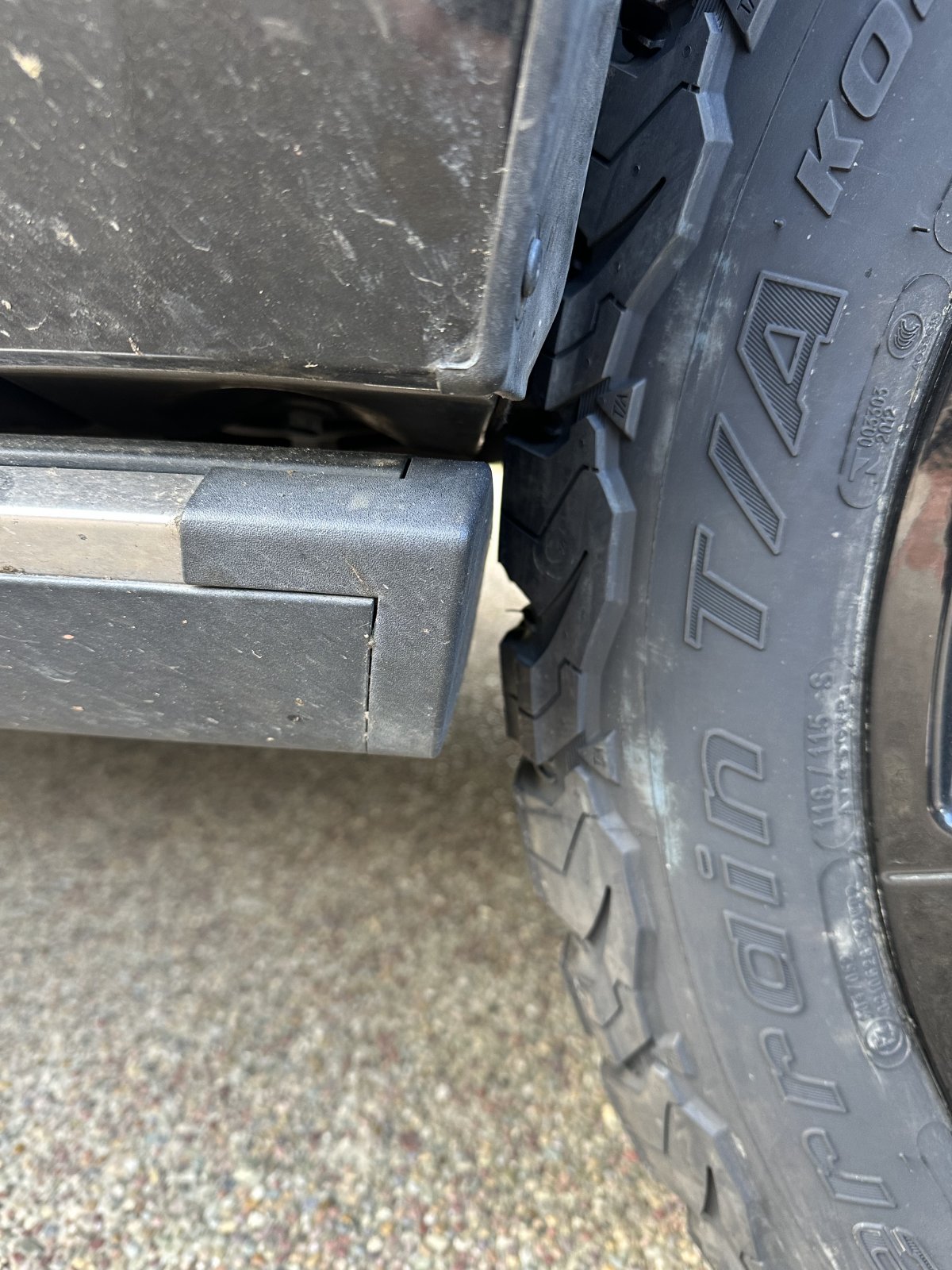

I just mounted 295/50/22 BFG’s on stock wheels. SuspensionMaxx leveling kit and only used 2 inches of the 2.5 available. Rear is stock.
Running into issues with run at slight turn when in reverse, almost to the point where it rubs on the running boards. Looked fine at tire shop. Might have to go back to 285/45/22 or bring the front up a bit.
Any thoughts?
Just do a little trimmin!
Looks great !

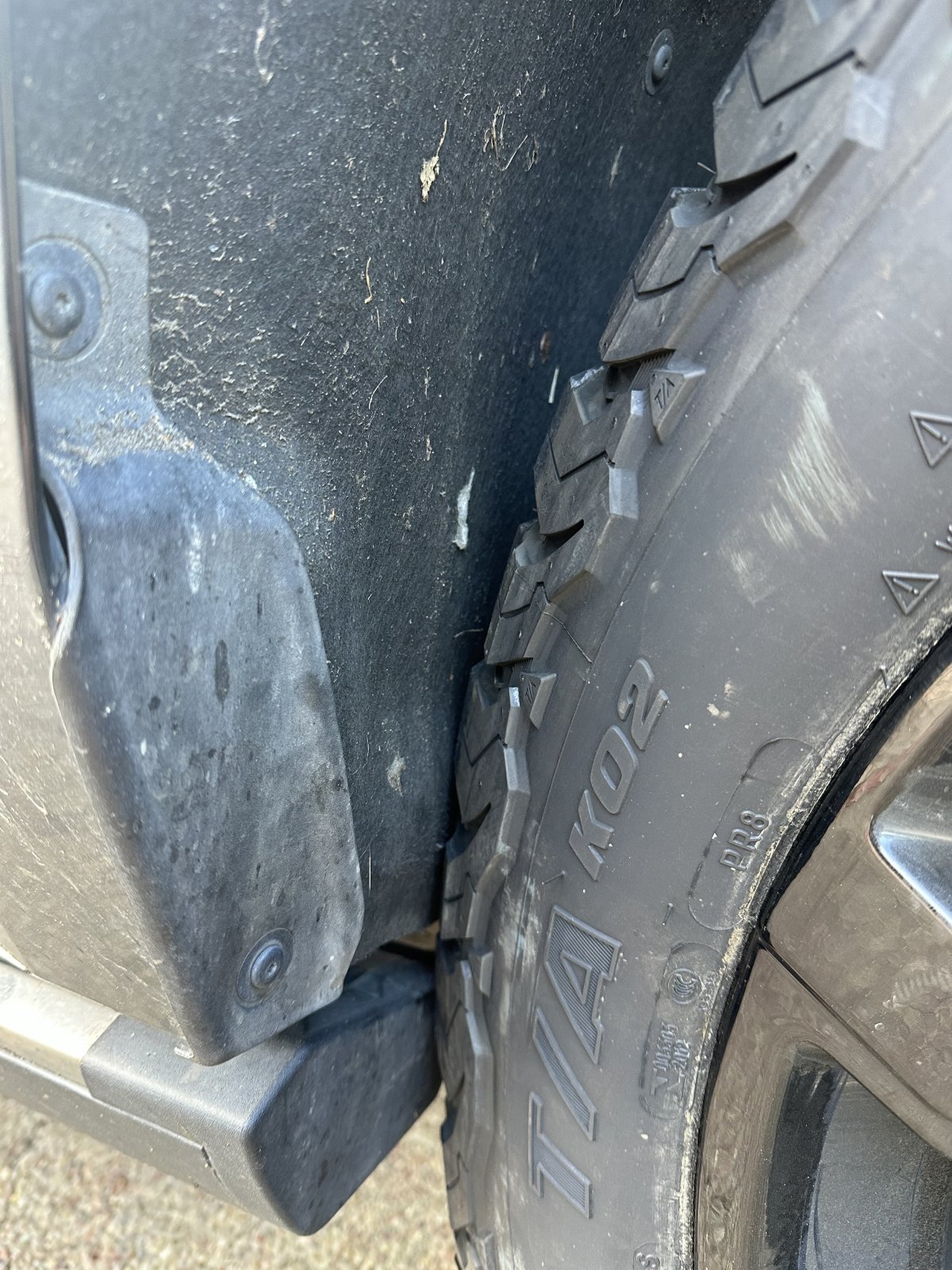

I’m surprised as your tires are very close to the stock Z71/AT4 size. I’m running a 3/4” taller tire (315/70R17) with slightly less offset at stock ride height. I also have the power running boards. I only rub at entry / exit ride height (approximately 2” lower than normal).
Based on your description, I suspect you haven’t done anything to the wheel liner, and you’re rubbing the liner just above the running board. There is a bracket behind the liner, just above the running board, held in place by 4 bolts. Remove the bracket the tie the liner back to the frame. I used a self tapping screw into the small divot in the frame. Once done, it’s completely unnoticeable from outside and you would have to be quite familiar with a Tahoe/Yukon wheel liner to tell, even with the tire removed. Sorry but I don’t have any pictures of my mod. There were several good photos a few posts back showing behind the wheel liner and the Westcott Design YouTube channel has several videos on their fender liner kit. Strictly speaking the kit isn’t necessary but should make the mod even easier.

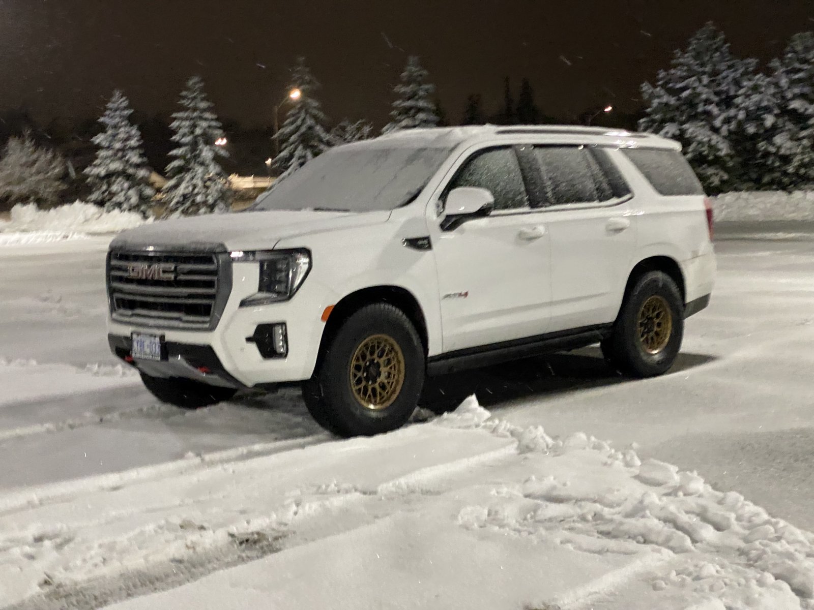

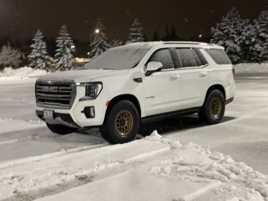

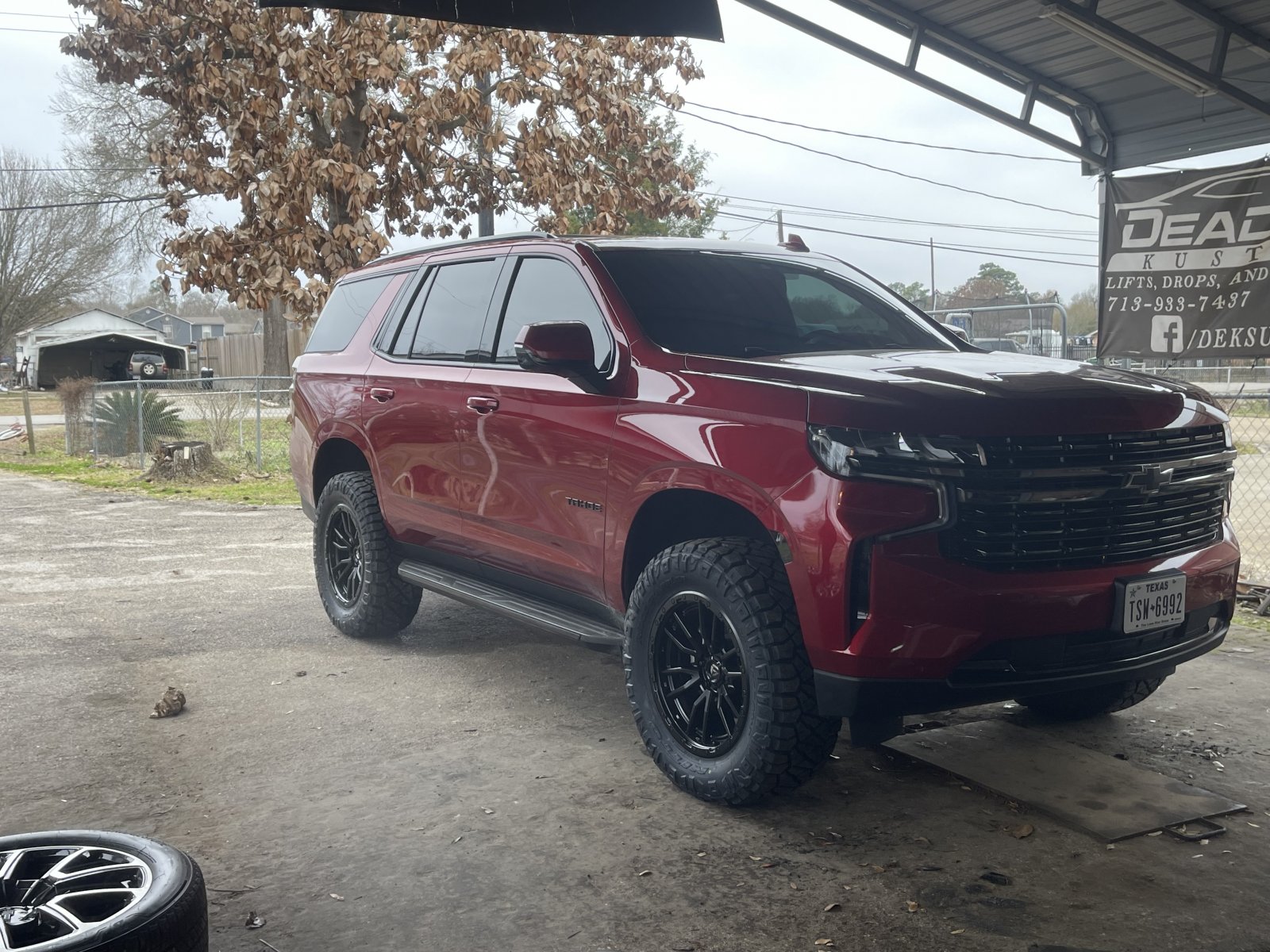

View attachment 419311Finally after trying to decide what to go with. Thanks to all of you who have posted their setup. Really helped me decide what to do lol
3.5” rc lift
20” Fuel rebels +1mm
Wrapped in ridge grapplers 35x12.50
Was trimming/cutting pretty extreme for the 35’s? I’m on a 3” readylift and temptation to move up to 35’s is there. Speedometer 2-3 mph low?
Ever93
Dec 13, 2023
There was minor plastic trimming/pulling the wheel liner back some to take away rubbing. I have no rub at all now at full turns. This was with the 3.5” RC too. As far as the speedo I haven’t checked how far it’s off but my guess would be that it possibly is off a tad now. Anyone know how I can check on that?

I really appreciate the response. I’m going to take a look in the morning and will post a few more pics of the main issue. I’ve been looking at replacement tires/sizes and would rather not change at this point.
denalijoe415
Jan 24, 2024
Here’s a couple photos of the area in question. You were right on about the screws and placement of rub. Gonna get to work shortly.
