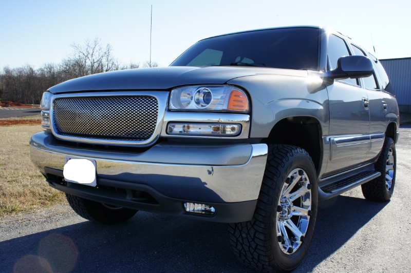

Thanks for the compliments! I did a denali headlight retrofit with morimoto projectors, euro clear corners, new fog lights, and debating getting led tails. I will post some more pics when I get all the lights complete. For the 5100s, they can be ordered for stock length which would require shock extenders or you can order the longer shocks and avoid the extenders. I highly suggest to order the longer shocks and below are the part numbers with year/model info (repost from previous page).
Front - Bilstein 5100 Offroad Shock: F4-BE5-C153-H0 (99-06 0-2" Lifted Chevy Tahoe shock)
Rear - Bilstein 5100 Offroad Shock: F4-BE5-6682-H8 (94-02 0-1" Lifted Dodge Ram 1500 shock)

Well I did some updating to my Yukon lights and installed Denali headlights with retrofit Morimoto Mini H1s, euro clear corners, new fogs, and LED tails. These pics show the update and debadged a little more, also took a close up pic of the wheel and tire.
