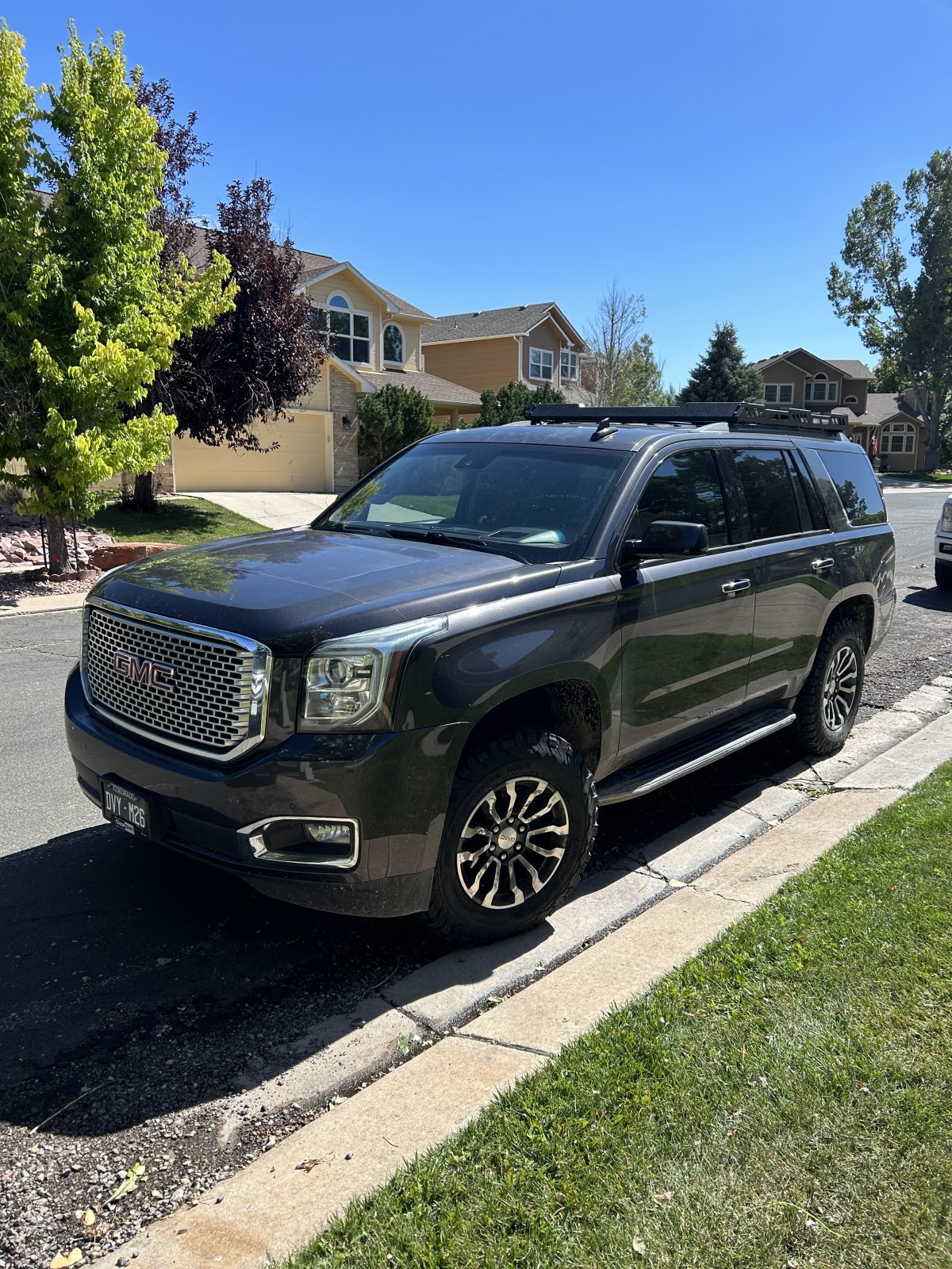

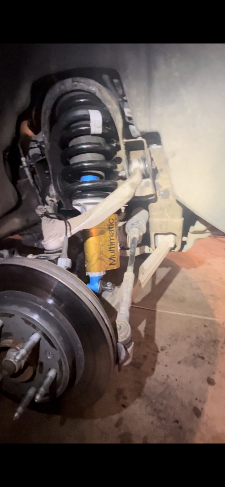

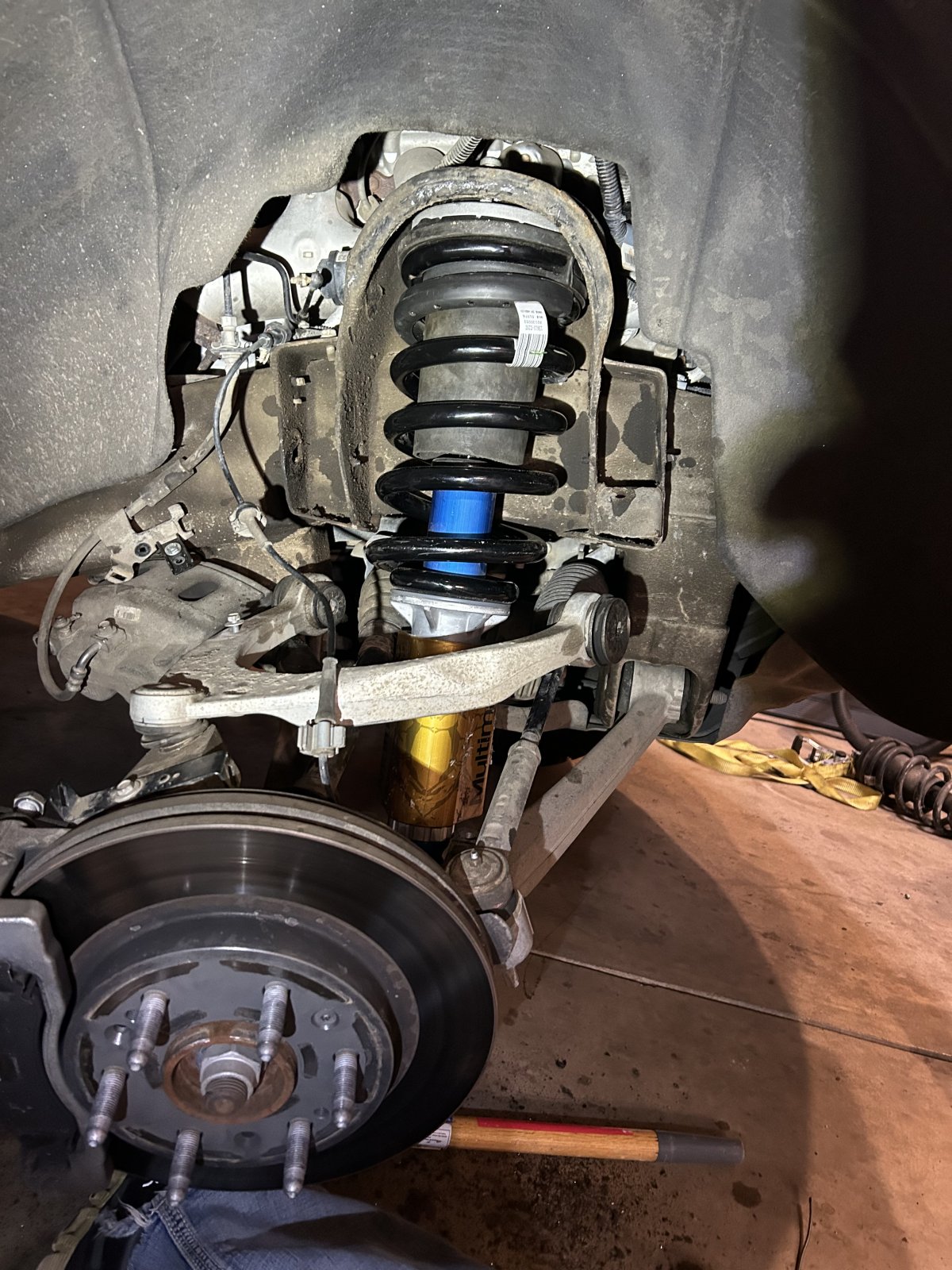

Scored Silverado ZR2 takeoffs with around 300 miles on them for $500 on marketplace. Wanted to delete mag ride, and I measured things out and. It looked like they would fit. With some help they do. Granted I’ve only drove it in and out of the garage, and to fit them I had to take the upper control arms off and now need an alignment, but.. they were about 3” longer than the stocks and it felt awfully stiff the little bit I drove it.
I checked vehicle weights 2016 Yukon Denali vs the ZR2 and weights and weight distribution is fairly similar so I thought it would be fine. Yukon weighs around 3,000lbs in the front, doubt the ZR2 is more, not by much anyway. I know the new generation has a different control arm geometry though, idk if that is what making these feel stiff on the Yukon. I measured a ZR2 shock installed on a ZR2 and installed it was maybe 1”-2” different vs the stock Yukons shock length installed.
I also had a 2.5” spacer in the front before the ZR2 shocks, obviously that’s gone now.
One of my thoughts is this: Would 2-3” drop lower control arm help the geometry perhaps and loosen up the shock abit? Now it’s pretty extended, hardly dropped at all when lowering the front end down after install.
Any feedback is appreciated!
Full vehicle pic is just with the spacers, and it has 18” AT4 wheels and 275/70/R18 K02’s

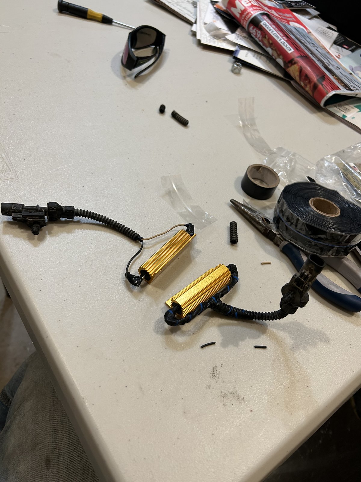

Oh, and I bought some resistors and used the stock plugs off the old magneride shocks to wire them up, worked good, no suspension lights on the dash.

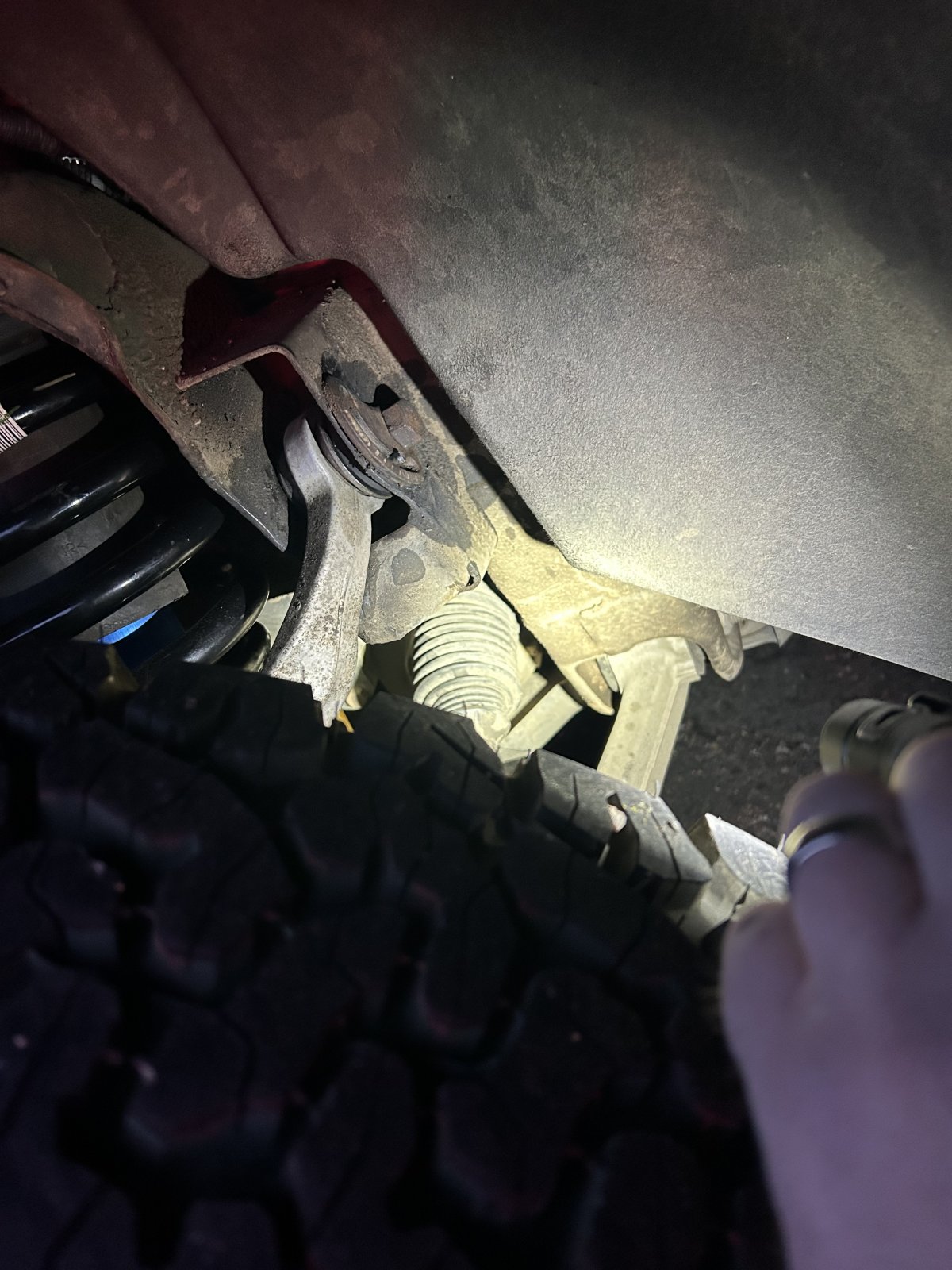

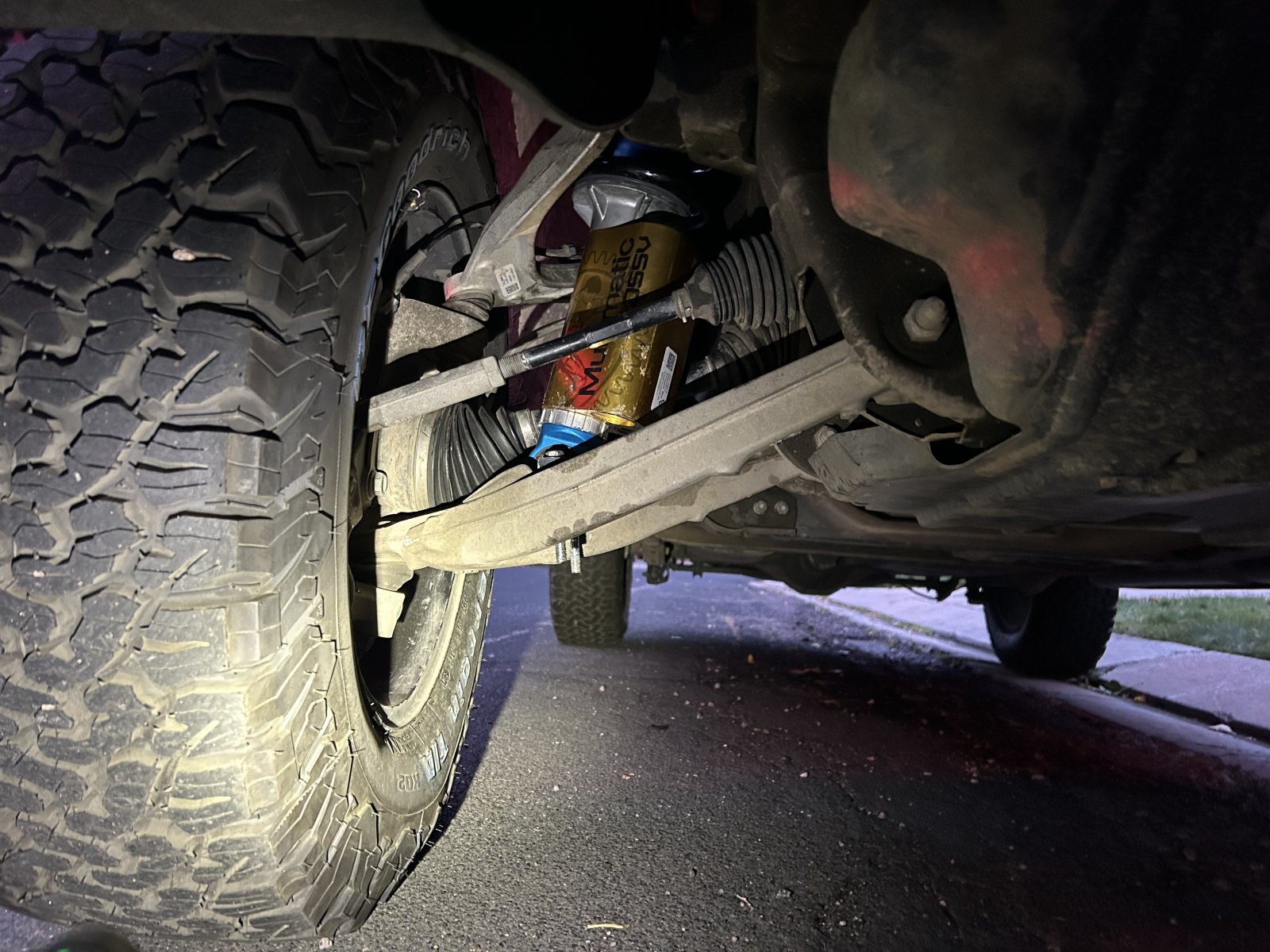

Took some pics this morning, it’s pretty much maxing out the upper control arms travel, I don’t understand why the suspension is not compressing hardly at all…

Silverado4x4
Jan 15, 2023
237
280
My advice to you is remove it till you get the proper install parts everything in that front is beyond operating limits, your ball joints, CV axles, tie rods are way over operating angles and will fail iam not kidding with you I have seen where people did what you have done and the front wheels completely came off due to part failure.
F
Favored
Oct 4, 2023
16
@Silverado4x4, perhaps I should have been more clear, I’m not driving around like this currently.
I’m trying to get advice on what parts I need or what I should do to make this work.
I was expecting about 2” of compression on the shocks once they were loaded with the Yukon on the ground and I only got 1/2”. I feel like if I got the expected 2” it may have been fine.
Any opinions on installing 2”-3” drop lower control arms, thoughts on if that could remedy this?

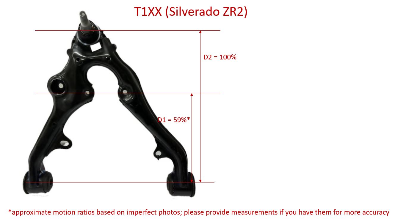

@stab6902, I am curious about your first comment, about the lowering arms not helping the suspension compress… if the lower arm was 2” more level would it not be easier to compress the shock vs if they are at a steep angle like now?
Also I’m wondering if the lowering lower control arms move the lower shock mount position further towards the wheel/tire, which if it did I would imagine that would also help with having more leverage to compress the shock, no?

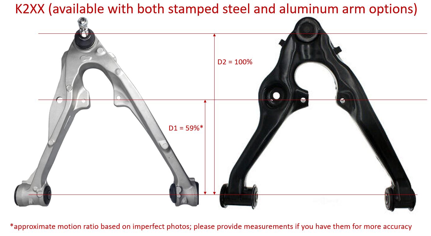

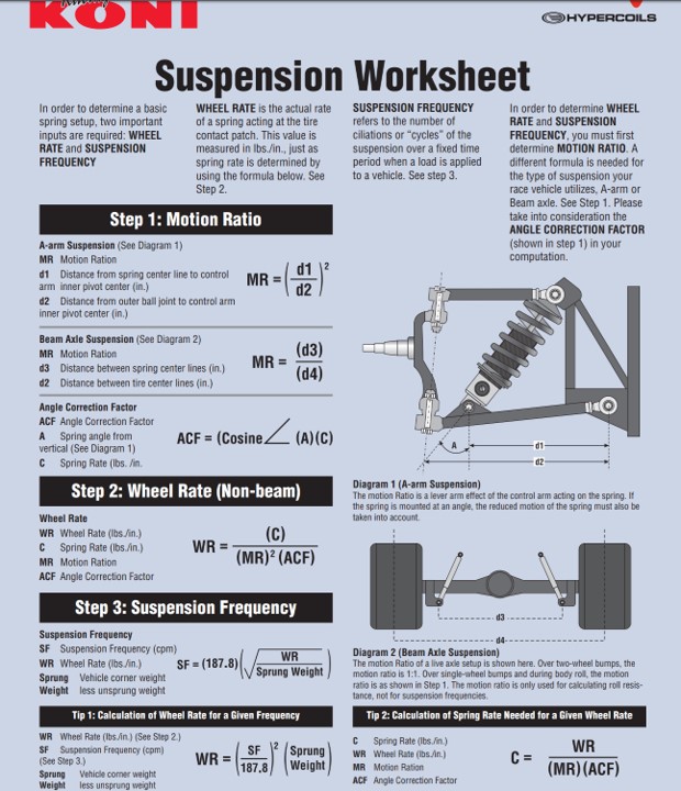

The angle of the arm doesn't really affect the wheel rate (aka stiffness) of the suspension - it's all about the motion ratio. See figure below. All of the lowering control arms I'm aware of maintain the same motion ratio as stock so the truck rides the same before and after being lowered.
To make your suspension "softer," you'd want to move the lower shock mount closer to your lower control arm bushings (reducing d1 according to the Suspension Worksheet). A little bit goes a long way, since you square [d1/d2]. This would give your tire more leverage on the coilover assembly.
I don't have any parts in front of me, so I had to guess based on pictures, but it appears as though the motion ratios for the K2XX and T1XX trucks are pretty similar. Therefore, it's kind of surprising to me that you find the shocks to be super stiff. If anyone could share actual measurements, we could be a lot more accurate.
If you're dedicated to making this work, it looks like you could buy some lowering control arms and drill some new lower mounting holes closer to the bushings (last figure). You'd need some precise lower control arm measurements, spring rates, and corner weights to guess how much to move the holes, but moving them as far towards the bushings as practical would probably be an OK starting point. You'd also have to be sure not to reduce the strength of the arms in doing this... welding in reinforcements where you remove material (if necessary) would be advisable.

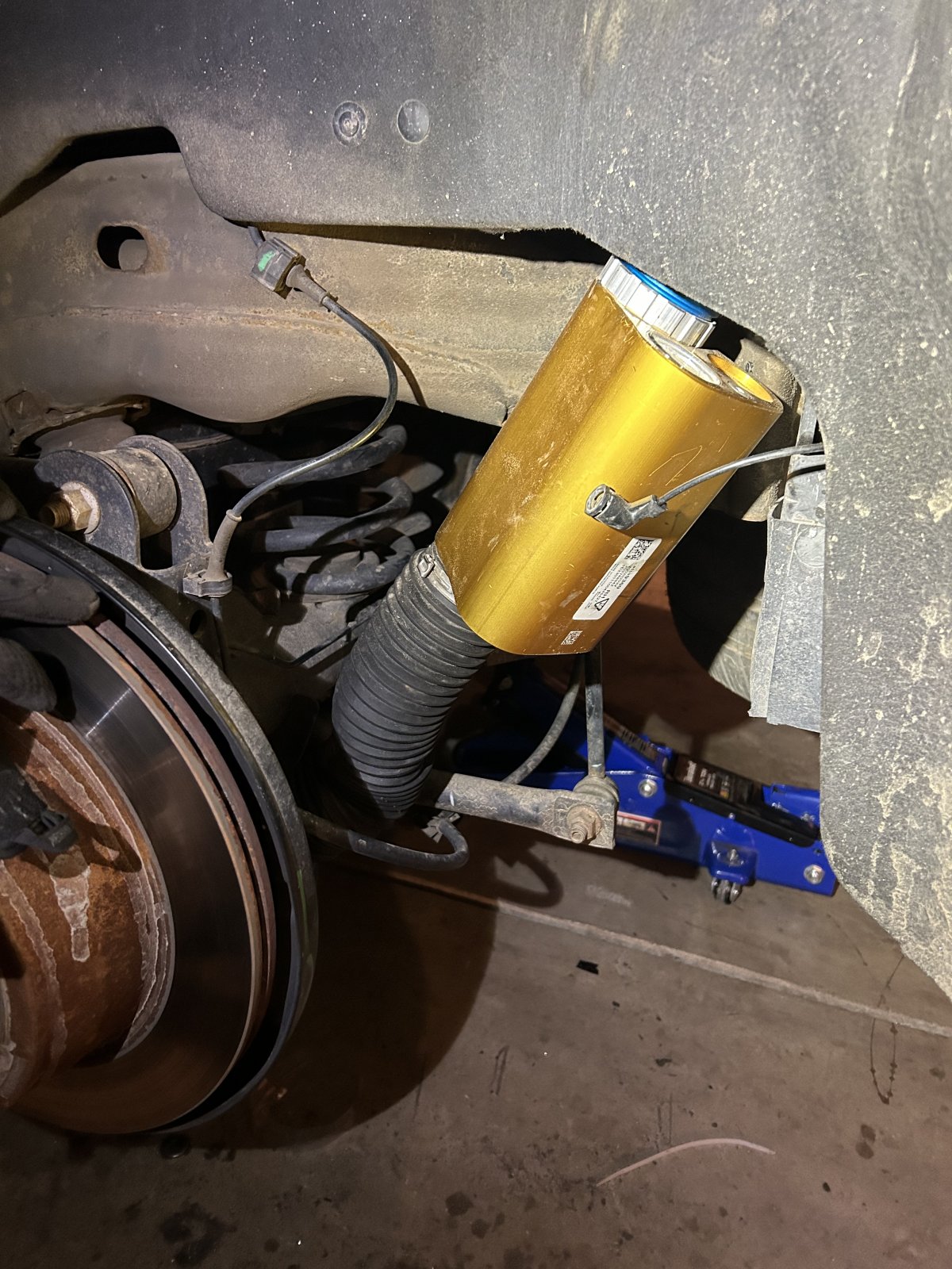

I’m also not sure how well moving the lower mount further inwards would work and here is why. The angle of the shock on the ZR2 is equal or more than the Yukon I think, I had to already force it to the current mounting position further inwards that what it seemed like it wanted to be. If I used maybe a 1-2” drop arm it may be a little less but at some point I’d start being concerned about forcing the shock to bend slightly inward. Although maybe you could make a spacer for the upper mount to correct the angle.

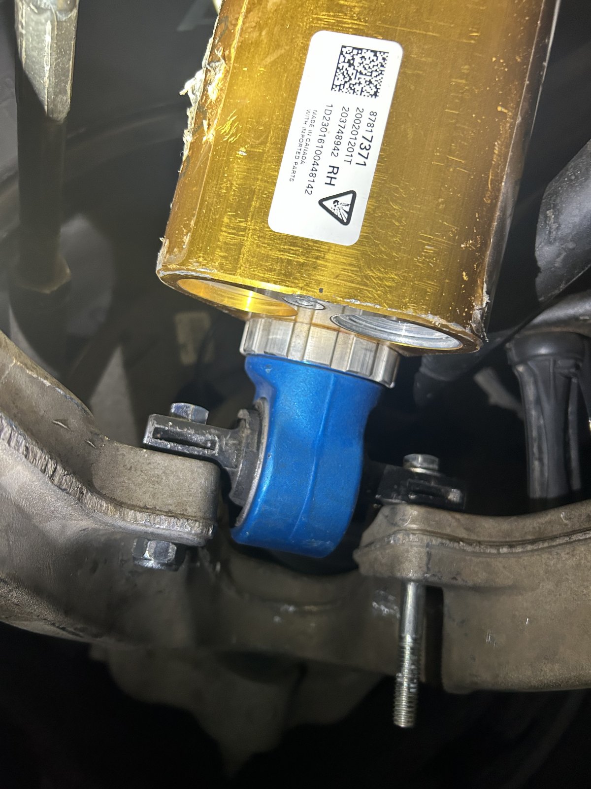

Are the external shock reservoirs too big to mount the crossbar underneath the arm, like this? https://www.tahoeyukonforum.com/threads/front-strut-“flip”-as-a-lowering-option.139425/ ?
If you could get away with doing that, at least temporarily to get your driveshaft angles etc in the ballpark, you could put some more miles on the truck to get a feel for how much of a change you need.

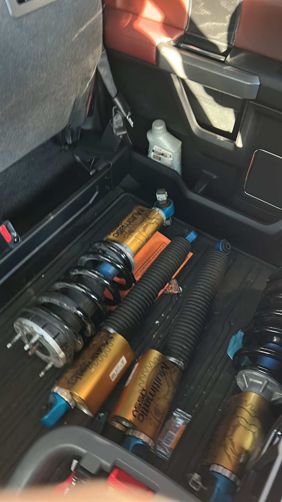

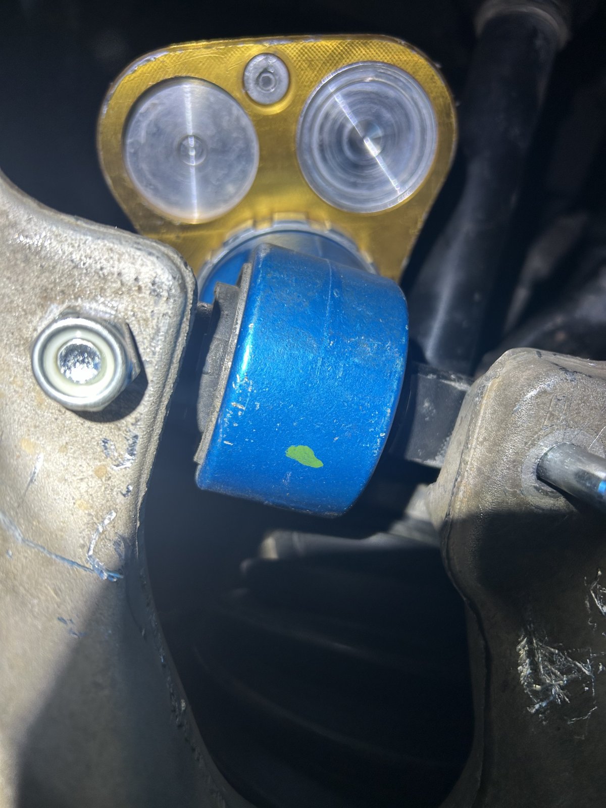

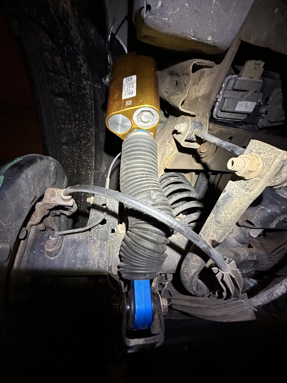

I got the rears on tonight, I wanted to see if I could atleast use them and just have to buy Fox fronts. So the external reservoir is too big to use them for the side they are labeled for but if you swap LH to RH then they fit just fine. I had to compress them about 2” more vs what the stock one last were. I drove it down the driveway and into the street, which have sizable bumps, and oh wow, now I’m motivated to get the fronts to work too! The back felt really really nice.
Very interesting on the strut mount flip.. I went outside to check, it would be really really close and not sure it would clear… I may have to try it although that would be hours wasted if it didn’t work.. also the bolts are not final on the lower mounts, don’t worry.

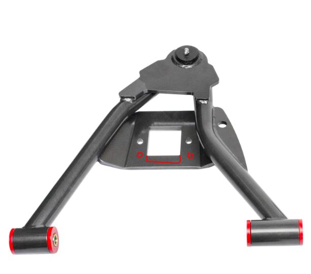

I’m thinking about calling these guys up on Monday, maybe they would be open to drilling a couple more sets of mounting holes for different locations, or modifying a set for me, worth an ask imo. Right now the rear is at 38”, the front is at 42”, so if I’d get 3-4” drop arms that should be nice, however if the angle gets fixed and the suspension compresses then probably wouldn’t want to go with 4”… 3” may even be abit much then. @stab6902 if I get you the measurements of the ZR2 vs Yukon geometry can you do the calcs pretty accurately to determine where the holes would need to be or is it still a pretty wild guess at that point? The strut angle still concerns me though… not sure if stacking washers between the top of the strut bolts and the strut tower to create more or less angle would work..?

Doesn't seem like the flip would be too much trouble, I guess you might have to loosen the top bolts too if you really had to muscle them in there. You just need to get the lower shock mount around and below the mount on the A-arm. Based on your description, mounting them below would also put the struts in a more natural angle, which would reduce seal friction and improve the ride.
Yes, I if I knew the spring rate of your original springs (assuming you want the same wheel rate as when your truck was stock), the spring rate of the ZR2 springs, and the exact dimensions of your lower control arm, I could do the math.
