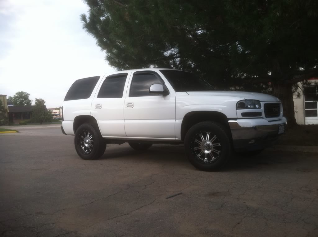

Finally got my kit. Where did you go for your tires?
01Konvict
01Konvict
Boats n Hoes
Jan 16, 2011
2,747
707
Raleigh/SML
Look great snow! I like the level kit. I went with my coopers from discounttiredirect.com for a shipped price of $760. I thought it was worth the $500 save to have a 33x11 vs. 33x12.5
