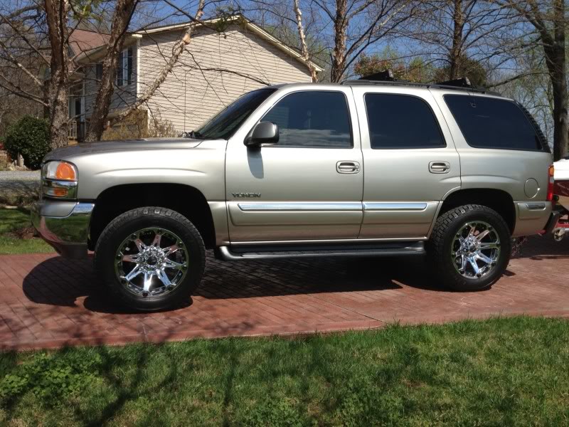

it looks good bro, can your front still crank higher?

yea it took me forever since I work all day when the suns up and don't get home til its dark so its very limited time to wash it never mind pics in the sunlight, damn winter sux!
Im maxed on my driver key with only 1-3 more turns left on the bolt, the passenger is halfway cranked so yes the front can still go higher on the pass side but not the drivers. Im sitting right around 40" in the rear and around 39.5" in the front. I think the 1.5" are a little easier to work with then the 2" spacers but it looks real good now!

that looks sick man! did everything clear the tires with just 2" spacers?

Thanks fellas! Yes everything cleared with the setup I am running. You can fit the wider 12.5" width tires but they will rub at some point and cost a lot more then the 11" width tires (approx. $500 more). I am happy I went with the setup I chose and it looks great to me. I towed a buddys boat the other day and it squatted a little but towed amazing compared to the stock springs vs. the z71 springs. Overall I am very pleased with my setup and I will add some more pics soon.

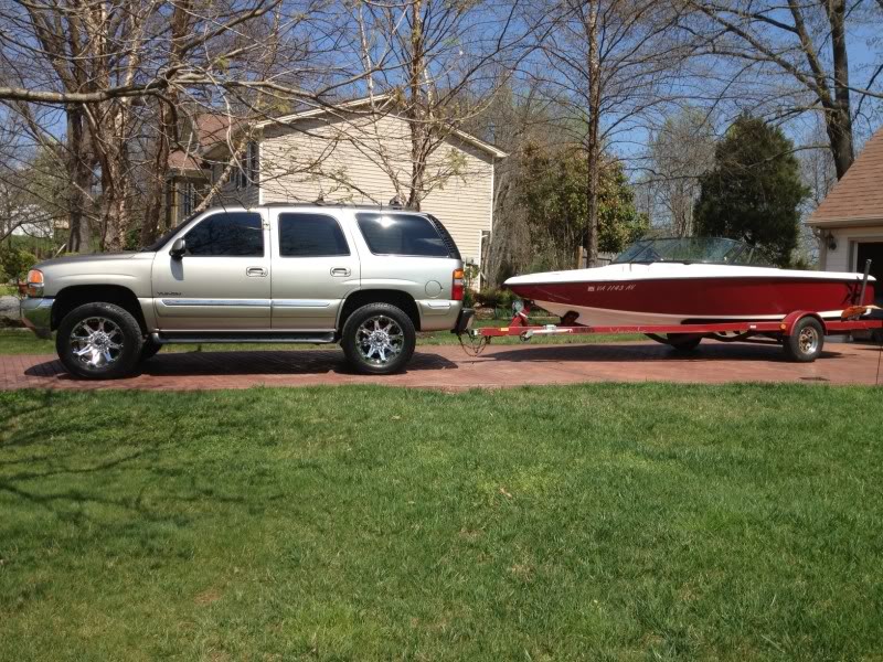

A few more pics and this time loaded with a friends boat. The rear squatted a little bit but not bad and towed great.

I'm surprised that little boat is causing that much sagging in the rear, actually. Any idea what the tongue weight on that trailer is?

Im not sure why either, but he has z71 springs as well and they should not sag... I have regular LS springs, and 1.5" spacer and with a 1000lbs of cargo my rear was saging good too, not something I like. Took the weight off the back, and my truck sprung up so high, that I cranked the front to match it back off. Also not liking the extra height Im at now without wait in the rear. Not sure if I would have prefer a .75" or 1". Now Im about to remove my coil spacers, in the rear and drop it back down to no rear spacers and then just lower the lift keys upfront to get it more level but little closer to the ground since 32s is as big as I will venture.

It doesn't sag that much as you may seem. It sat down about a 1" in the rear which I find kinda normal. The spring should absorb part of the tongue weight then be stiff for towing and handling. I do not know the tongue weight of the boat but the engine is forward of the rear axles and majority of the boat is also. So with the tongue heavy and springs responding by far better then stock I was very pleased with the handling and towing factor.

If the boat engine is forward of the trailer's axle, that explains it. That's going to add quite a bit of weight right there. I'm assuming it's a big engine as well.
