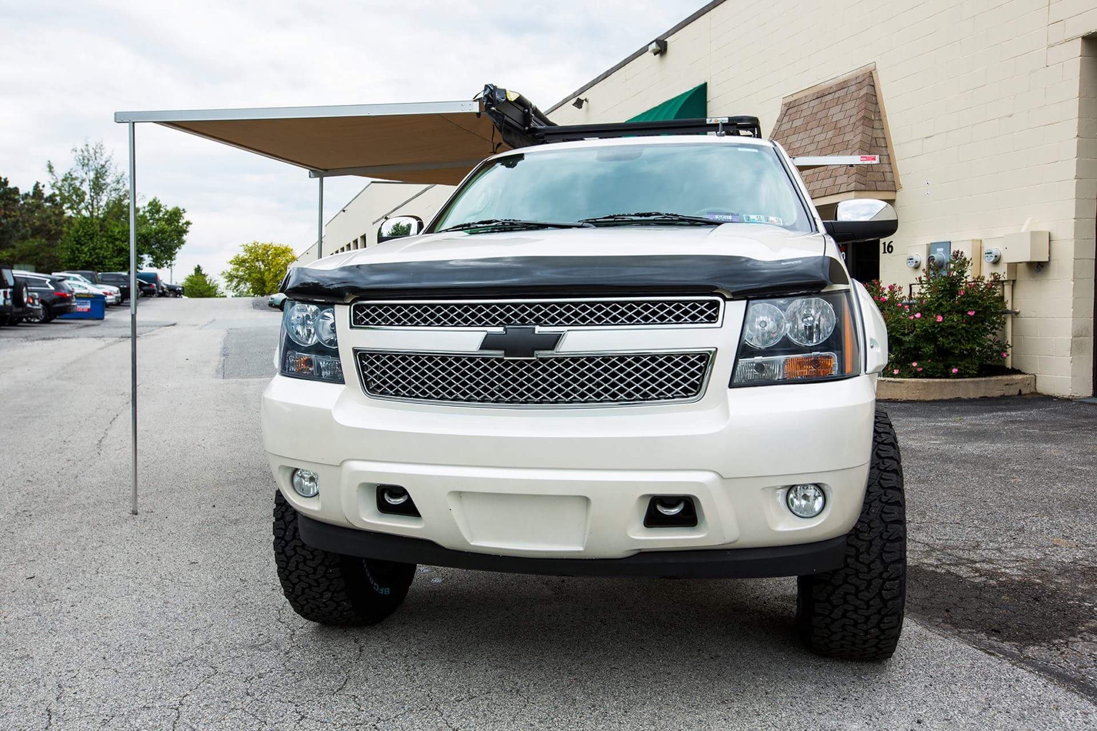

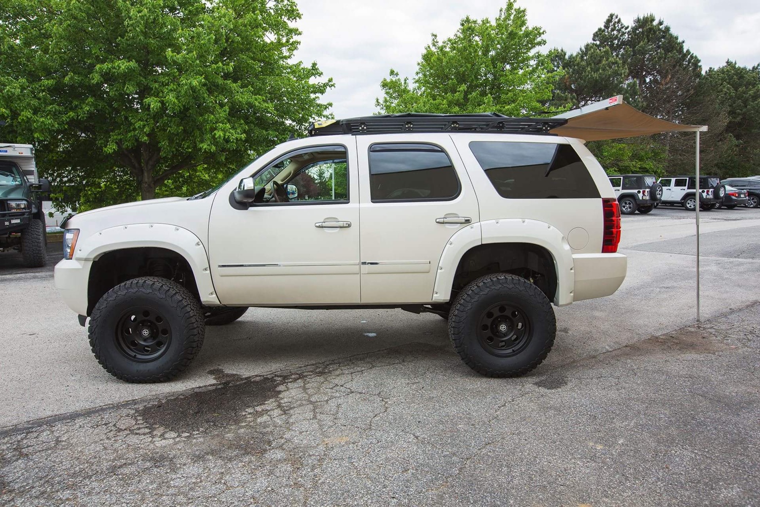

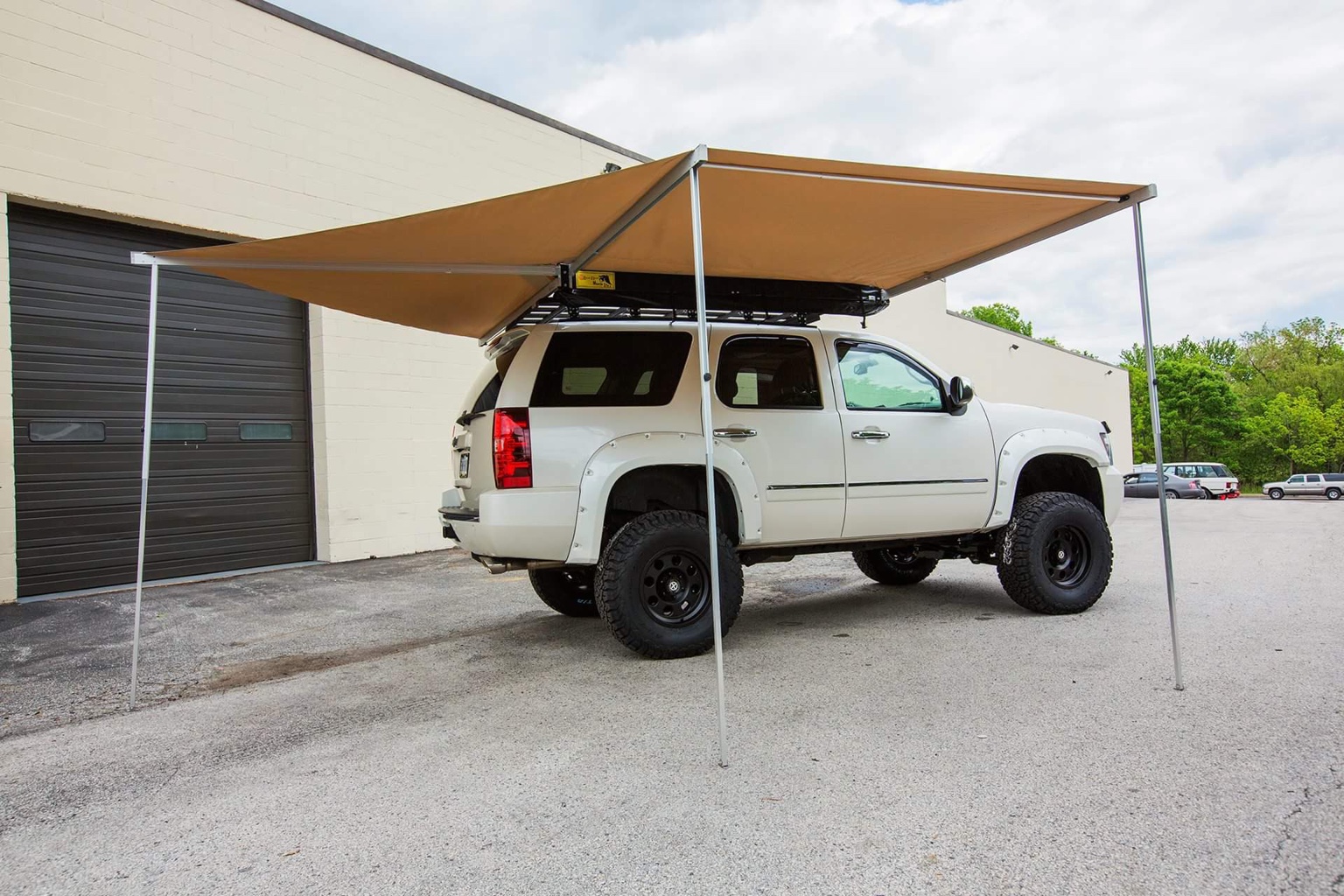

This looks so nice!!! I have a 09 Tahoe LT 2wd. I want to lift it and give it the "look" without going crazy. I have a few questions and I apologize if you have said this already. This is a long thread..lol! What is the lift size and the tire and wheel combo? Also do you have a measurement of the roof height? I have a parking garage at work that will limit how high I can go on my truck. Again, great looking truck!

It's a Fabtech 6" kit with 35 on 17x9. Not sure of roof height but guessing 7'6" with that rack.

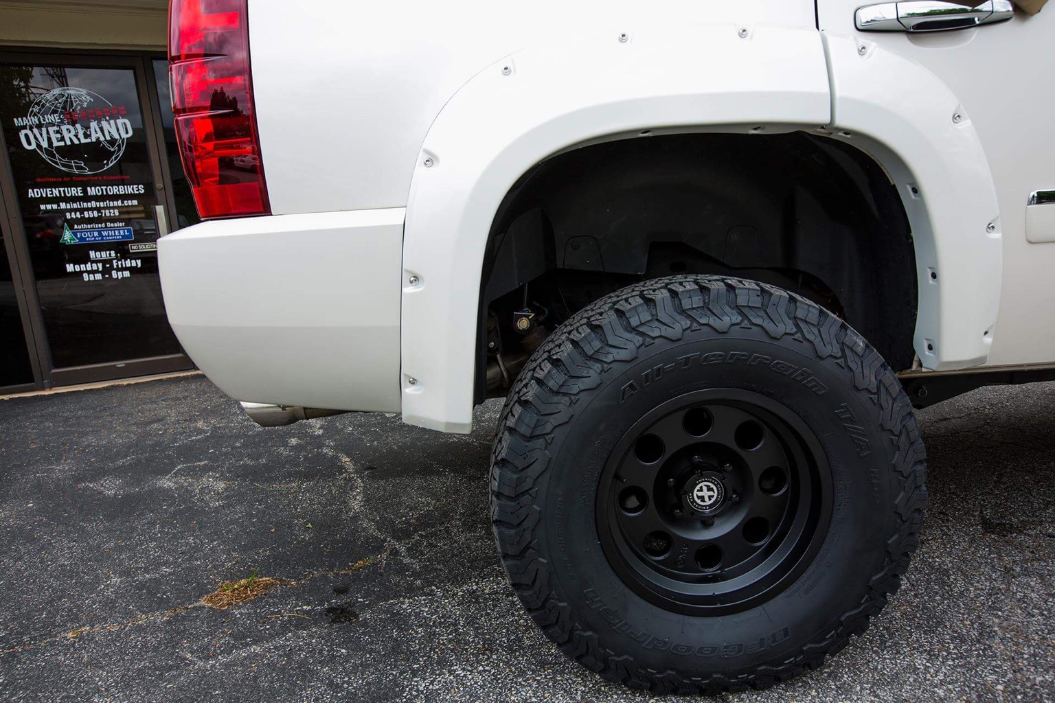

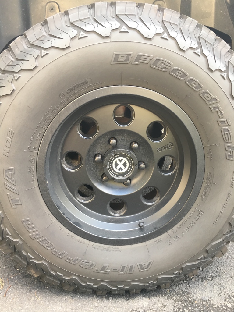

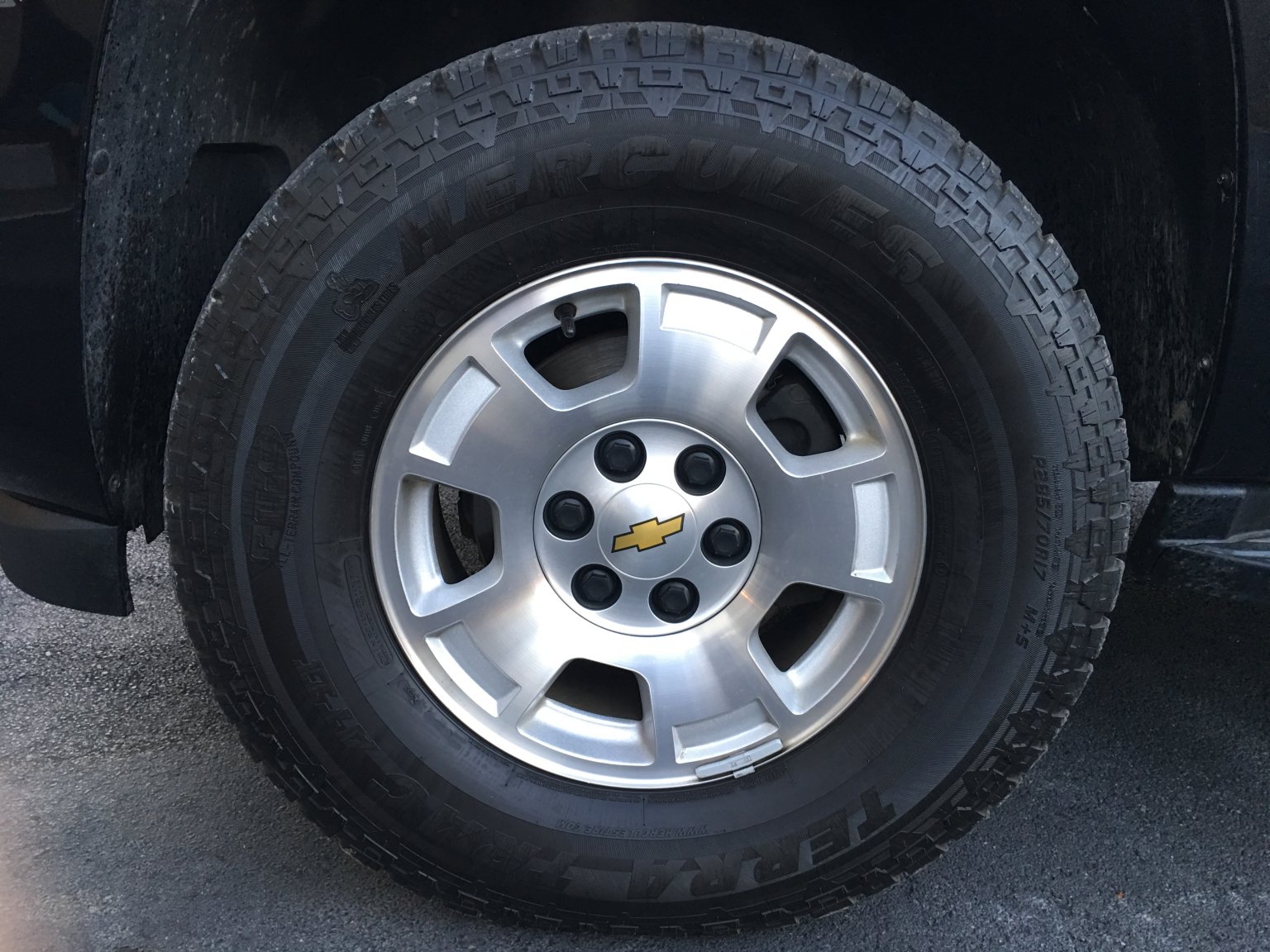

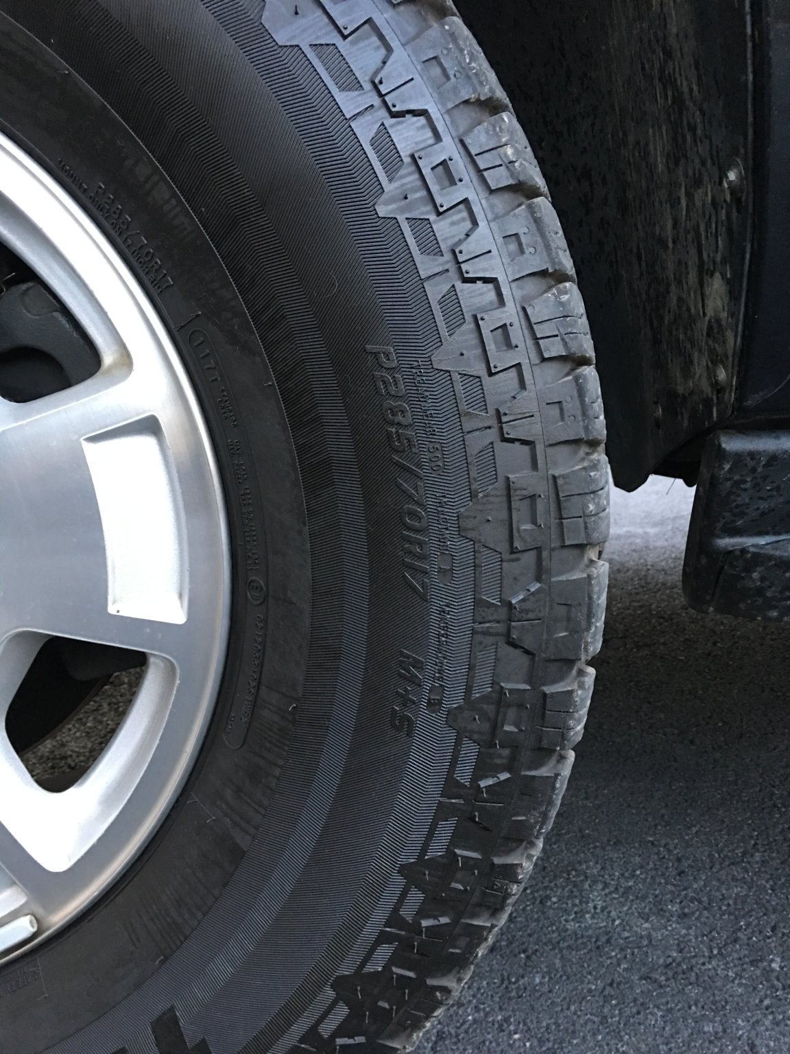

Hi. Thanks for the compliments. ~80" rack adds another ~6". I needed a heavy duty rack for gear. Here's a picture of the wheel/tire. If need any other info let me know. Also thanks to Konvict for assist.

NICE!!!! So looks like I can still go with a 5 inch lift and 33's w/no problem. Thanks for the info!

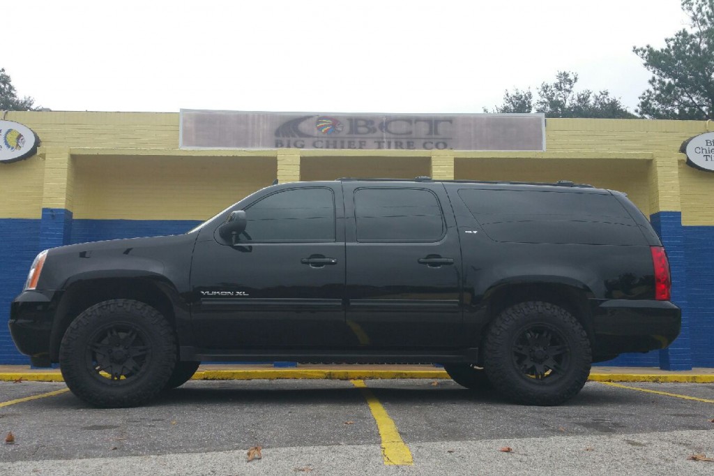

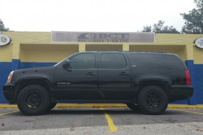

This one's not mine, but I was searching the internet for leveled NNBS pics, found this blacked out Yukon, and just had to share it. Yukon XL on 285/70r17 and 2.5" front only.

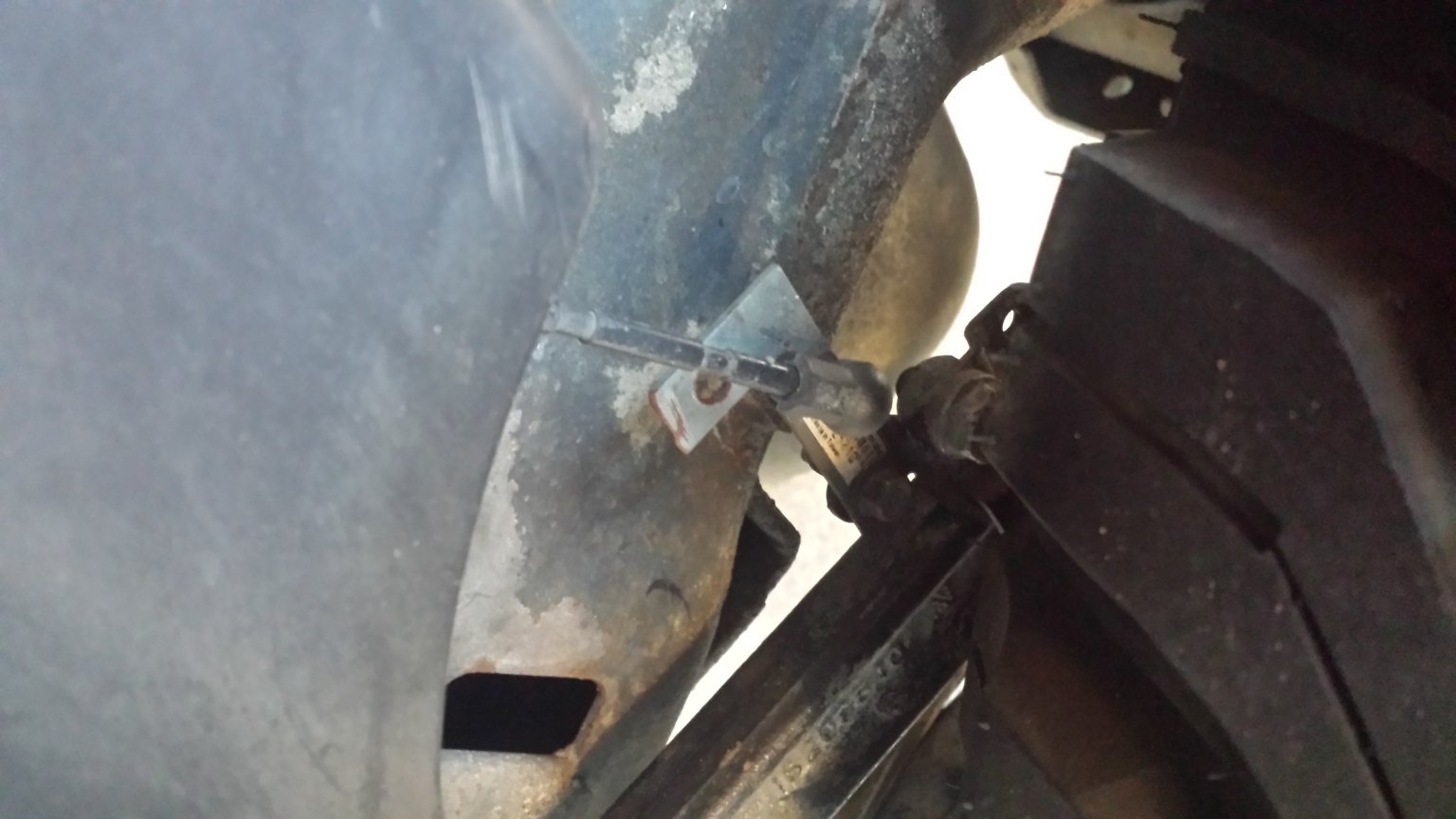

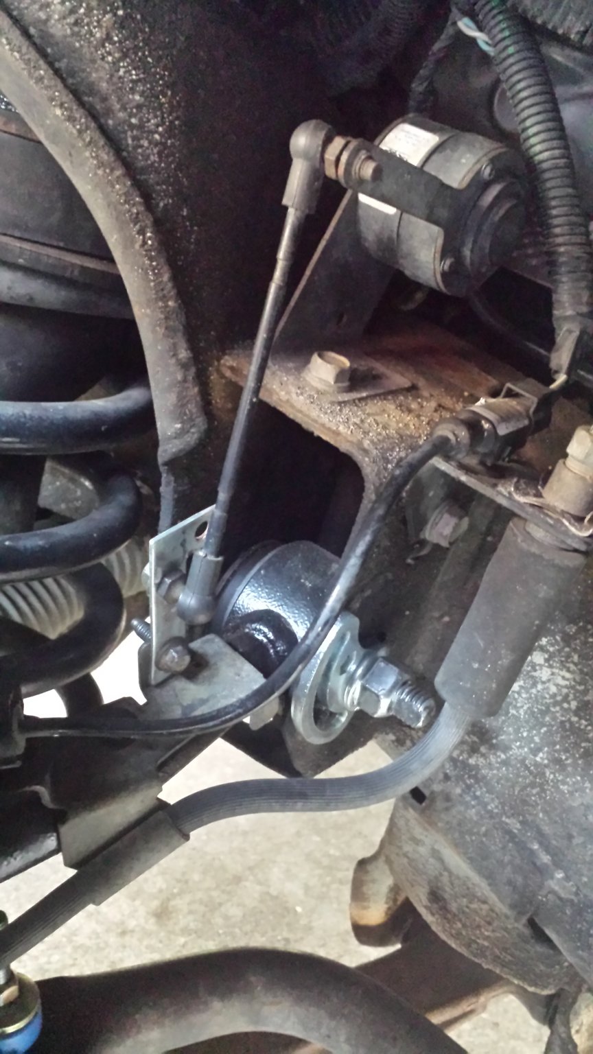

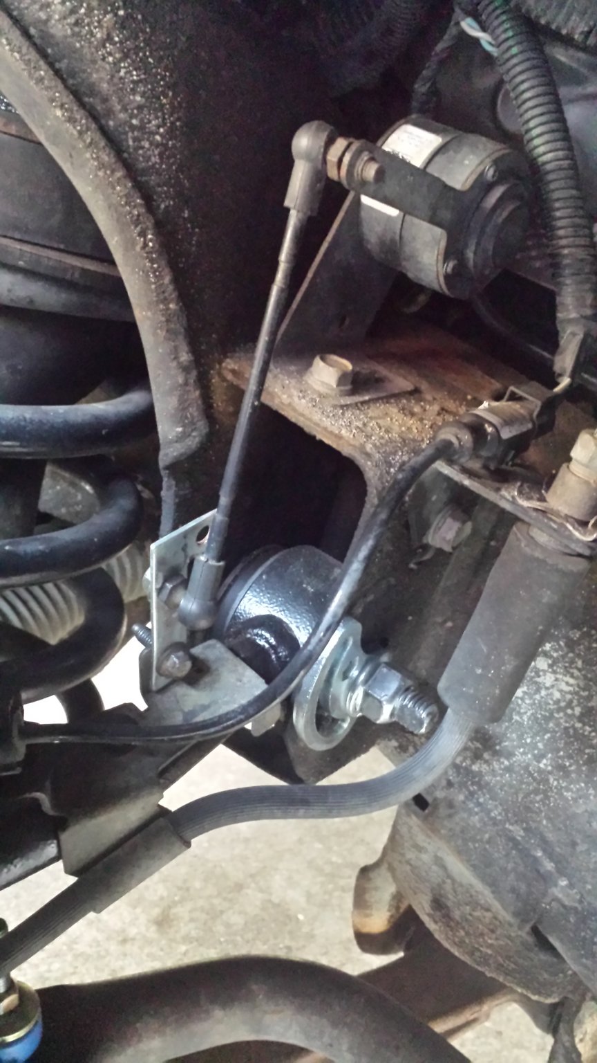

Here's how the front looks
Here's the back.
Just used simple L brackets from my local haEdward store, paid Ike 34 cents per bracket. For my 3.5" lift, the math came out to an inch in between each hole in the L bracket to return the ride height back to normal and get the autoride to work. The pump still runs and I can see the vehicle rise from the autoride, but I do have a dash warning to service suspension, though it does still work. I don't mind the dash warning, but if you do, there are companies that sell resistors to get rid of it.

Think the warning light is from the front end. Those look a little long so the sensor is way up. Make sure all plug connections are tight. Center up ride height sensor arms so there level or slightly up. That should clear up dash lights.

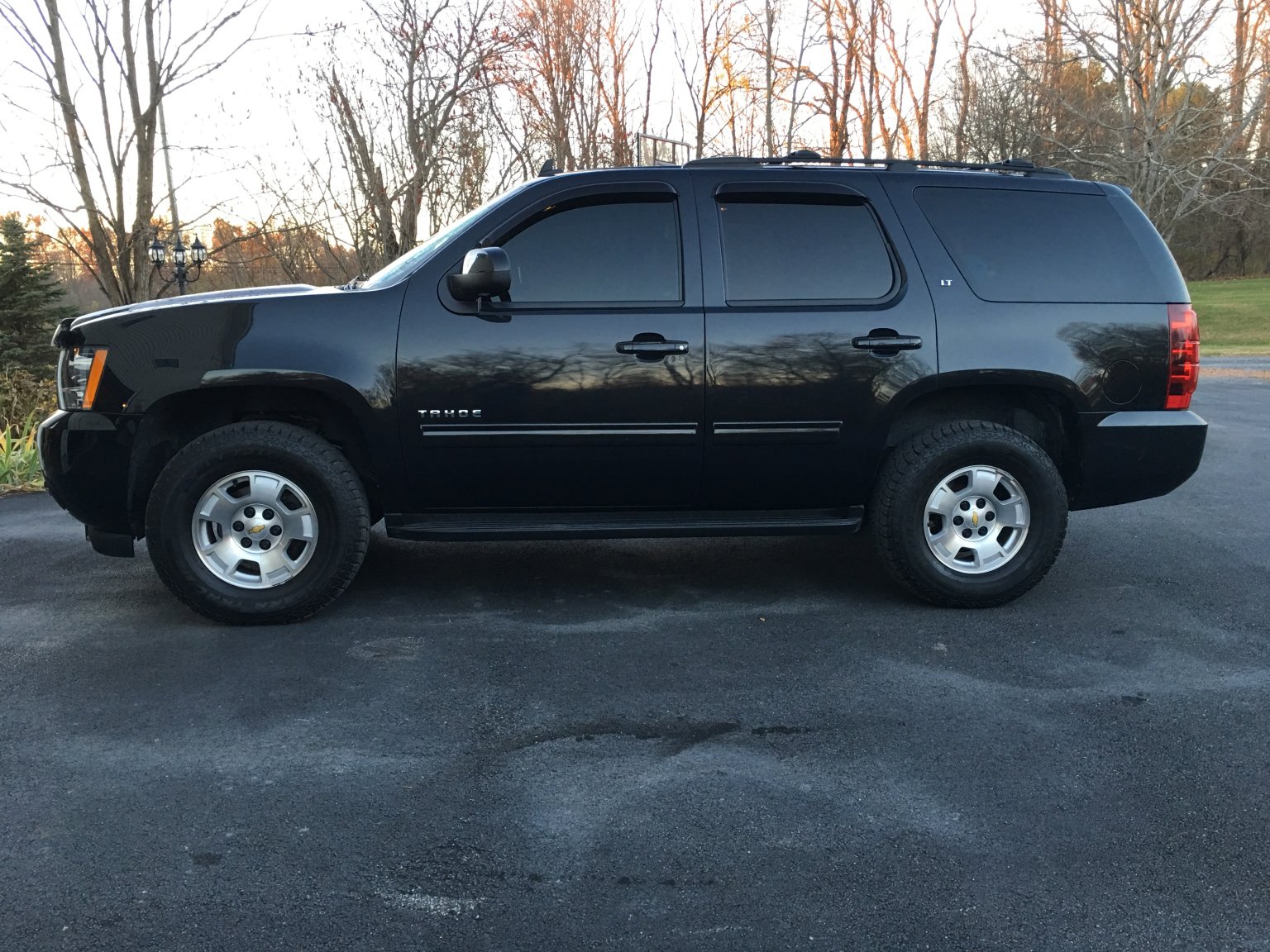

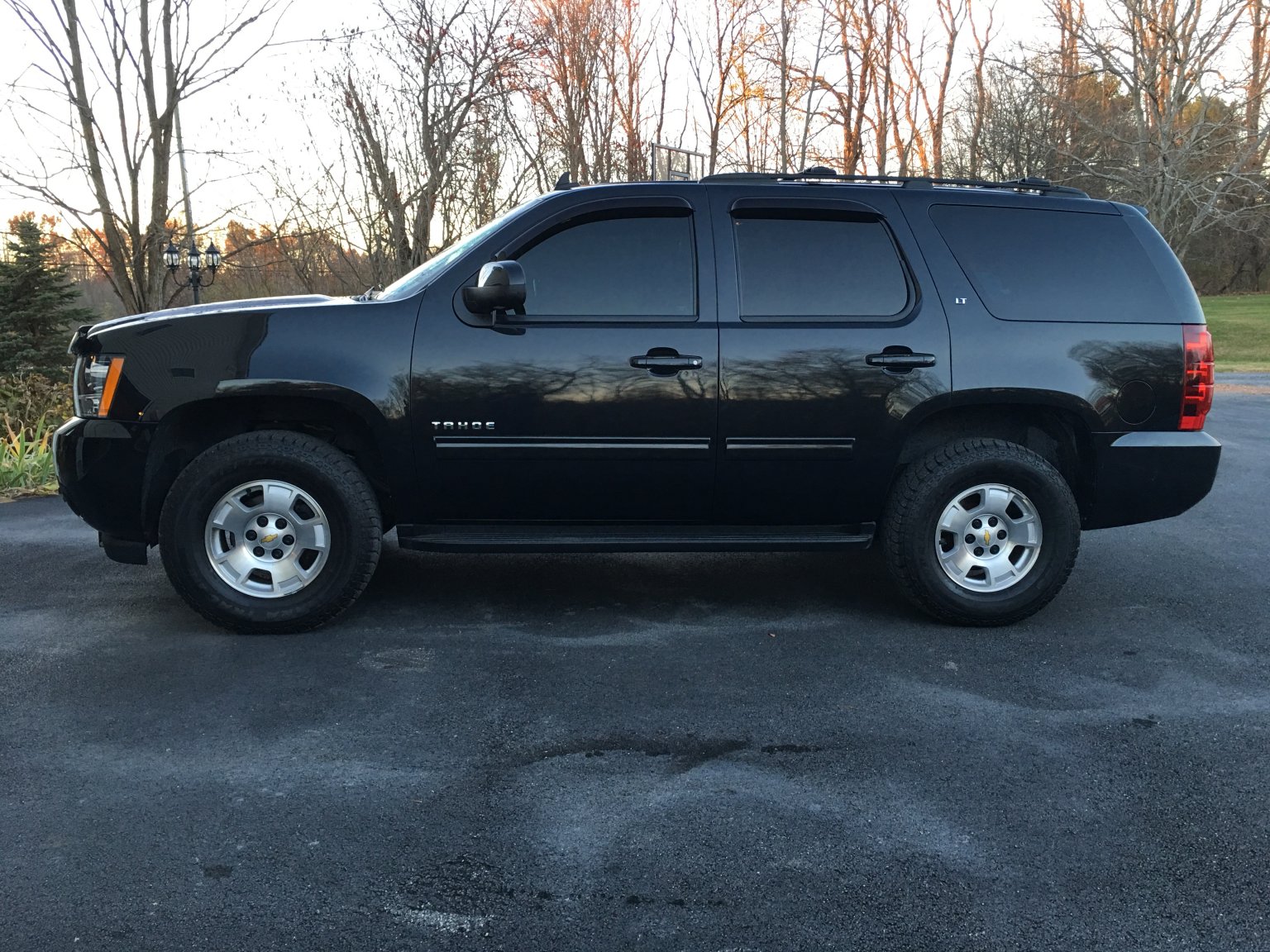

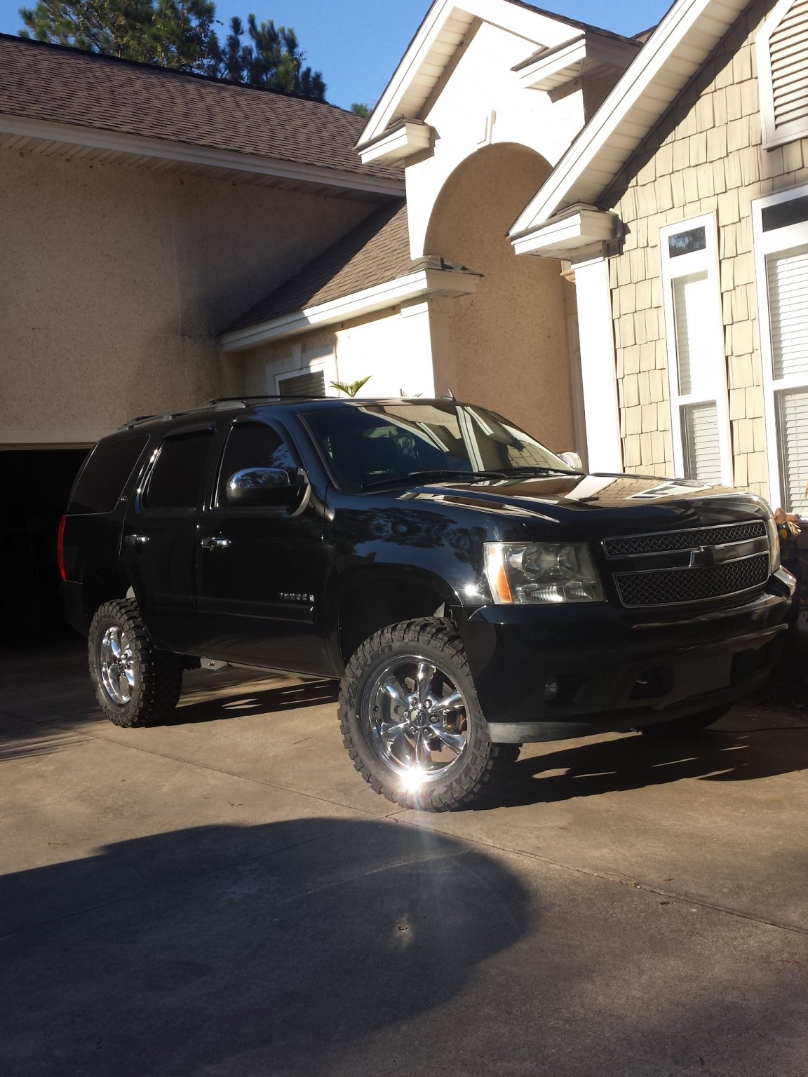

Rough Country 3.5" lift on 33x12.50r20 Falken Wildpeak MT tires. It is an LTZ so had to account for autoride, but got it to work with brackets. Can include pictures of how that was achieved if anyone wants them.
How are the tires? They looks like they'd be loud as crap.

I thought the same thing, and having ridden in vehicles with Nitto Trail Grapplers and Toyo MT's mounted on them, I can say I was pleasantly surprised at how quiet the Falken's are. I can notice the difference being as I went from a normal street tire to there, but they're honestly not loud at all. Sound more like an all-terrain if I'm honest.
