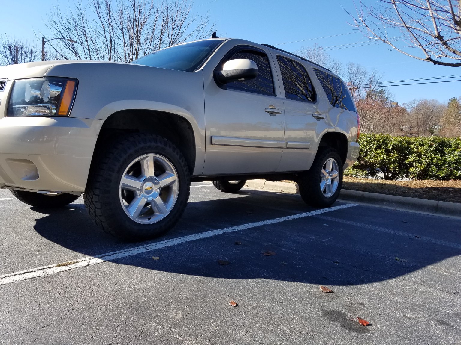

Rough Country 3.5" lift on 33x12.50r20 Falken Wildpeak MT tires. It is an LTZ so had to account for autoride, but got it to work with brackets. Can include pictures of how that was achieved if anyone wants them.
That looks perfect. I want to do the same to mine. Any trimming required or rubbing? How are those tires

There is minor rubbing on the plastic, bu it's at full lock, so not enough for me to bother trimming. I opted to not put spacers on my stock wheels like recommended, so you may have different and better results with some quarter inch spacers. Loving the tires, they're very quiet for a mud tire, and I got them at a great price. Would highly recommend them as of right now.

What size wheels are those and offset and back space? I'm looking to do 20x10 with a -19 ish offset

Honestly not 100% sure, I've looked for exact numbers before, and never found any for these wheels. They were apparently a factory upgrade. I believe that they are basically the same as the other stock Tahoe wheels, so 20x8.5 and +31 offset.

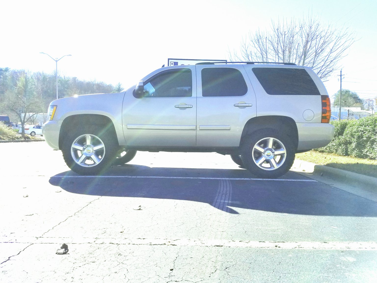

Those tires are the same height as mine but just 1 inch wider. Mine clear no issue with a 2" level. i think since you had em on a stock wheel they probably were an inch or so taller than if they were on a 10" wide.

Yea a second look at em they look like then gm accessories wheels. Any more pics of the truck?

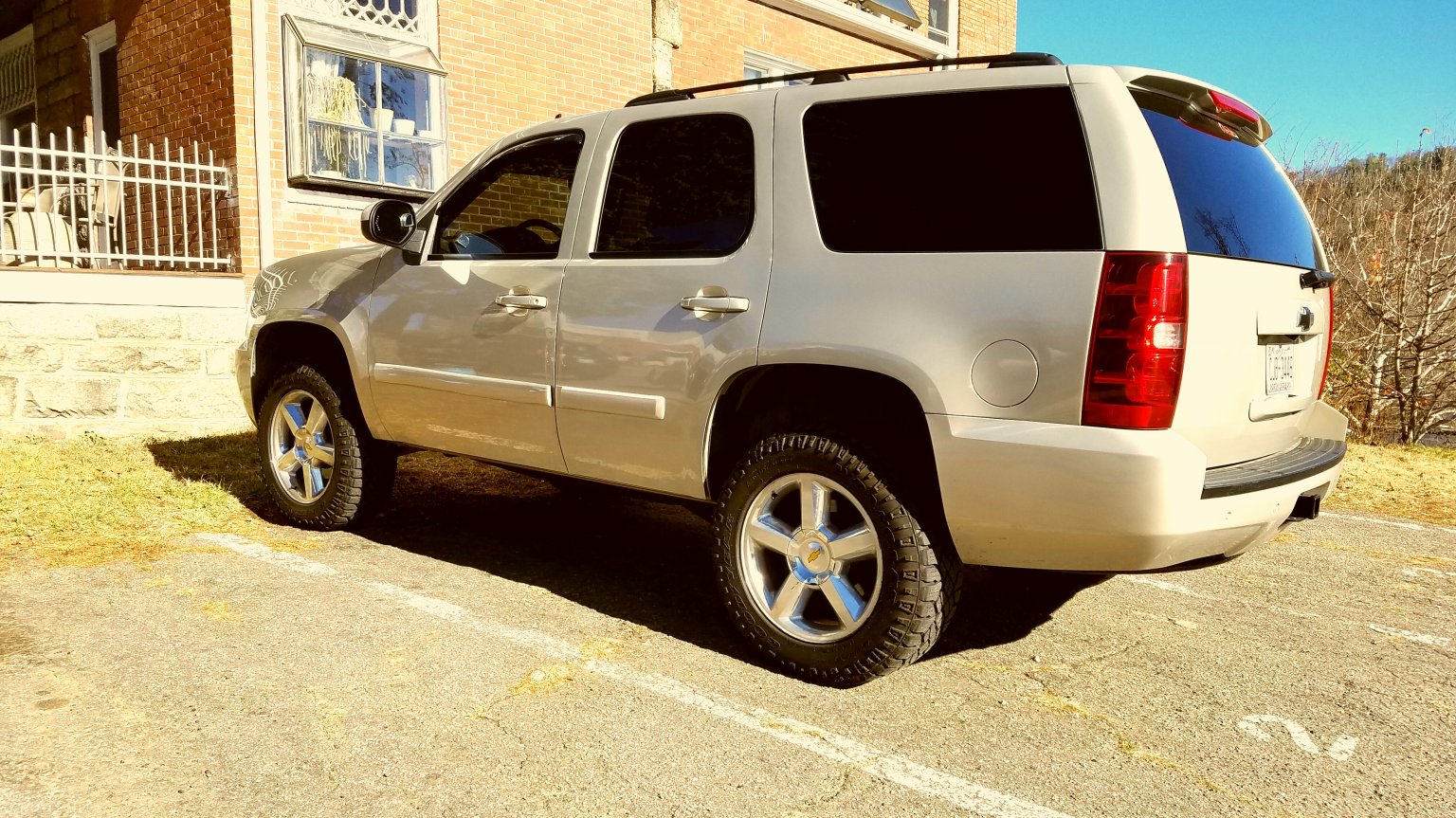

I'll post a new thread this weekend on the details and measurements. It is definitely higher front and rear. Rides so much better and now I don't rub at all with no trimming.
