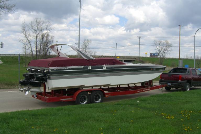

How much do you plan on towing? I had an 04 2500 Avalanche 8.1 w/ 410's. It was a beast. I routinely pulled my 31 ft offshore cat 11k on the scales. It did it fine. Then I had a 15' Duramax . It would tow ANYTHING. But found the punishing ride too tough.

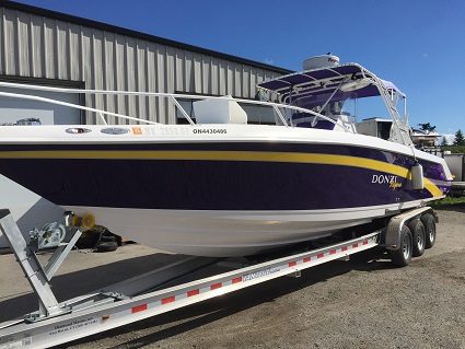

But I sold the dmax and plan on towing my 35' Donzi CC - OB's about 9500# with my Denali about 35 miles at the end of the season.

Nice Donzi...:cheers:
