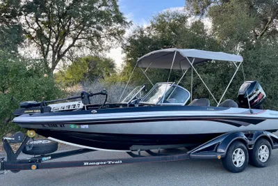

Bought a 2014 Ranger Reata 212LS and plan on towing it with the Wife's 2017 Yukon XL Denali w/8speed
Trailer GVWR 5400 lbs
Approximate Boat Weight 2215 lbs
Total Person, Motor, Gear 1850 lbs
Length Tip of Trailer to tip of Engine 26.7'
Thoughts, Concerns, Comments? I installed the newest trans harness that goes in the pan and installed Shift Solutions Sure Cool Bypass Valve. Plus I keep fresh Mobil 1 Synthetic LV ATF HP fluid every 15K.

Need pics of the boat

Doing the math I have come up with 2269lbs total weight of the boat, trailer, motor, gear and fuel.
I was on another website called Bass Boat Central and a guy had a rig similar to mine. He determined the Tongue weight to be between 150-300lbs. I'm gonna call Ranger and ask them the specifics of the trailer and towing.

2017 Yukon XL Denali with the 6.2L and the 8 speed towed like a CHAMP!!
23MPG HWY on the way up to get the Boat, 15MPG HWY towing it running 75-80 mph both ways! Passed slower traffic with ease, trans temp stayed at 125 - 130 degrees.
Couldn't be happier!!
