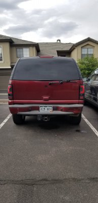

I bought a new pair off of eBay and they look great. The only problem is now my turn signals flash like crazy. They even had resistors built into the ballast to prevent that but they still hyper-flash.
Does anyone know if you can buy a thermal flasher relay to fix that? Other than that little issue I love them!

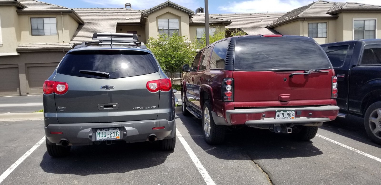

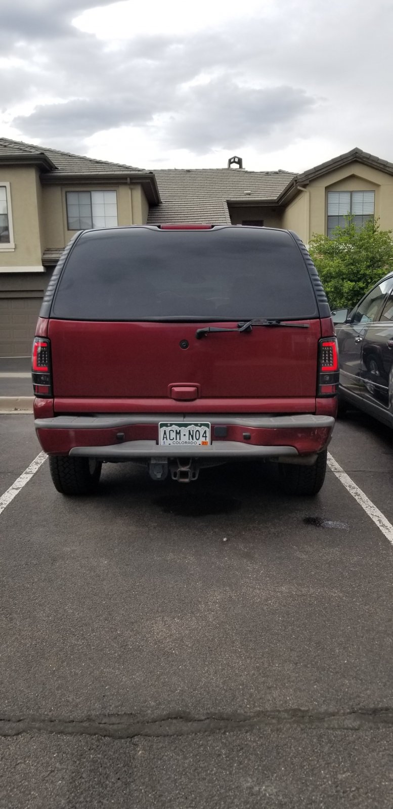

They're a little smokey too, nothing too dark. And they have a red bar instead of a white bar, which i think matches my Tahoe a little better. Also they were completely plug and play. I just took out the bulbs and plugged them into the new ballast. We'll see how they hold up after the rain we're supposed to get over the weekend. I've included a little before and after. Please ignore the Traverse, it sucks and I hate it lol.

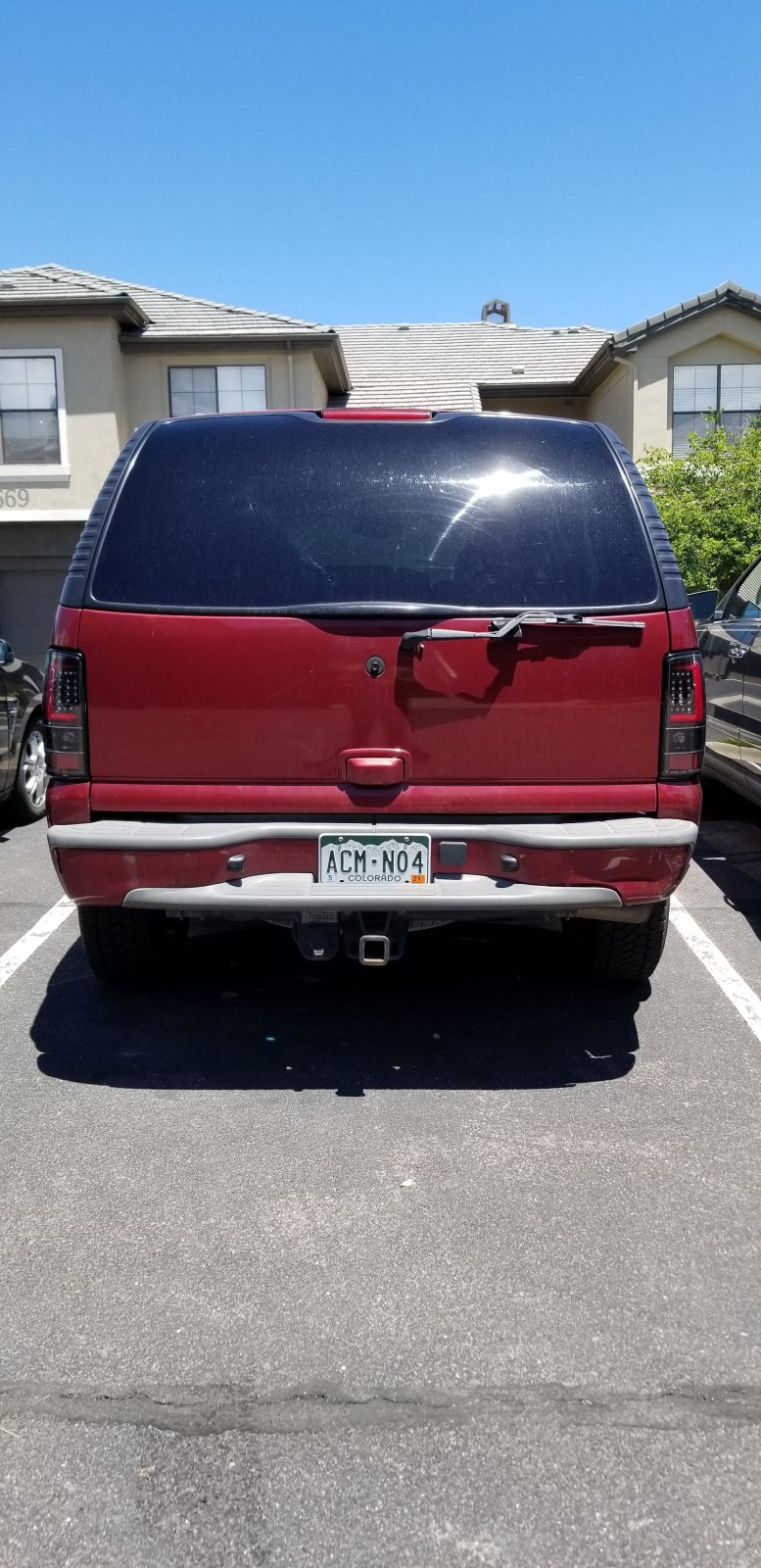

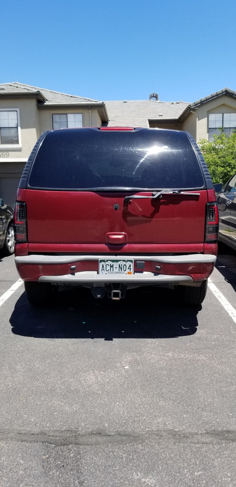

So first thing's first. I am sofa king stupid lol. After posting this I thought it give it one more go. Just to make sure i'm not being stupid. Well I was being stupid... After a careful and diligent review of the entire set up. It turns someone who I will say isn't me ( but i'd be lying) didn't hook things up correctly. I think it was a roaming band of teens that hookded it up wrong...yea thats it, thats the ticket!
Thanks for all the help, you guys are great!!
Here's what they look like now that i've got done right! Oh and the hyperflashing cleared right up!!
