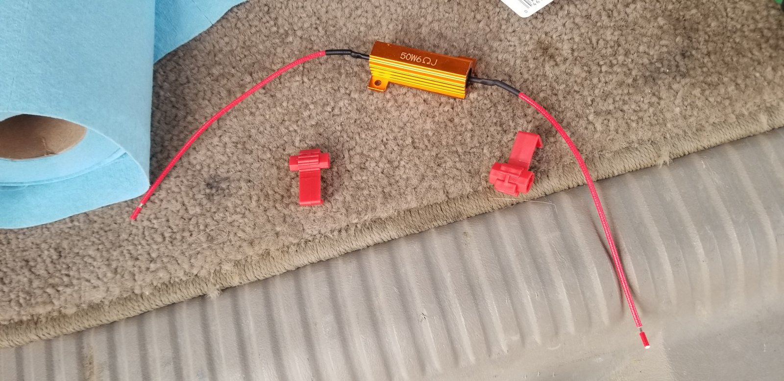

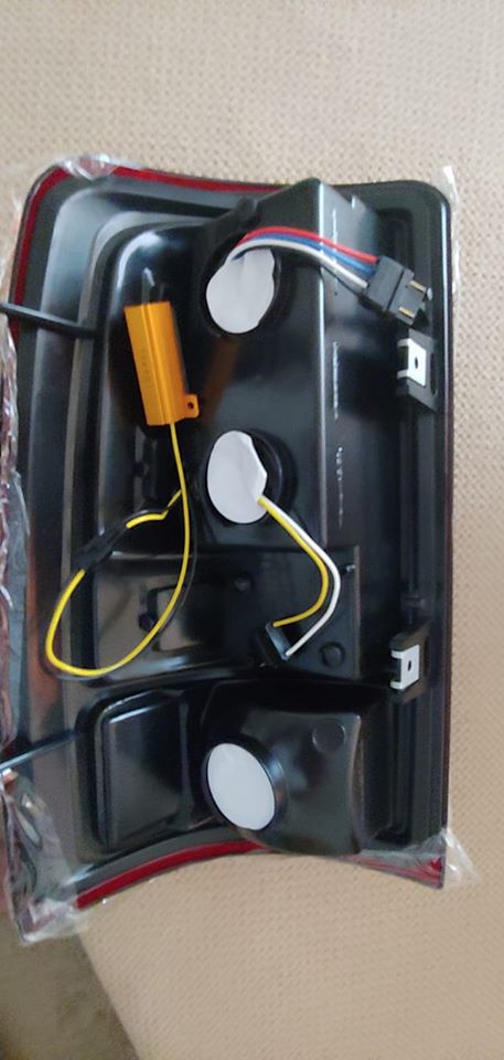

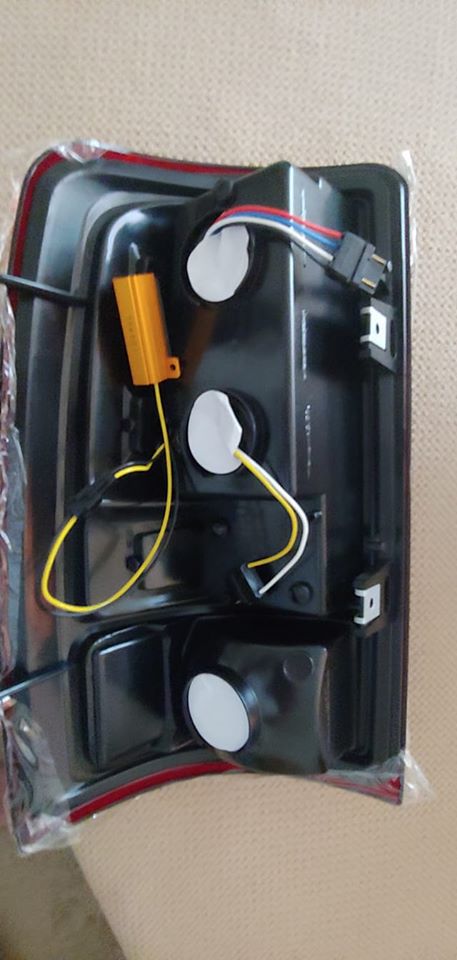

Here's what mine looked like from the factory in the rear. And the little resistor dealy i bought off eBay.

Don’t mount that resistor to the plastic like that, it will melt it.
thanks for pointing that out. I just lay it there to take the picture. I am not mounting the tail lights or my smoked out head lights till I get my yukon painted next month

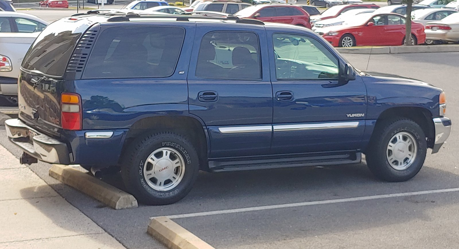

the sides and lift gate paint looks still factory fresh but the hood and roof , need a do over lol

the sides and lift gate paint looks still factory fresh but the hood and roof , need a do over lolView attachment 251293 View attachment 251294
I've got the same issue starting on my roof also
. Funny--same color too.

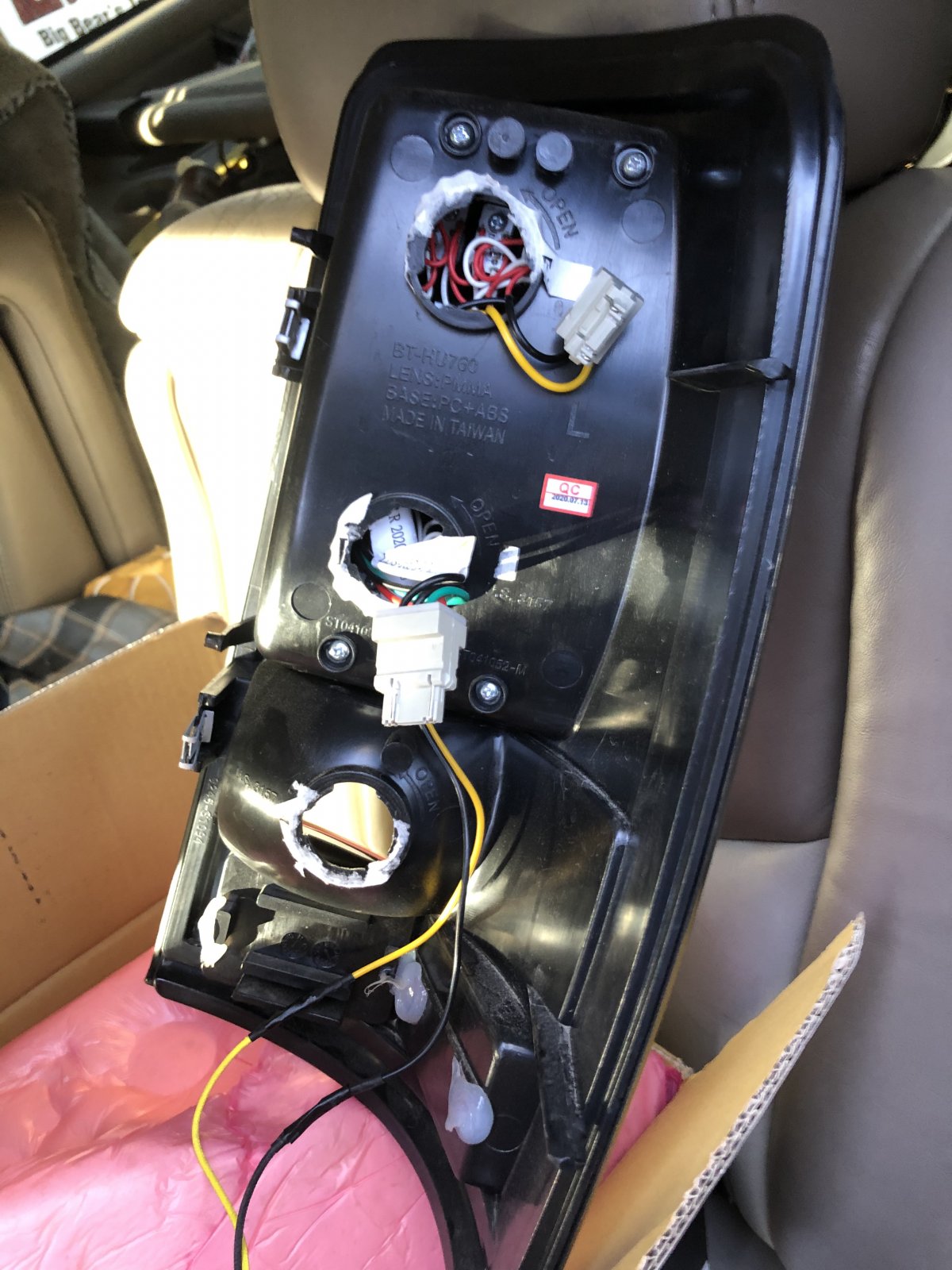

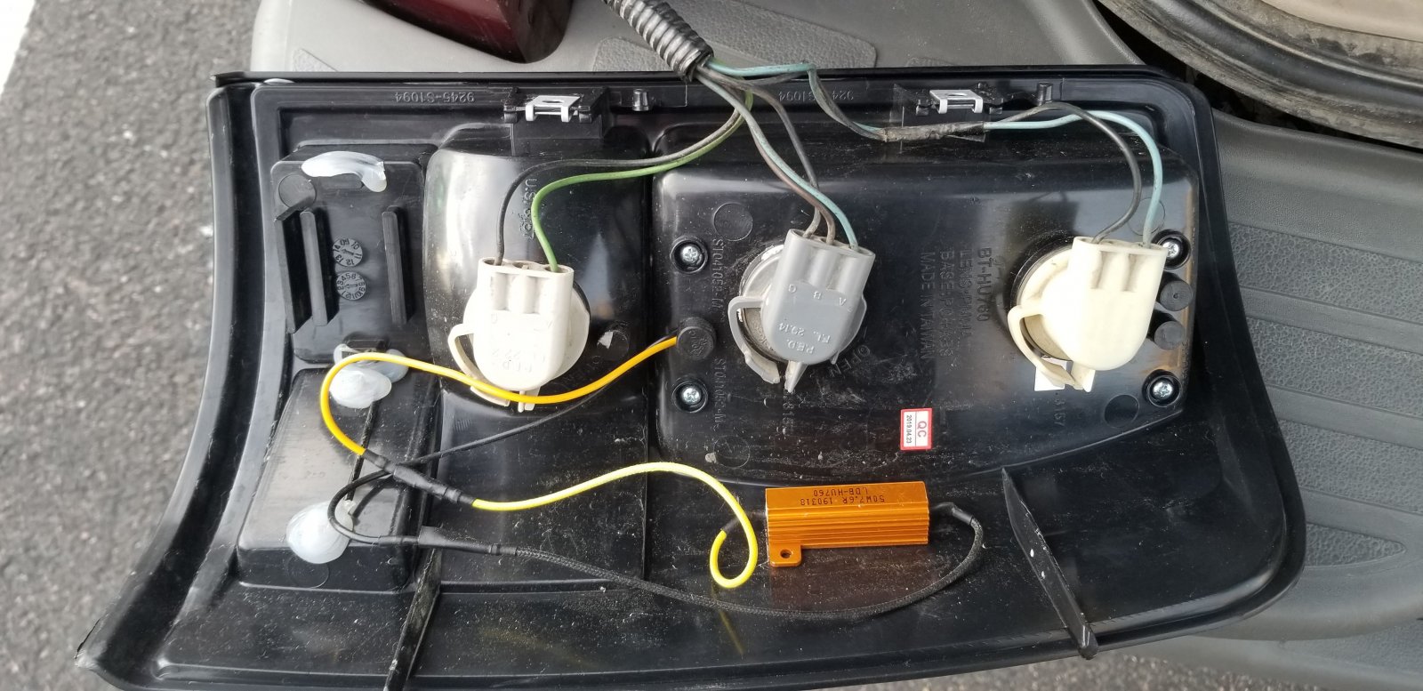

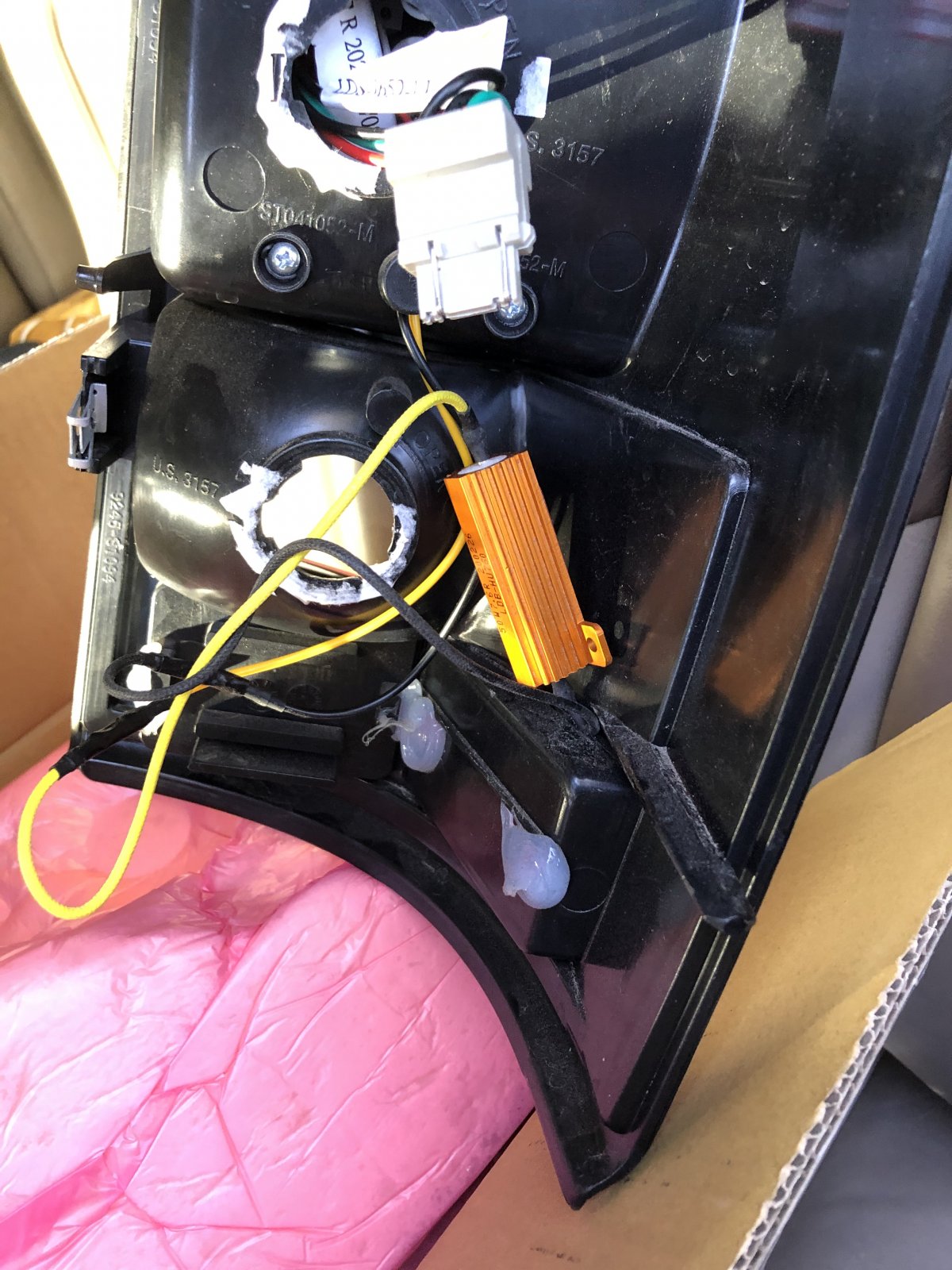

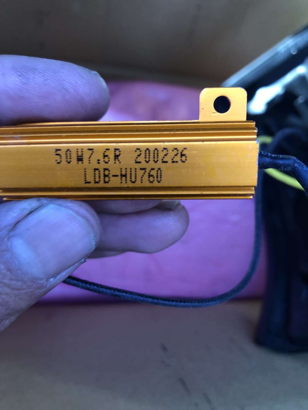

Hey guys sorry to revive an older thread, but I’m having an issue with the exact SAME tail light set. I got them a couple weeks ago and my set has the exact same resistor that the OP bought off amazon, already wired into the brake light wires. Yet I still have NO cruise control. The lights in my housings all function exactly as they should, and I double checked all the fuses pertaining to the stop lamps and all my fuses are good. What am I missing? I can’t figure out why I have no cruise because the tails already have load resistors. Do I need the flasher relay mentioned at the beginning of the thread? Here are a couple shots of the tail light housings for reference.
B39206A8-CF8C-47E0-88C1-A53B33F6A99A.jpeg 8032C5FE-80F6-46E9-A123-9A81FCB8728C.jpeg 1EE27EE1-2B28-435B-AF3F-1E2B9274E322.jpeg
The load resistors are wired into the middle light socket which I’m assuming is the brake lights and the top is turn signal? Is that correct? Or is it the other way around? I should add that the way there plugged in right now brake, turn, and the U bar LED, which lights up at night as the running light, function correctly.

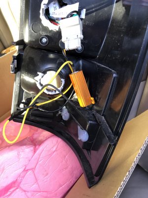

I realized im a Dodo .... the resistor is wired into my turn signals and NOT the brake lights. I thought it was wired into brake lights so I was stumped. Had to take a look at the harnesses... ordered a couple more load resistors from amazon so when they get here I have to wire them into the brake light harness.

Looks like it's time to order a resistor. A previous post said only one was required if I read it correctly.
Just ordered mine off of Ebay. They should be here in a couple of days. Those of you that have added these to take care of the cruise issue, can you show how you hooked these into the brake wiring please?
