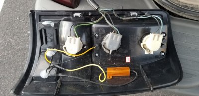

It’s easy, just connect one end to the brake light + wire and one end to a ground wire or the chassis, and mount them away from the wiring because they get hot. I installed mine in the area behind the tail lights.

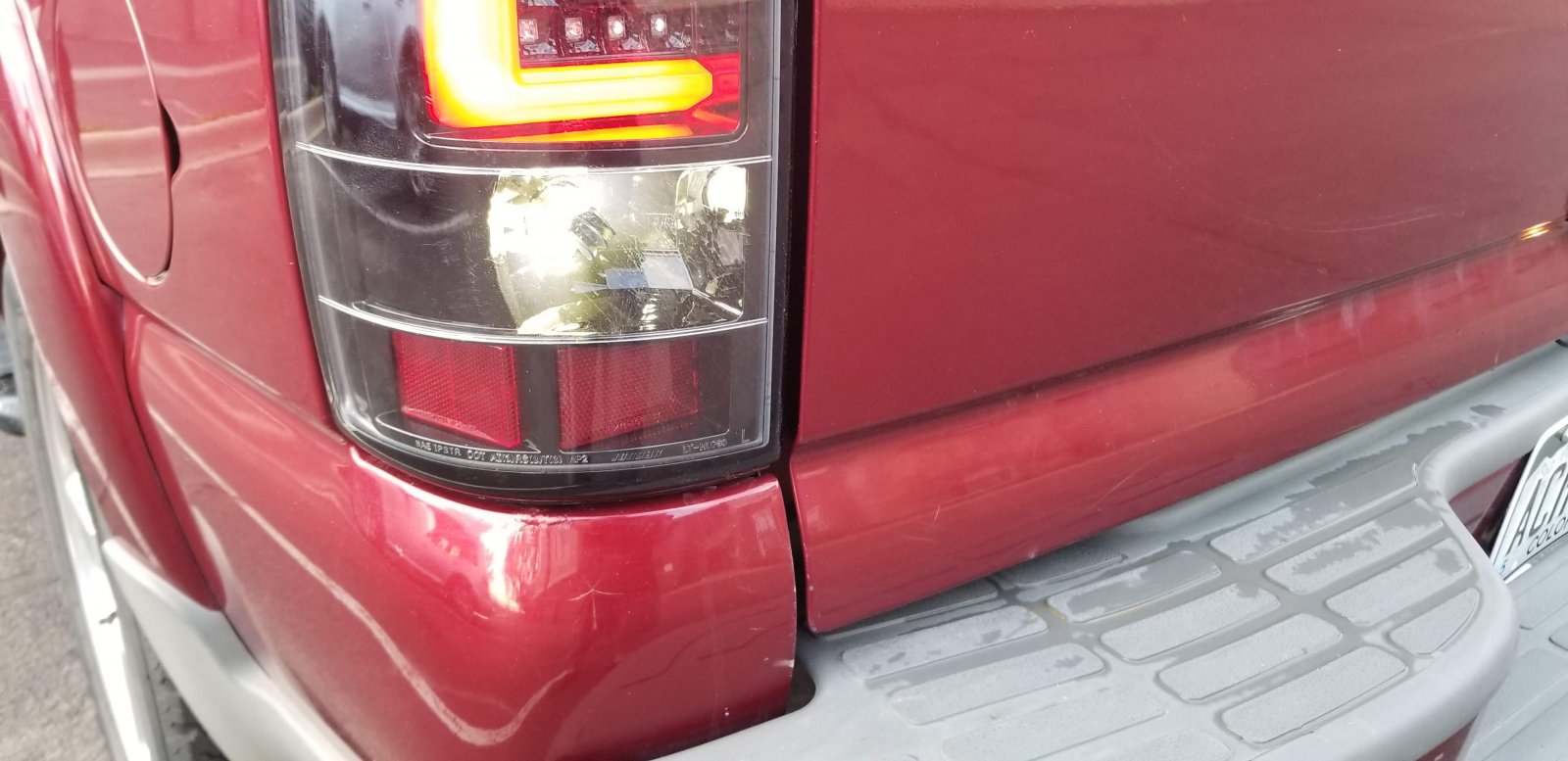

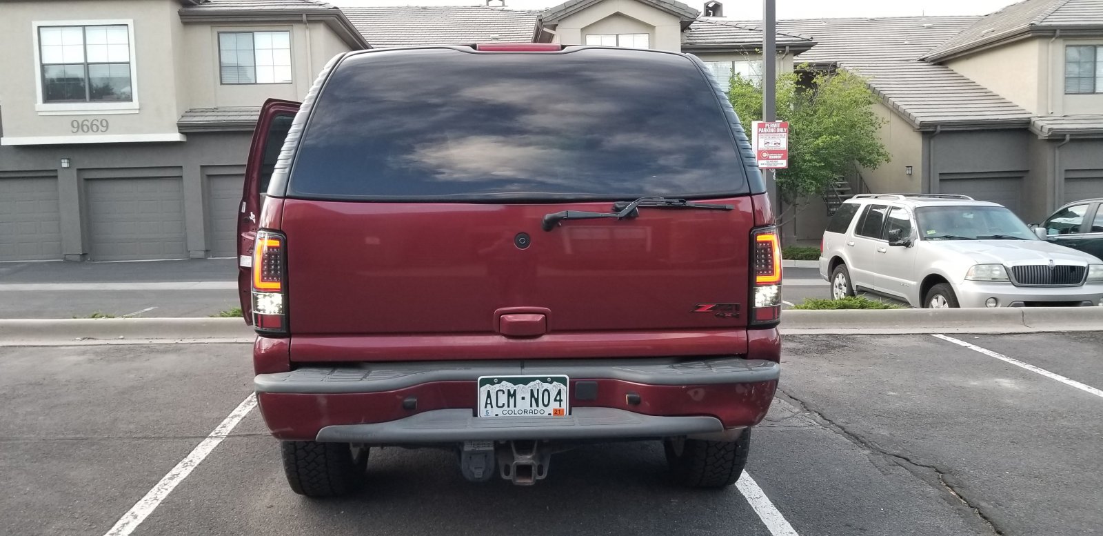

I installed mine on the drivers side brake light. It was super easy. I was thinking i was going to need to install a second one for the passengers side but nope. I also got some Sylvania Zevo LED's in for the reverse lights.
All told 10/10 would do again.

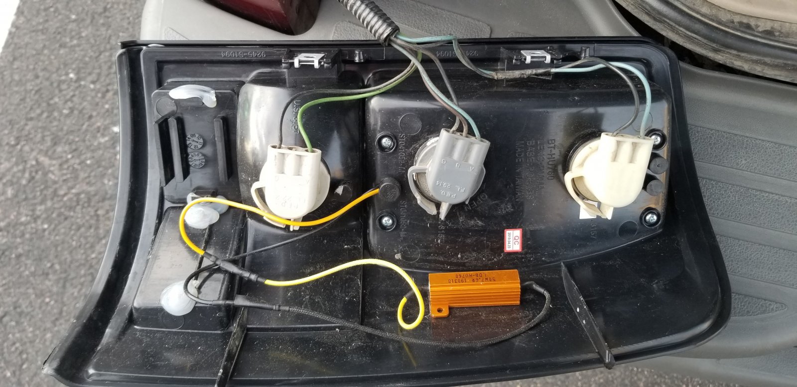

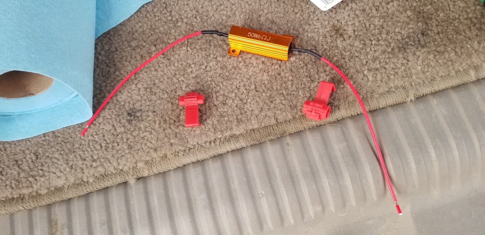

Here's what mine looked like from the factory in the rear. And the little resistor dealy i bought off eBay.
