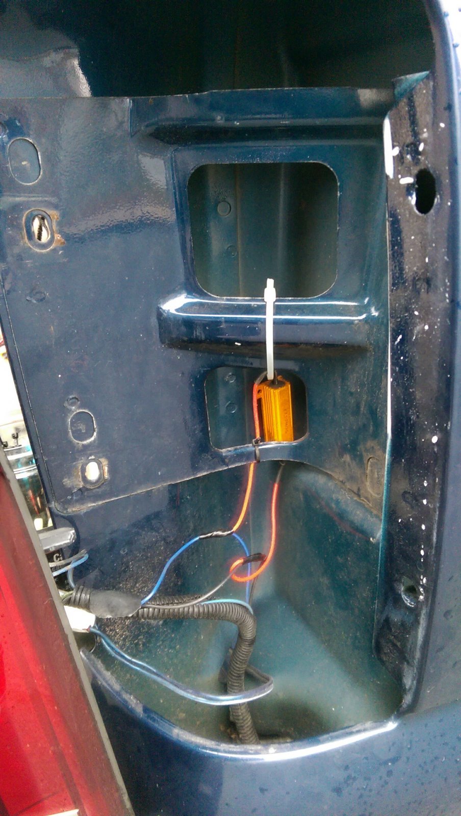

Looks like it's time to order a resistor. A previous post said only one was required if I read it correctly.

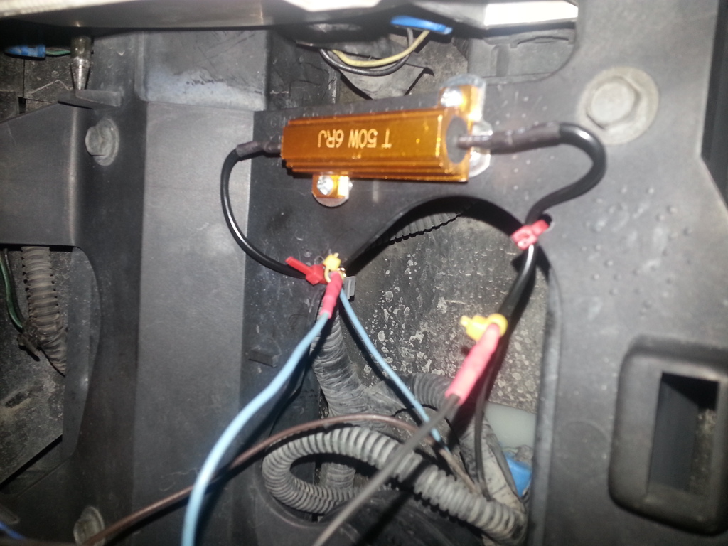

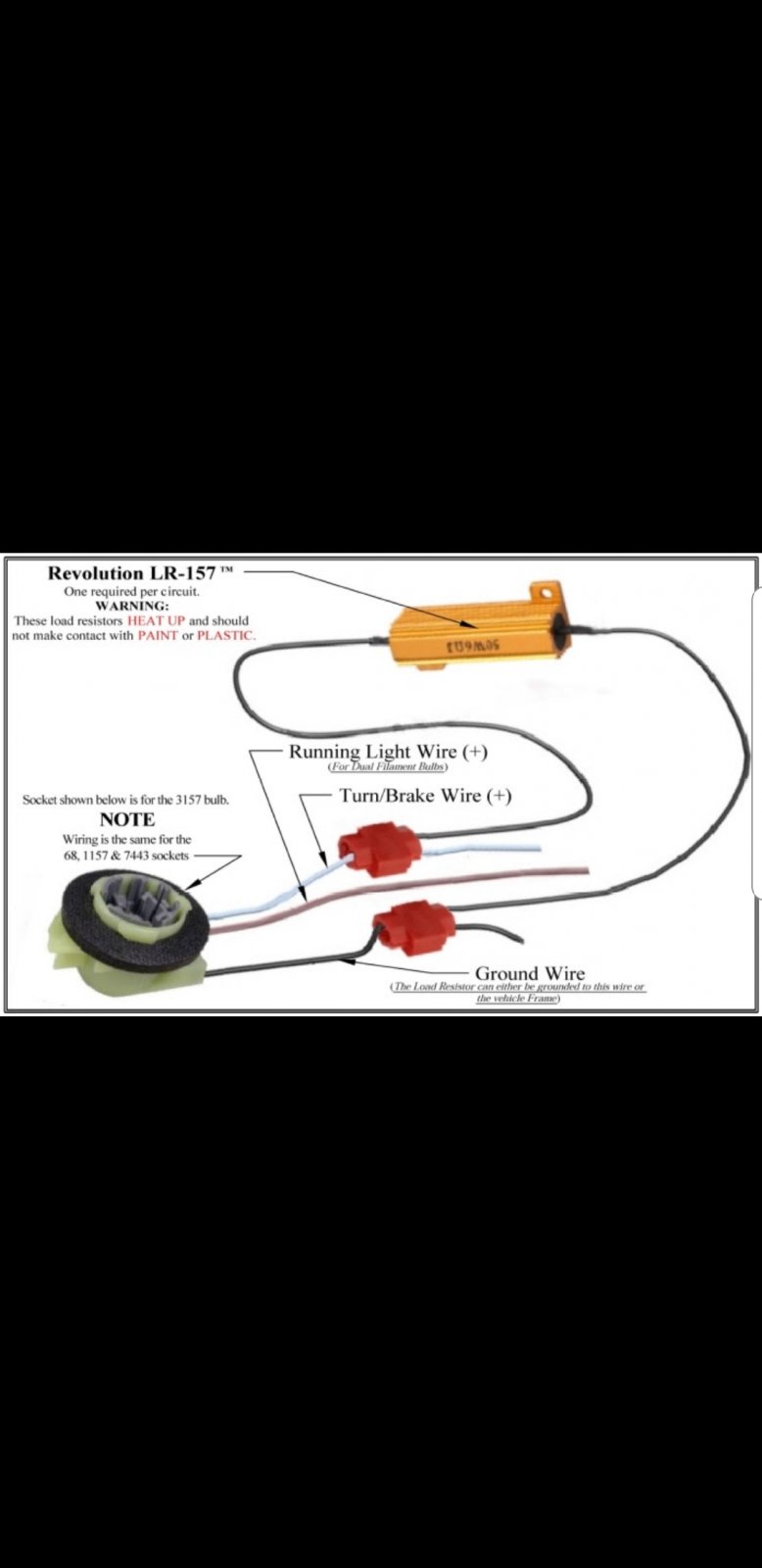

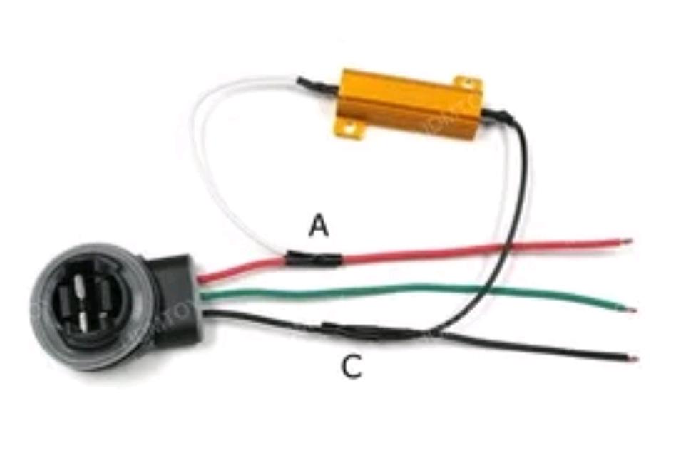

Just ordered mine off of Ebay. They should be here in a couple of days. Those of you that have added these to take care of the cruise issue, can you show how you hooked these into the brake wiring please?
Thanks.

Thank you Tony! I greatly appreciate greatly as I'm sure others do as well. Unfortunately, wiring isn't my strongest suit.
This one is pretty easy. Almost impossible to mess up.
Just make sure you secure the resistor on something that won't melt. They do get hot.

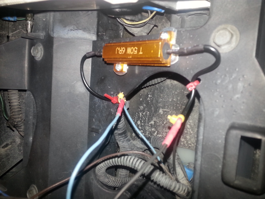

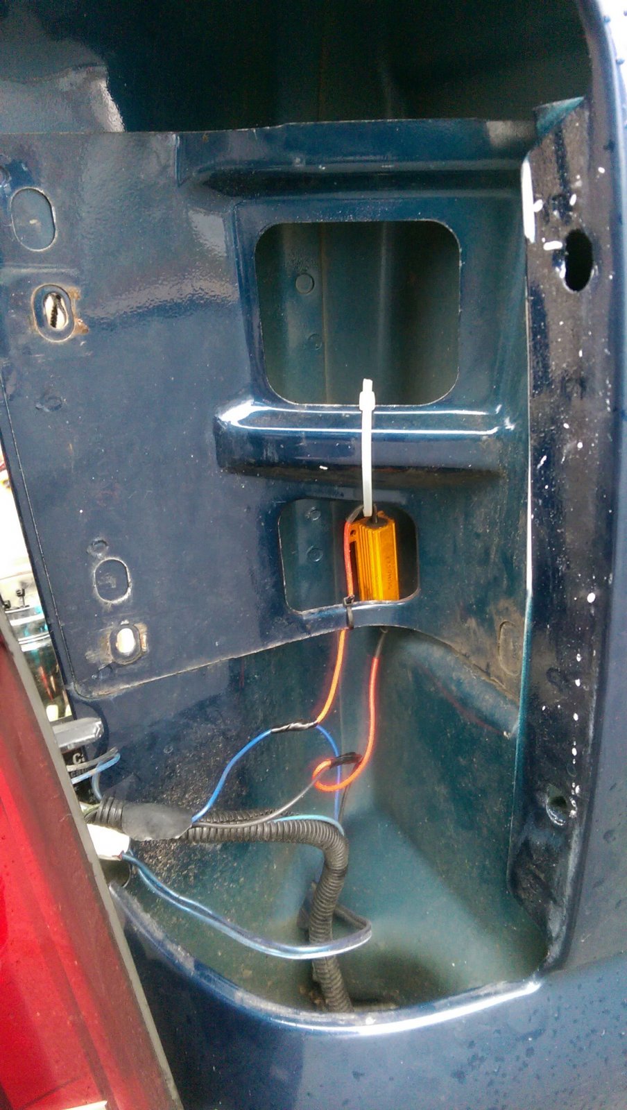

OP here. I just wanted to say, yea you have to add the extra resistors. I actually bought and installed the recommended control module as well. And imo that was unnecessary since it works just fine with the resistors. They were like $8 on ebay.
Also I only had to add 1 resistor, not one on each side in case anyone was wondering. And I just used T-taps instead of fancy soldering. :D
I was a dodo head and didn’t realize that the resistors added on the tails were only on the turn signals, until I looked at the photo you posted of your tails.... lol. I was like “oh maybe I should check mine to see if my resistors are in the same place....” :doh2:
