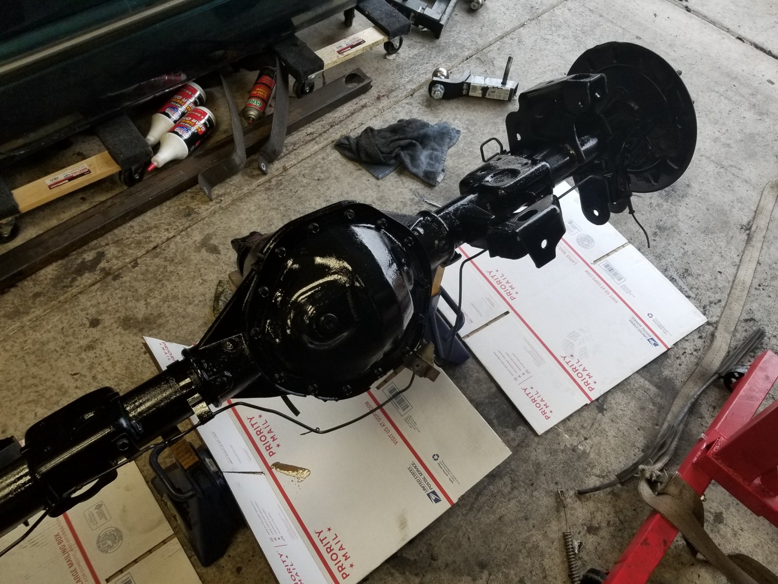

Picked up the new axle today. Here's pics. It's got 3.42 gears vs the 3.08 that I have now so it should pick up a little better acceleration.

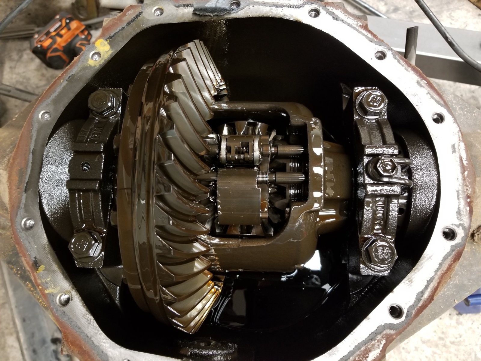

Checked operation of the locker and ran a few cans of brake cleaner through it. Sanded off most of the bubbled paint and rust. Fresh coat of rustoleum satin paint and some Lucas 75w90 and I think it's ready to go in. Just have to measure my u joint to see if it needs a different one.
