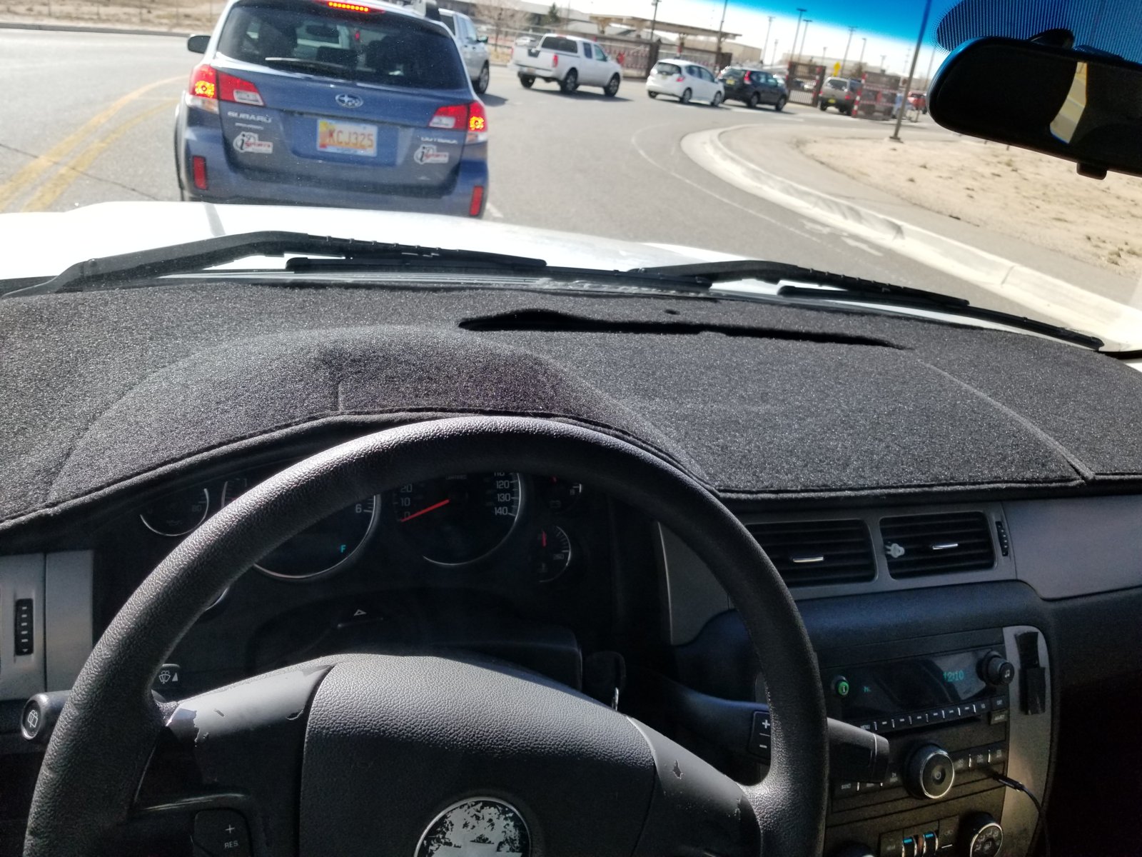

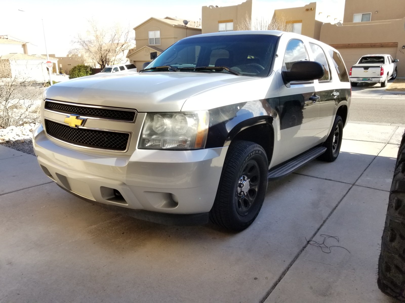

Going to put all my mods in one place. Got a 2011 PPV 2WD to play with. So far I've added a dash mat and replaced the broken driver side mirror. Tried to remove the black stripe but ended up screwing up the base coat. Put some gorilla tape over the roof holes.

I thought the black trim looked pretty cool. My steering wheel looked a lot like yours, but when bored, just keep scraping it off with your fingernail, and pretty soon it will have a nice black glossy look to it. And, just add a cover to the wheel, which helps a lot with grip, and comfort. As long as you don't pick a fuzzy one, the $15 black perforated covers work great! Especially on the base plastic steering wheels I've had on 4 different trucks.

I like the black trim too but it is already chipped and peeling so I figured I'd get rid of it.

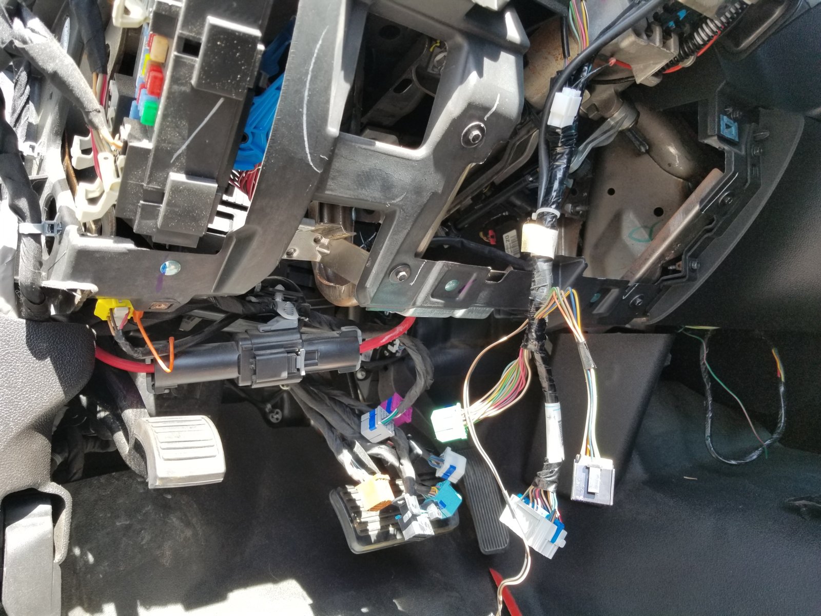

Did you install the Viper yourself, if so, was it easy? Plug and play type?
I did. By comparison it was easier than others I've done. but I used to do alarms as a profession. So for anyone not comfortable cutting wires to the factory anti theft stuff, I'd advise to pay someone who knows their stuff
Mine was peeling too, as I'm sure everyone's is going to do at some point. The soft material around the steering wheel hoop itself had separated internally from the metal loop, almost like the trooper assigned to my truck was death-gripping the wheel as a nervous habit or something. I wanted steering control for my radio, so I just bought a new factory leather wheel with the steering controls.....probably the best $200 I'll spend on this truck.

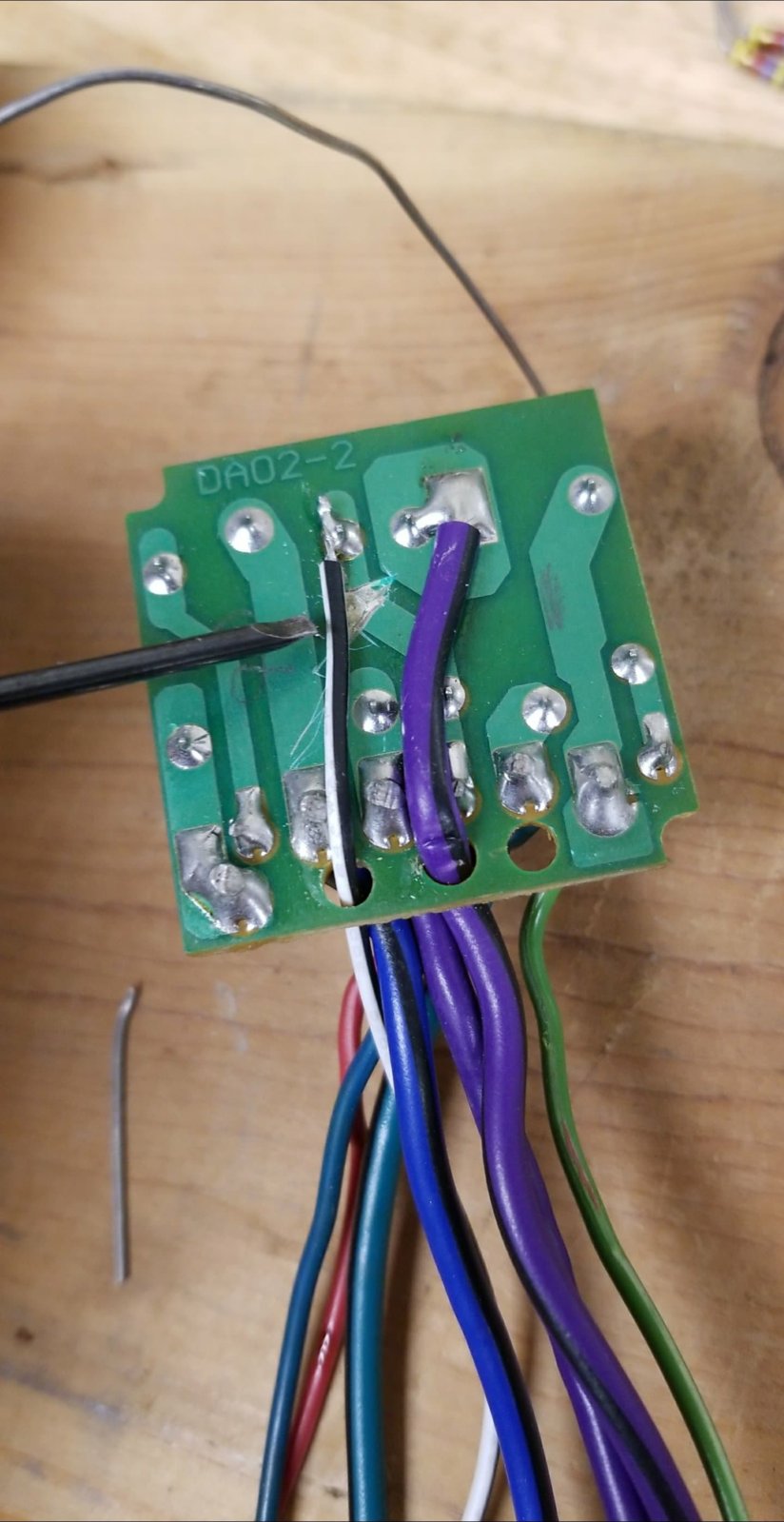

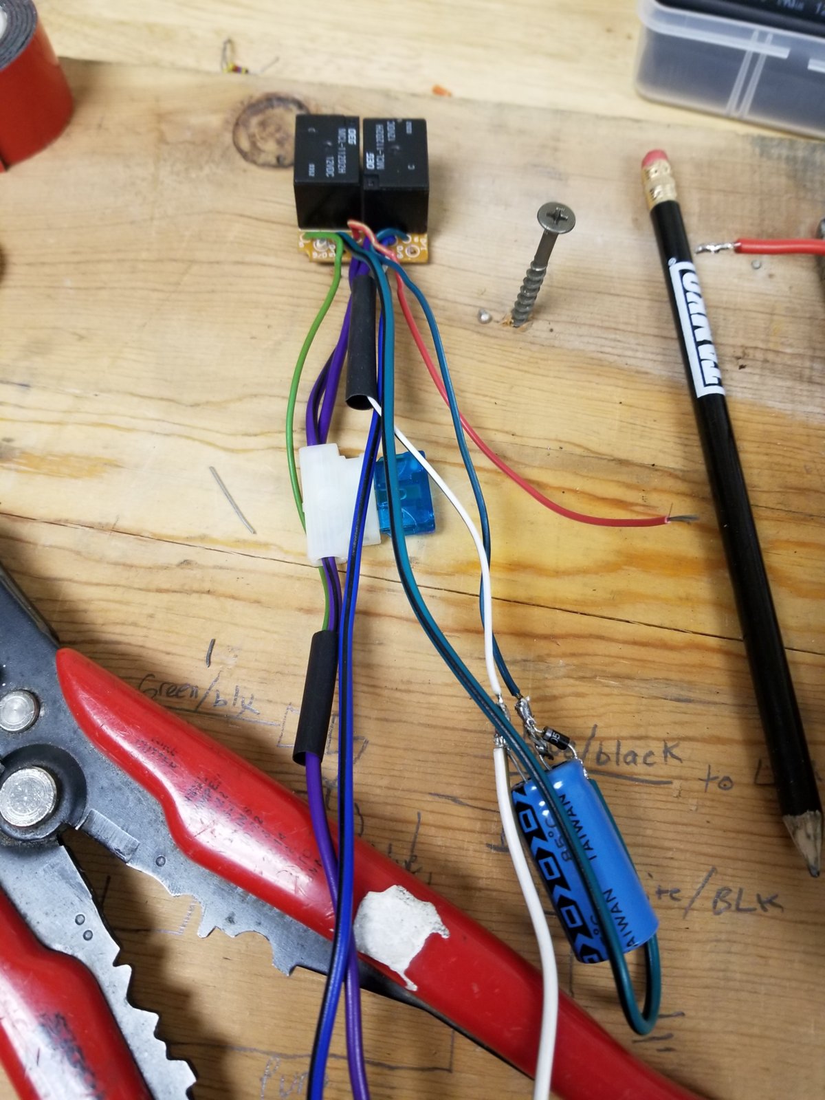

This past weekend I took an old DEI 451M door lock module and modified it. This will take the pulsed negative output from my alarm and convert it to a steady positive output that will turn itself off after losing the pulsed ground.
I'm going to wire this up to the cop light flasher so that when the alarm is set off it will make all the lights flash alternating.

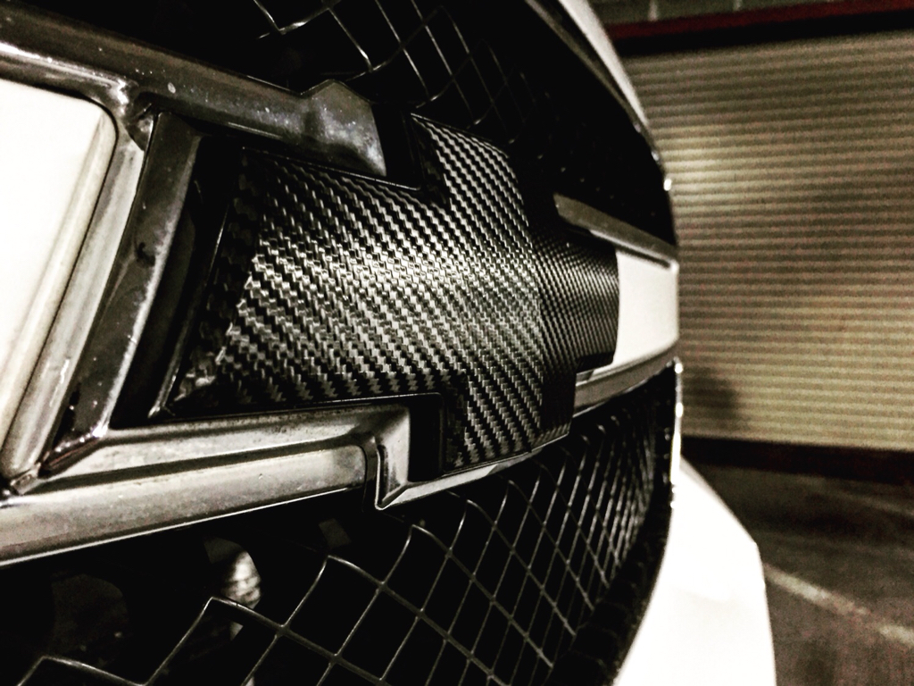

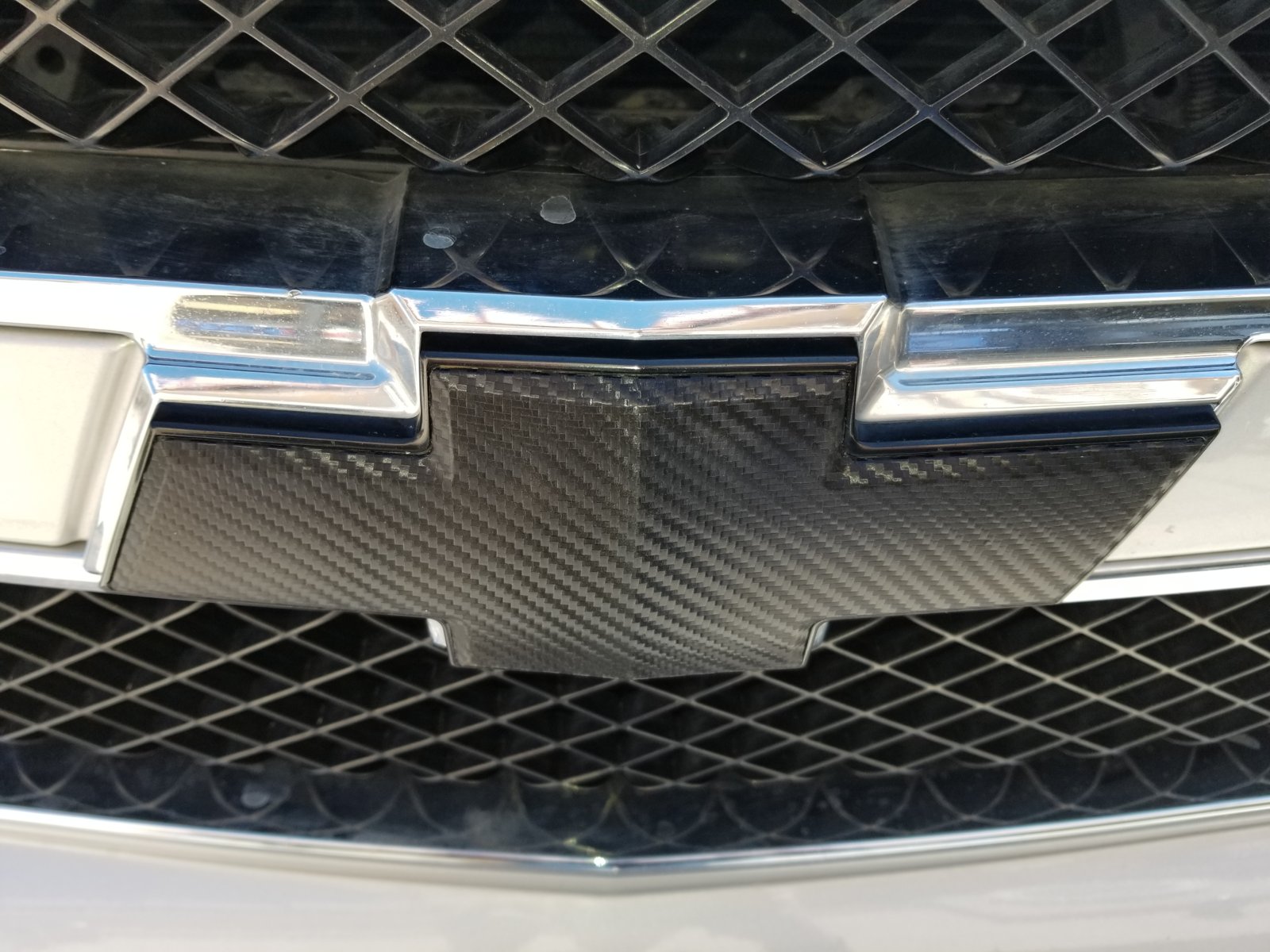

Also fixed the messed up paint spot. Just put a piece of scrap vinyl sticker over it. Not quite as noticeable now. Also had some scrap carbon fiber wrap and covered up the faded gold emblem.

That carbon fiber wrapped bowtie looks pretty good and not ricey like I thought it would....I need to do something about both of my delaming bowties!
I recently purchased a PPV and the previous owner had a wrapped bow tie. My Tahoe is white so it flows pretty well, better than I would have thought.
