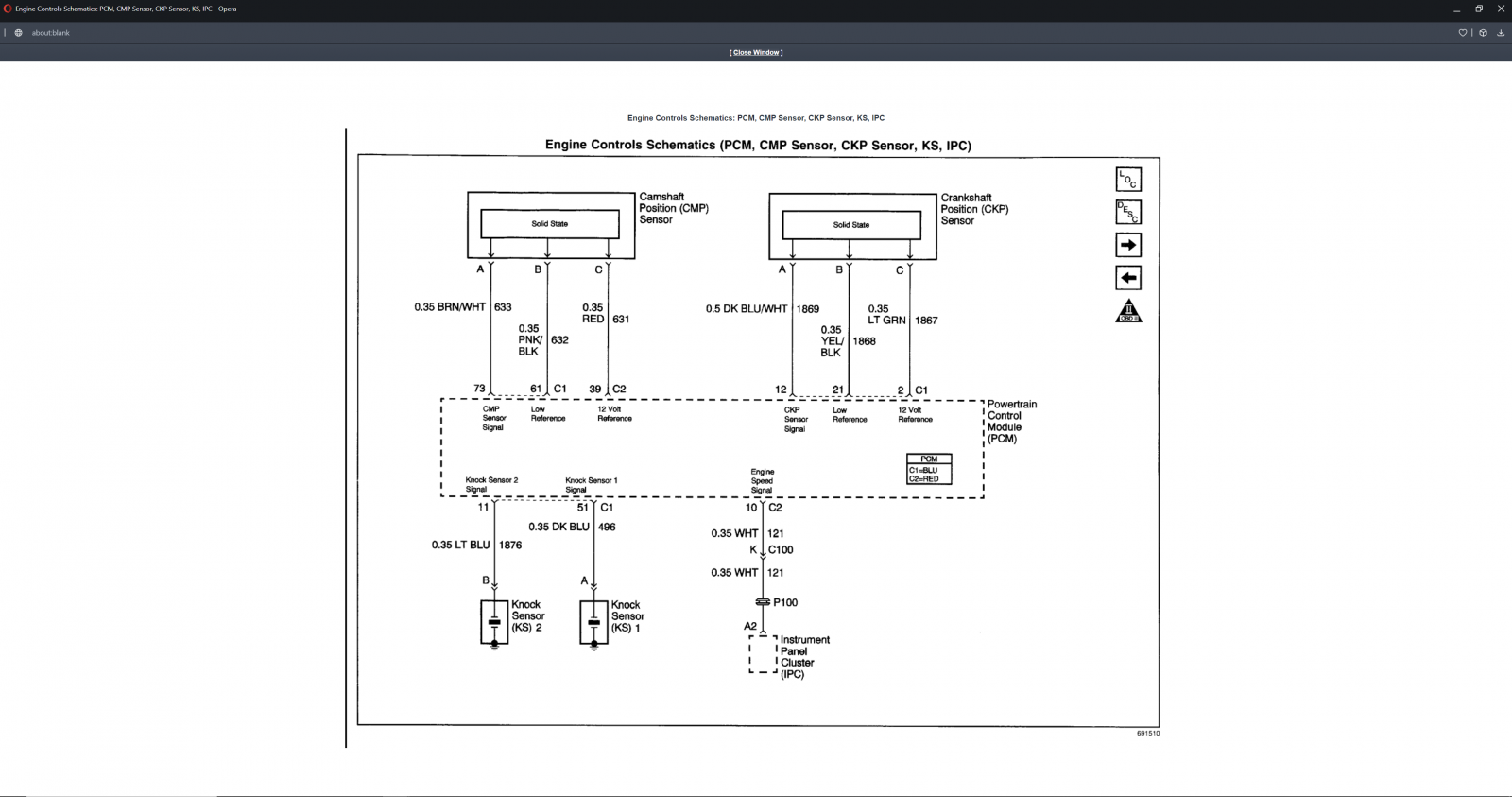

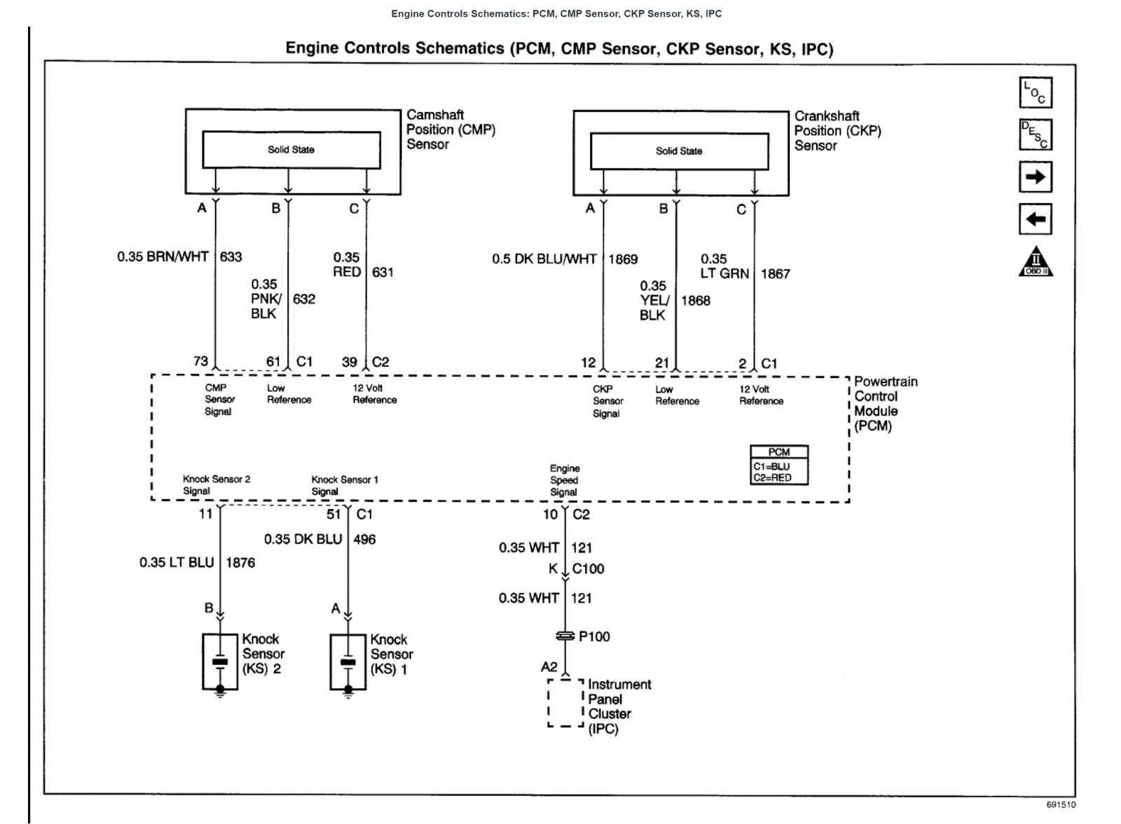

I'm going to save a few notes in here in case anybody else comes across this thread.
P0327 - Front knock sensor closest throttle body
P0332 - Rear knock sensor closets bell housing
Nominal sensor has 93k to 107k Ohms resistance (can test through connector to chassis ground / engine block).
Nominal output is AC 400mV. Tap on engine block with wrench and see if you get signal on DMM.
Wiring harness copied below:

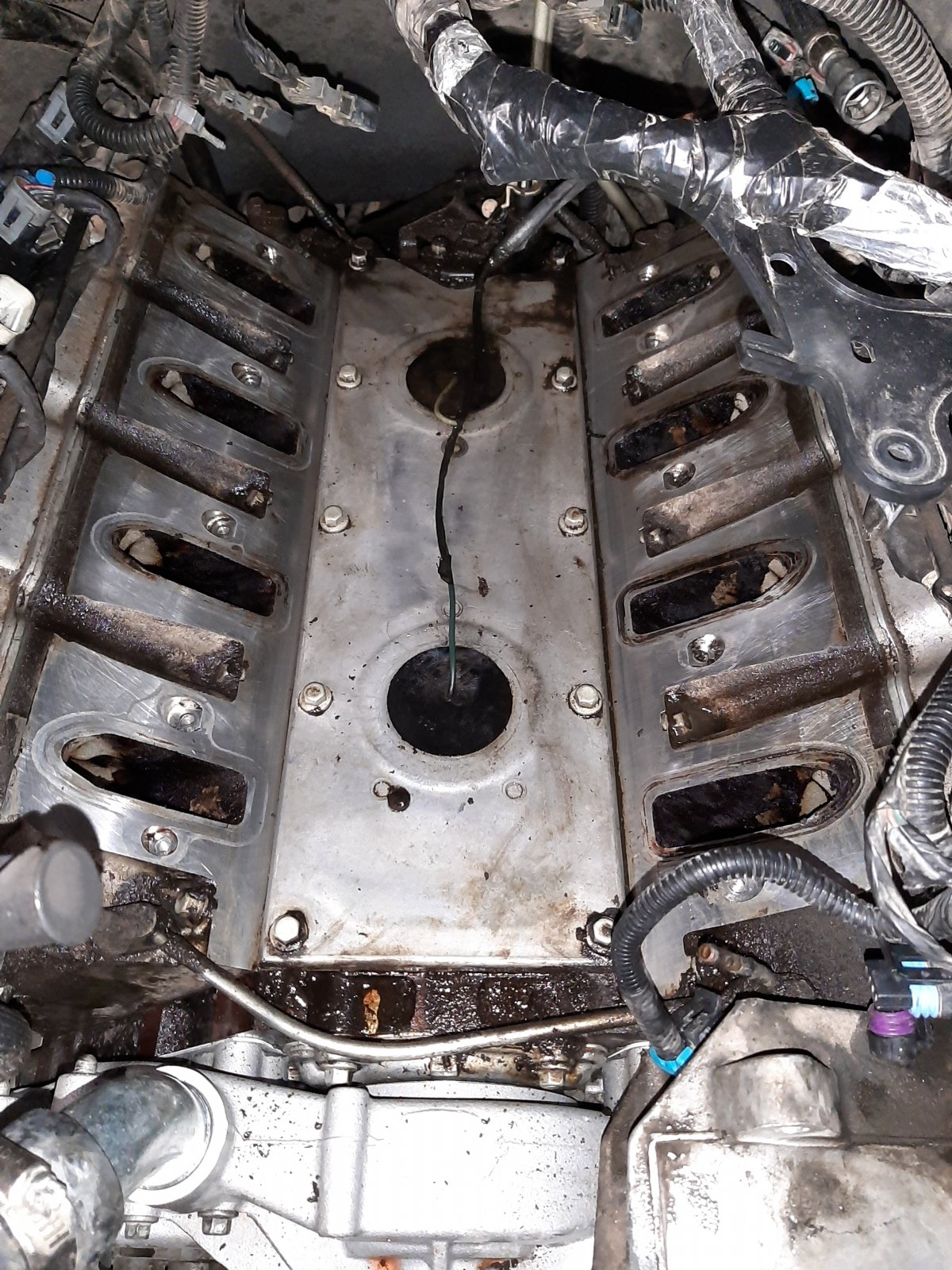

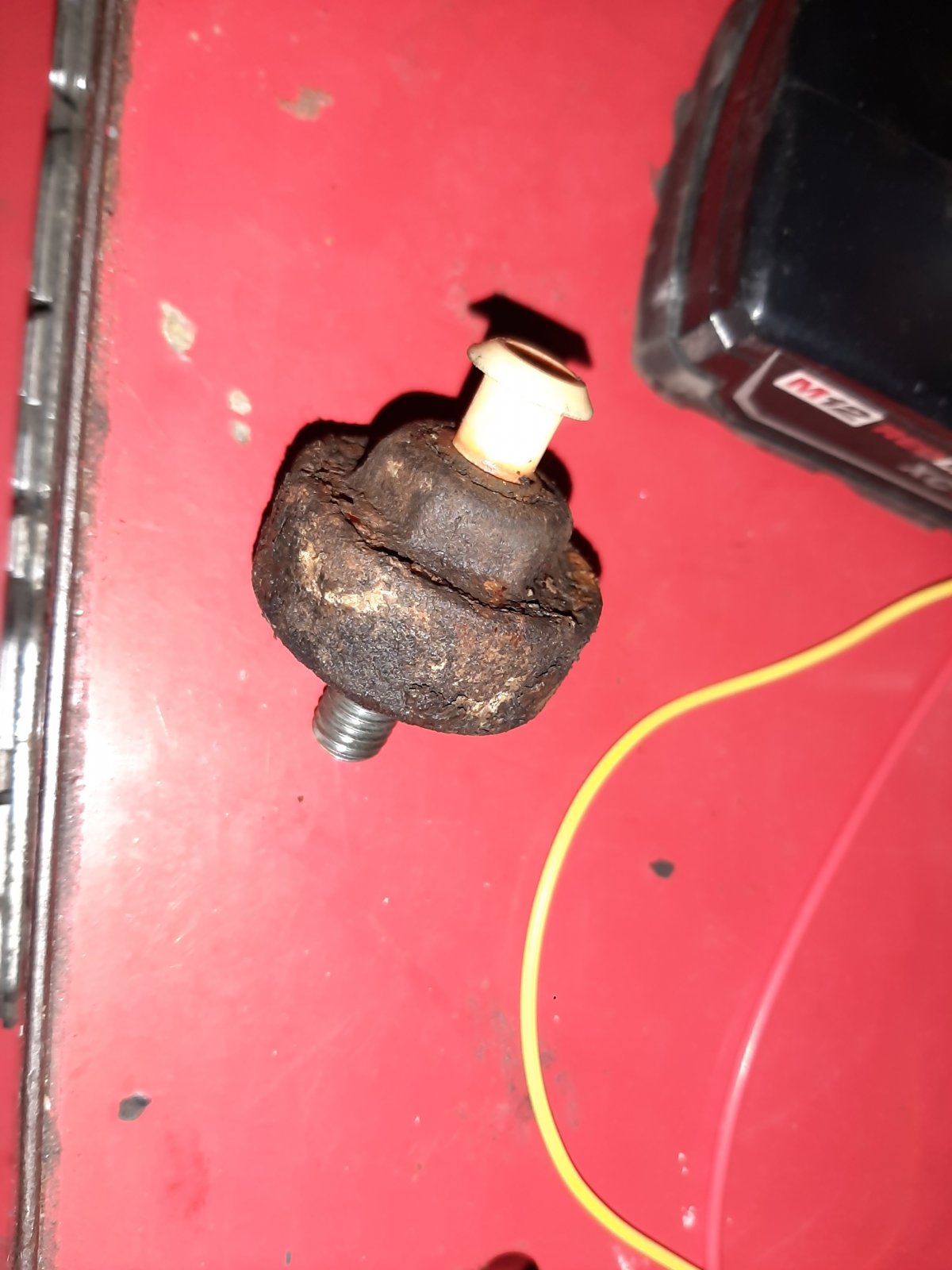

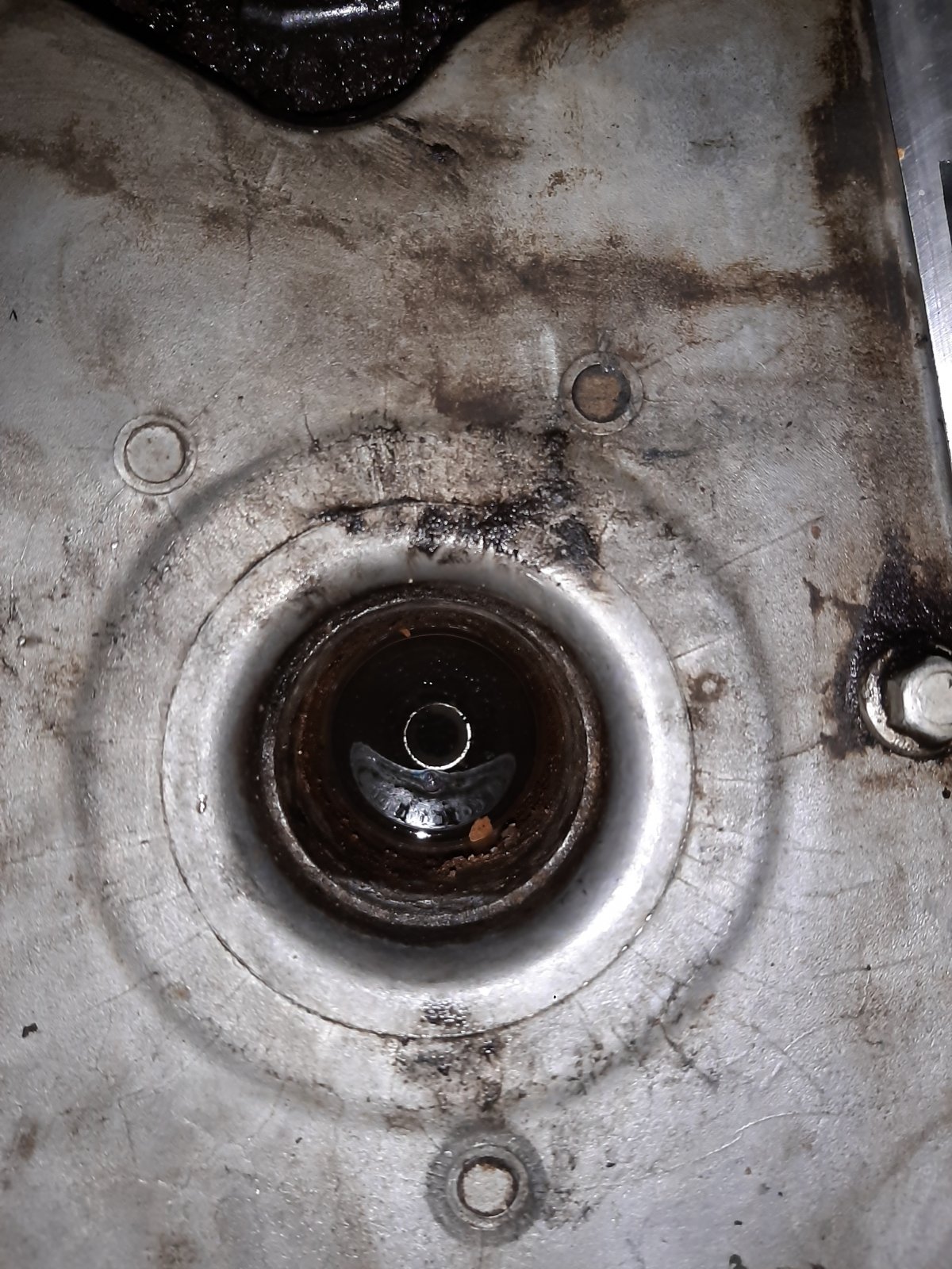

Tore it down, fun project... I'm a glutton for punishment haha Just don't like the $50 I'm spending on a motor I plan to get rid of. Got two new knock sensors, harness, and intake gasket. I must say, this Gen 3 design is BAD, at least they could have made a better seal for the sensor / harness. It was laughable. Certainly had been water accumulating in there for a long time. It looked like I raised a cannon from a sunken ship haha. I measured resistance and was basically an open. The second sensor looks great. The harness still made a connection but has a bunch of resistance in it so needs junked. Thanks everybody for the help. I'll probably RTV the seal in as I've seen other people do when I put it back together.

... I'll probably RTV the seal in as I've seen other people do when I put it back together.
No "probably" to it! Unless you want the new sensor(s) to end up looking like that one, a few pennies in RTV will save your $50 investment. It's not lost on that engine cuz you can swap them over to your new one.
